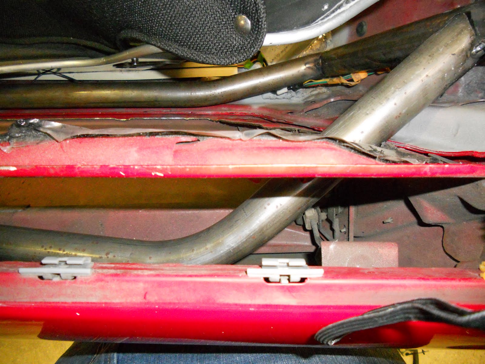

Keep the suggestions links coming. Have sent an email off to the rule makers to ask what cannot be done. Have started to ask for quotes for a CAMS cage. Suggestions appreciated as well.

This is what I am thinking for the doors. "To fit the cage and to make egress safer, the windows had to be removed to fit the cage. Hence why lexan windows were needed"

Ok you guys aren't thinking through the rule set. You need to be a bit more creative and find the loop holes.
You can remove metal for wheel clearance. In a NA that means the entire inner tub of you setup the ride height low enough. Ideally run 17s with drop spindles for optimal metal removal.
You can also remove metal for cooling, so everything in front of the shock towers can go to alow airflow through the backs of the guards. Maybe some stuff behind the shock tower too to get a bit more airflow. Much better to be safe than sorry when it comes to cooling. There should really just be a couple of tubes hitting the shock towers and the chassis rails in front of the firewall.
You can also remove a whole stack of metal at the back for a diff cooler. Just find the largest and lightest aircon radiator and mount it in the spot where the metal is thickest... and of coarse you have to duct the airflow to it so you can remove pretty much the entire boot floor and rails etc. You might also need to duct it in/out the sides too. You do know mx5s need big diff coolers right?
The heaviest part of a mx5 is the sills. There are two thick metal plates pressed into the middle. That happens to be right where you need to run the lower bar for your cage... what a shame! In fact the whole cage seems to fit best right where all the heavy bits are so better start chopping.
If you design the cage, cooling, fuel tank, seating right you shouldn't have much original car left. I think 804 is easy to hit. No CF required.
