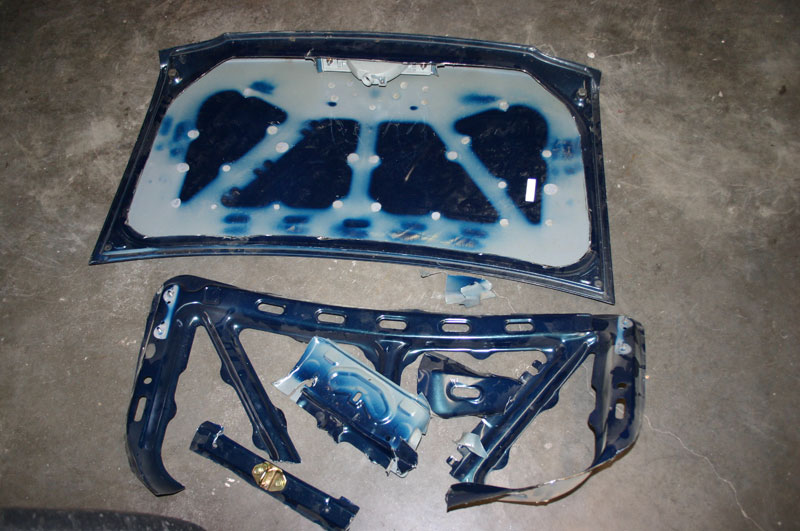

3gress wrote:There is a build log on mx5nuts and clubroadster called panda2. The car had some serious weight reduction. For an example the boot latch and rear support stamping was removed along with boot hinges. The frp boot lid was held down with latches. The hole saw was powered up here and there too.
It got fairly extensive with frp doors added along the way. See if you can find the build log, it was in the epic roadsters section of the clubroadster build log forum.

3gress
Posts: 512
Joined: Tue Apr 14, 2015 6:49 pm
Location: northern rivers n.s.w.
Re: Weight reduction? How do I add lightness?
Postby 3gress » Wed Mar 16, 2016 11:31 am
Courtesy of Keith Tanner.
You could leave the hinge mounts and latch in place to avoid having to pin it down. Sourcing a frp or carbon lid would probably make more sense, the only advantage with the above mod would be saving money.

3gress wrote: Courtesy of Keith Tanner.
Not a good idea if you have a big wing on the back :)
Postby 3gress » Wed Mar 16, 2016 11:42 am
I'd do it if i could find a decent way of securing it discreetly while still allowing access.
Postby Magpie » Wed Mar 16, 2016 12:10 pm
Thought about that. These would be perfect, one in each corner of the boot, lift on/off but not cheap for lockable versions http://www.quik-latch.com/quik-latch-hood-pins-lockable.html. Non lockable expensive as well http://www.quik-latch.com/QL-50-LP-Low-Profile_Quik-Latch-Hood-Pins.html
You maybe able to use the Aerocatch 2 http://www.aerocatch.com/aerocatch2 but area to install could be an issue.

3gress wrote:I'd do it if i could find a decent way of securing it discreetly while still allowing access.
Why not just leave the hinge points and the catch area untouched then?
Not as light as removing it all, but lighter than stock, and would allow use of the original lock etc.
Or remove the lot and make up an aluminium bracket for the hinges, and an alu part to hold the latch.

I figured the decklid being steel would be where the weight would be on the NA so I quickly looked into it.
According to this (http://clubroadster.net/vb_forum/16-gen ... ights.html) the weight of the NA boot is in lbs:
6.00 deck lid
4.50 trunk hinges, springs, catches
3.00 trunk ribs
Replacing the decklid with something like this (http://forum.miata.net/vb/showthread.php?t=516069) and then doing some modifications to the ribs for that last bit I'd think would be the way to go.
