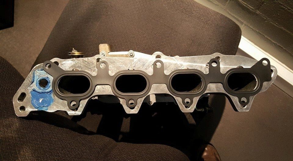

At the start of the year I saw a Honda Skunk2 Ultra Street intake manifold and 70mm throttle body on gumtree and figured I'd give it a go. I've always figured this manifold would fit nicely in my engine bay and I've been searching for a better option than the stock NA8 manifold. I was torn between ITBs and a plenum design and this pushed me over the line.
Here is a summary of my build. This has been posted on various forums for those who would like to follow and test it out on other engines. Just a not of caution my engine is is NOT stock so if someone replicates this design on a less developed engine the results may be different. Having said that, please do and post your results!
My original aim was to modify the Skunk2 manifold via drilling new holes and filling in the ports. This didn't work out due to the angle of the manifold causing the TPS on the throttle body to hit the chassis and that the injector ports on the manifold would need to be welded then cut in half to clear the mazda injector ports.
This has been done with other Honda manifolds in the US successfully but for us RHD cars we have the brake booster in the way of the manifold so the tapered plenum is critical to clear all the brake lines etc. The typical Skunk Pro / Blox manifolds wouldn't fit without major mods to the brakes.
here is my test fit. A scale printout... looks good so I hit purchase.
My manifold rocked up 3 weeks later at the start of May.
Test fitment looked good. I needed to angle it up a bit to clear the throttle body on the chassis rails.
I cut off the flange on a table saw, had a new flange waterjet cut from 12mm ally and made up some braces and it was off to the welder. Note the angle of the cut so to lift the plenum up away from the chassis rails.
Once welded I machined it flat on my mill... Don't look at the mounting points, not the best!
Get it welded professionally if you do it. The guys in the US have had big issues with the welds cracking due to the vibrations, which is why I added the bracing underneath.
Here is it all welded up and mounted to the head. I machined the face of the flange down a few mm to take out the warping caused by the welding. Fitment is brilliant with the plenum missing the brake lines, biasing valve etc as well as all the throttle body clearing the chassis by at least 20mm. I have solid engine mounts so the motor can't move a lot. Also the throttle body aims the intake path to clear the pop-up lights.
