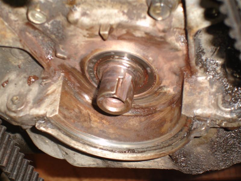

sailaholic wrote:Dann how is pulley slip possible on a b series engine? There is a keyway that keeps the crank aligned.
Harmonic balancers are two parts, the centre which lines with the keyway, and the outer, which has the timing marks and pulleys.
there's usually a bonded rubber donut between the two, if the bond breaks, the outer pulley can shift, moving the marks.

- Posts: 3511
Re: Low Compression in cylinder # 2.
manga_blue wrote:You're kidding us, right?sailaholic wrote:Dann how is pulley slip possible on a b series engine? There is a keyway that keeps the crank aligned.
Nope, but obviously having a brain fart.
My memory, is everything is positively located unlike the later engines that just rely on an interference fit.
Apart from a damaged key / keyway (which I wouldn't have described as "slip". I don't see how the pulley could be out of rotational alignment.
sailaholic wrote:Apart from a damaged key / keyway (which I wouldn't have described as "slip". I don't see how the pulley could be out of rotational alignment.
see my post above re: rubber insulated/located.
the lefthand pullleys were supposedly from a burned out MX5, the rubber separator things melted and the two halves separated.
The righthand one is a normal one.
