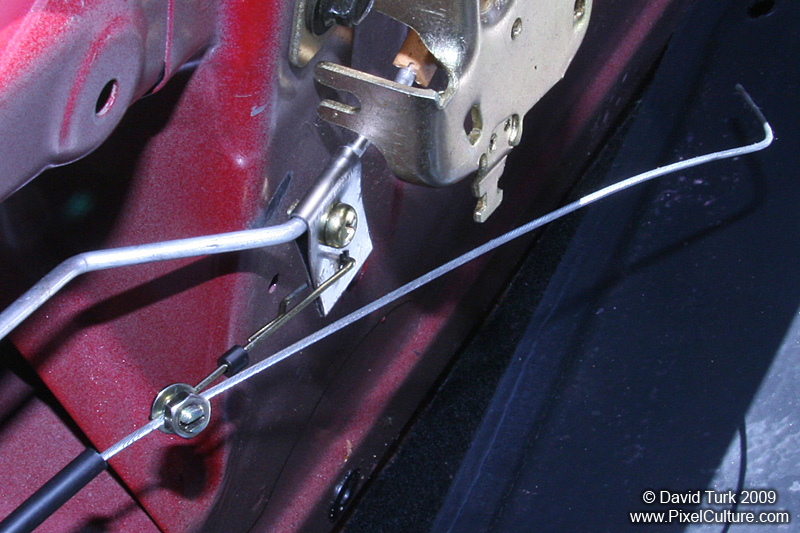

This is on the NB
Here's how I wired up an electronic version on the NB8A.
I've done the opposite, I disconnected my factory boot release so that it's harder for someone to break into the boot.

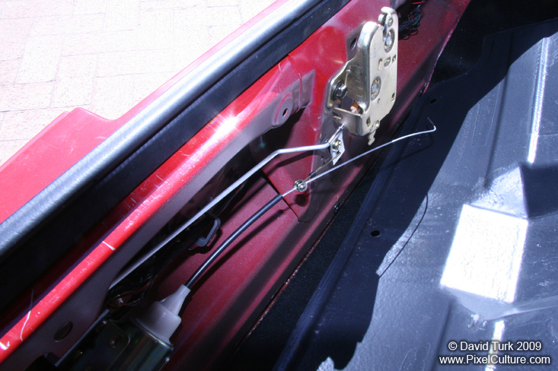

These photos show the electronic boot release (I assume) was fitted to my NA6 when it lived in Japan

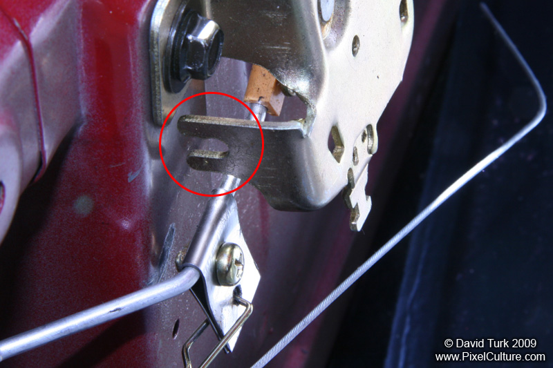

This photo shows the grove where a later model cable release could be attached. I assume you'd need to modify the inside part of the catch to attach the actual cable.

Cheers Okibi, my lock looks the same as yours, i may have to rig something up to attach it to the rod like your one. Not now though the cars at mx5+ getting another engine fitted, thanks for the photos

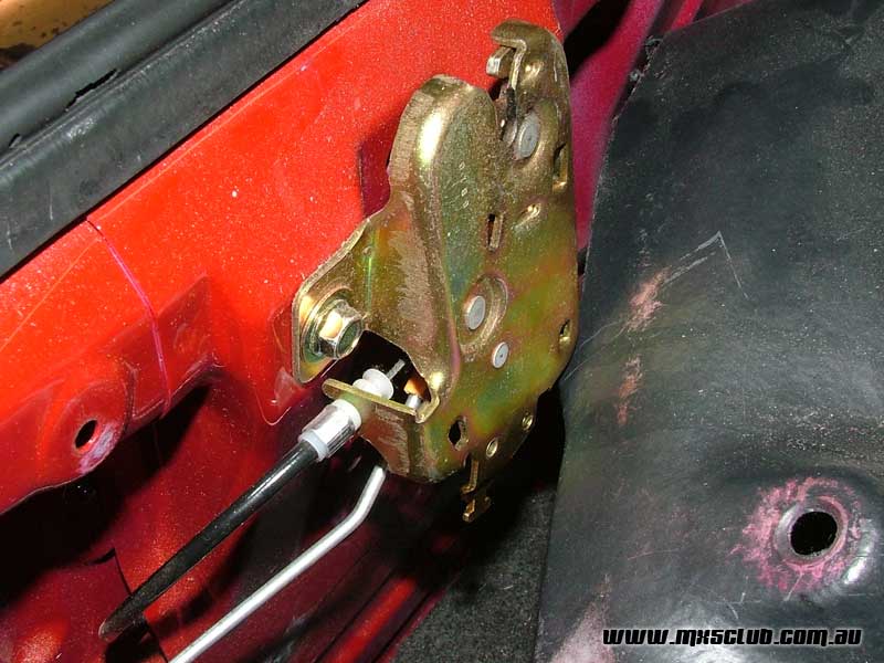

Here is what the latch looks like from the other side. The cable connects to the loop above the orange bit. As viewed, the cable pulls the level to the right which in turn moves the level and rod (the orange bit) to the right. I'm not sure how different this is to your latch but if you can get the cable to pull on your latch's lever or rod it should work.
