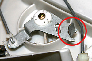

Postby Alex » Sun Dec 21, 2008 10:57 am

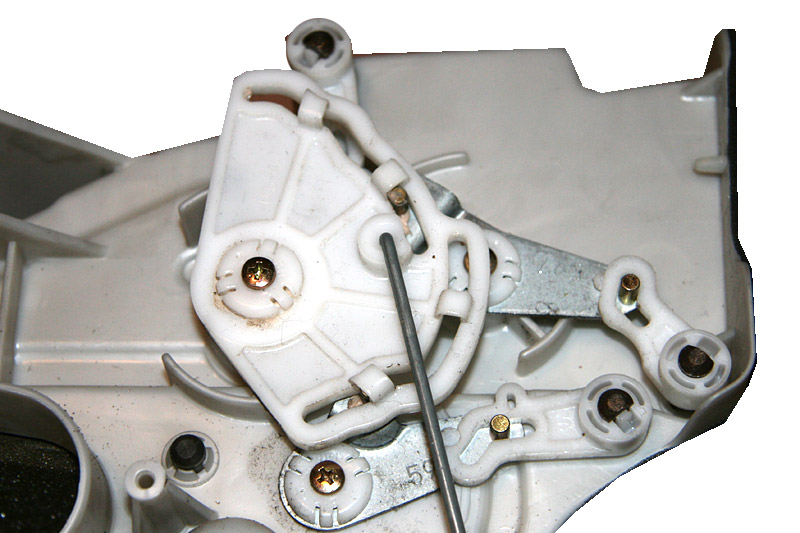

I turned my temp a bit too fast this morning and I think it might have disconnected because it doesn't seem to work
is it possible for the wire to diengage?
how do you remove the unit? is it similar to the factory headunit?
NB Heater controls

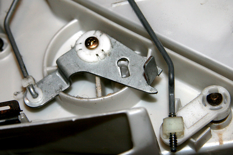

Postby Okibi » Sun Dec 21, 2008 11:42 am
I took these awhile ago, I think the red circle is the tab the loop on the heater cable needs to be around, it's more likely it's come off from the heater core than the controls.
You can get to these by popping the glove box out or removing the access panel above the pedals.

Postby Alex » Tue Dec 23, 2008 3:21 pm
Thanks Okibi, I found the problem, just like in your picture, there is a wire loop that goes around that tab, it had come off.
For anyone else wonderin it's located on the drivers side just about the transmission tunnel, not hard to see once you have your head in the drivers side footwell
