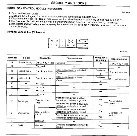

Postby Okibi » Wed May 17, 2006 10:50 pm
This is the diagram but I can't tell where it is meant to be under the dash.

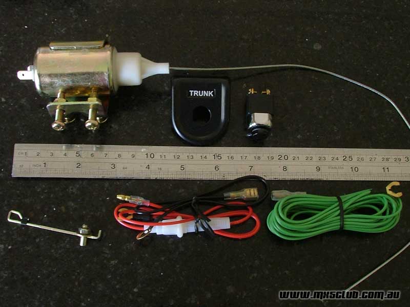

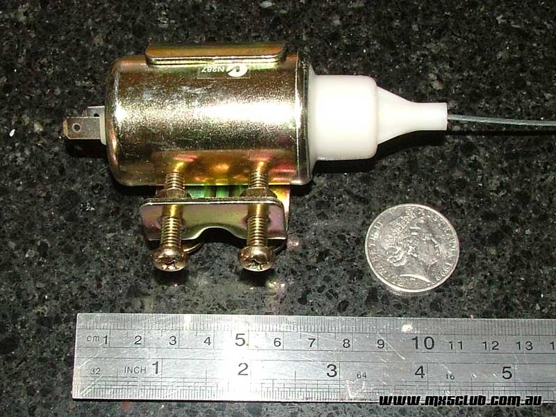

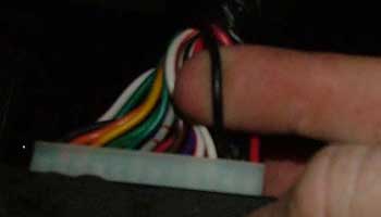

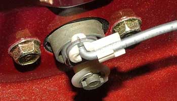

Postby Okibi » Thu May 18, 2006 3:39 am

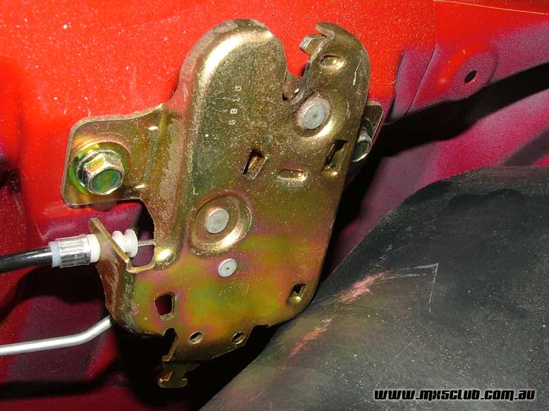

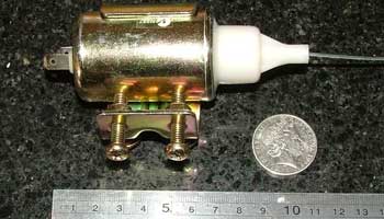

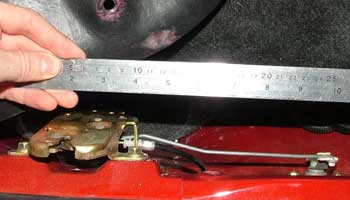

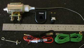

Jcar Boot / Hatch Release
Full Jcar Kit

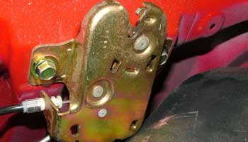

Boot Latch

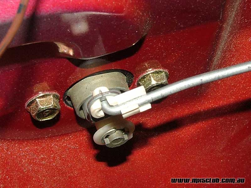

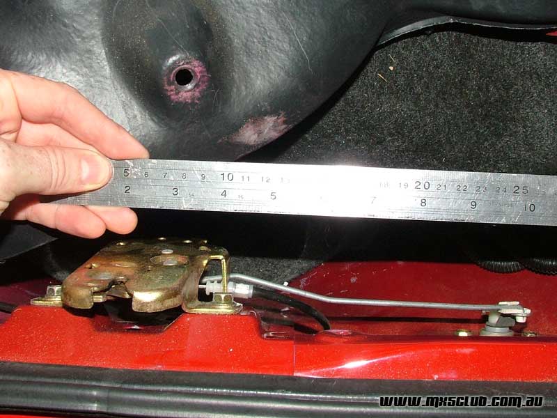

Close up of connection to lock
Close up of boot latch

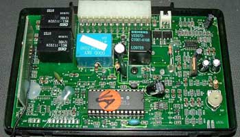

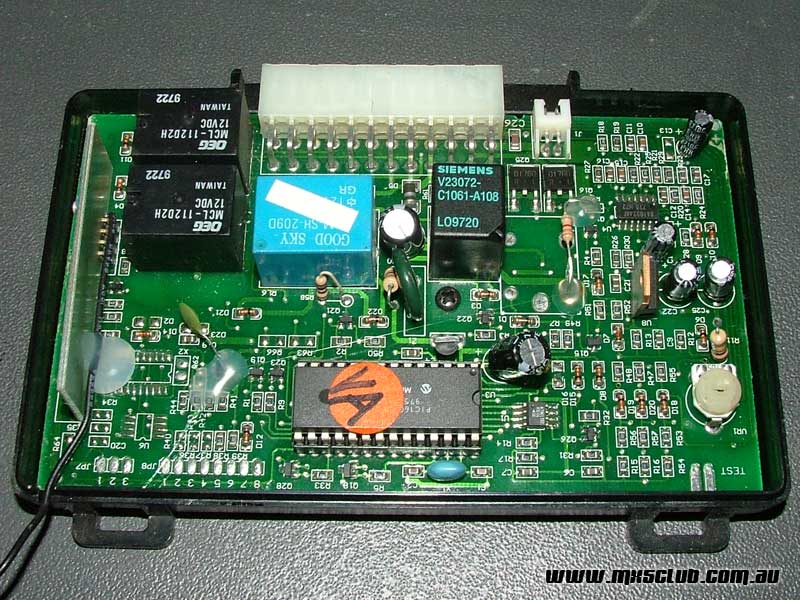

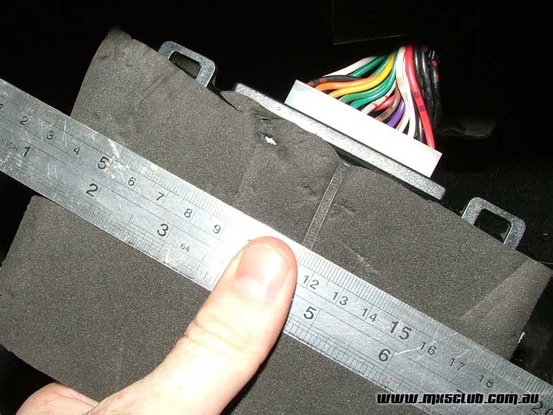

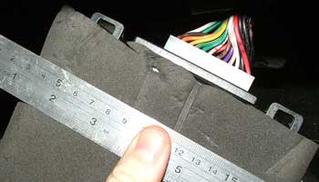

Alarm Module
2nd wire from the left on the top line (Black with brownish/red dots)
Inside the Alarm (pulled it apart trying to find why it wasn't working)

Have you worked out how to connect the solenoid to the boot latch :?:
Atleast the battery is is nice and close allowing you to test it quickly :P

Dave..I was pulling apart the SE yesterday and noticed that relay...it's on the passenger side,if you pull out the glove box it is right in your face.

Dave, wire it like this:
This will stop you blowing the 7.5A fuse - those relays can pull current >10A - that 7.5A rail isn't design for that sort of load.
This assumes that the black + dotted red/brown wire puts out 12v when active. If not, then nothing will happen.
