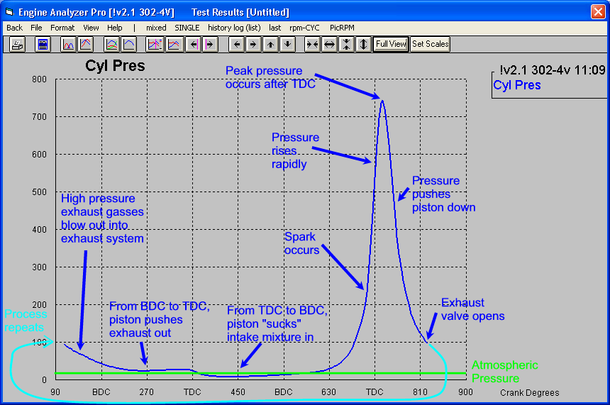

The piston is at BDC twice per cycle:
1) If the piston has just sucked in air and fuel and is ready to compress it, then, it *isn't* the wrong part of the cycle to let in boosted air. Any extra incoming air/fuel will add to the charge that will be ignited in 60-80 degrees. This is why standard intake valves close *after* BDC. This is *good*.
2) If the piston has just completed a power stroke and has a bunch of hot exhaust gases already ripping out the barely opened exhaust valve but still quite high in pressure (~50psi), then *good luck* to the boosted air getting in.
Where in the below graph, where the in-cylinder pressure is below a boosted pressure, would one *not* want the turbo adding pressure?
https://www.performancetrends.com/Definitions/Images/Cylinder-Pressure-Lrg.gif
PS: Sorry for thread hack, but it is close to topic>
