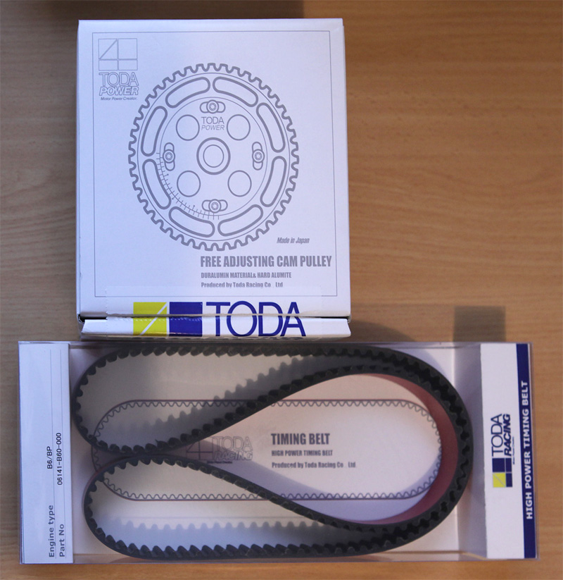

Hi Andrew,
Not sure how I missed this thread. You will need to get the Autronics tuned mate.
Check your PM for Steve's contact number.
A more efficient turbo will require a different fuel map.
Have you got adjustable cam gears?
Regards,
Les

I can see you're going to try and show me some new shiny stuff Les..
It might work..
