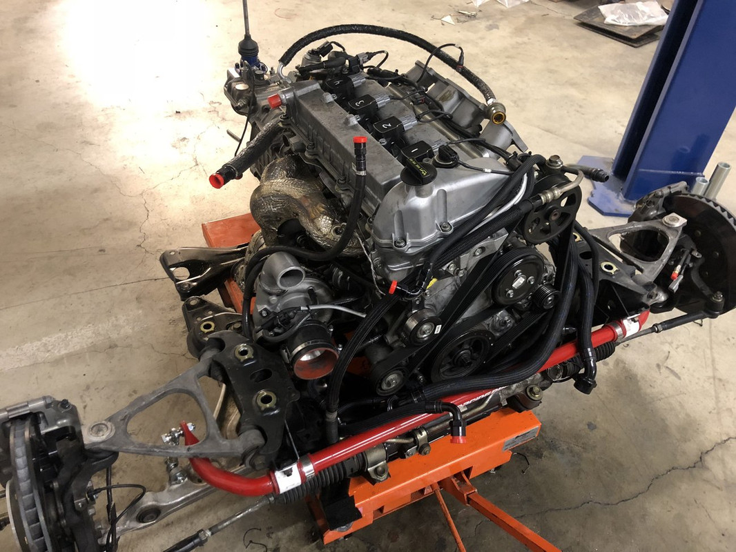

Postby NitroDann » Tue Nov 27, 2018 11:43 am
A bit of porn for NC guys.
david_syd_au
Posts: 935
Joined: Mon Feb 07, 2011 10:27 am
Location: Bilpin, NSW
Re: NC: Who here is interested in a NC RHD Turbo Kit???
Postby david_syd_au » Tue Nov 27, 2018 3:54 pm
So much easier without the brake and steering components on the exhaust side of the engine :-(
2011 NC LE "Black Beauty" (ours) | 2006 NC race car "Shazza" (his) | 1998 JDM NB race car "OMG" (hers) | NC Trailer
Postby NitroDann » Tue Nov 27, 2018 4:11 pm
Easier for me, no difference for you :P
