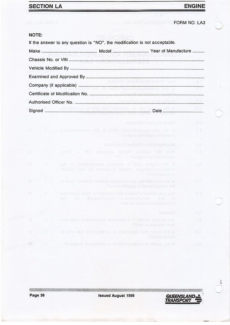

Hi guys, here is the LA3 code as it currently stands.....The game breaker is stated in the section "Modifications which are not allowed under this Code"; Item 2: Fitting of turbo/superchargers to MA and MB category vehicles such as Subaru, Toyota Tercel, Alfa 33 Quattro and sedan car type derivates. Refer to Code LA1 for allowable modifications.
The vehicle category codes MA & MB cover passenger vehicles that includes sedans, station wagons, forward control vehicles etc. MX-5's come under the MA category. The fact that MX-5 owners in Queensland have been able to get their turbo or supercharger installations (I'm not referring to SE, SP or SR20 etc...factory turbo engine substitutions) approved under the LA3 code is beside the point, the point is that the Queensland Approved Person has incorrectly applied the code and as such they now personally carry any risk associated with the flawed approval.
From recent discussions with various stakeholders regarding Queensland's adoption of the National Code Of Practice (NCOP) for Light Vehicle Modifications, there will hopefully be a "legal" way forward for the approval of such modifications through a combination of the LA1 code and the IM240 Emissions Test. I'm not holding my breath though!

NA - LIGHT GOODS VEHICLE - A goods vehicle with a ‘Gross Vehicle Mass‘ not exceeding 3.5
tonnes.
NB - MEDIUM GOODS VEHICLE - A goods vehicle with a ‘Gross Vehicle Mass‘ exceeding 3.5
tonnes but not exceeding 12.0 tonnes.
MC - OFF-ROAD PASSENGER VEHICLE - A passenger vehicle having up to 9 seating
positions, including that of the driver and being designed with special features for off-road
operation. (See Definitions and Vehicle Categories for special features)
So LA3 is mainly for trucks and 4wd vehicles then ;-)
Dang!

gslender wrote:So LA3 is mainly for trucks and 4wd vehicles then ;-)
Dang!
You are spot on, but as I said, there are Approved Persons out there who are prepared to take on the risk for you!
