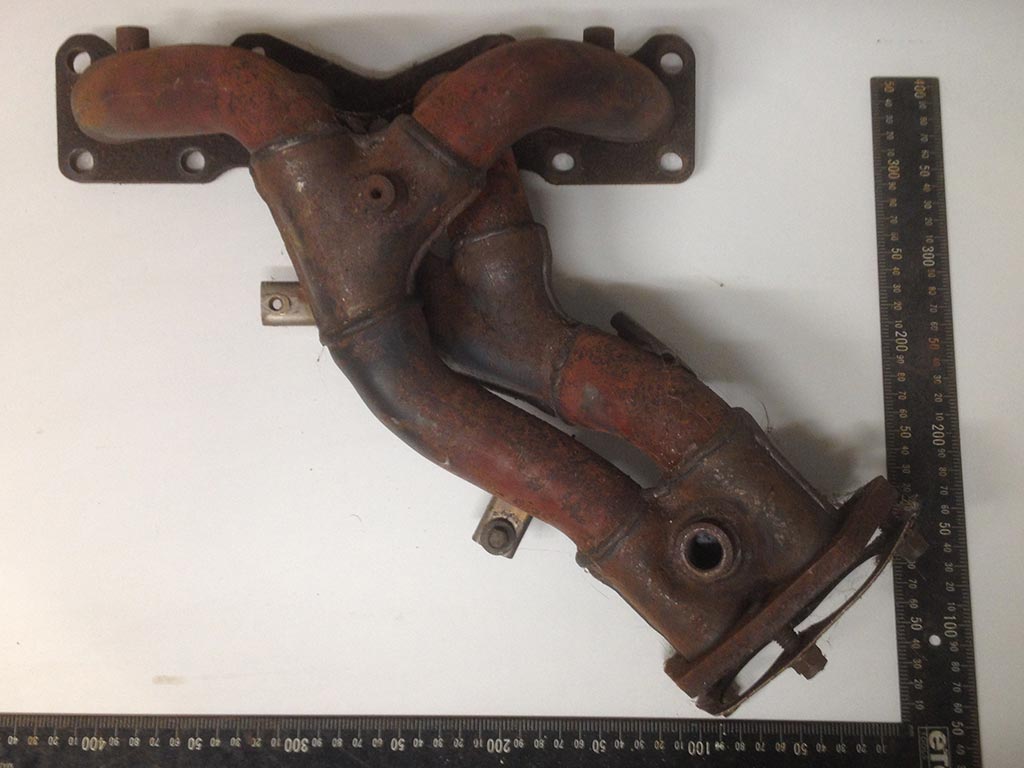

Can you take a pic of the headers on your car, or is there a heat shield covering them? Even if there's a heat shield a pic of the upper & lower parts might still provide enough visibility to identify them.

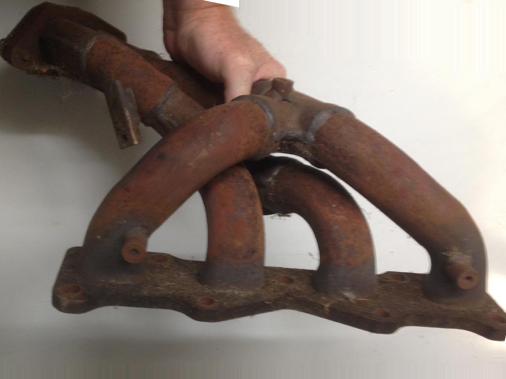

mx5002 wrote:Nb8b onwards got the good headers. So late 2000 (like mine) onwards....
American cast manifold
I know the American early NBs had a cast manifold but I hadn't realise the aussie design had changed when the VVT model was released.
Does anyone have a comparison photo?

ADM NB8B headers:

Very cool thanks for the photo.
