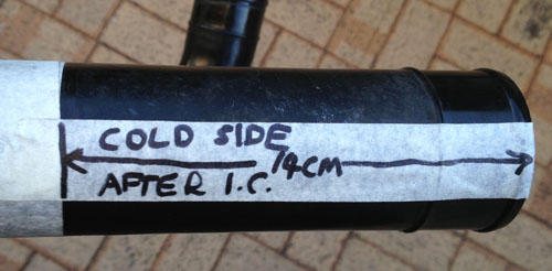

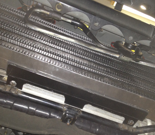

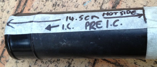

Tube & Fin intercooler 710mm x 180mm x 64mm
Cut the stock IC pipes down
Now it's all in place I think if I did it again i'd only chop 13cm off each one to begin with and see if that'd do.
The powersteering lines are a huge PITA.
I created a bracket using the factory mounts to support the intercooler.
