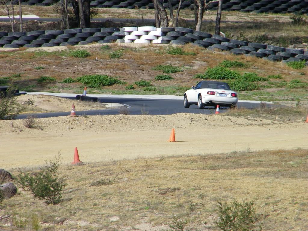

Image - Me at MDTC, and no I didn't catch that spin! :mrgreen:
