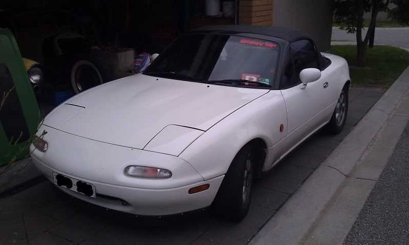

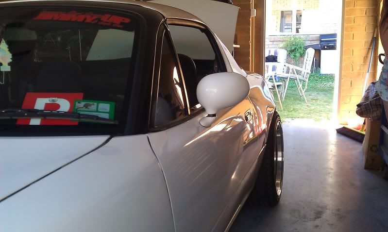

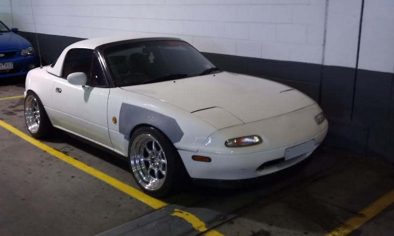

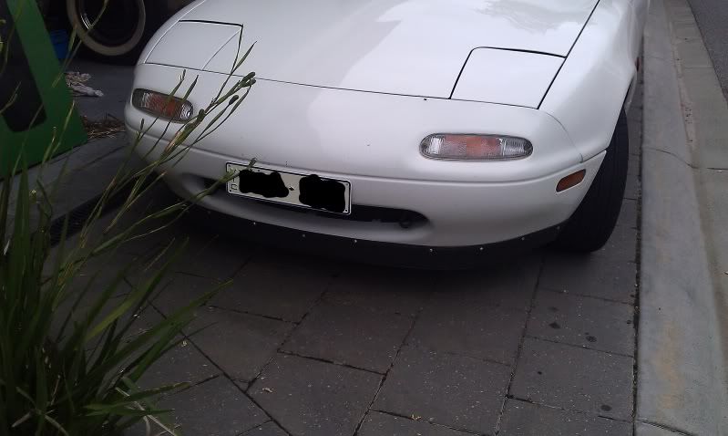

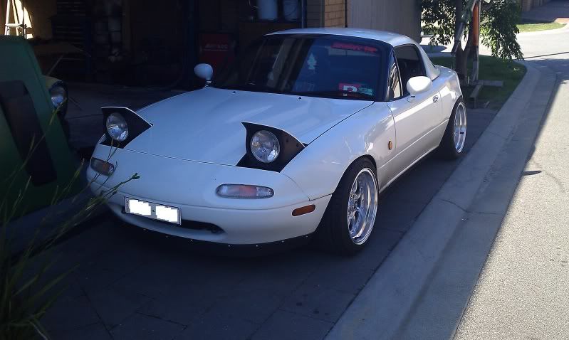

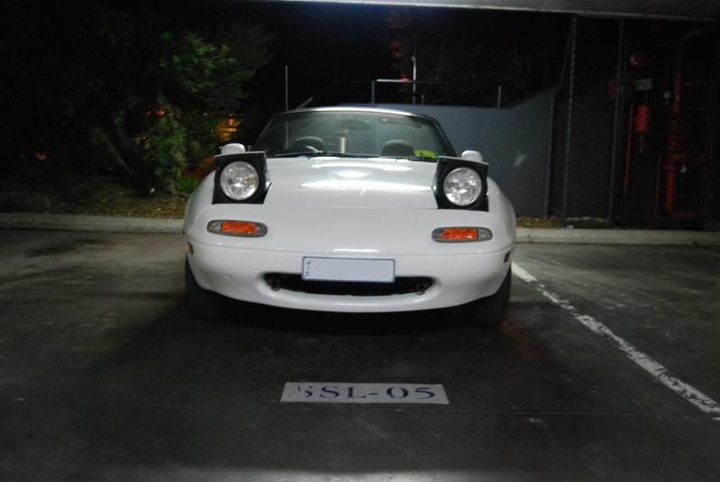

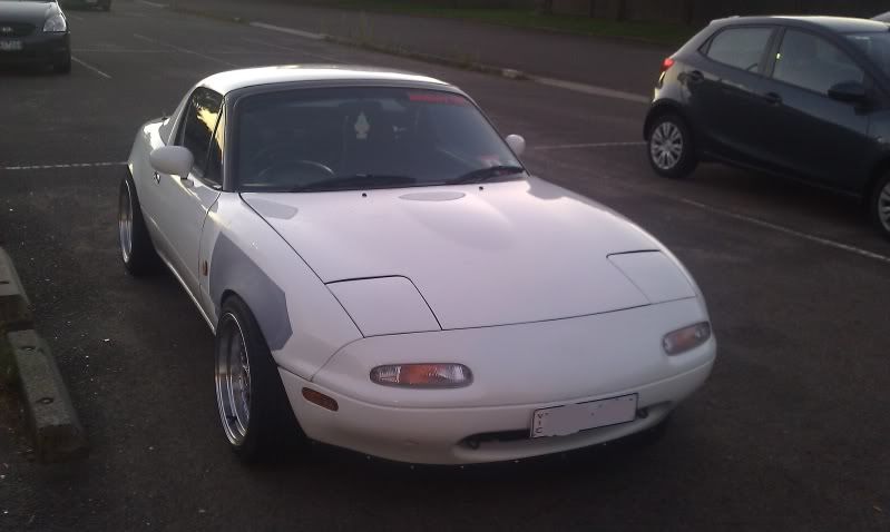

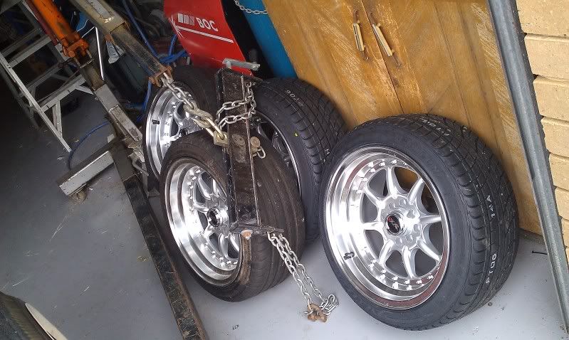

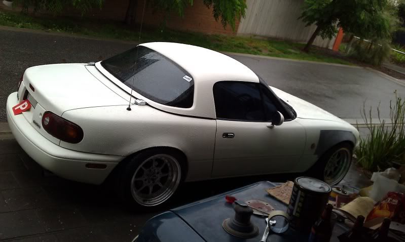

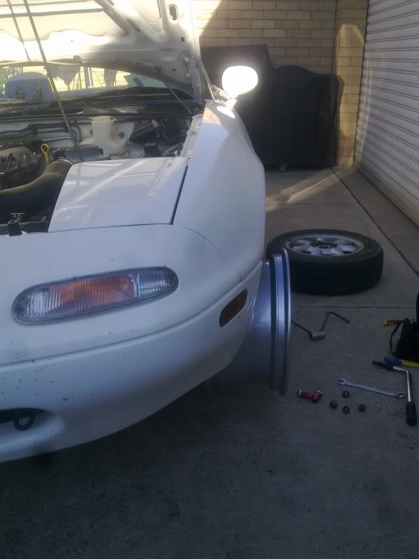

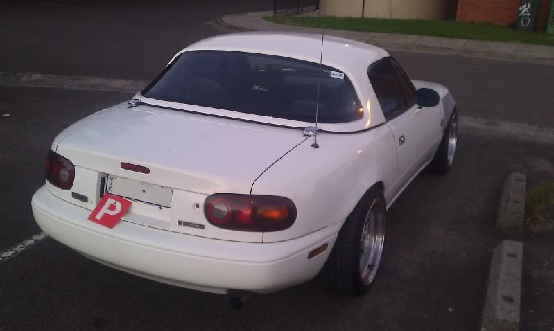

Hey guys currently building my mx5 for drift so far its coming along to plan :)
1990 NA Mazda MX5
modications so far

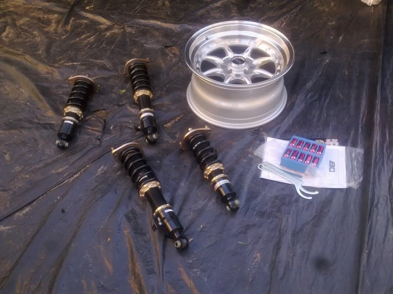

- Bc br type coilovers
- Twin Core radiator
- 16x8-+0 sportmax Xxr wheels
- ebc ultimax pads allround

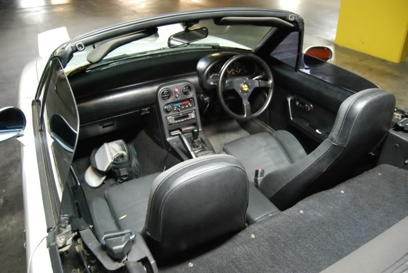

- nismo shifter
- nardi deep corn 350mm wheel
- Tyres
Front: saliuns (sh*t i know) 205-45-16
rear continentals 205-45-16

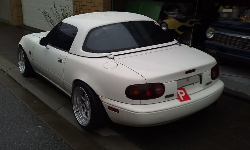

-oem hardtop
-garden edging front lip

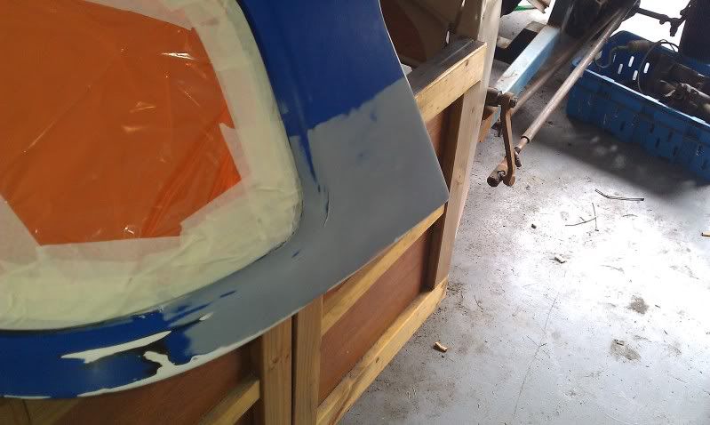

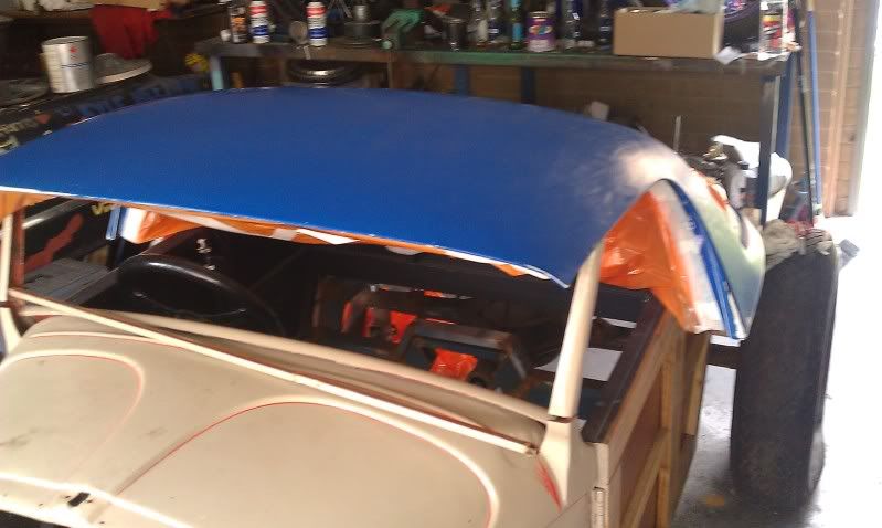

so far body wise ive pulled all 4 gaurds out fronts about 20mm and rears about 15mm ive lightweight filled them and primed them ready to go also fixed a couple of little marks in the rear qaurter
future plans are:
- bigger sway bars
- the big brake kit
- drivers side bride fix back
- half cage
- adjustable suspension arms
- jap wheels (equips longchamps or hoshinos
- a turbo conversion of some description trying to decide wether to turbo the 1.6 or try and track down a 1.8 or 2L motor get it built for turbo ect.
- 2 way diff
-hyrdaulic handbrake (stock one sucks!)
anyway heres some pics!

Very nice! My car is going to look very similar to yours in the end :)

Looks like a great project.
Have you considered using wheel arch fenders? It might go with the theme of your build and keep those wheels tucked under.

yeh ive considered it but at this stage i want to be able to not run them quite yet but if i decide to pull some camber out at anystage itll probaly be the go
