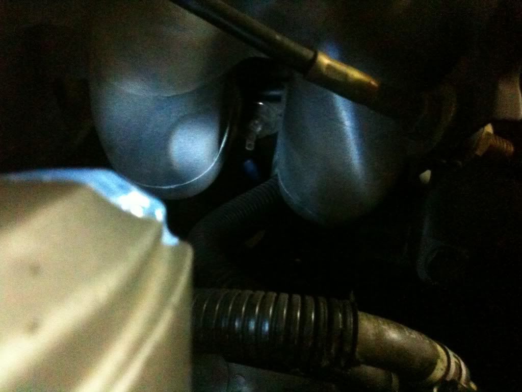

Okay now for the issue i am having and hoping someone can chime in. The oil pressure gauge is on drugs or something.... it reads fine about 70% of the time, the other 30% it dances around like a raver and sometimes drop to 0 when idle at lights.. :shock: Now i know its got oil, its flowing, but wtf is the gauge doing.... A quick search on here suggests its a dirty or rusty terminal on the sender!??!?! This sounds right? If so where the fark is the this terminal / sender?? LOL Any tips would be bonzer!

The sender is just above the oil filter.. If you can somehow get a light and look down there, you'll see the wire running to the unit.
It's a royal pain to get to!!

Heres a dodgy pic i found that i took when i had sender issues on my old na6.
if that helps at all :roll:

Thanks Dweezle thats perfect!! Will have to get under there ASAP but yep looks to be in a dog of a spot!! :shock:
