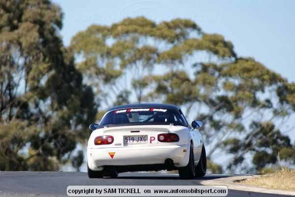

Got the paperwork all sorted and put the finishing touches on the car in readiness for it's first race meeting. I'd entered the 1 hour race at Morgan Park, which was part of the Shannons National meeting, as I thought this would give me plenty of time behind the wheel to test the setup and get a feel for the car.
All went well and I finished the weekend without a hitch, well except for the horn button that fell into my lap about two thirds of the way through the 1 hr race :)
Heres a photo from that weekend:

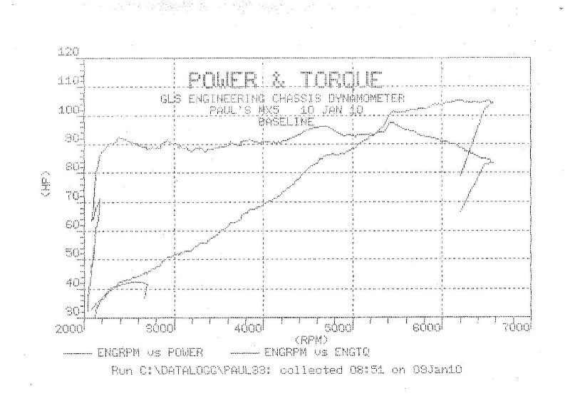

After that meeting I fitted a new Cooling Pro radiator, Haltech Platinum 1000 ECU and a 4.3 Torsen rear diff. Once again slack with the camera, so no photos :(
Had it on the dyno to tune the Haltech and it made an impressive 98HP at the rear wheels :D

I've just recently done a coolant re-route, fitted a shift light, removed the standard airbox and made a new intake. Had it back on the dyno and made another 7hp, making it 105hp at the wheels :)

TCR wrote:After that meeting I fitted a new Cooling Pro radiator, Haltech Platinum 1000 ECU and a 4.3 Torsen rear diff. Once again slack with the camera, so no photos :(
98HP = 73kW doesn't seem to me all that impressive for a chipped NA8 :? . What was the timing set at? My stock NA6 pulled 71kW at MX5 Mania with 14 degrees timing. :D

Postby SKYHI » Tue Jan 12, 2010 4:54 pm
Timing is at 14 degrees BTDC.
Different dynos, different days, they'll all produce different numbers. Probably about 28 degrees last Saturday when the runs were done. 140,000ks on the engine, so it might be getting a bit tired.
105hp (78kw) @ 6300rpm
