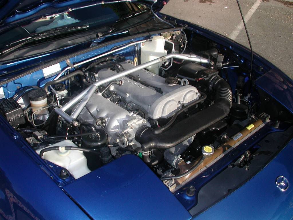

OMX-596
Vehicle Specifications
Vehicle: Mazda MX-5 (NA6)
Year: 1989 (1996 - VR Ltd Type B Specifications)

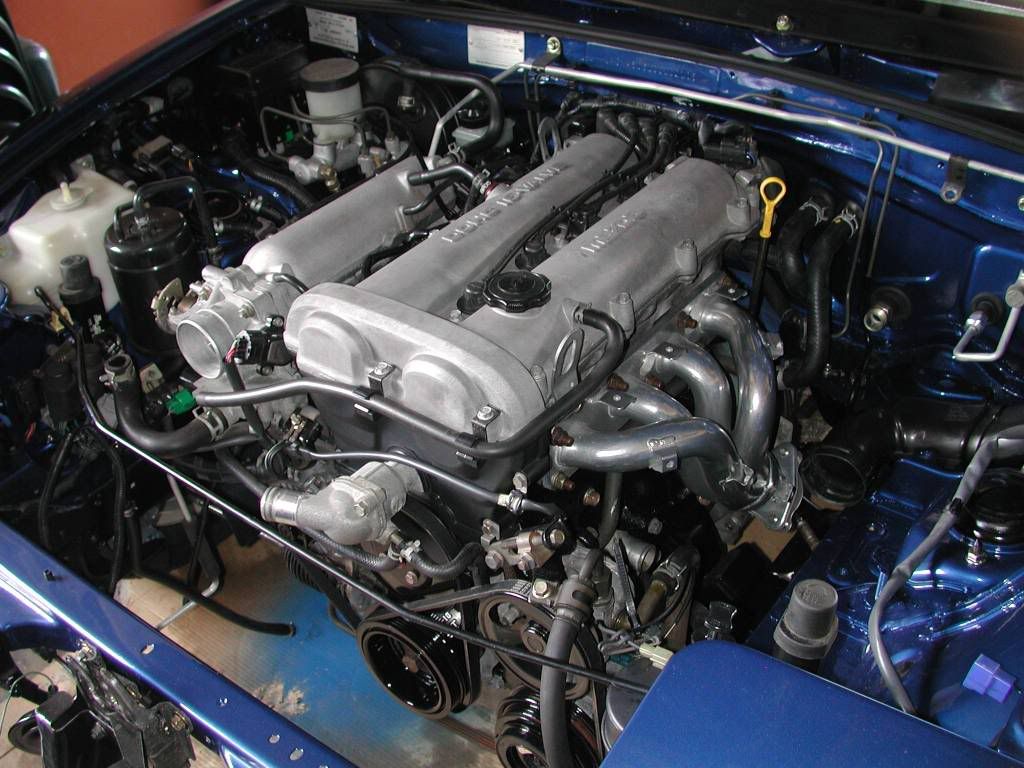

Engine: 1996 Eunos Roadster 1.8 litre (BP) Engine
Induction: Jackson Racing M45 Supercharger Kit - 6 psi pulley
Gearbox: 2001 Mazda Roadster 6-speed
Differential: 1996 Eunos Roadster 4.3:1 Torsen LSD
Suspension: Tein Flex
Sway Bars: NB8B 22mm Front & 14mm Rear
Brakes: 1996 Eunos Roadster Front & Rear
Brake Pads: Bendix Ultimate
Road Wheels: BSA 214 CP 17 x 7
Road Tyres: Crappy Federals in 205/40 R17
Track Wheels: BBS RGF 15 x 7 - 33P offset
Track Rubber: Toyo 888 in 205/50 R15
Exhaust: MX-5 Plus 2.25" Stainless System including Xforce extractors
Engine Management: Megasquirt PNP
EFI Fuel Pump: Standard
Roll Over Protection: MX-5 Plus Single Hoop Torque Box Roll Bar

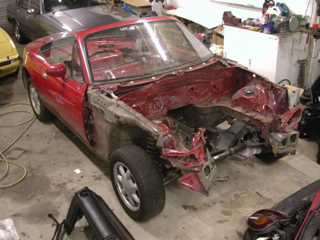

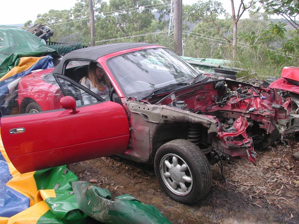

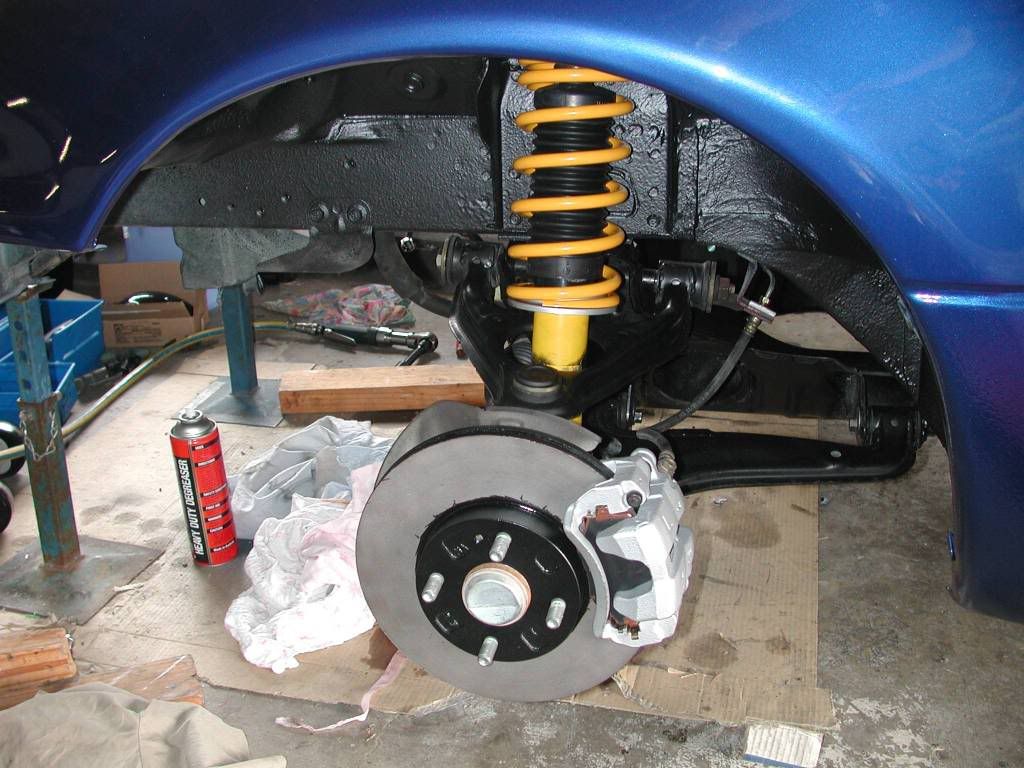

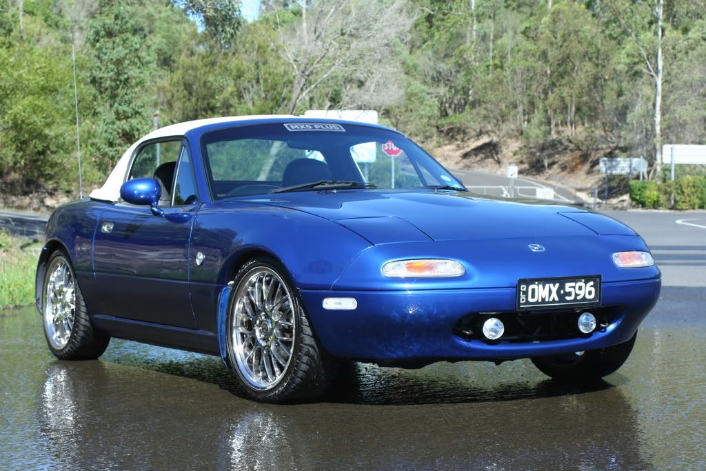

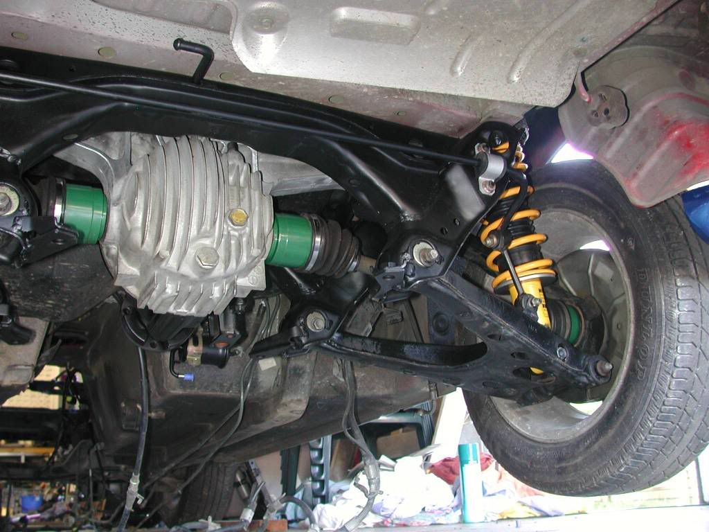

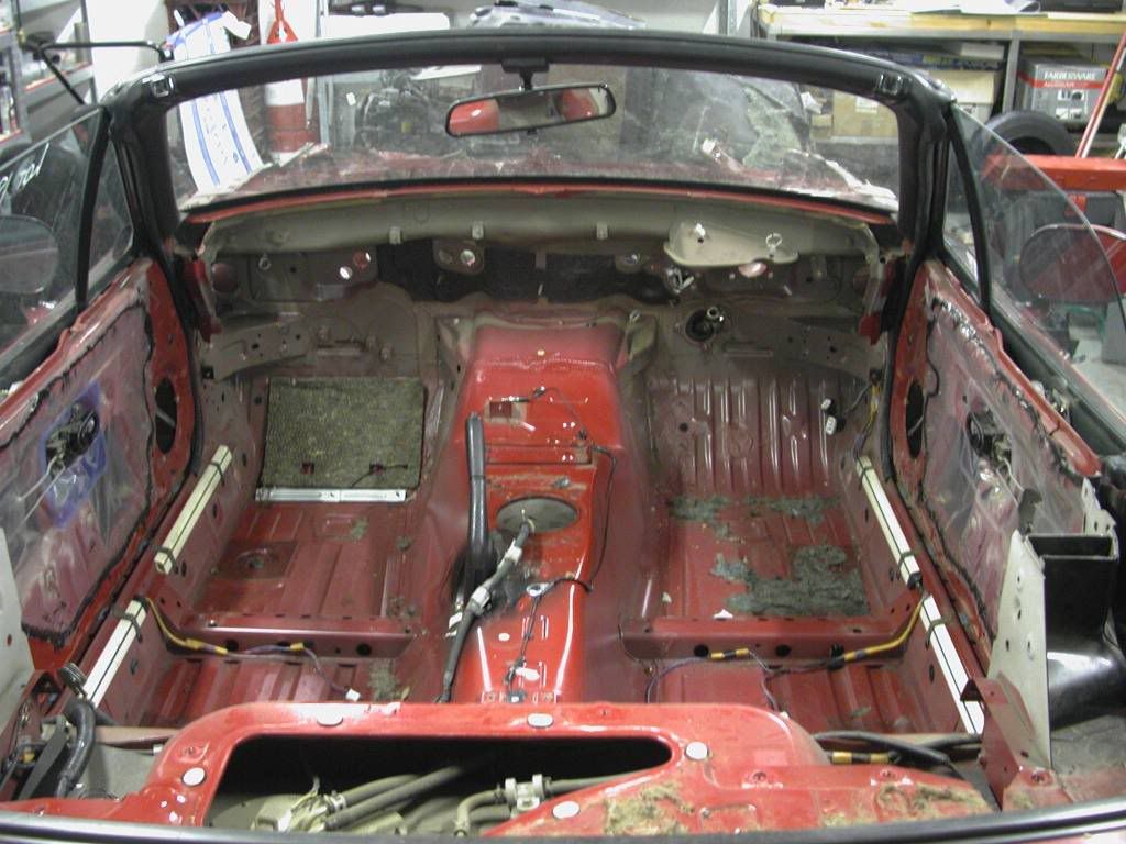

Started life as this.....circa 2003 (6 month build from start to finish)

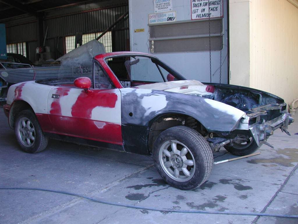

Then progressed to this....

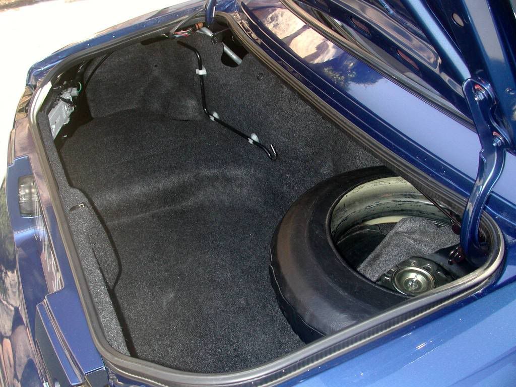

And finshed up as this............

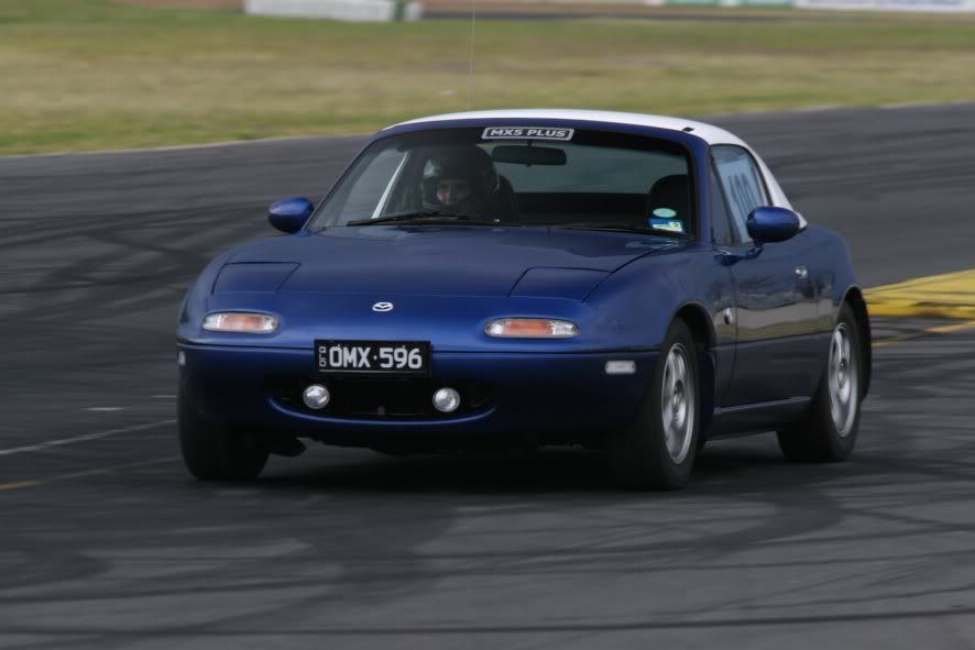

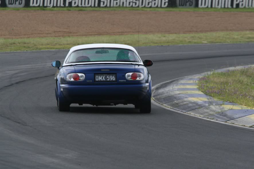

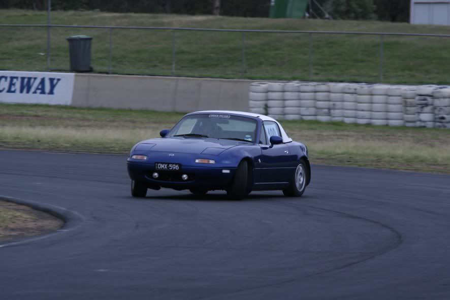

Racing piccies

I can't believe it has been 5 years since I restored her! It was my first MX-5...others have come and gone (not all going mind you), but this one is staying 8) .

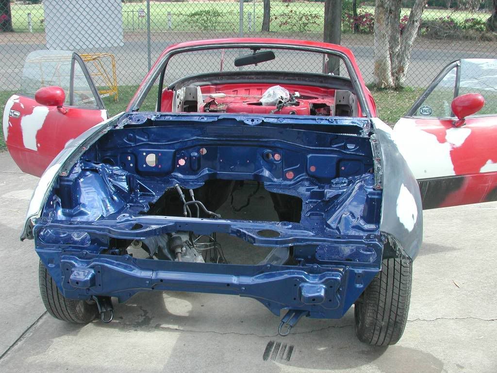

It was a pretty big job...stopped counting the hours I spent on the job....it was well over 600 hours!
She was stripped back to a bare shell with no wiring and only essential fasteners. The rear loom in the bottom photo was also removed. The fuel tank was changed out for the 1996 one after the paint job.

So did your mechanical engineering background help any in the rebuild? :mrgreen: Tre cool monsieur Danny.
Check out how flat the cornering and drifting attitude is ... superb.
The corner you drifted looks like the last turn at QR?
But what about the right-hander (back of car shot)? 2nd corner at QR? If you were hard at it, that is a 100km/h+, open-90deg radius, turn (in an MX-5) boys and girls :D

Postby orx626 » Tue Feb 12, 2008 9:42 am
1red5 wrote:The corner you drifted looks like the last turn at QR?
Indeed 8)
1red5 wrote:But what about the right-hander (back of car shot)? 2nd corner at QR?
Pretty sure that's turn 1 Andrew. Corner speed was between 135 and 140 kph.
