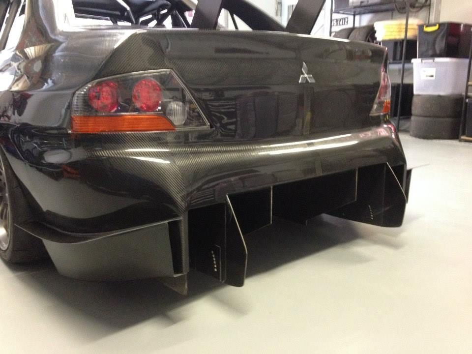

Why do the cuts in the rear quarter panels have two smaller slots on one side and a continuous slot on the other? Not critiquing just genuinely interested! Not enough clearance to angle it in from below due to the other (fuel or oil system) bracket?

Me too. This is an example of the composite work quality of the guys who are executing my aero package. A former F1 engineer was recently heard saying that their composite work is the best he has seen in Australia to date. That gets me rather excited.

timk wrote:Not enough clearance to angle it in from below due to the other (fuel or oil system) bracket?
Nailed it! :mrgreen:

its a low res pretty noisy pic but man that looks like some really high quality work.
anyone who has attempted any composite work will appreciated just how hard it is to get a finish half that good.

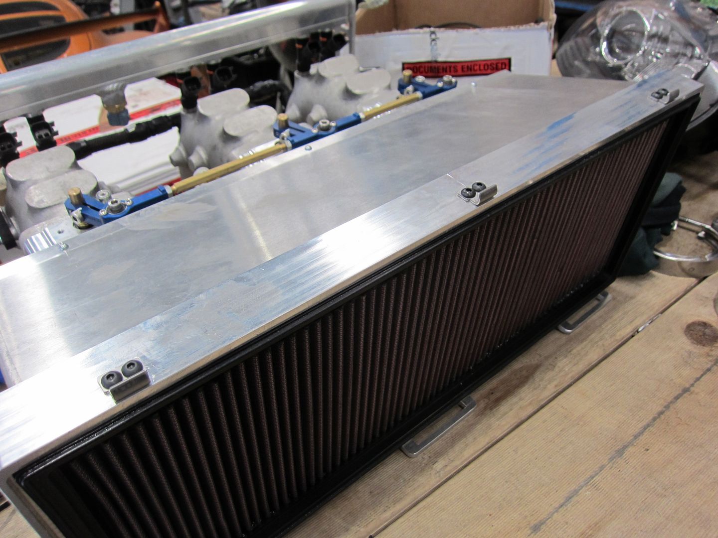

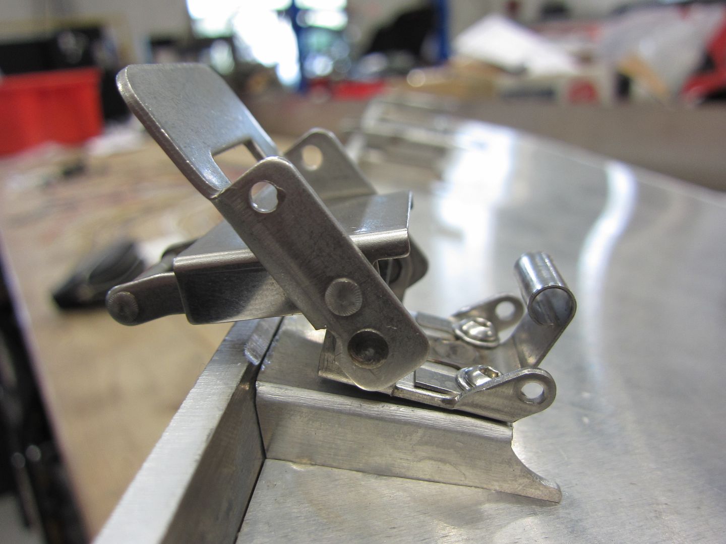

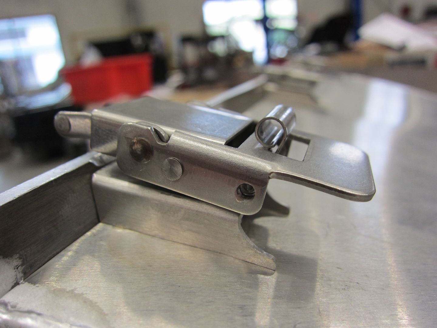

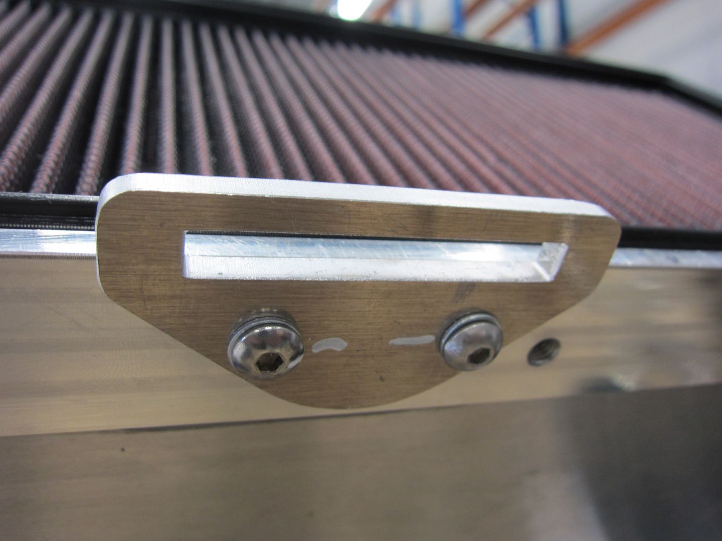

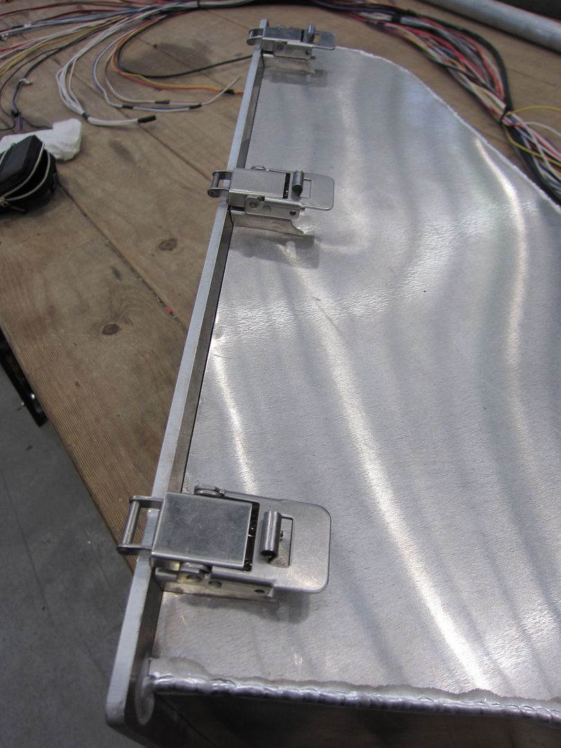

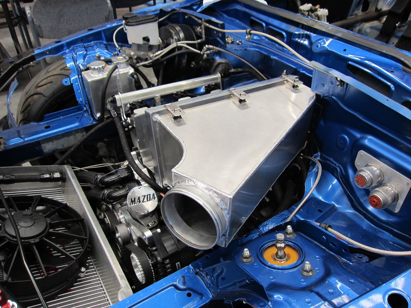

The intake airbox was finished this week with the latches added to the removeable section.

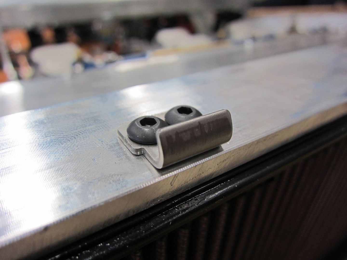

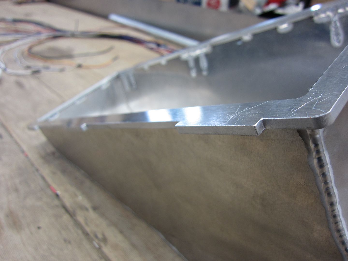

The locking tab pockets were added to the fixed section of the intake.
The catches were attached as well.

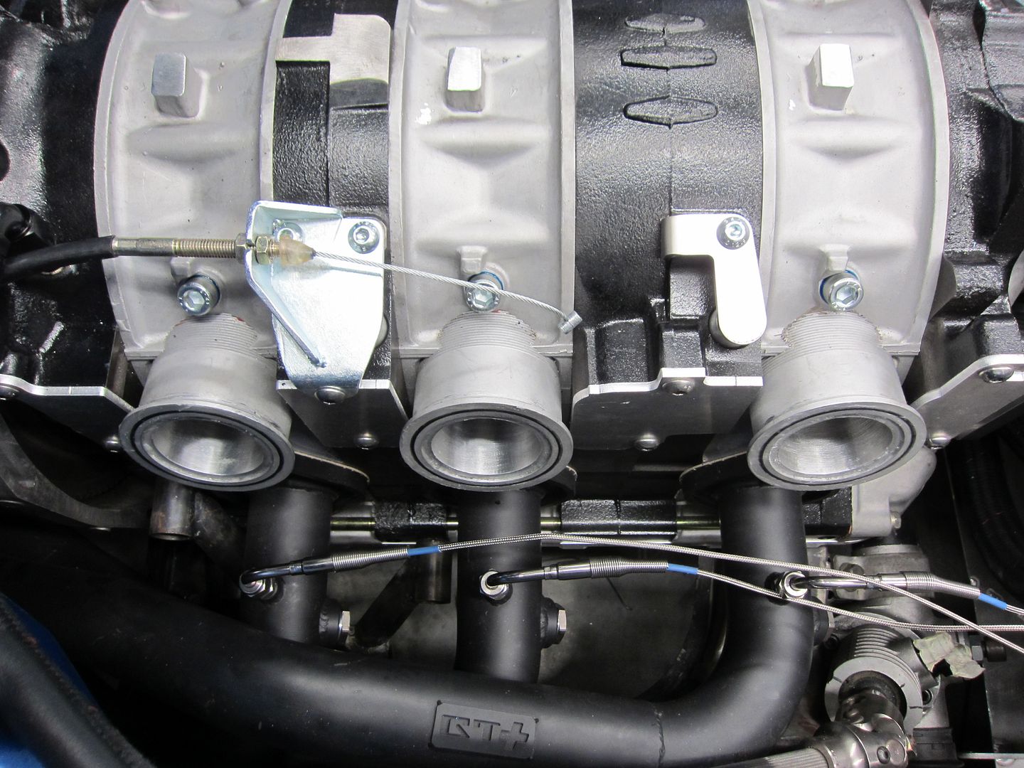

The throttle cable bracket/injector plug retainer was zinc plated and fitted.
....and ta-da!!! 8)

Postby 16bit » Sat Jun 28, 2014 6:22 pm
so much awesome.
i love how you have got practicality and looks to work together with the intake.
