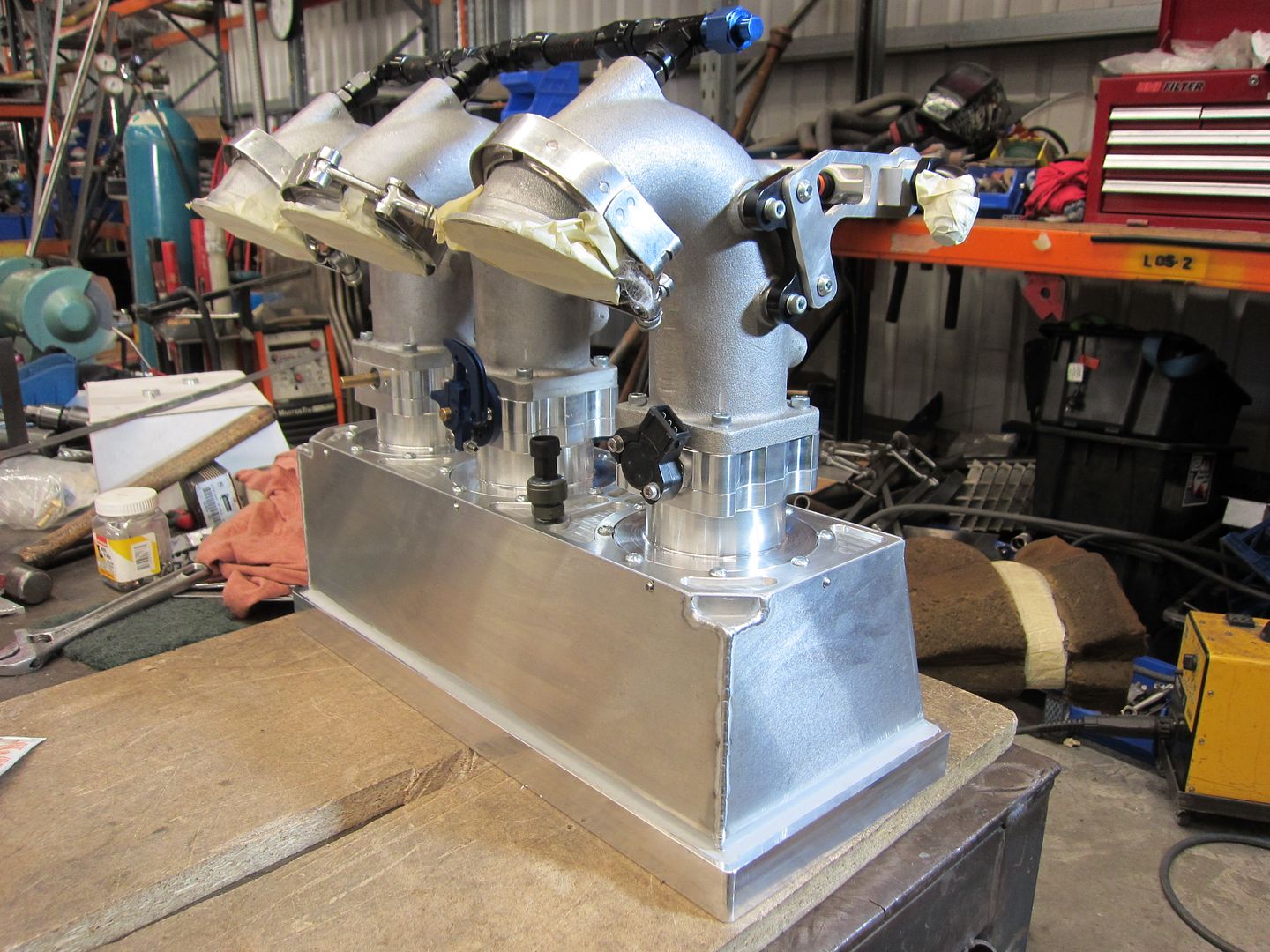

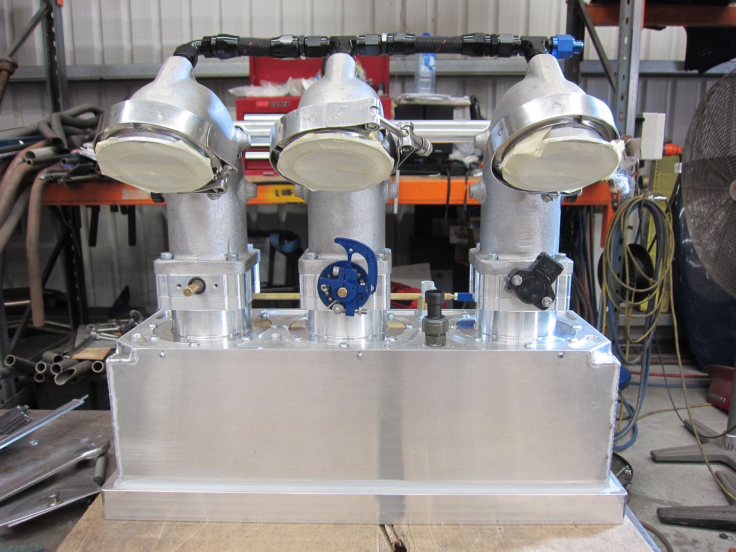

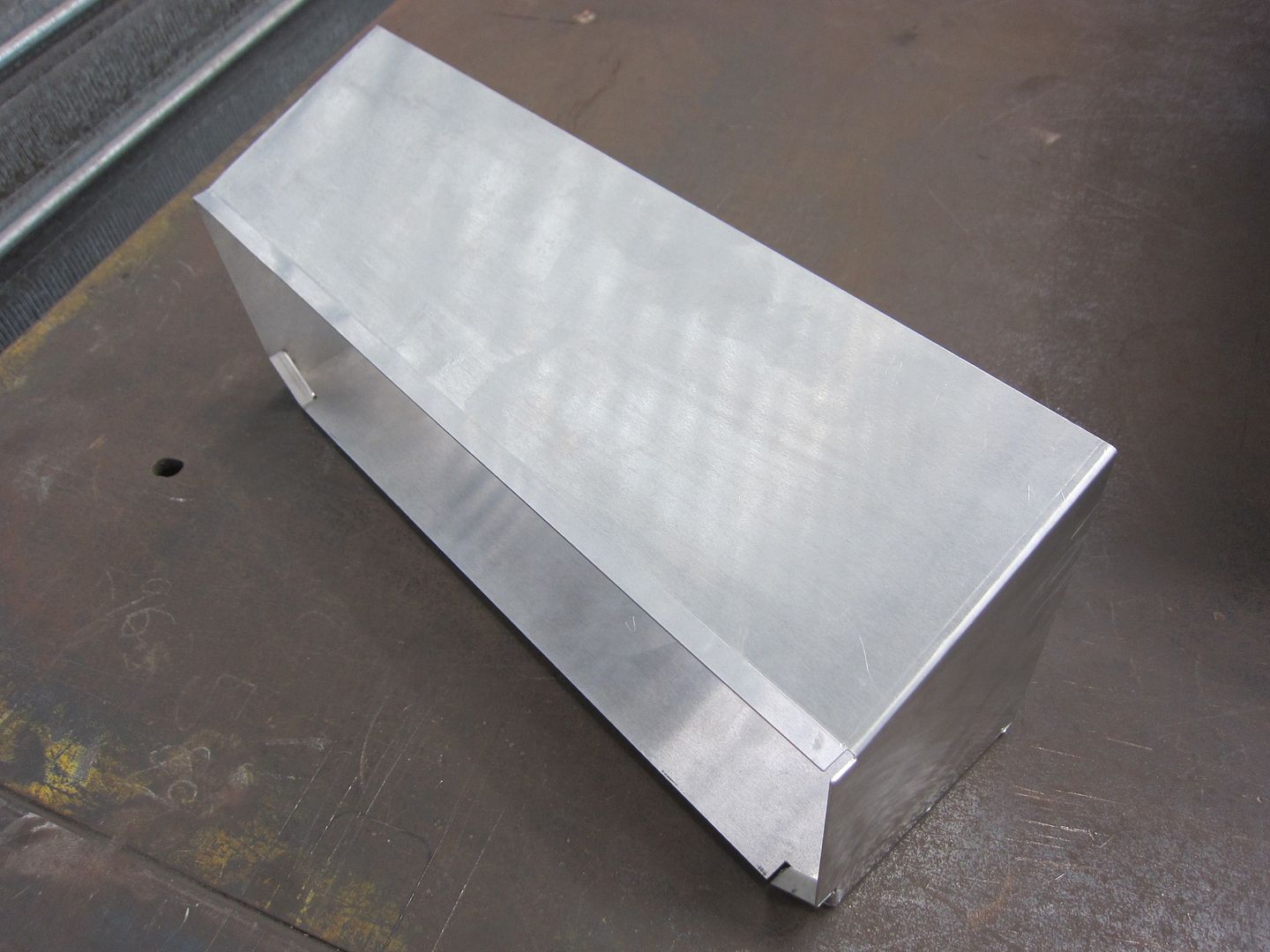

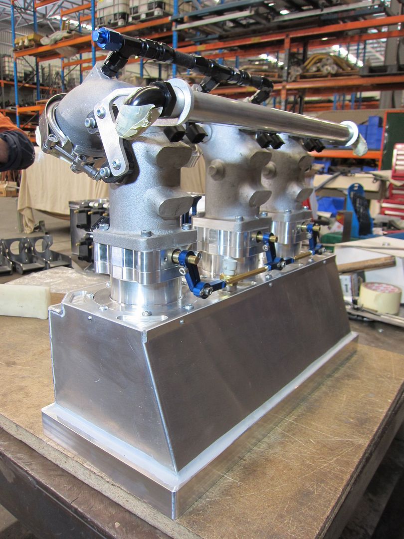

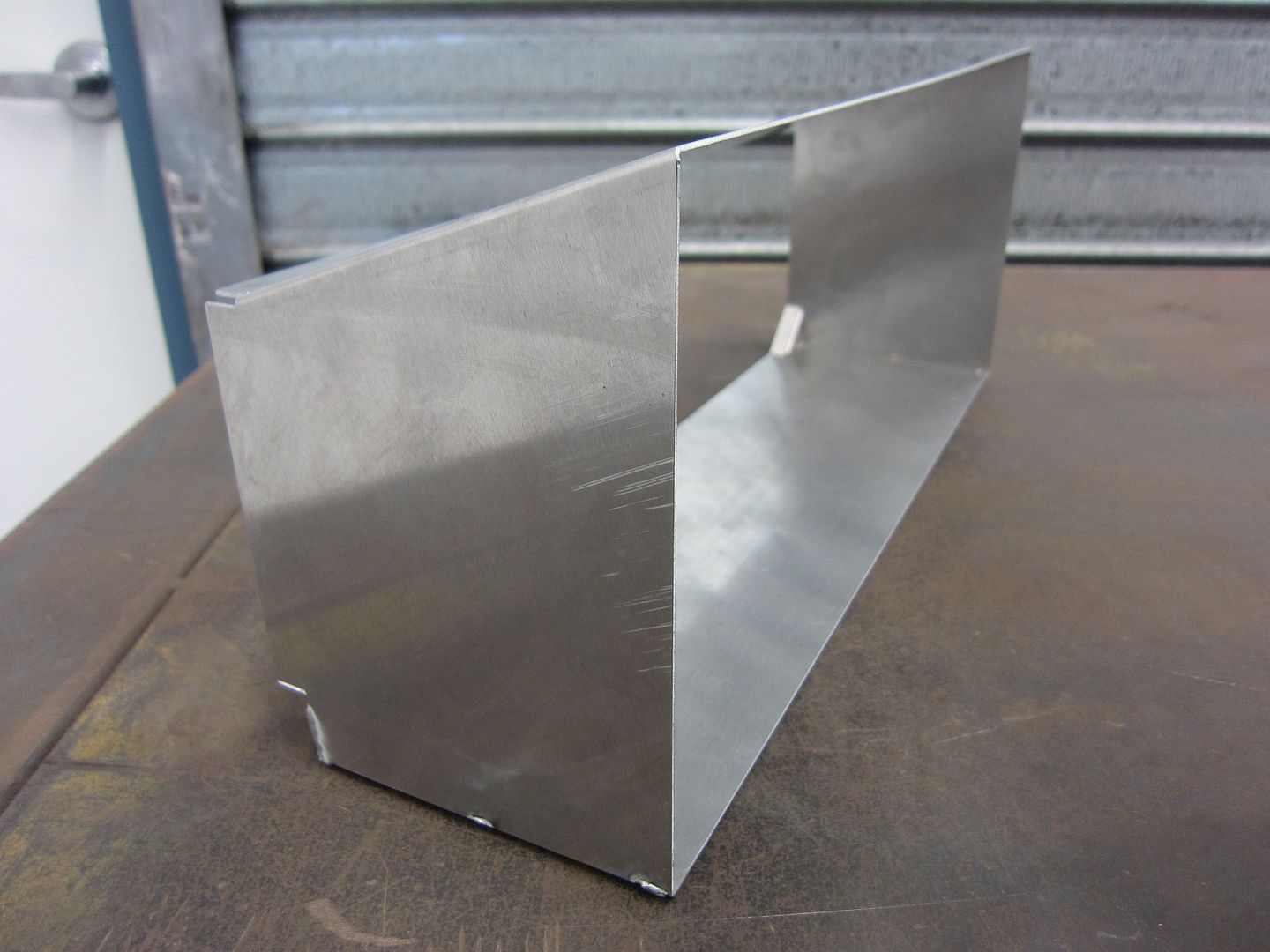

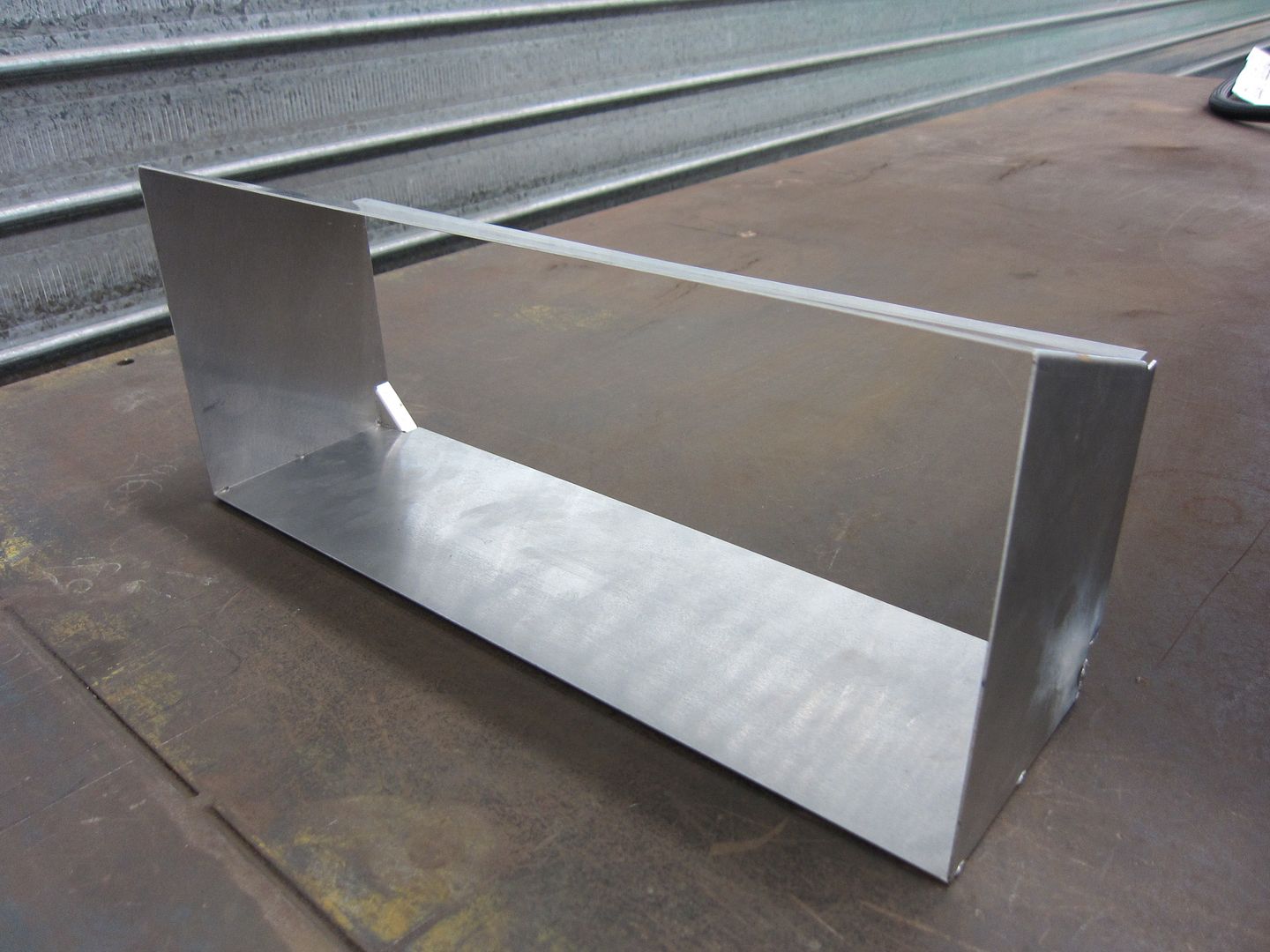

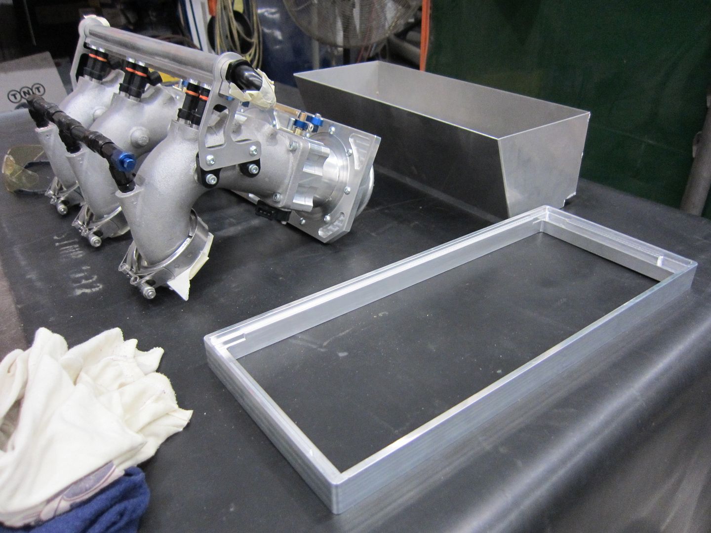

This is the air box outer shell.

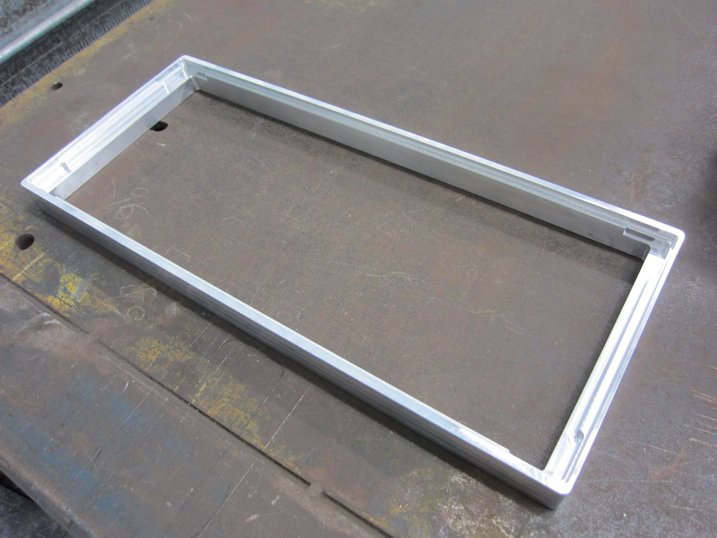

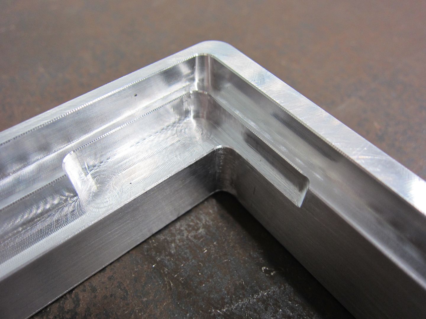

The panel filter flange plate that attaches to the airbox shell was milled from a piece of 30mm think aluminium billet.
The inside profile is a negative of the panel filters urethane flange.

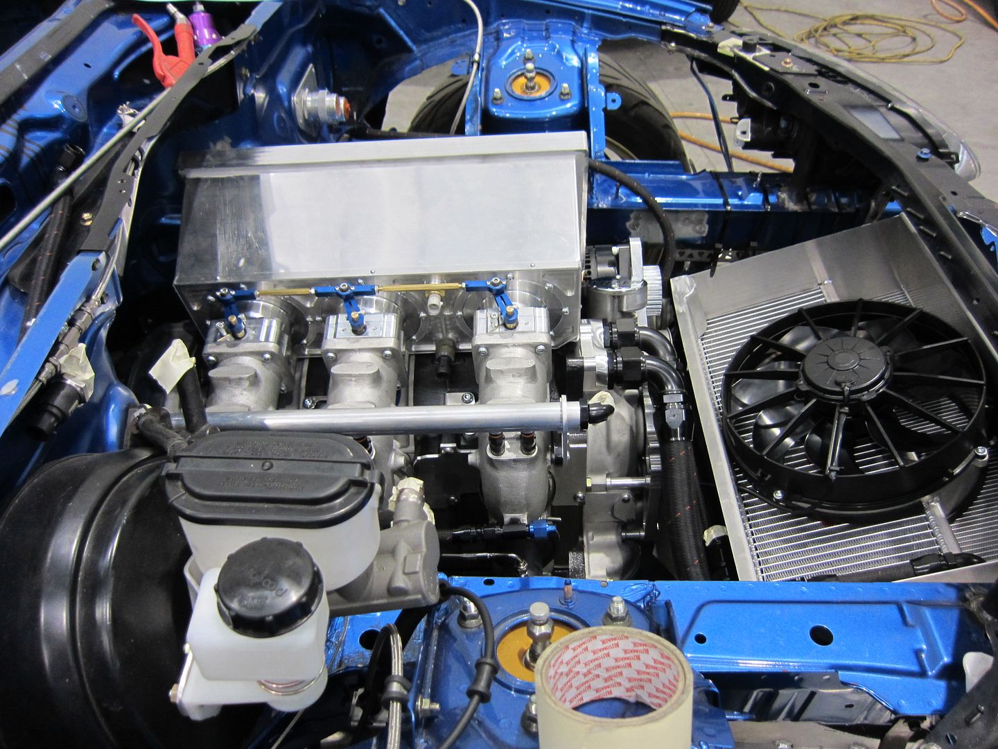

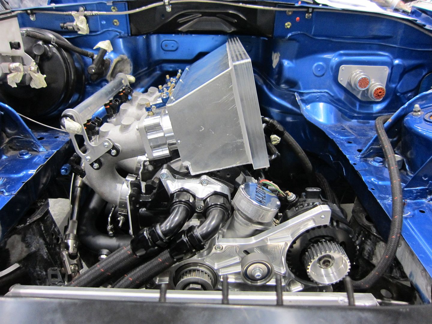

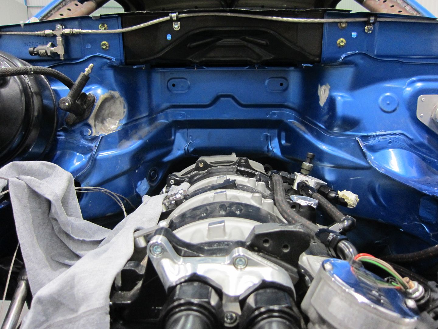

For the airbox to attach to the throttle body flange some minor modifications to the engine body were required....just a bit of die-grinding here and there. :P
With the inlet manifold removed it really highlights how low the engine is positioned in the chassis. It's just below the top flange of the chassis rails. :mrgreen:

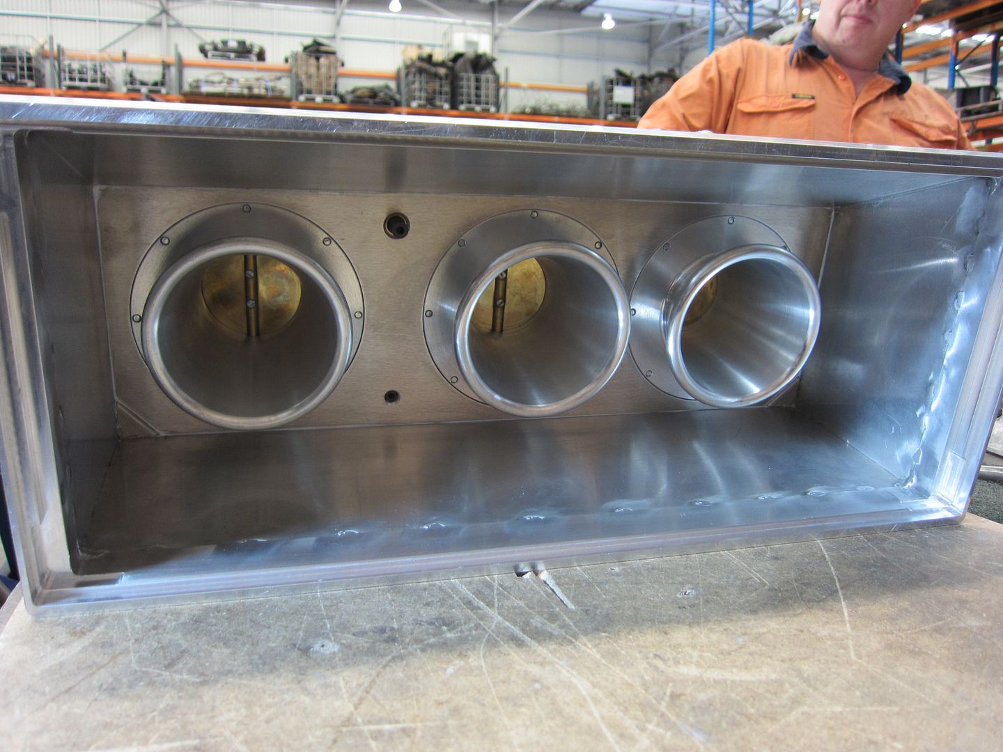

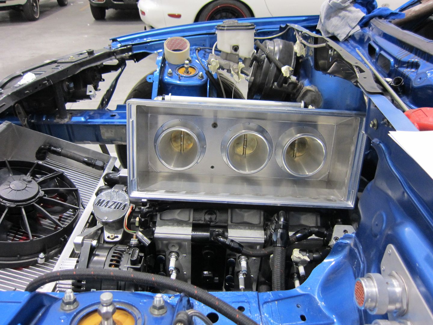

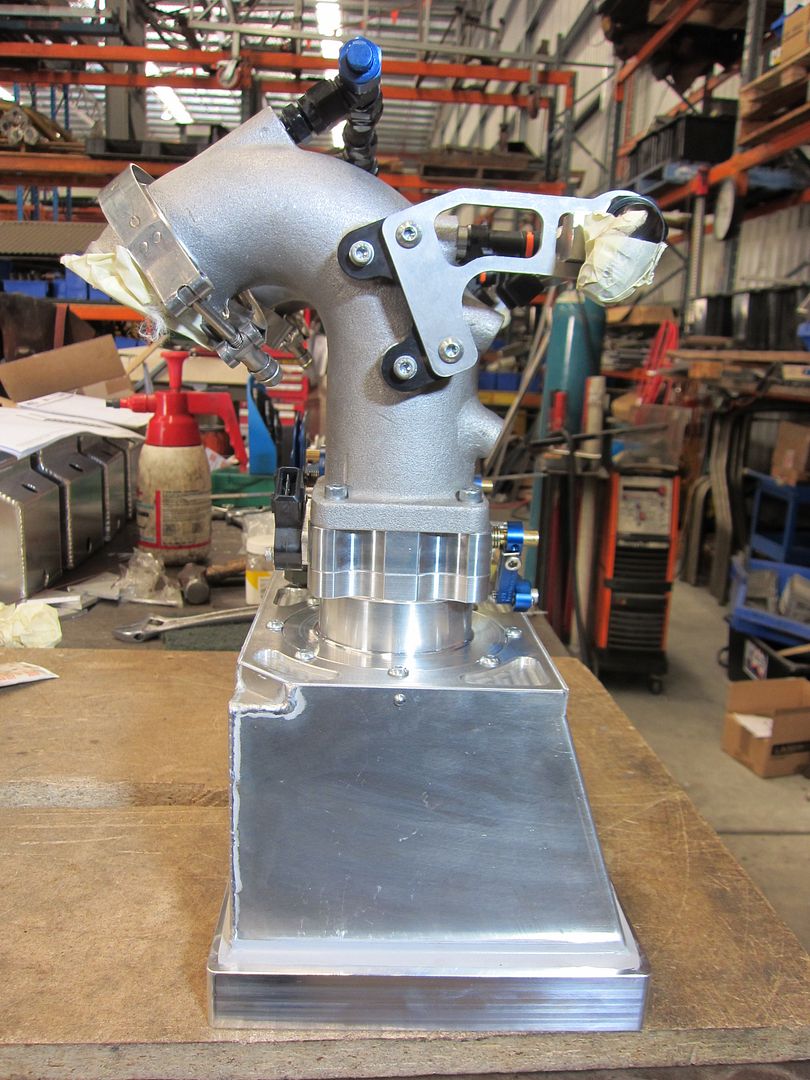

Time to assemble the fixed section of airbox.
.....and ta-da!! The shell was glued (Sikaflex) and attached with drive pins.

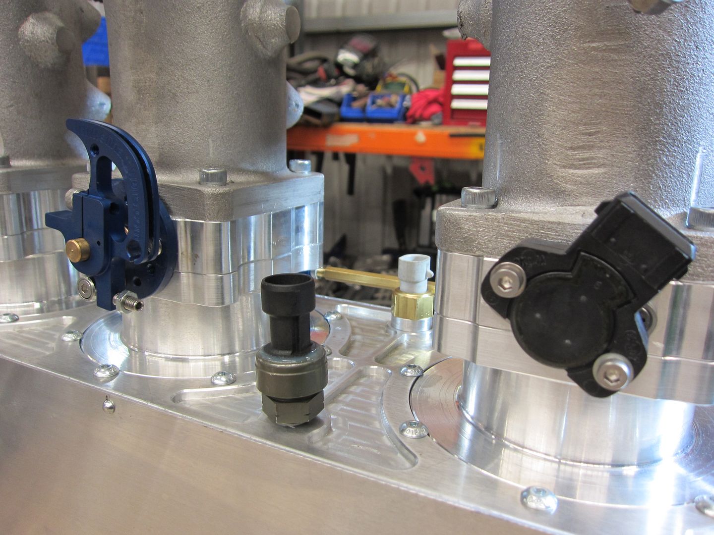

It was also a good opportunity to drill and tap the throttle body flange plate for the air temperture and air pressure sensors.

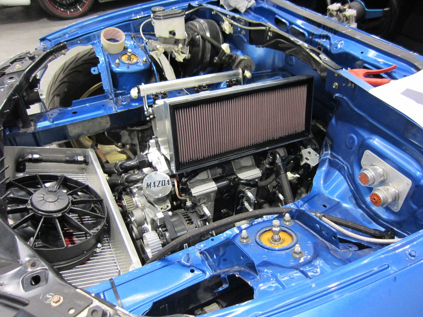

....and back on the engine. 8)
With and without the panel filter.

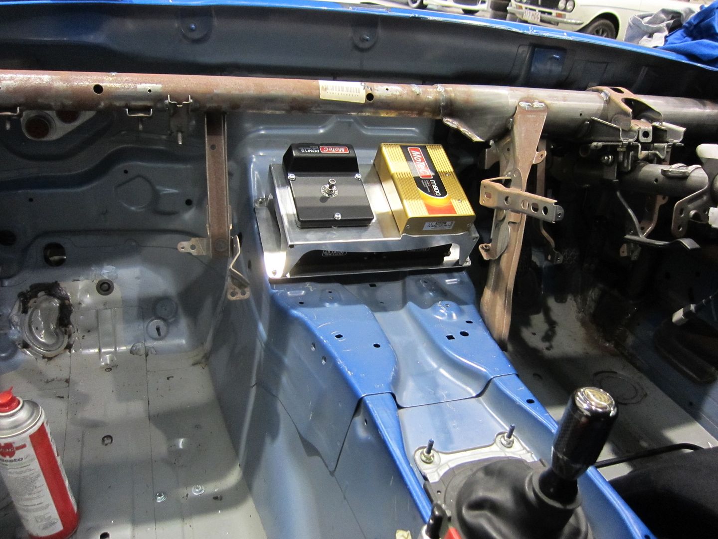

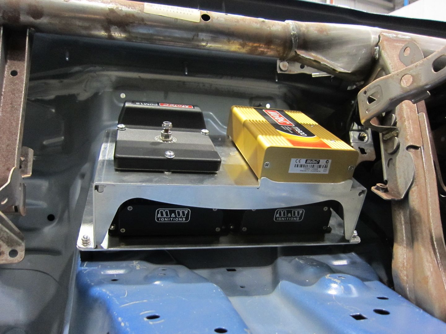

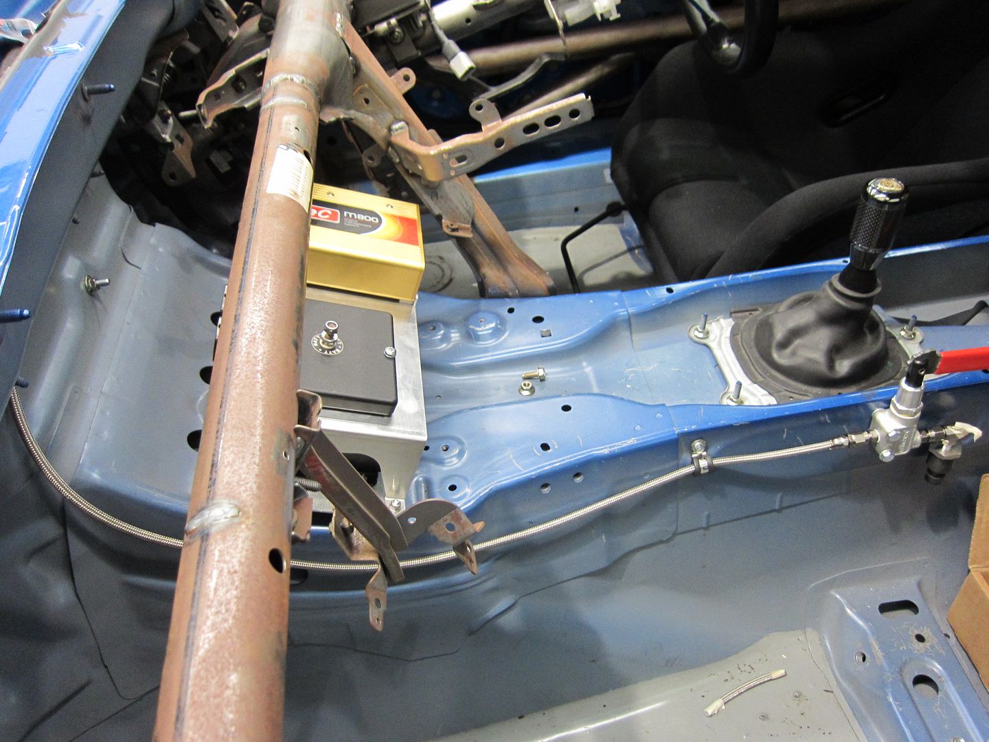

Other work that was completed was the installation of the ECU, PDM and ignition module assembly....

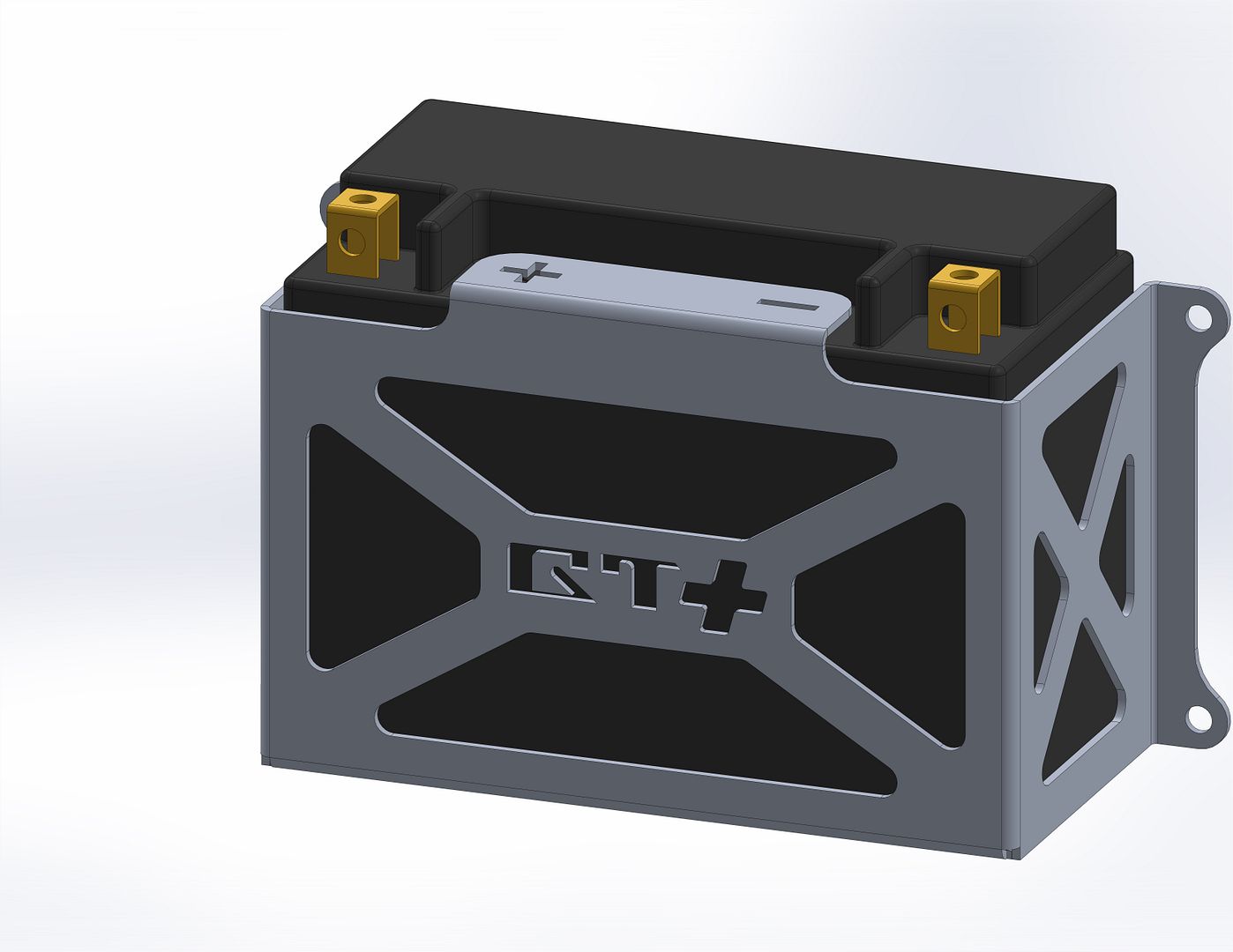

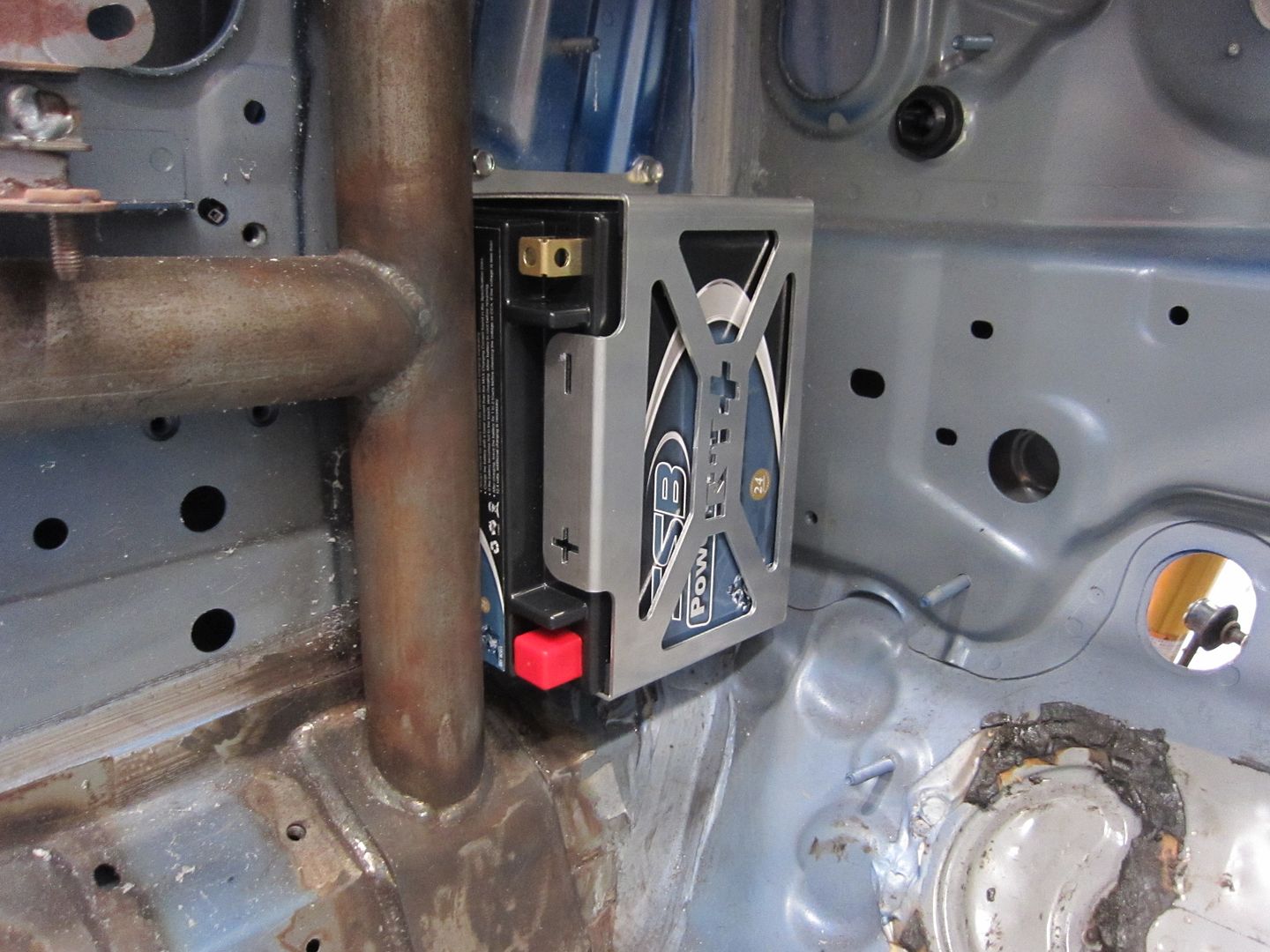

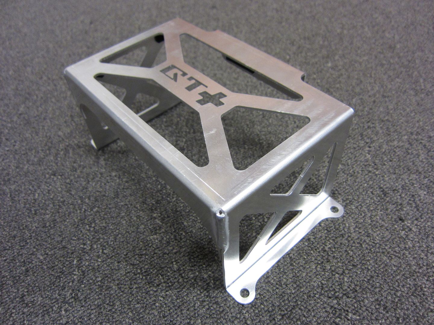

...and the design of the battery mounting bracket.

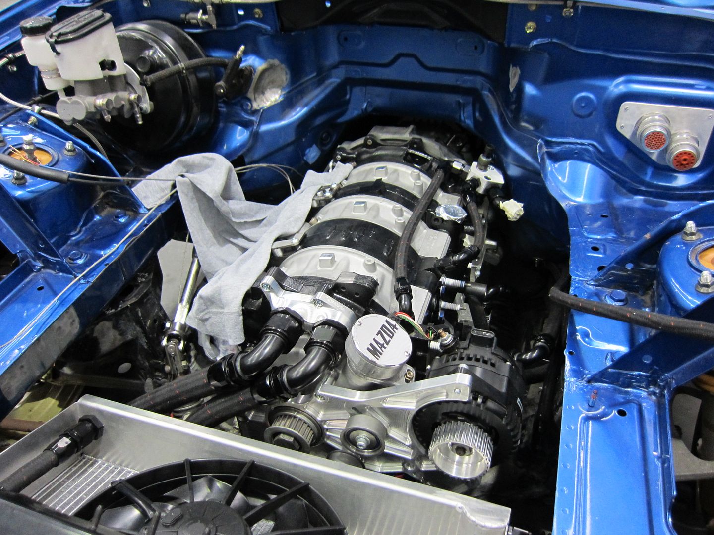

Well the beginning of May has seen quite a few items ticked off the list as we inch closer to firing the 20B up for the first time. :twisted:

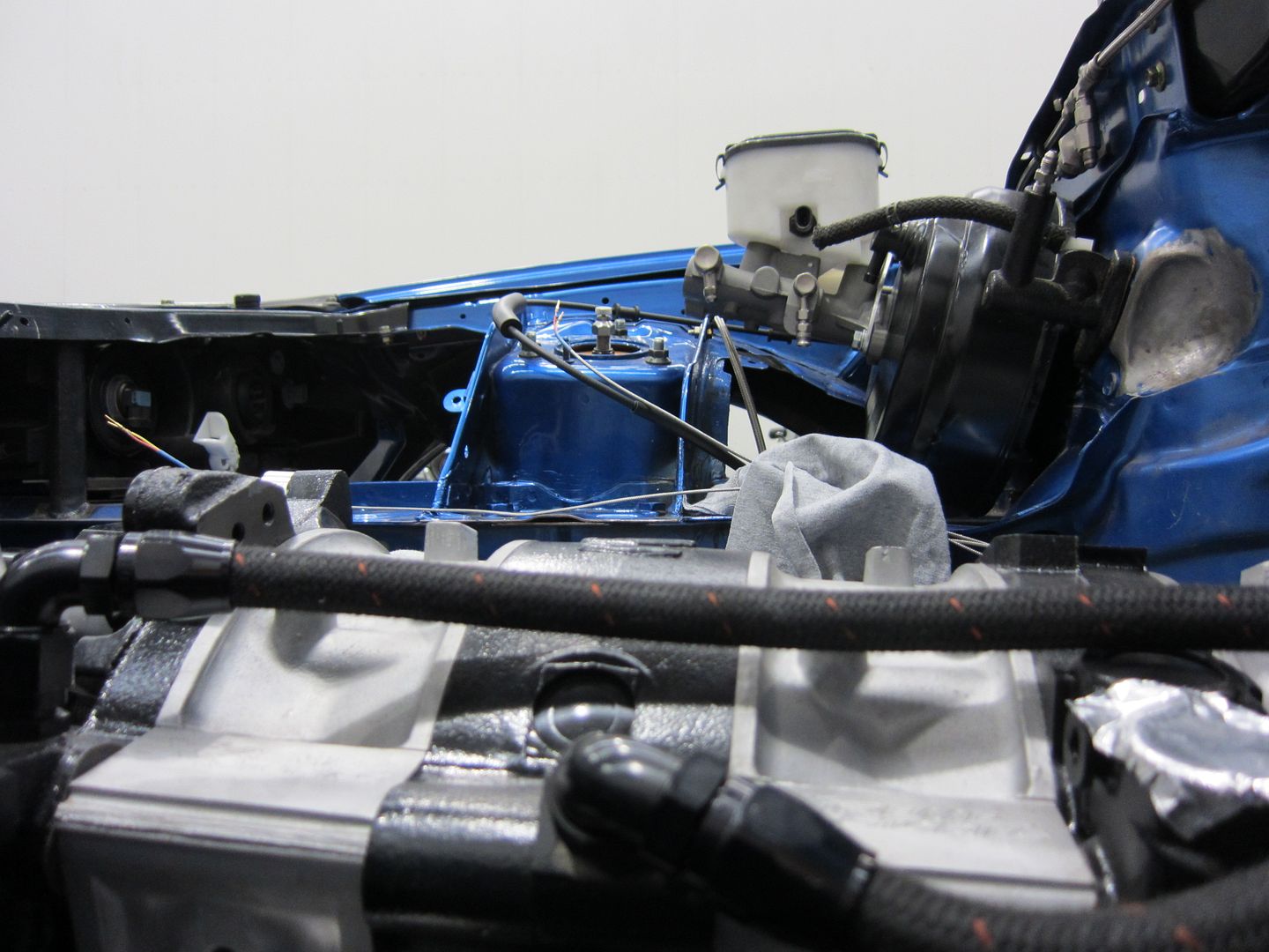

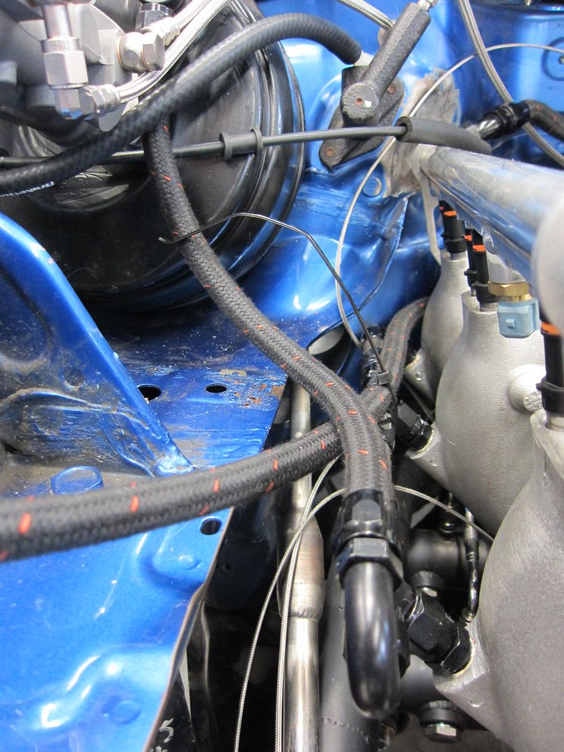

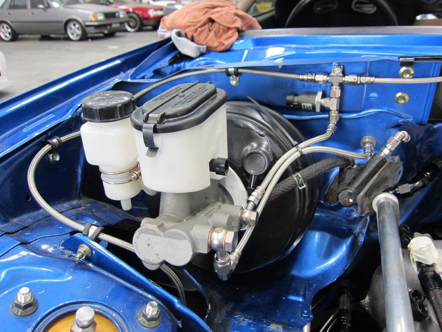

The brake master cylinder is now plumbed to the front brake circuit and through to the in-cab bias adjuster.

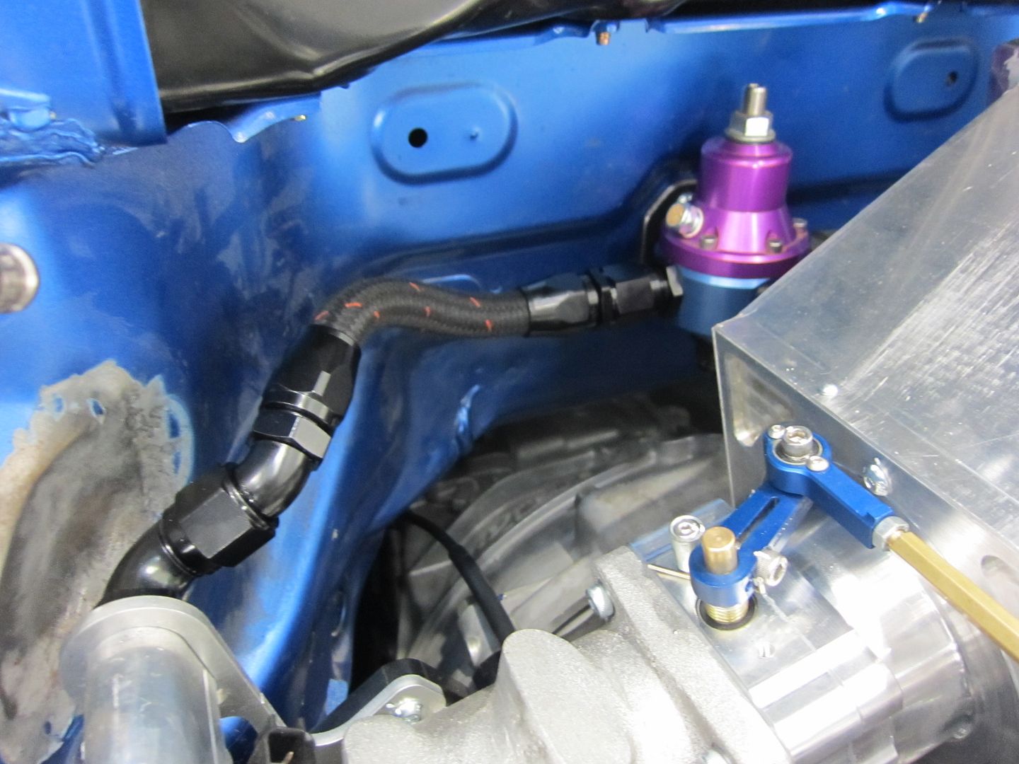

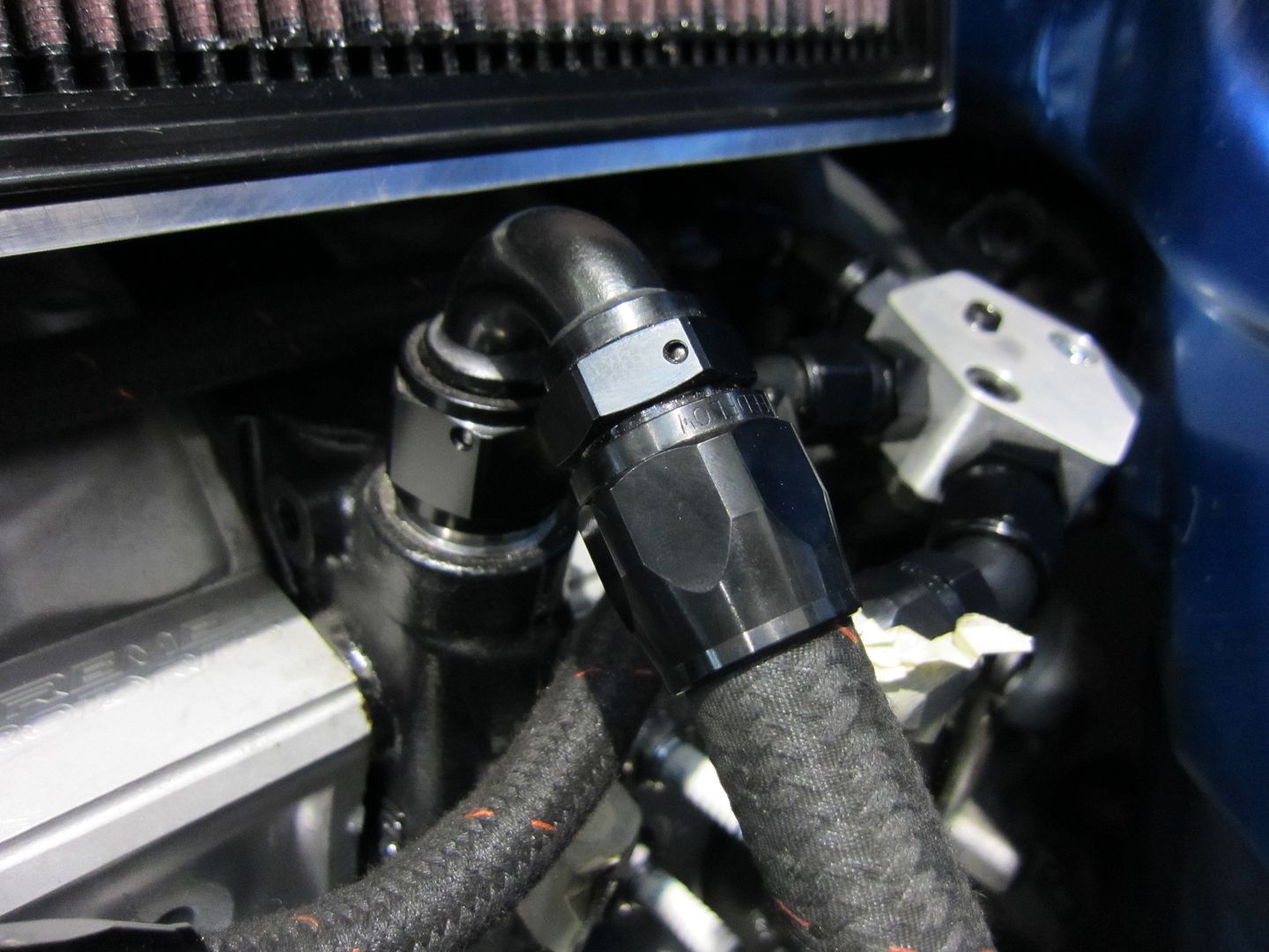

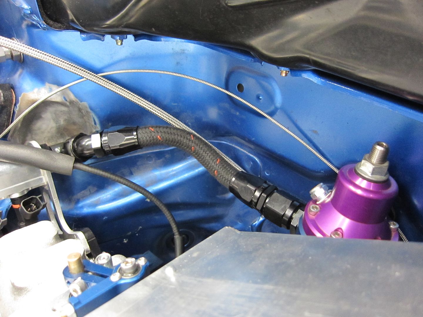

The fuel pressure regulator has been relocated as it would've interfered with the intake air box if it had stayed where it was.

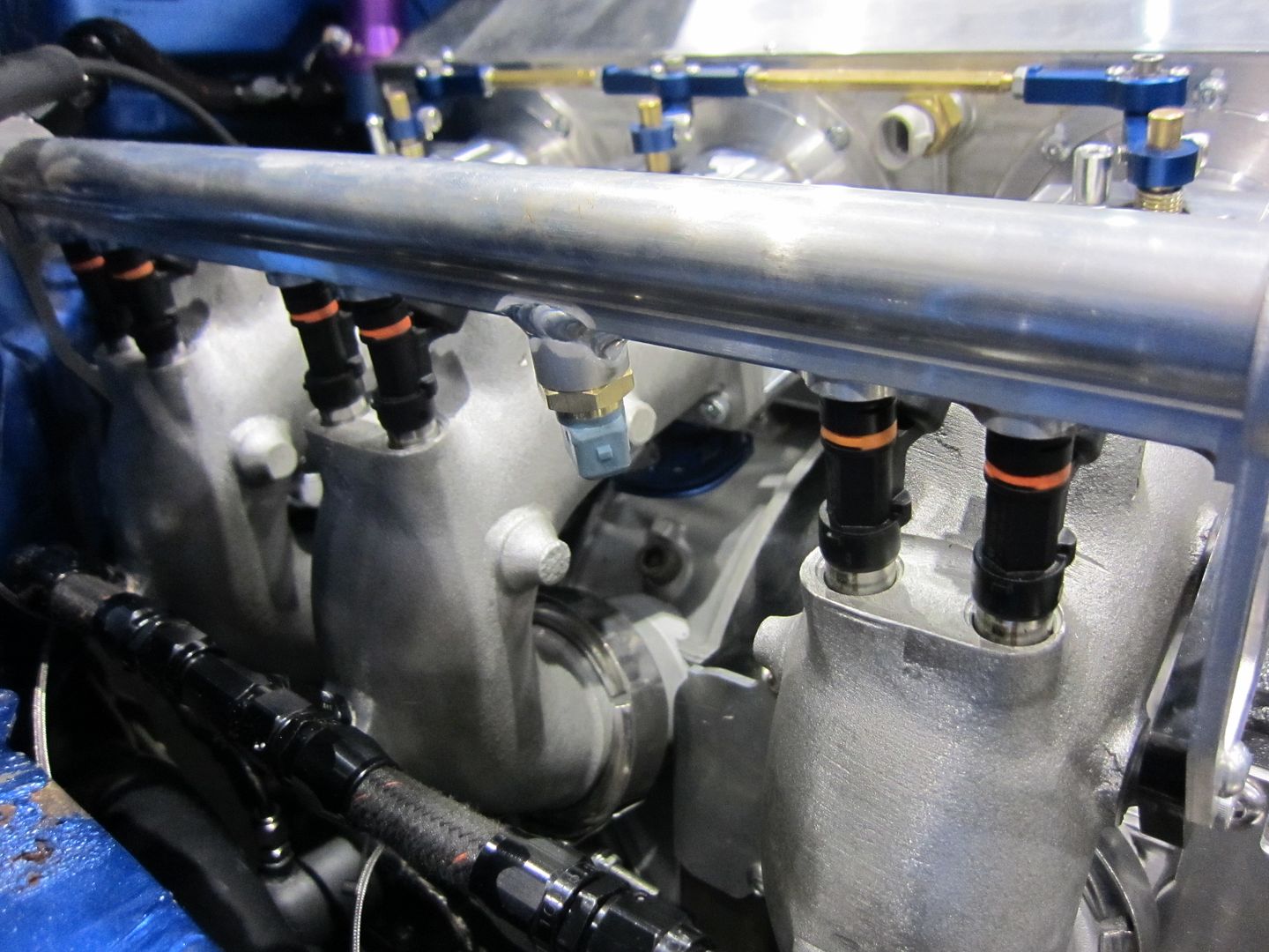

A fuel temperature sender was added to the fuel rail

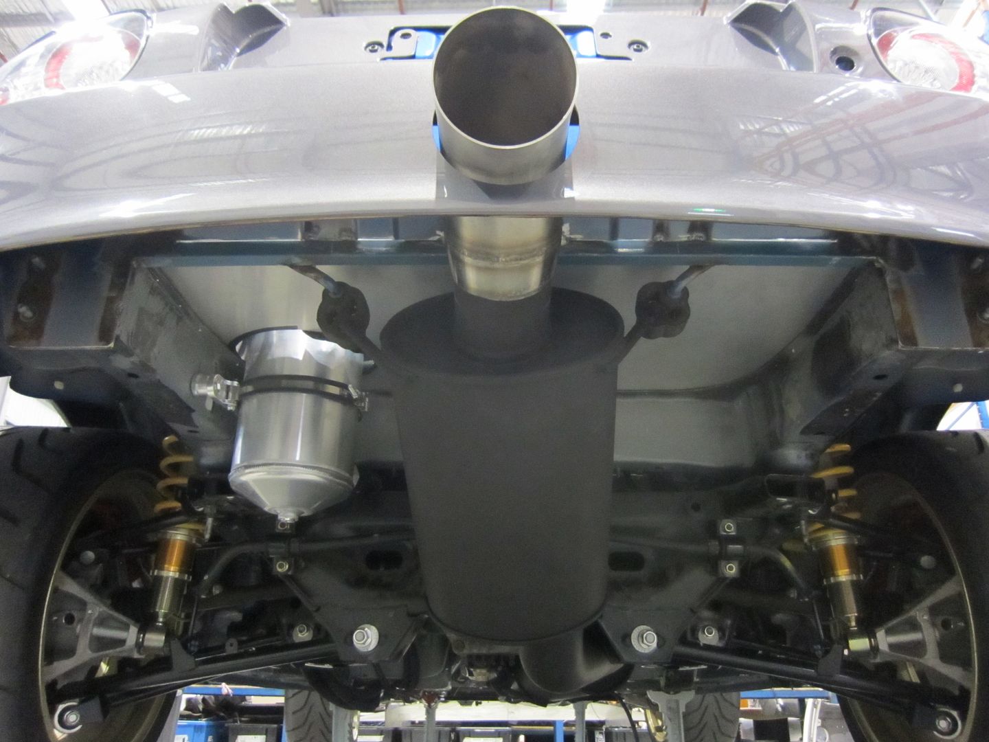

The rear section of the exhaust system was painted with the appropriate hi-temp coating and refitted.
It has assumed the wiring position! :P
Other completed jobs are as follows:

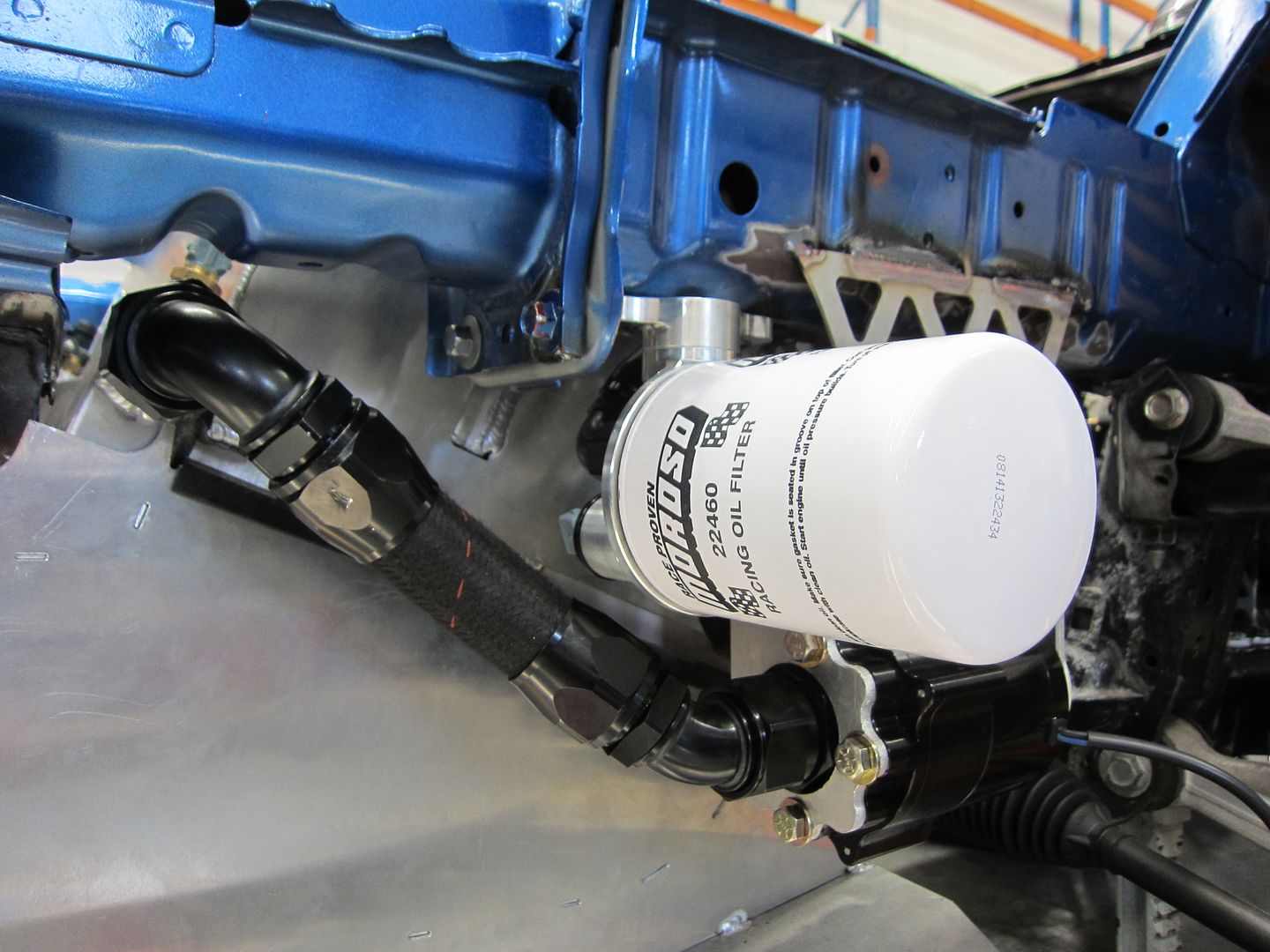

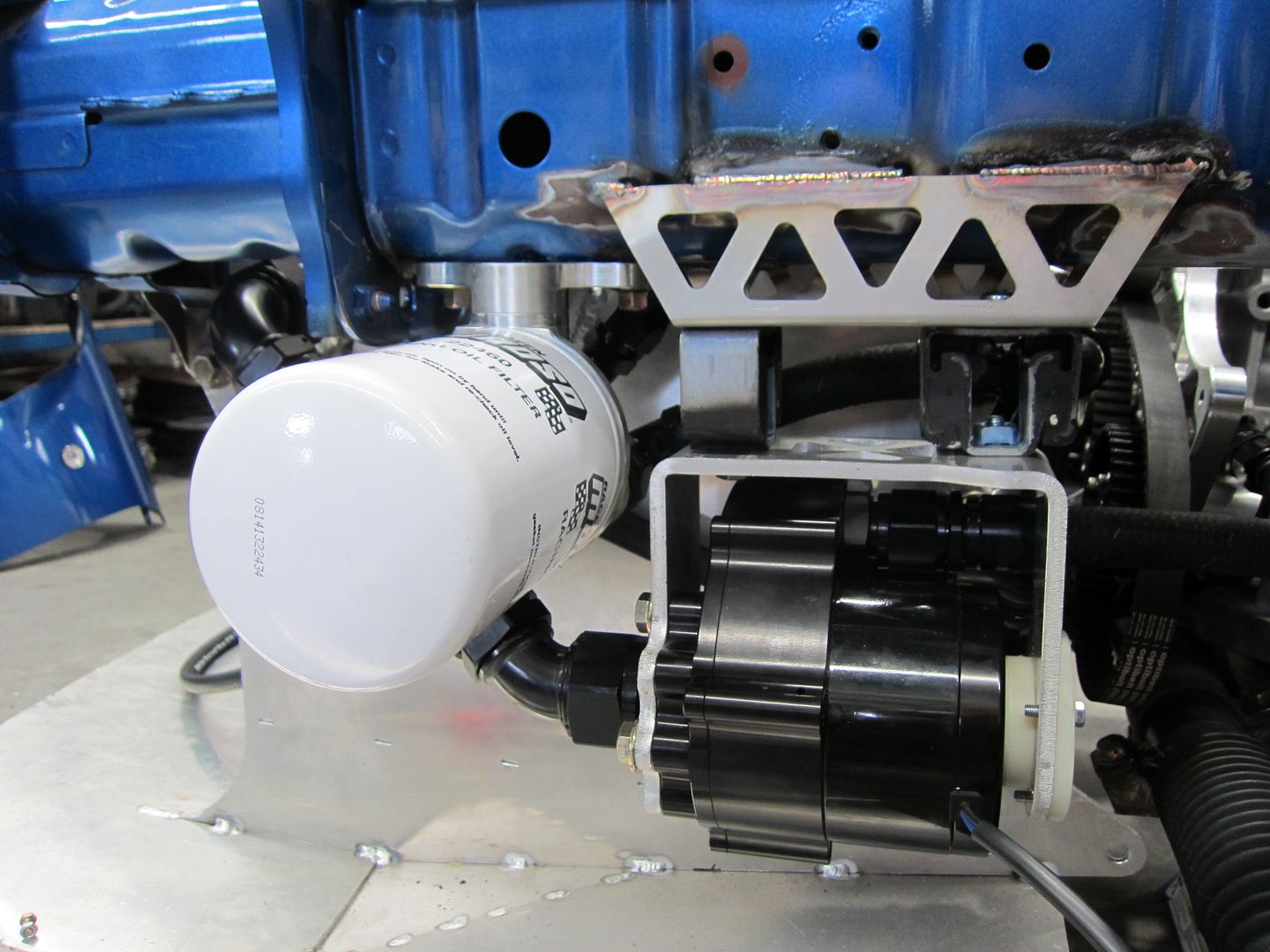

Water pump and remote oil filter head mounted.

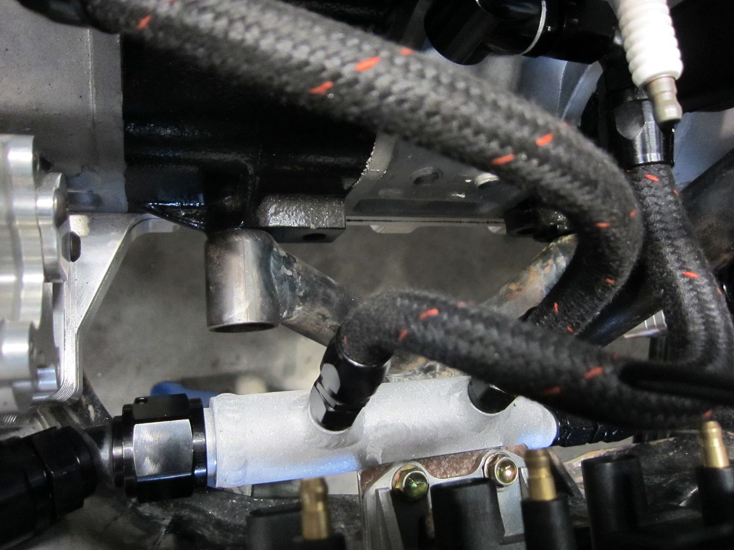

The water distribution manifold that delivers coolant directly to the spark plug area of the rotor housings was made and plumbed.

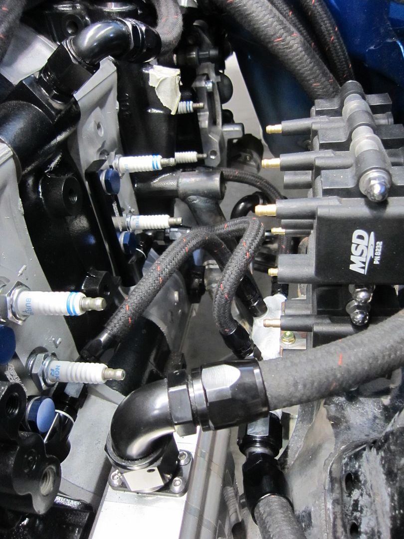

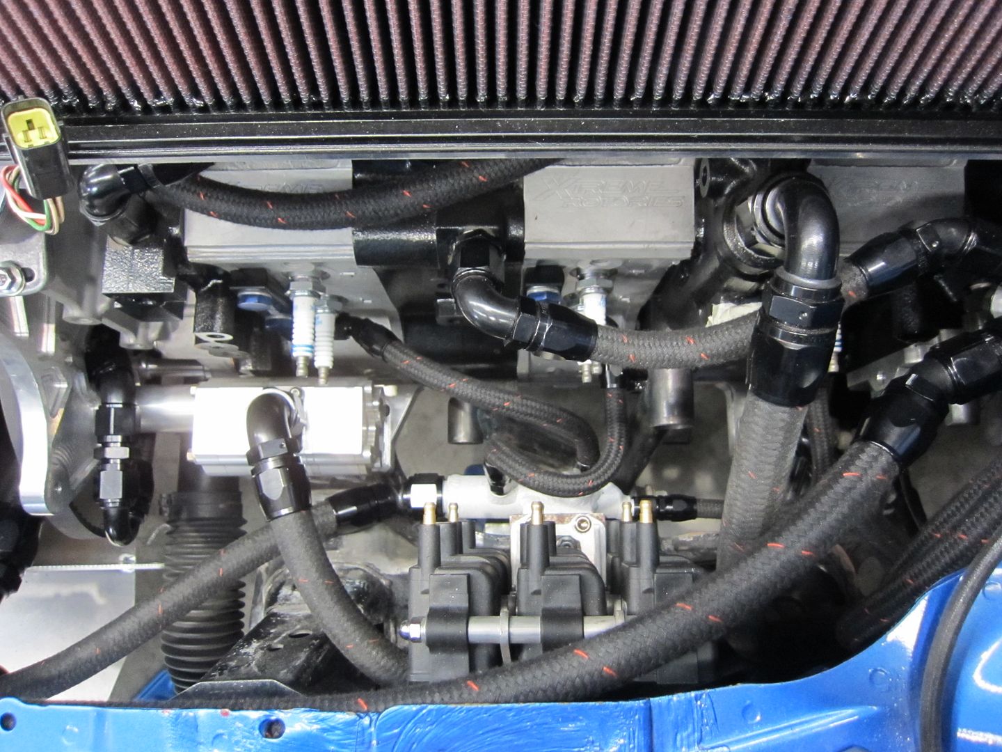

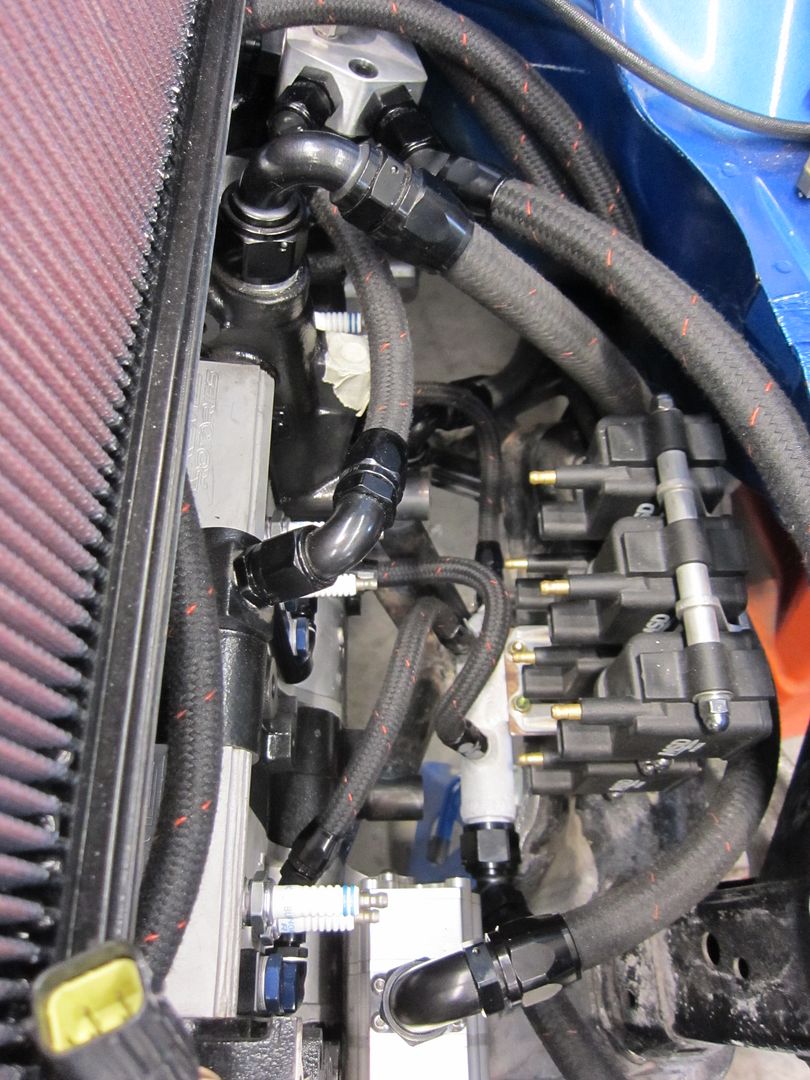

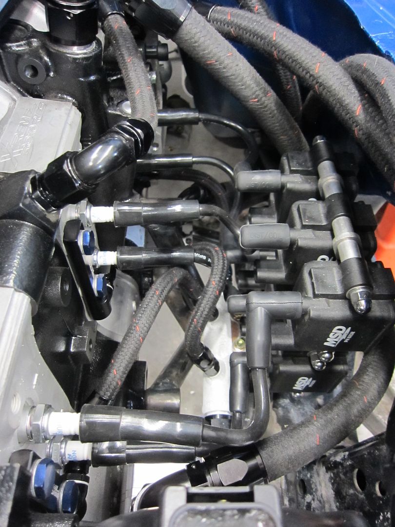

The ignition coil assembly has been mounted and the ignition leads measured and ordered (2 sets).

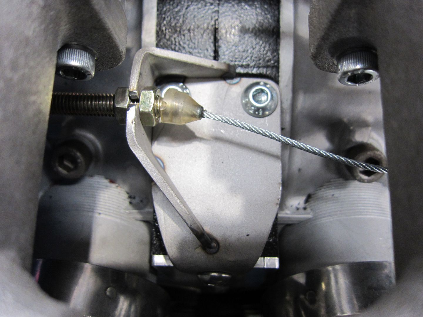

The accelerator cable bracket.
The brake booster vacuum line.
So this is where it's up to. The oil system is effectively completed with just a header tank for the coolant system left to complete the water system.

the size of that fuel line :shock: :shock: :D :wink: :beer: :beer: :beer:

I see a brake booster as well!

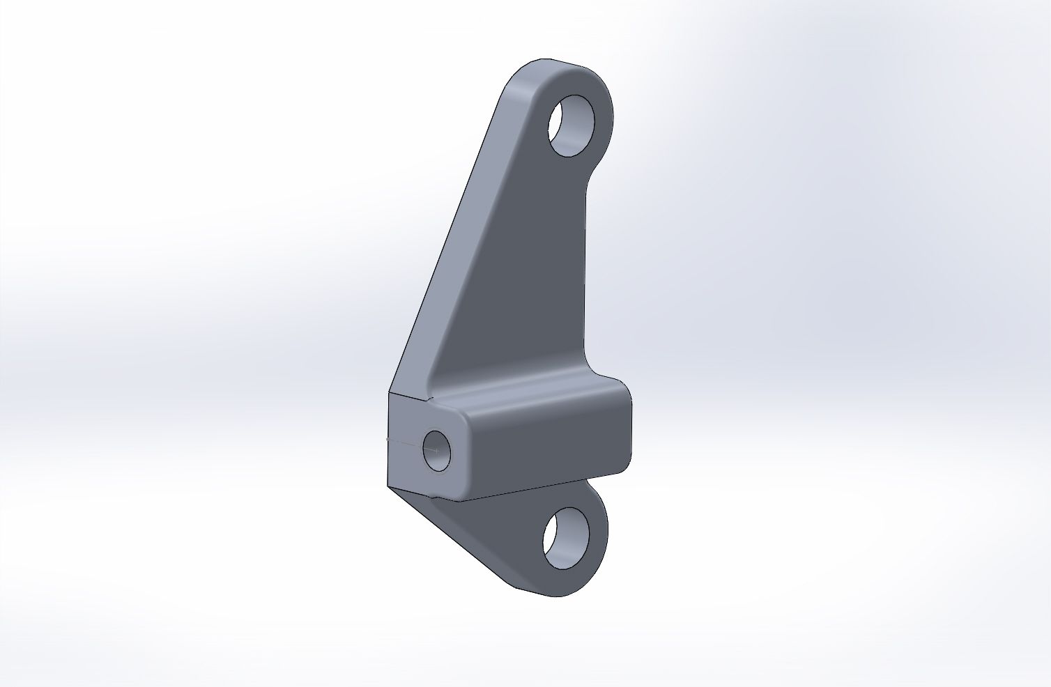

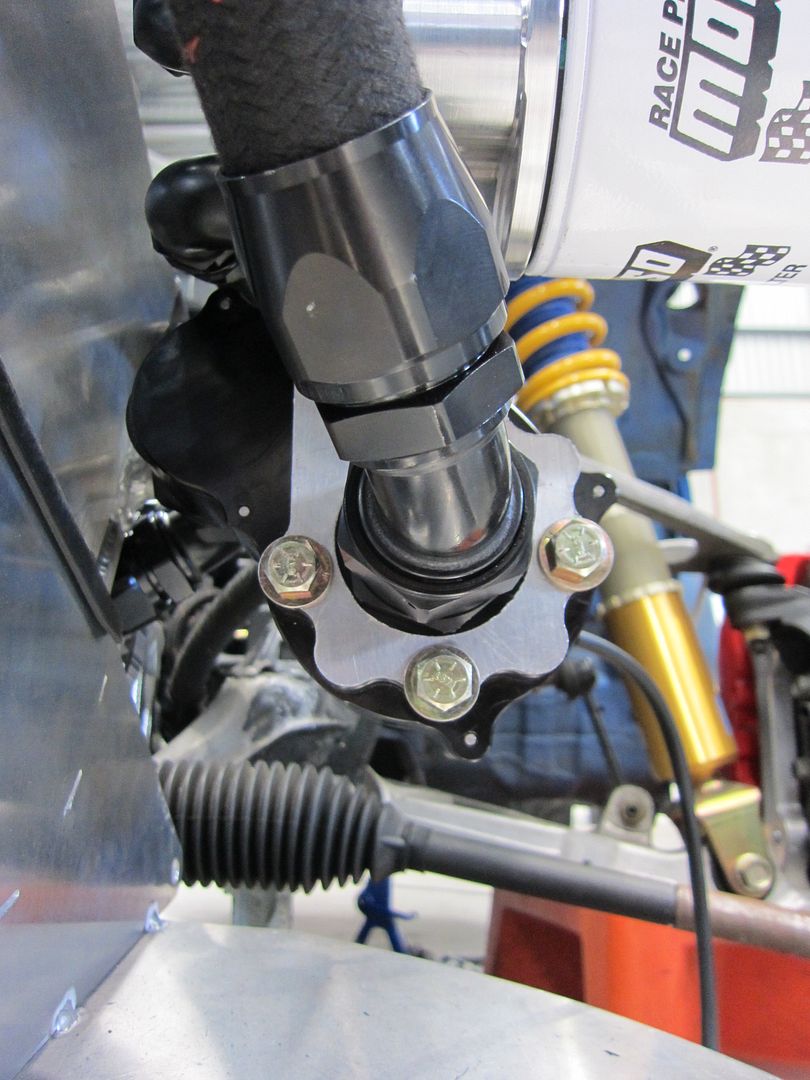

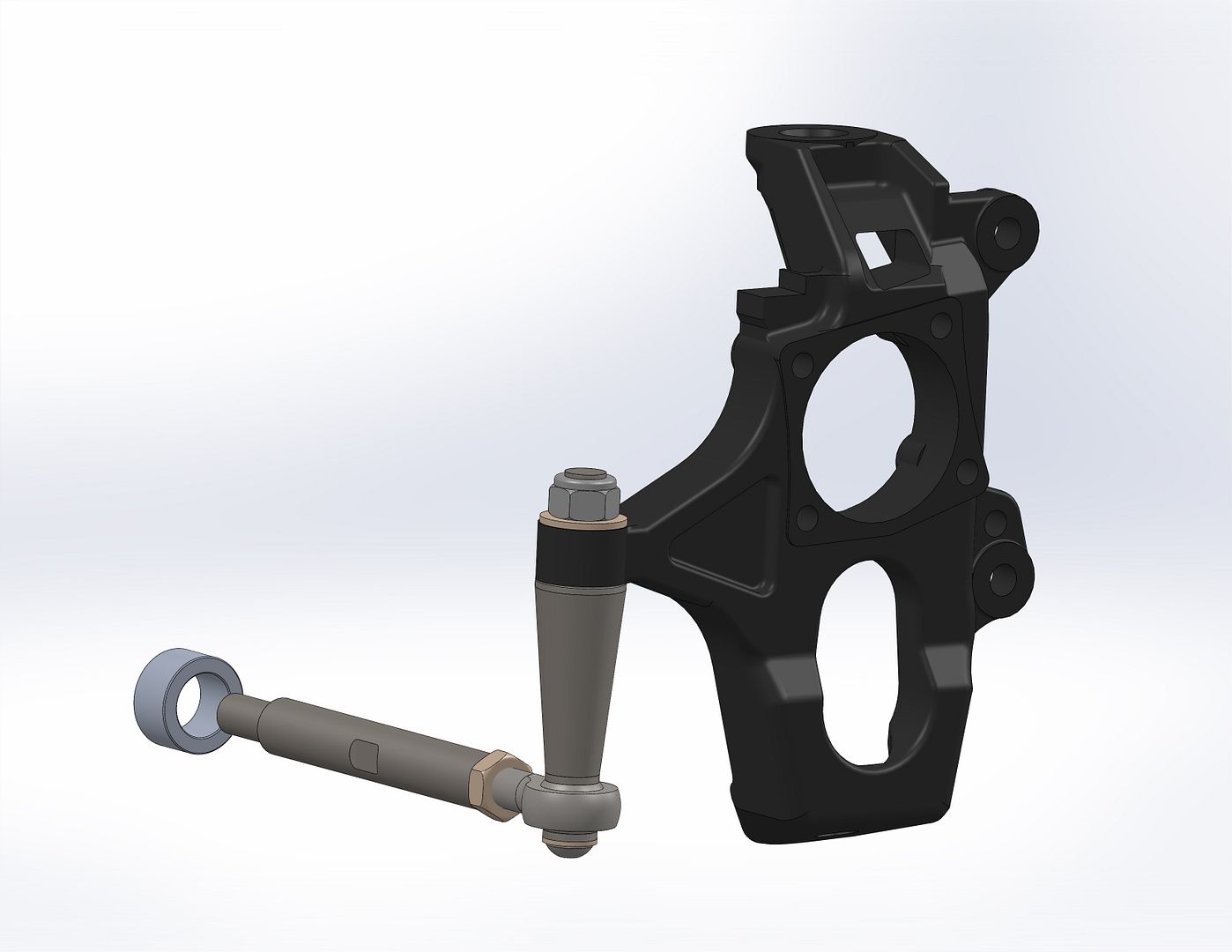

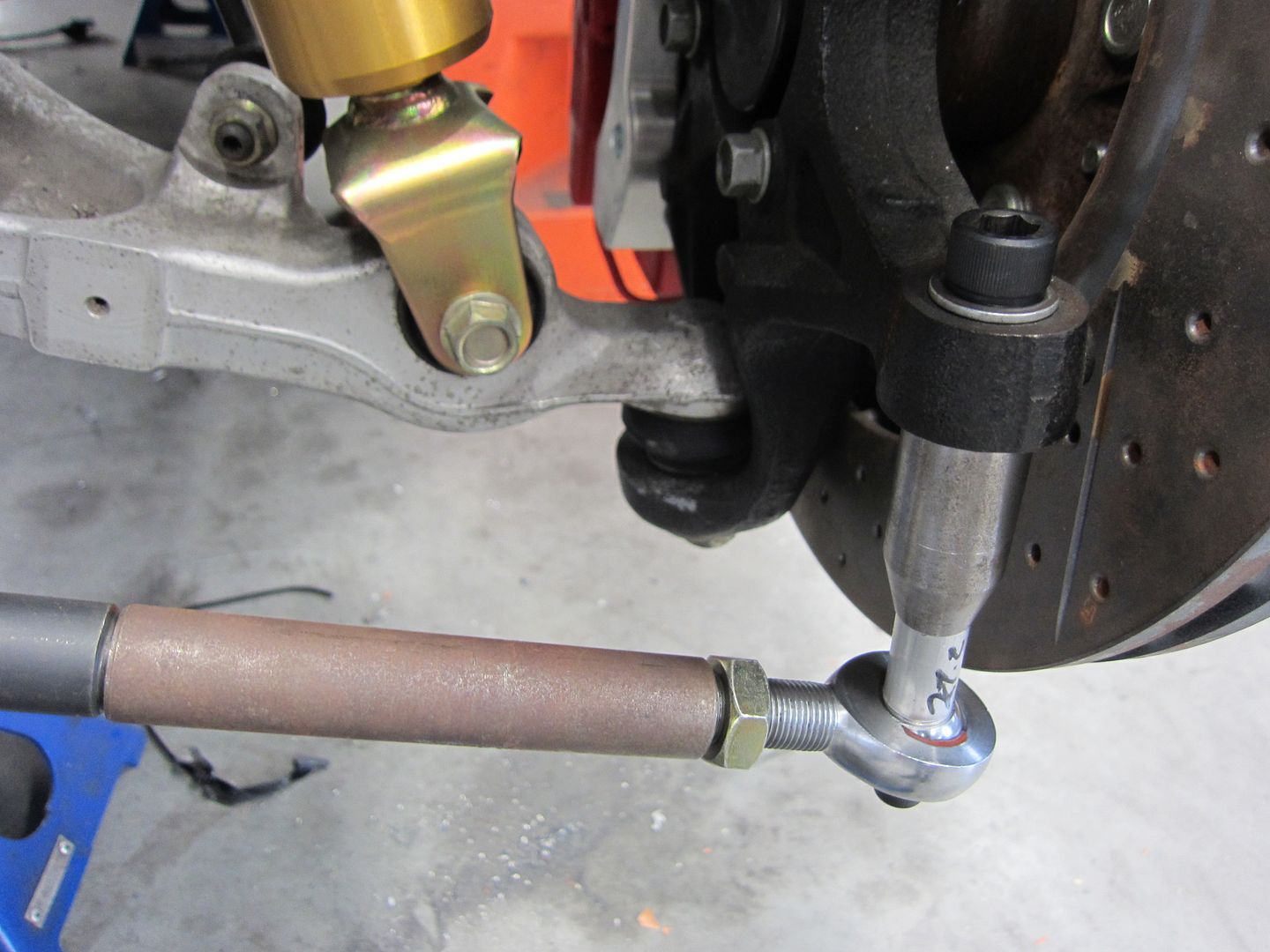

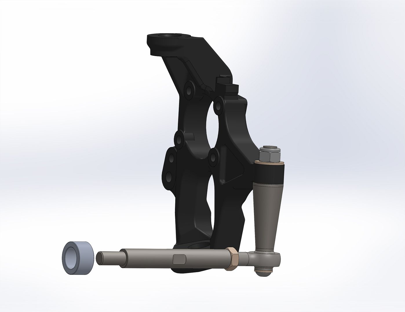

The steering components that facilitate the use of the custom power steering rack are now designed and can be manufactured. These are the prototype items. The RH side is pretty much the same.
....and these are the production items.

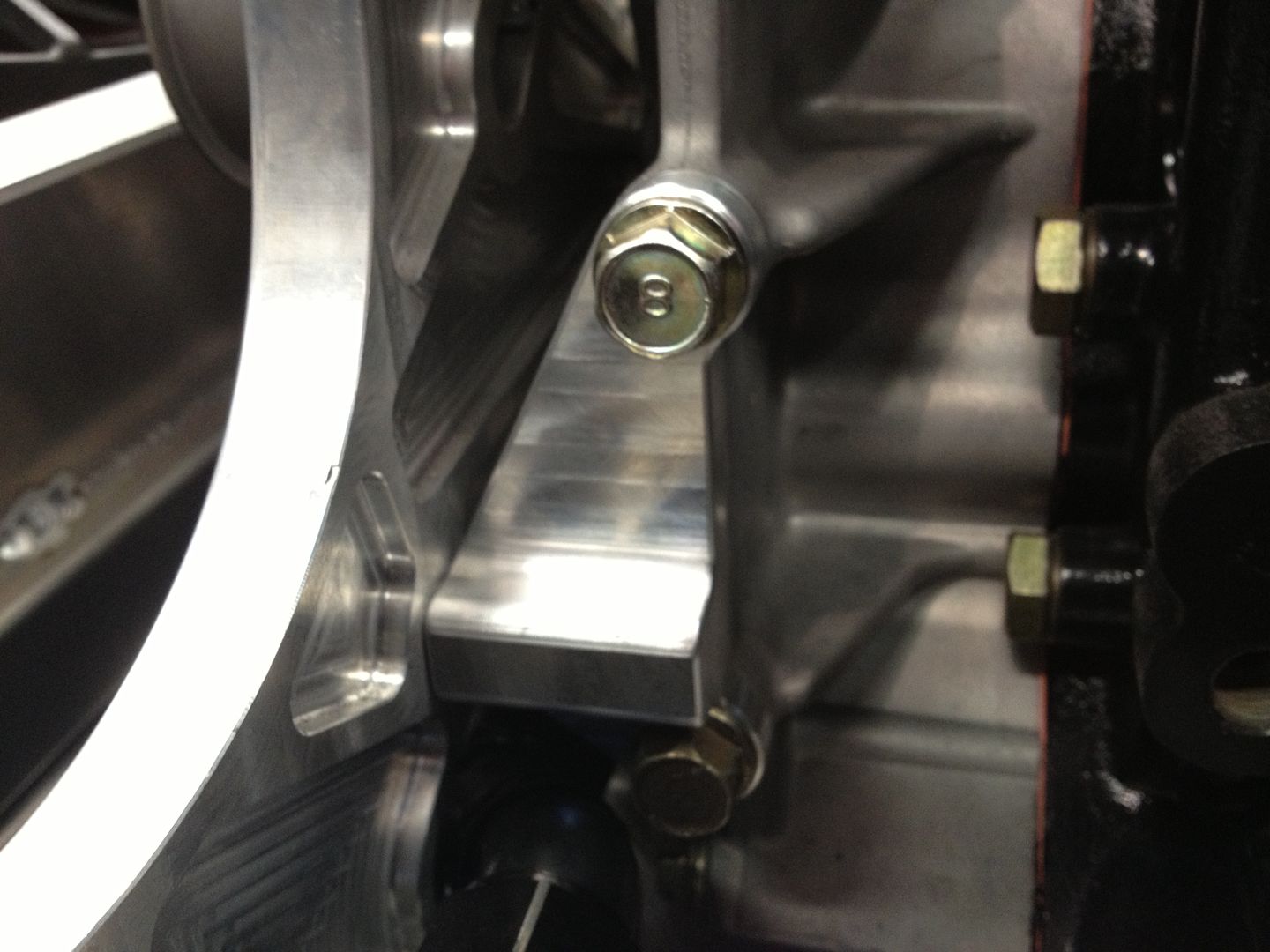

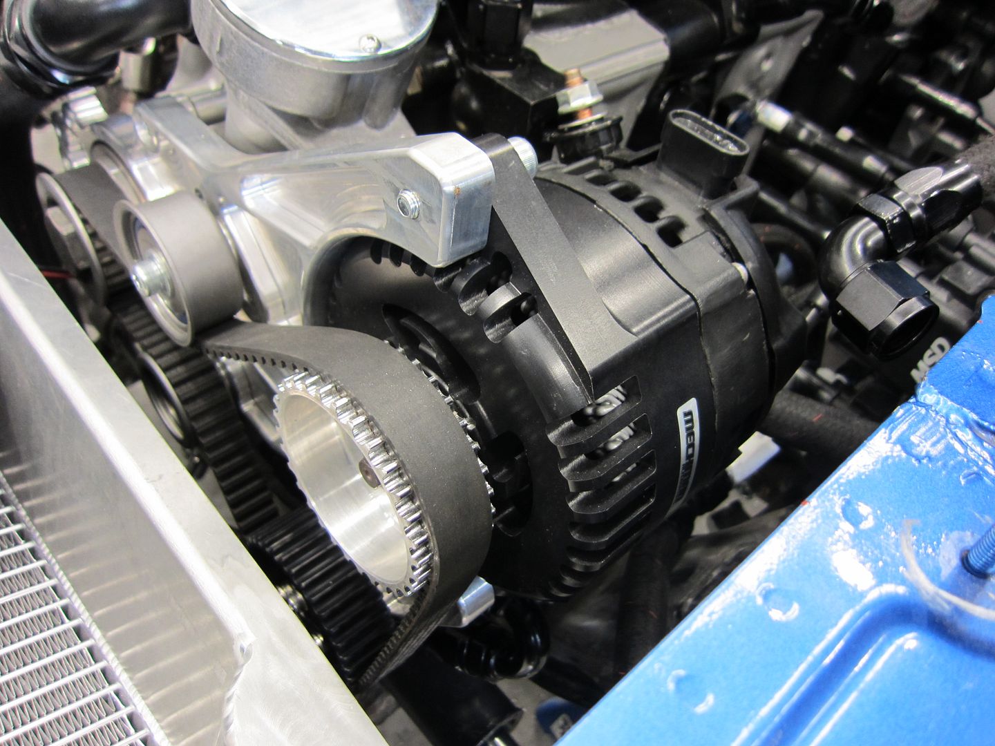

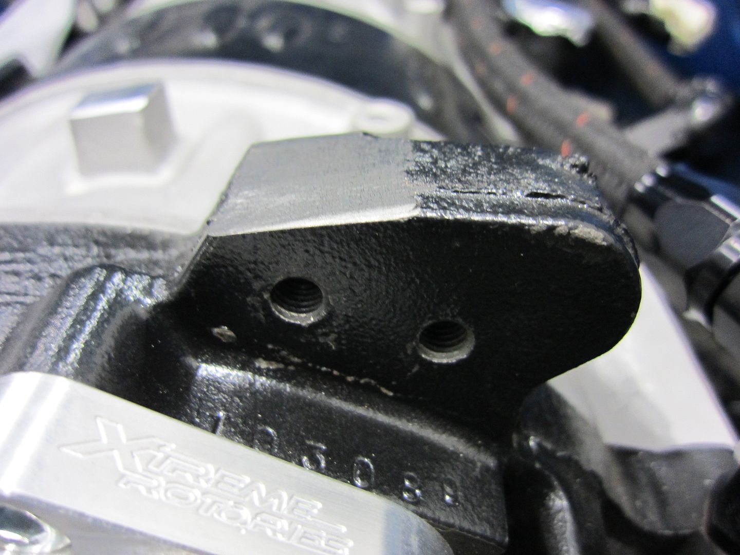

Due to the rather large alternator I found that the dry sump front cover bracket wasn't as stiff as is necessary. So I added a bolt in stiffener between the front cover bracket and the engine front cover.

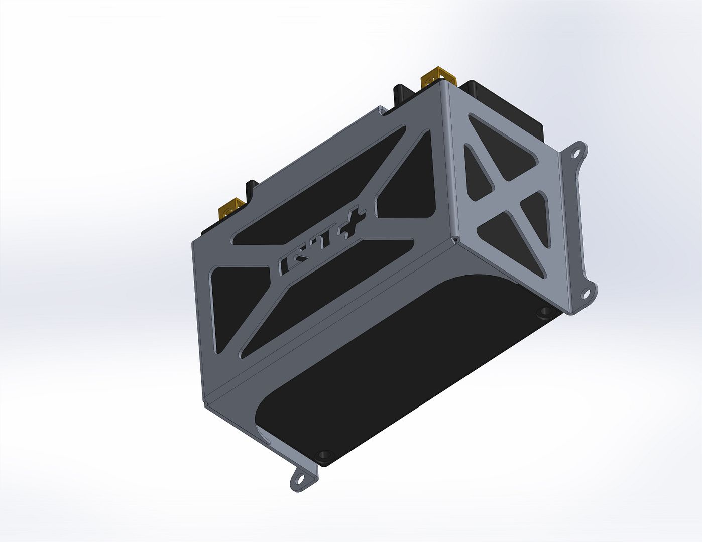

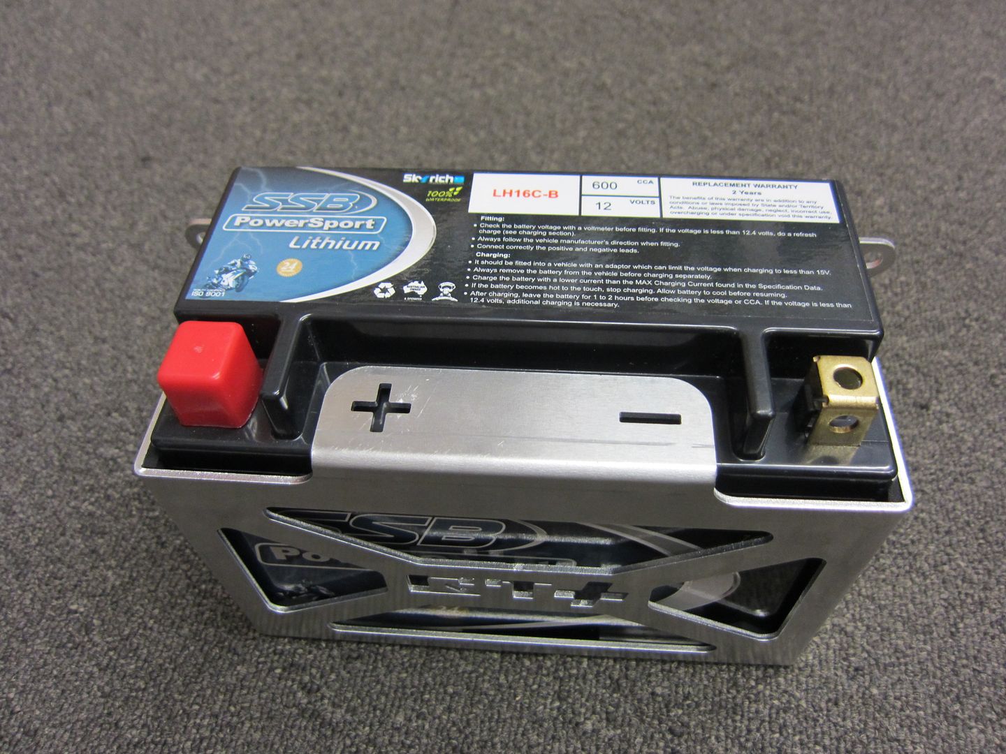

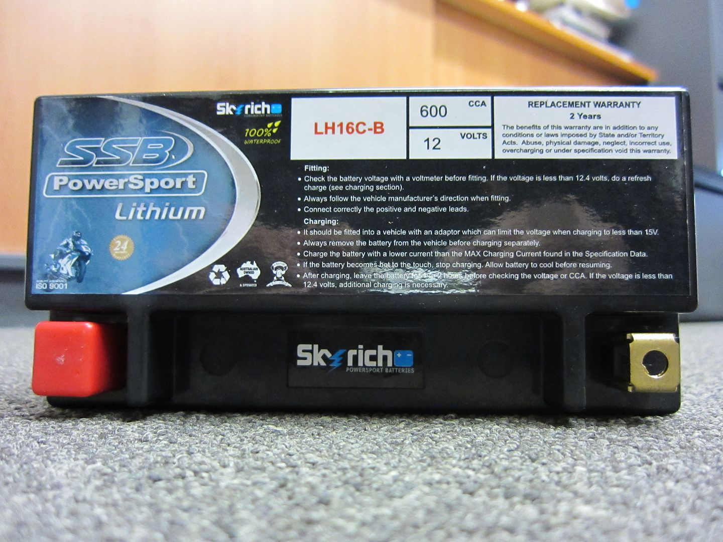

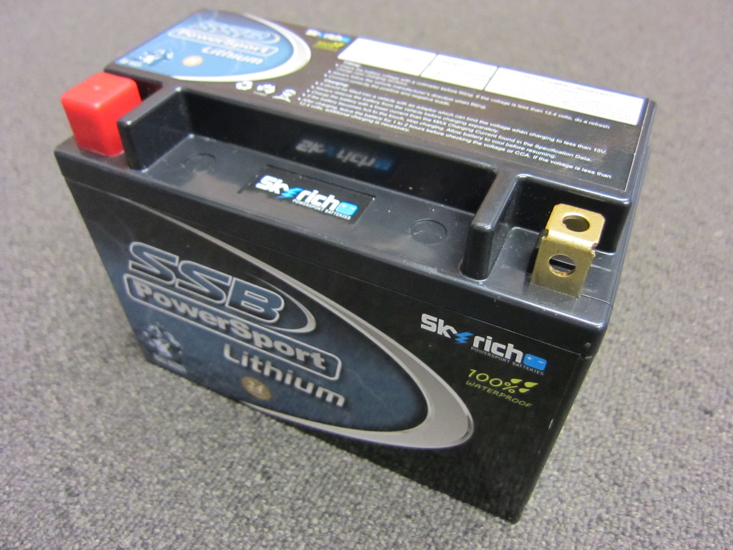

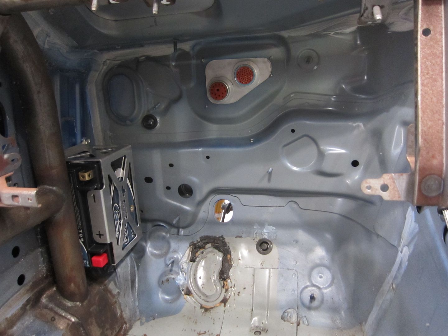

This is the battery I'm using. It weighs a huge 1.7kg

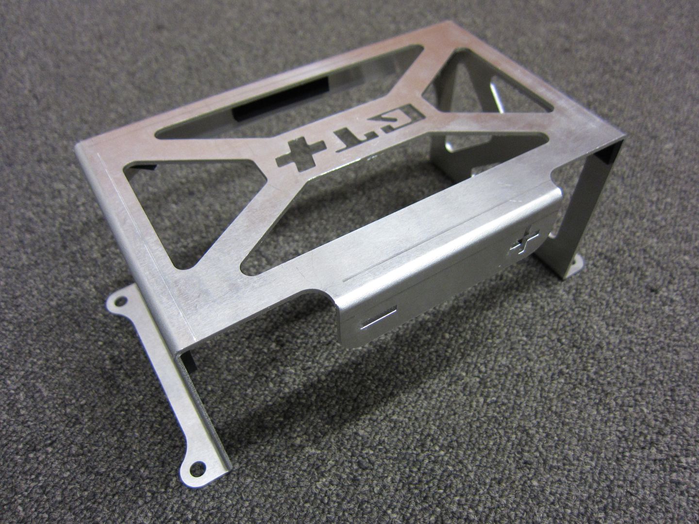

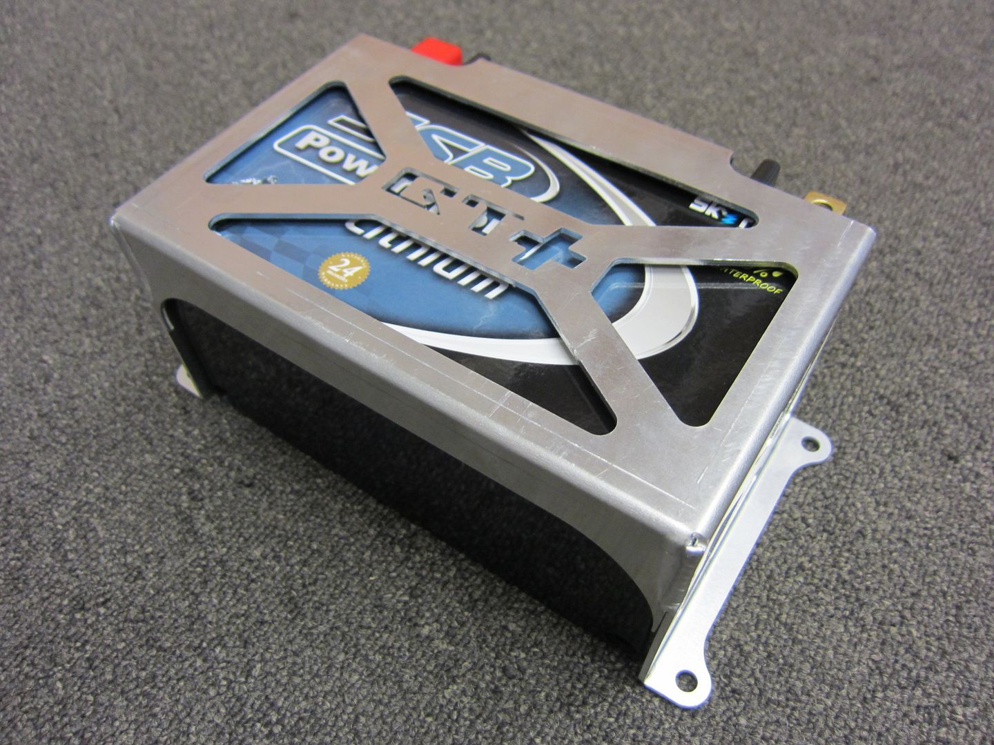

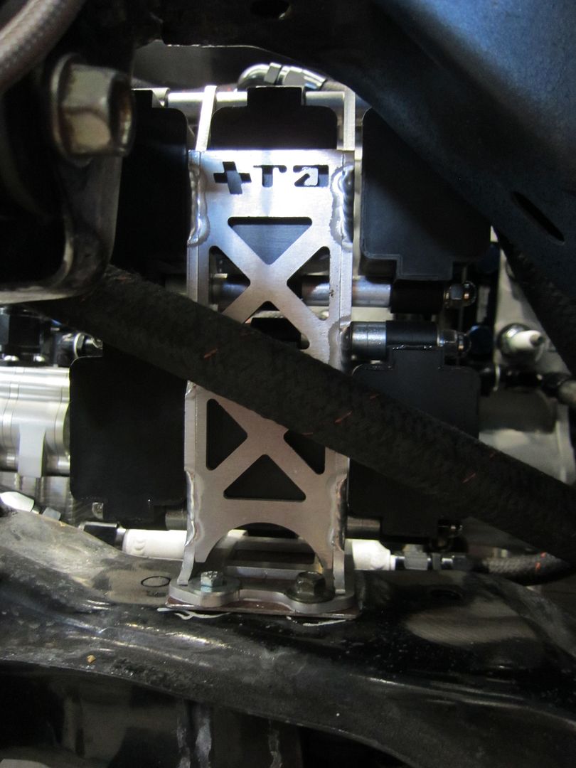

The lightweight battery bracket (190 grams) was also finished.
...and mounted. :D

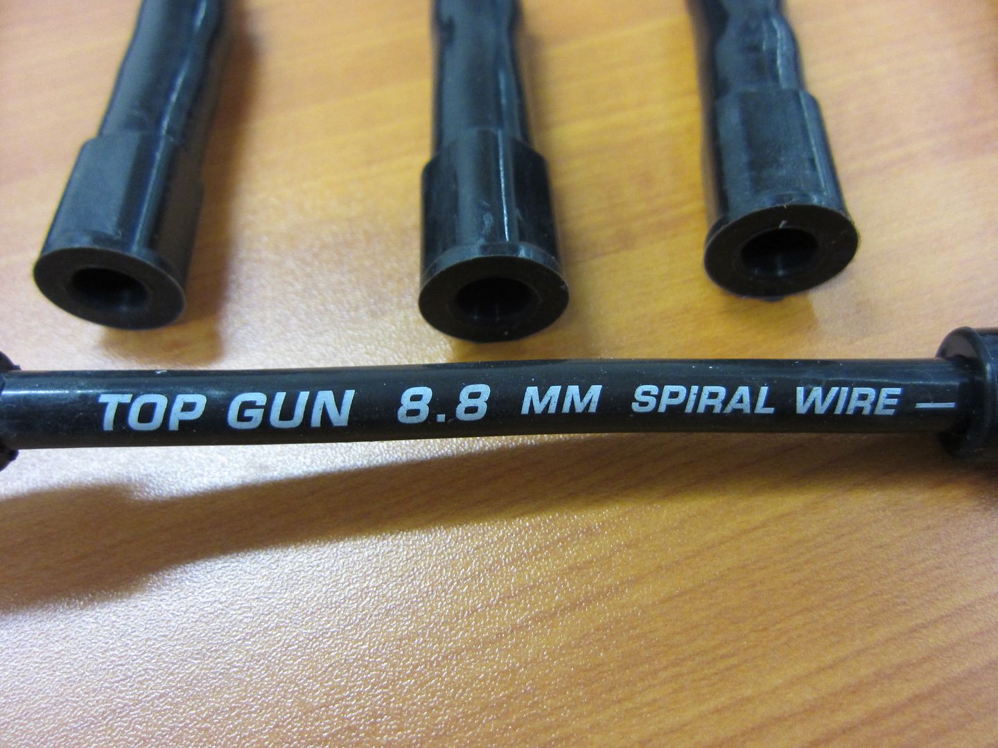

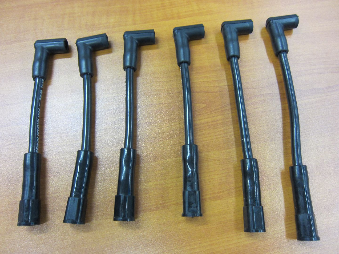

Two sets of custom ignition leads have also been manufactured and one set installed.

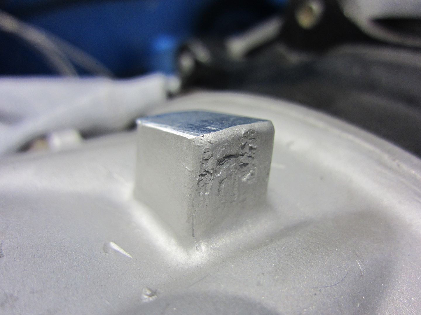

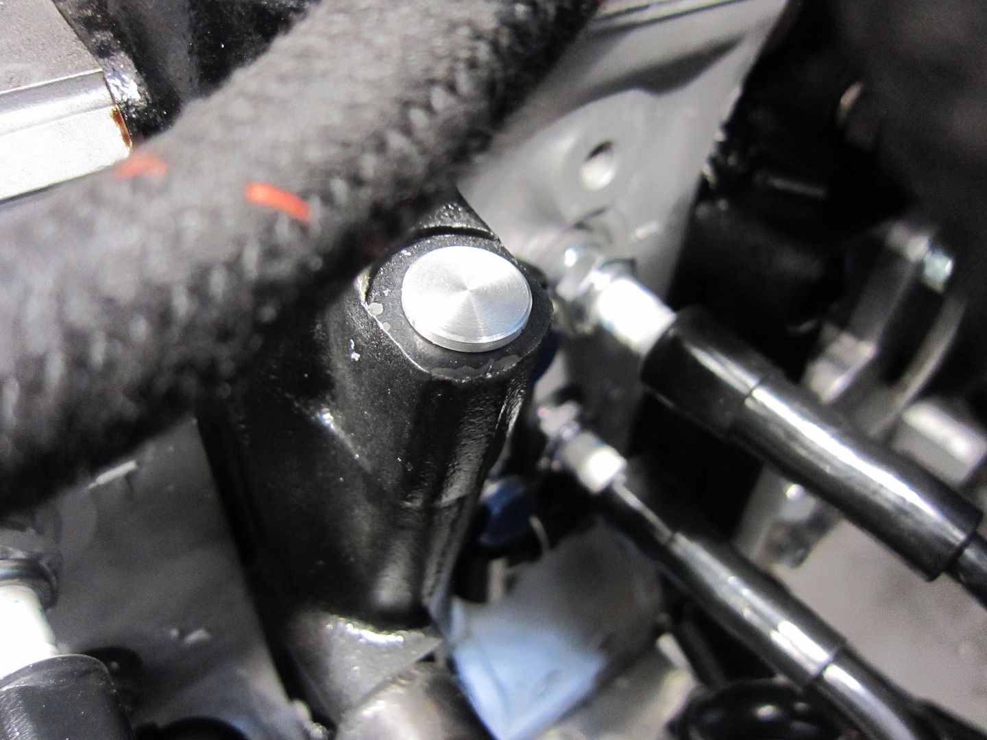

...and the dip stick hole plugged. :P

Mint work as always Danny. It looks like a swaybar endlink is photobombing your battery mount pic! :lol:
