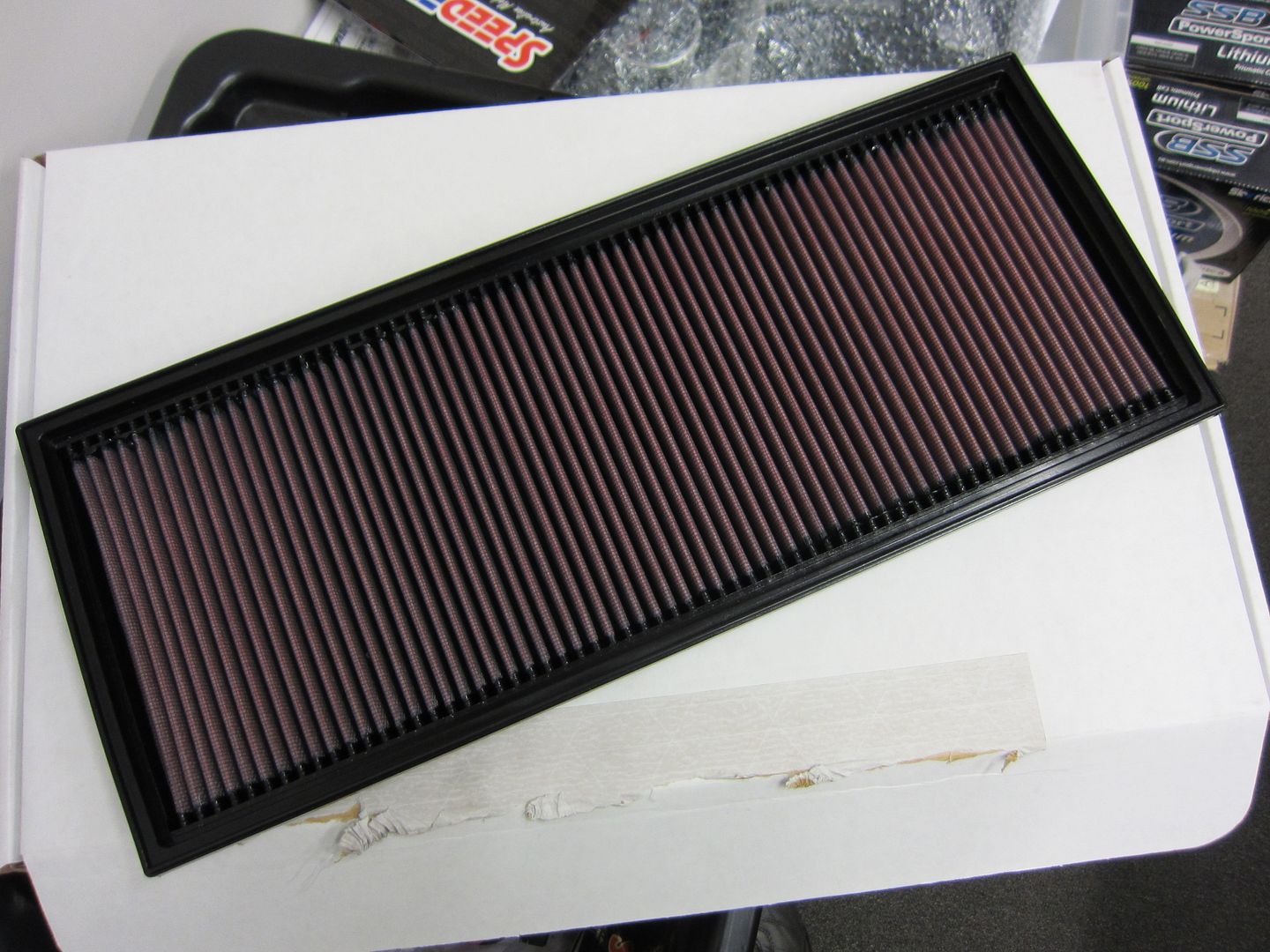

So I have the panel filter...its to suit a Porsche 968 3 litre. Materials for the fixed section of the air box have also been ordered. I hope to have them early next week.

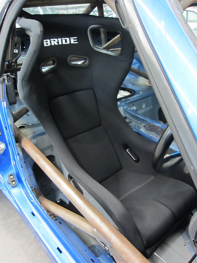

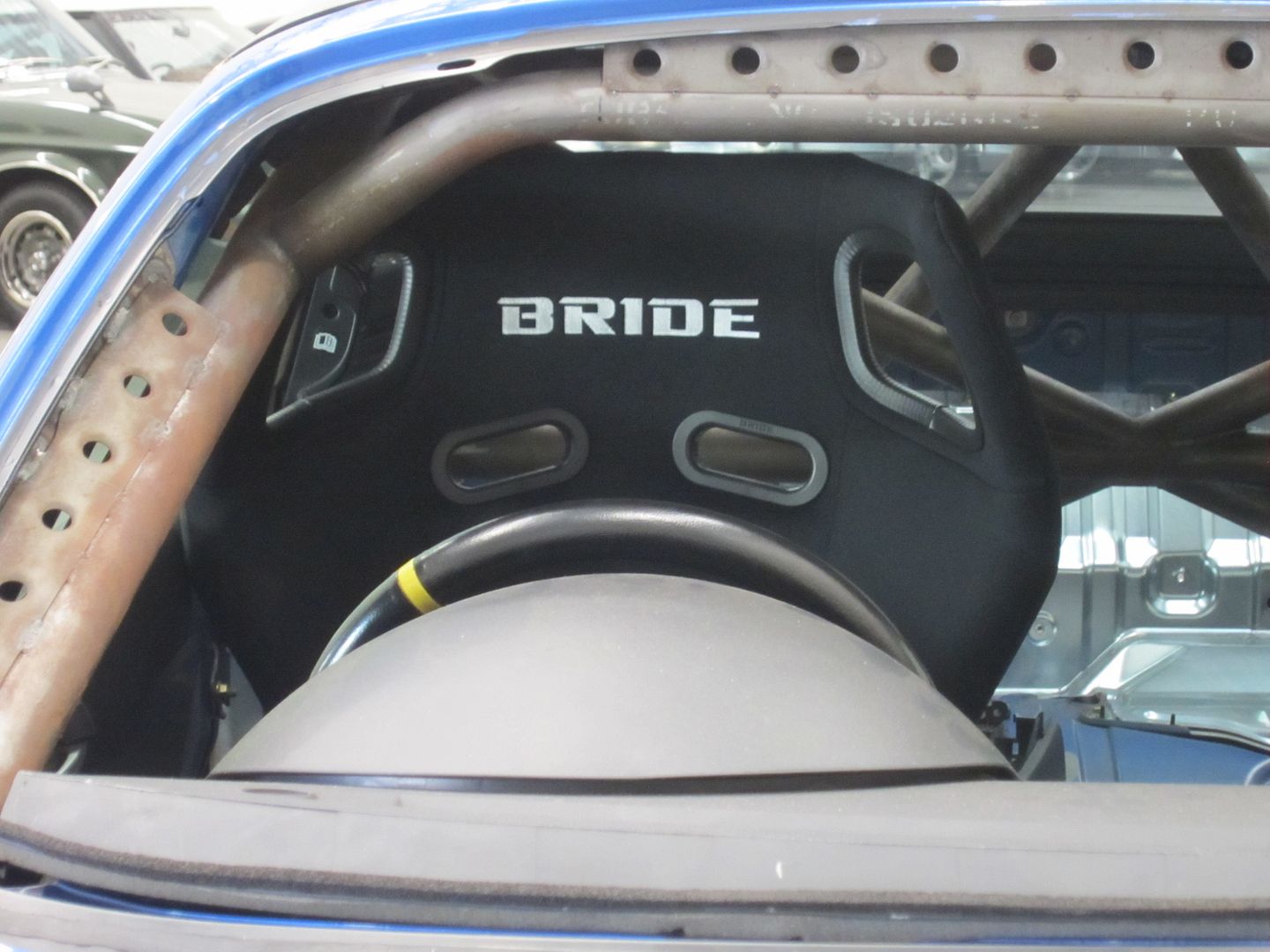

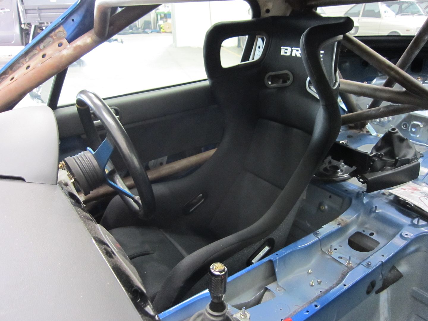

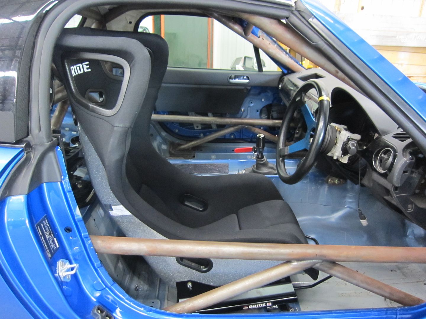

The drivers seat and rail have also arrived and are now in the car. It is a Bride Gardis III. I'm very happy with how well it fits in with the cage and hardtop.

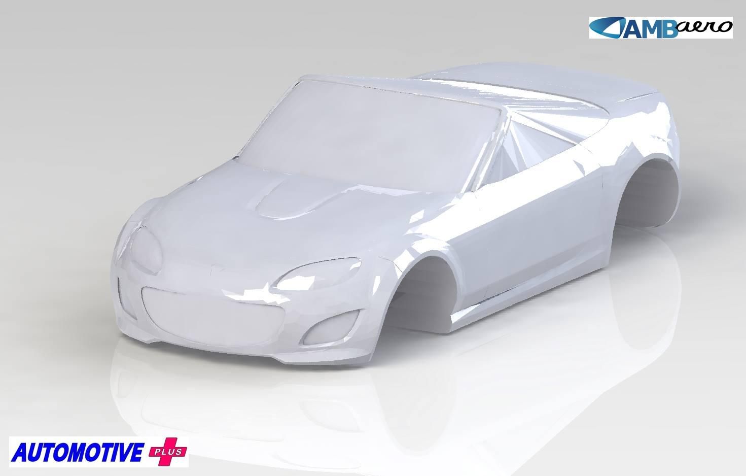

The design of the aero package is underway with AMB Aero completing the solid model of the standard body. This image was before the hardtop was added.

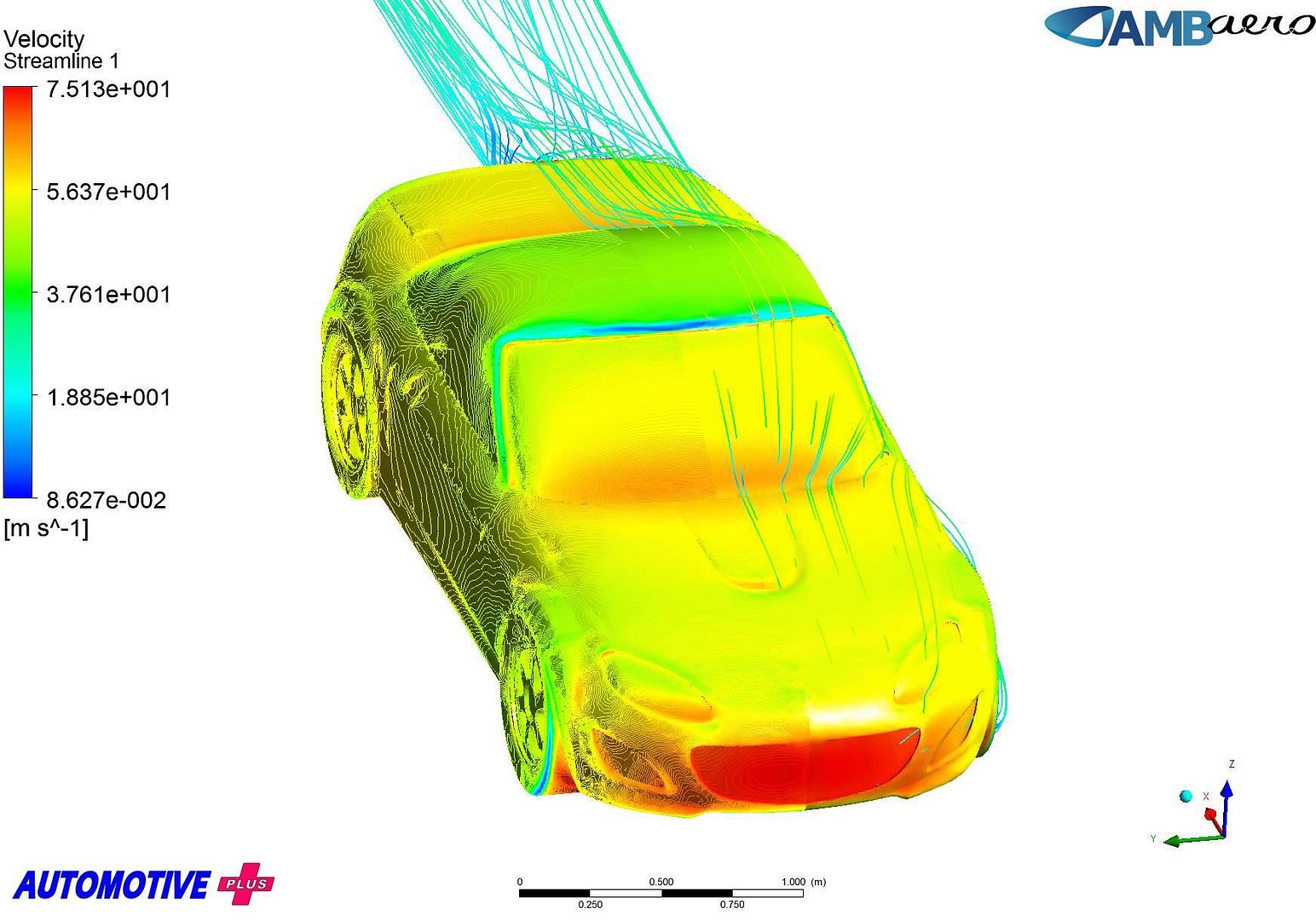

This image is of the first CFD model so that we had something to benchmark the aero package.
