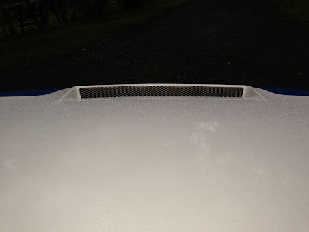

Did a test fit of the new bonnet (fibreglass), will be going to paint very soon. Also now have decided that the roof scoop was not the greatest idea, whilst it does not leak (anymore) the wind noise (without a helmet on) is annoying, unless you don't want to talk to your passenger. However on the track it is fantastic and gives heaps of air so I'm making a foam template to block off the noise when on the road and can easily be removed for the track.
After the bonnet only the spliter and possibly side skirts to go and externaly car is complete.

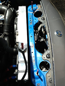

Postby Magpie » Thu Mar 21, 2013 8:14 pm
Small update, bonnet pins are in and car fitted for trailer.
Used existing spots where the hood rubbers go.
A bit of white chalk on the top of the pins gave the drill points:
Holes drilled
Bonnet masked and template marked out
Holes cut
Stopped taking photos, however will get some of the finished pins soon.
Car on trailer (tilt type) for test fit, door can be opened, final position of car will not be as forward as it is on the trailer, no scrape on loading a small one when unloading, however this will be rectified. Trailer off for galvanising very soon.
