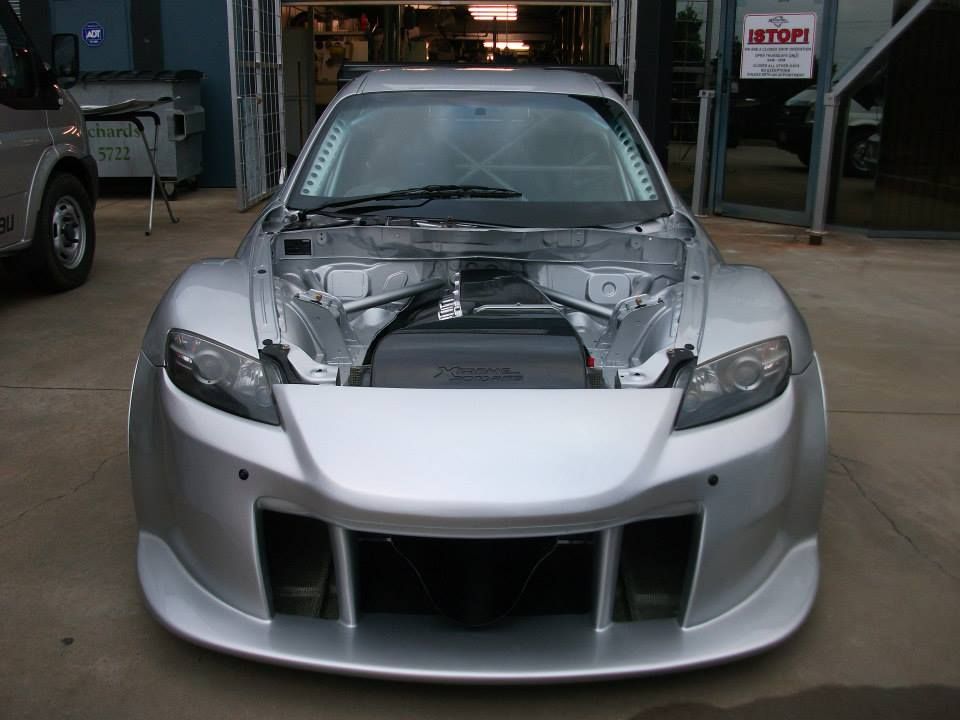

Nah this is it for me. Rohan's (Xtreme Rotaries) has already got that one covered with his quad-rotor powered RX-8.

Nice RX8.

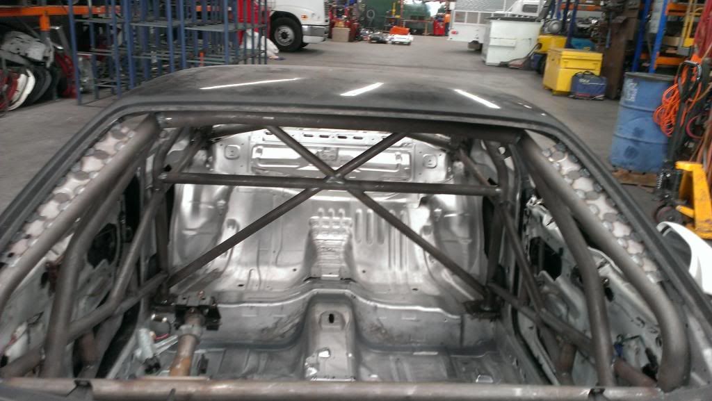

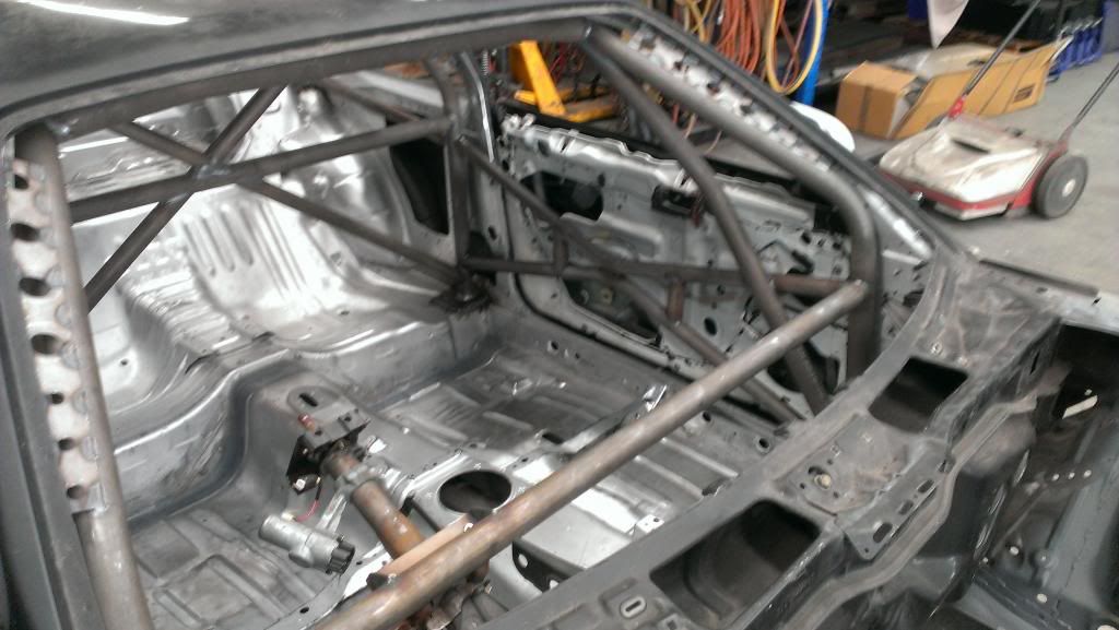

Anyway, excuse the poor quality pictures and the hijack, but for those playing at home here is a sample of the fabrication work done by the Boys at ADE.....
