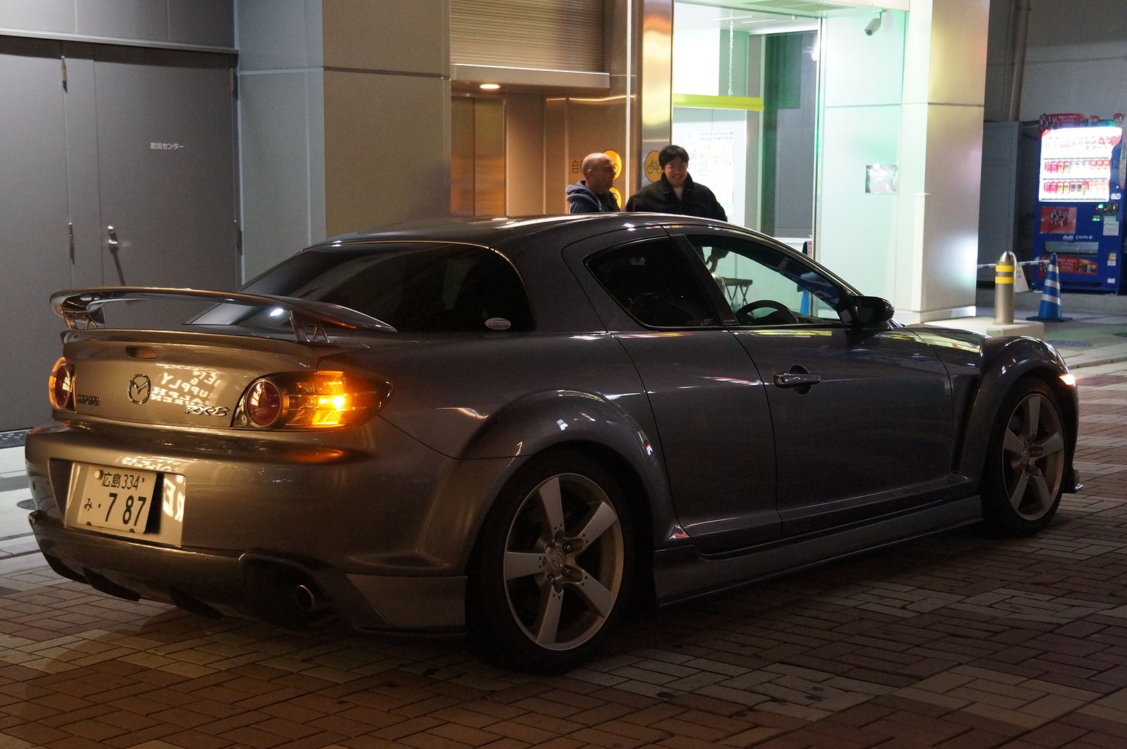

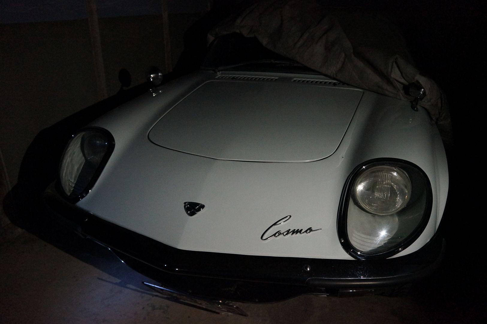

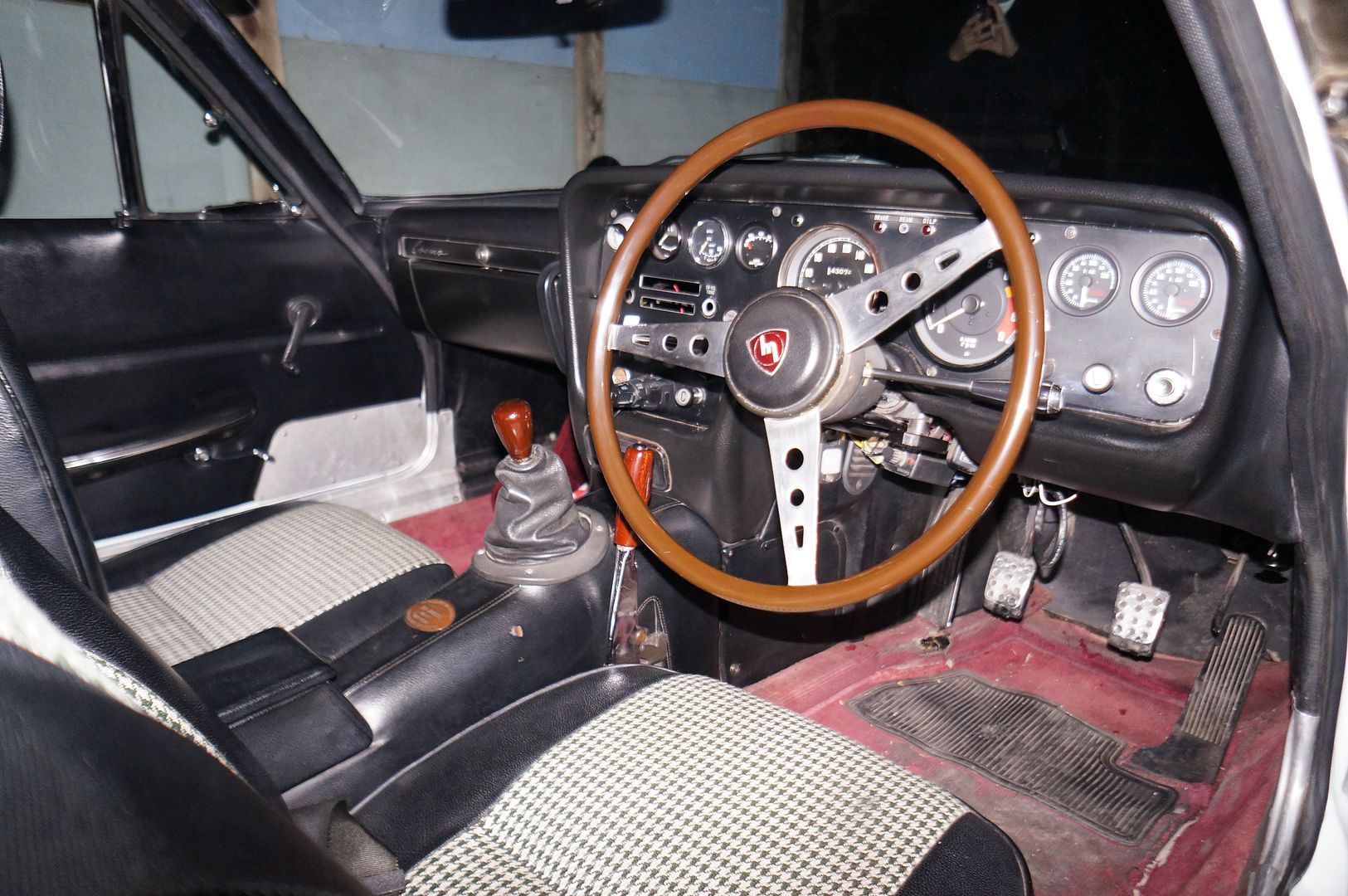

One of the highlights was an impromptu road trip (in Hayato's RX-8 Taxi) up into the mountains of Okayama to finally meet the former President of the Cosmo Sport Owners Club of Japan, Matsuda-san. Hayato is a young Mazda engineer who like me has an undying passion for the rotary engine.
This is his L10B Cosmo Sport.

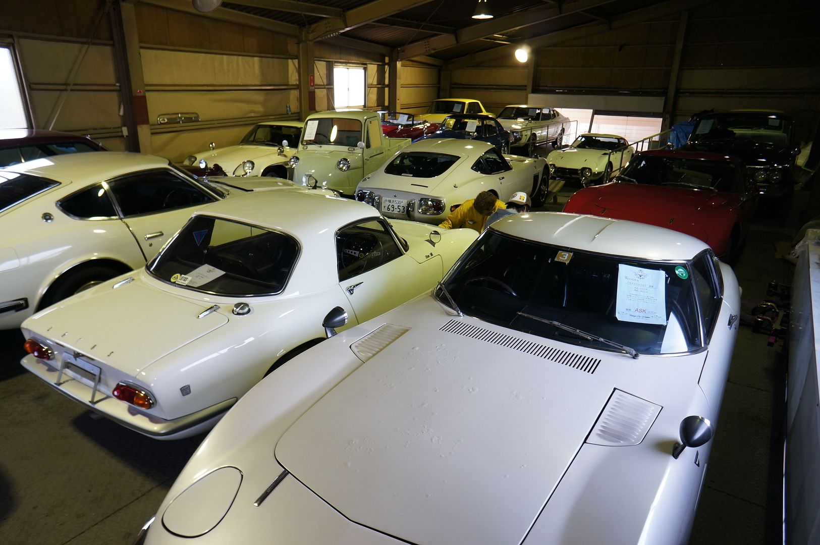

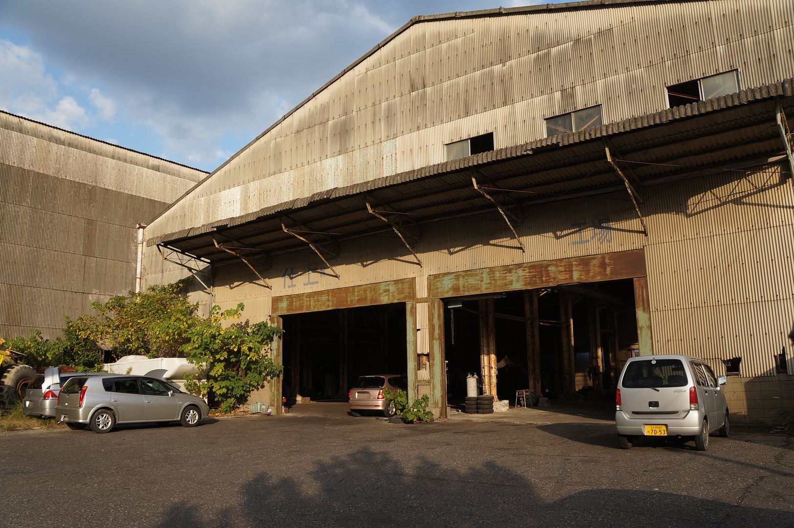

A quick run down to Kokura to inspect Automotive Plus' new storage facility.
Not a bad view from the facility...
Also dropped into....

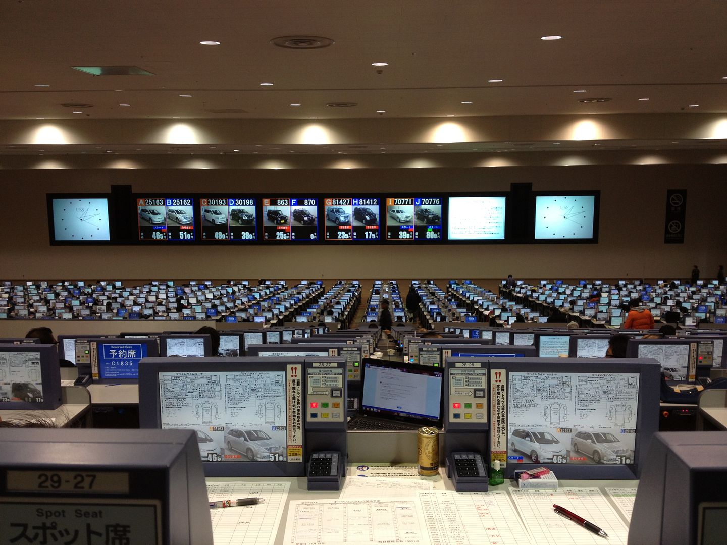

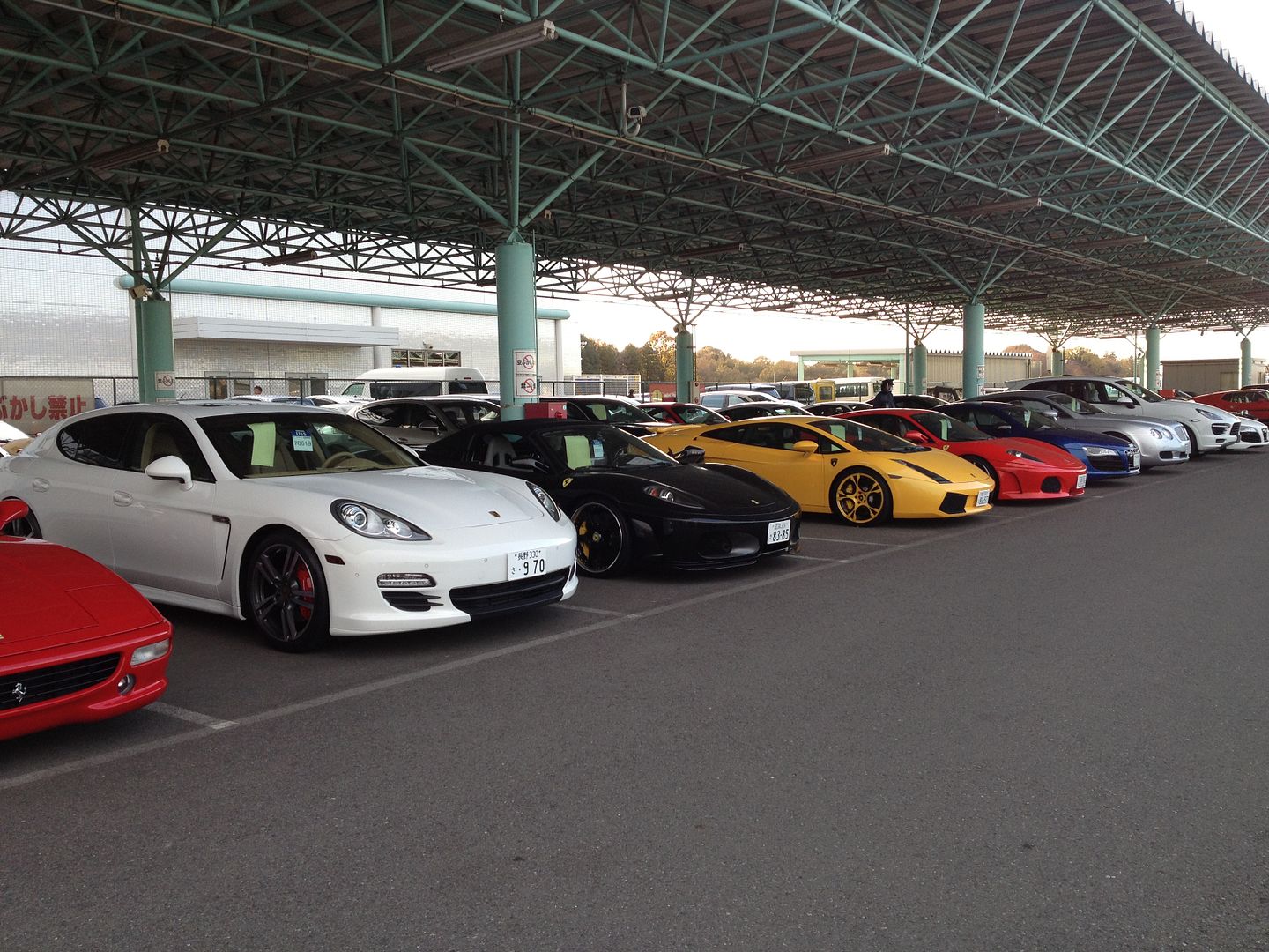

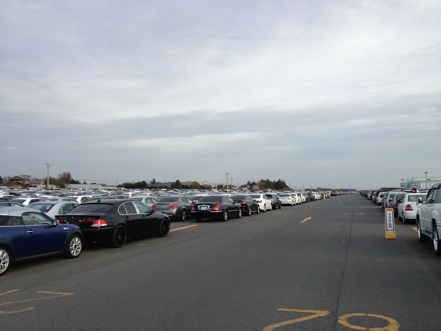

An unexpected visit to USS Tokyo auction house. The biggest in Japan - 10,000 cars auction in one day....mind you it's only once a week there though.
Some Euro-trash! :shock:

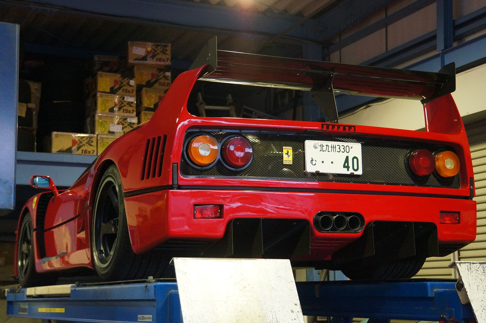

is that an f40 GTE?

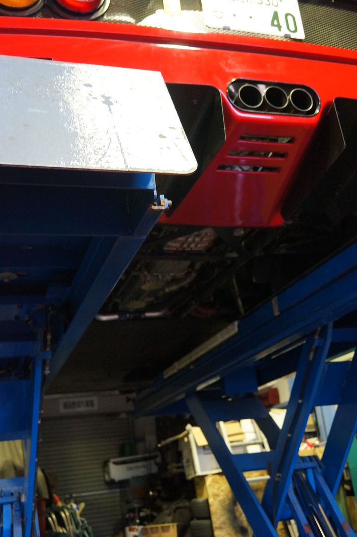

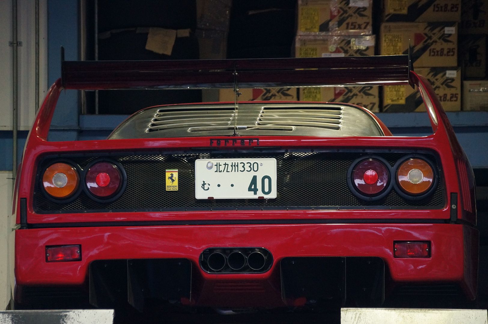

16bit wrote:is that an f40 GTE?
I can't comment on the GTE bit James...but it definitely was an F40! :shock:

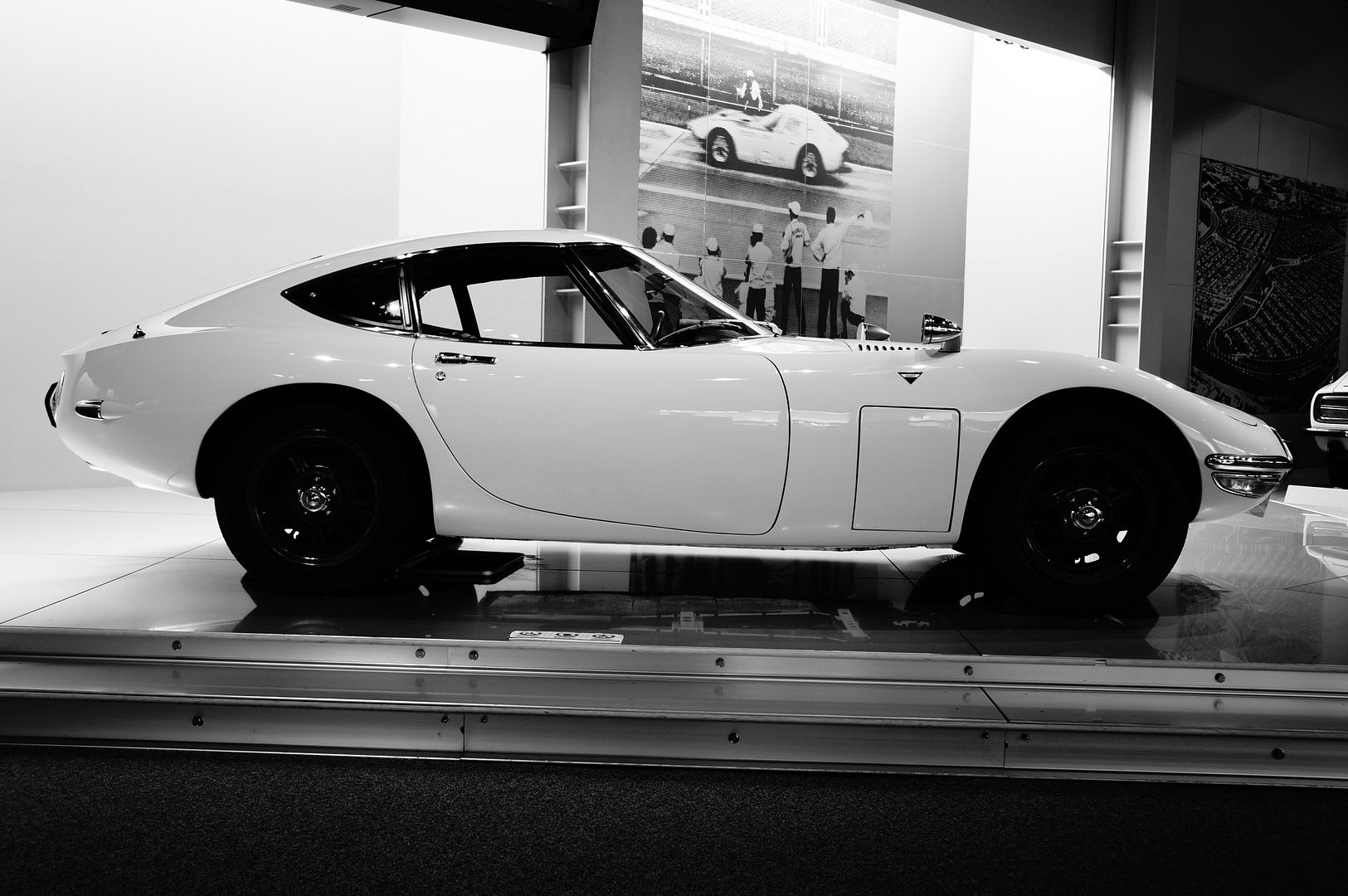

A.Chen89 wrote:whats a mariner blue mx-5 doing in a toyota museum!?

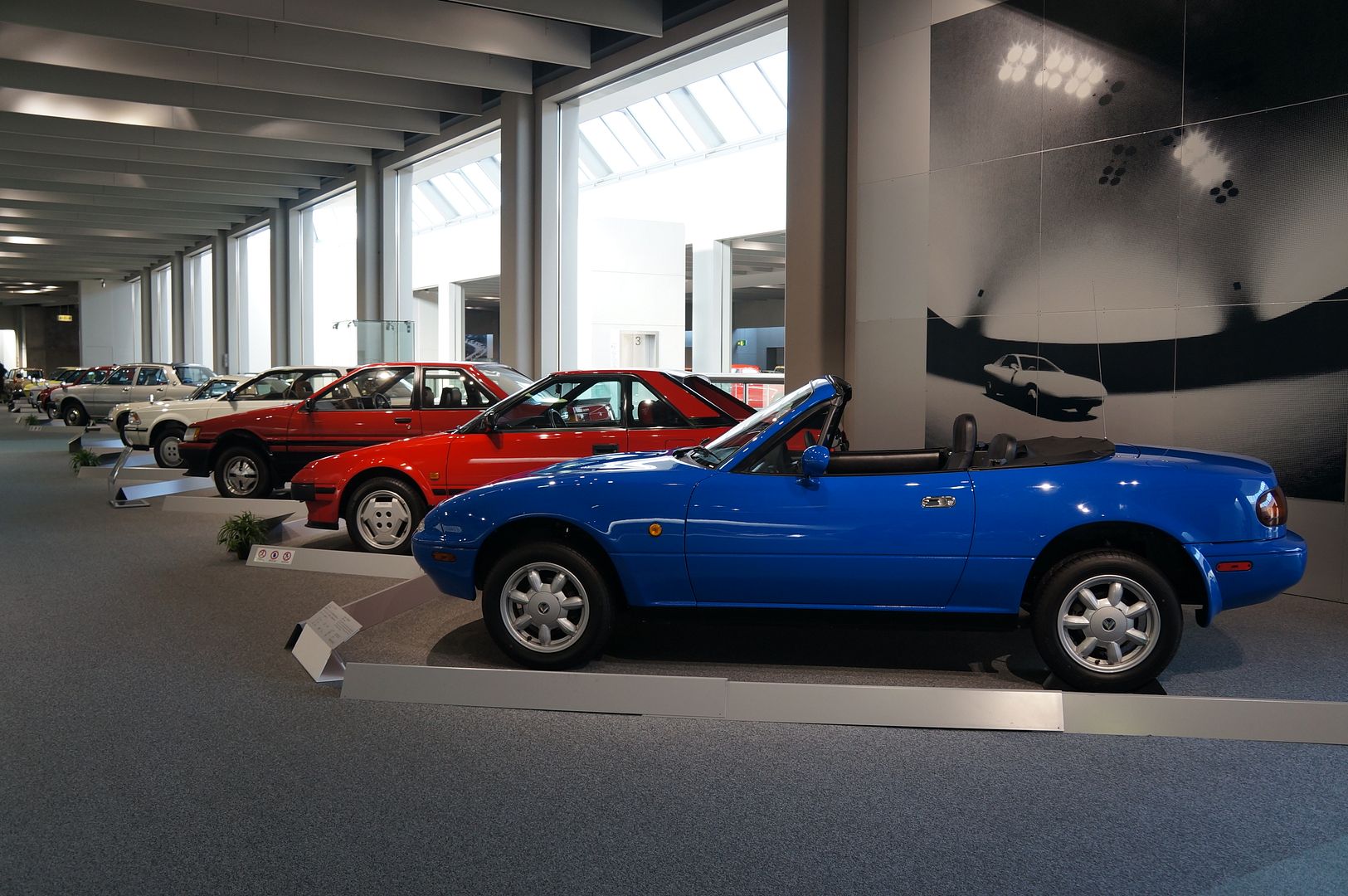

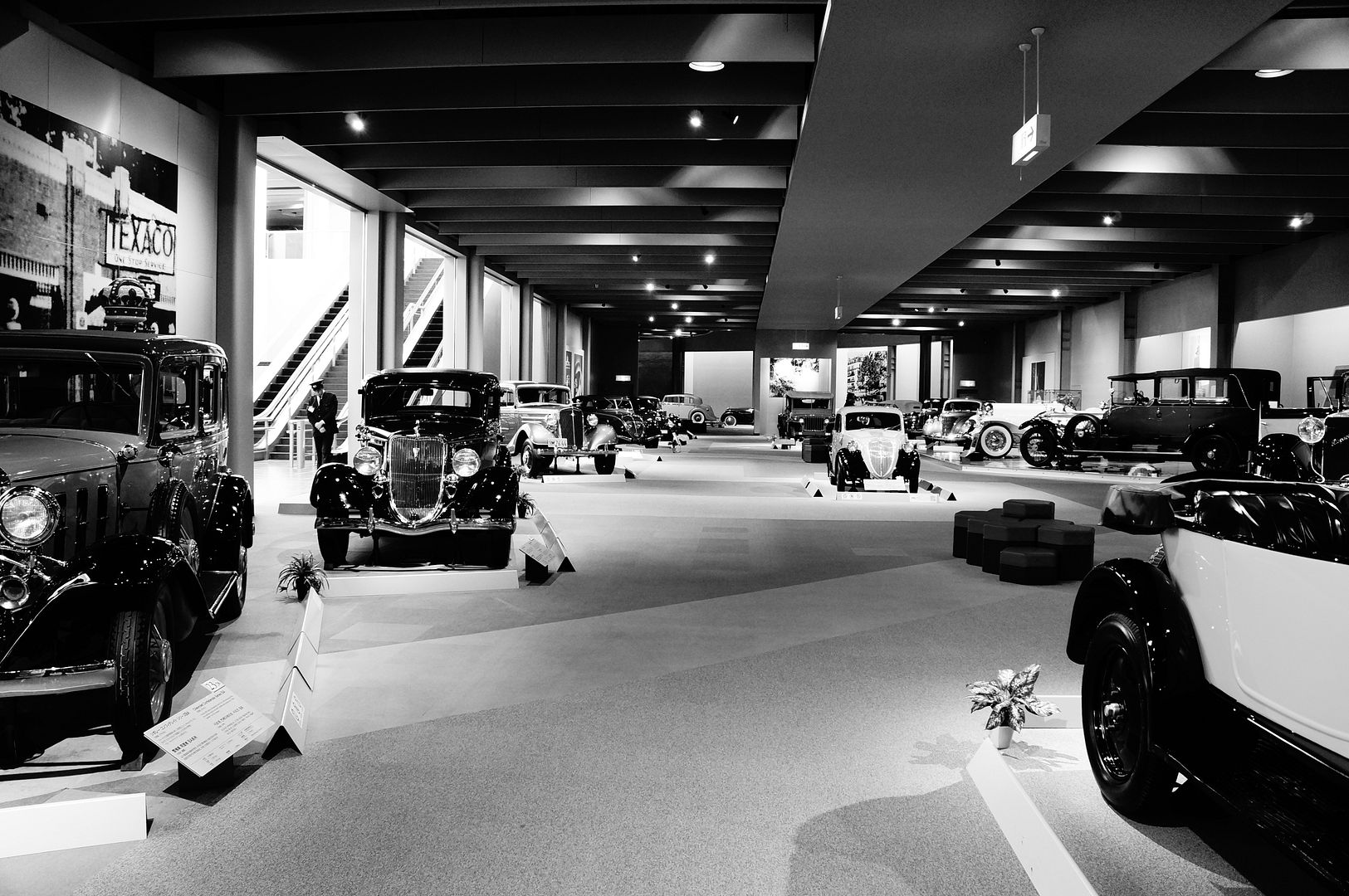

It's an automobile museum owned by Toyota, not a museum full of Toyota's. 8)
16bit
Posts: 2346
Vehicle: NB8A - Supercharged
Location: Brisbane Southside
Postby 16bit » Sun Dec 22, 2013 9:27 pm
that is indeed a gte.
i believe there is less than 10 in existence.
Postby orx626 » Sun Dec 22, 2013 9:29 pm
16bit wrote:that is indeed a gte.
Geebus! :shock:
