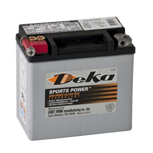

I 3D printed a battery holder out of ABS this morning. It's nice and light at around 110 grams and feels strong enough to take a beating. I like this sort of prototyping, 5 mins with a tape measure, 10 mins 3D modelling and half a day of printing and I have a prototype that should just work. It beats hacking it out of ply.
It is the same base size as a standard MX5 battery with a hole in the middle to suit a Deka ETX12. If I got it right, it should hold the battery in a nice position for the stock clamp.
here is the battery I'm using. It cranks my engine fine though it's first real test will be the sprint day this Saturday.

I use the EXT12 in my car and it's been awesome. It can sit for 3 months and starts the car no problems on a cold day, all day long.
Turbo NB Build Thread | BeavisMotorsport.com | YouTube.com/bbeavis | Cars: NA6, NA8-VVT, NB-Turbo, ND-2L

The EXT12 so far has been fine and would be ideal for normal mx5s. My engine is hard to crank because of the steep ramps on the cams, heavier valve springs and high compression making it really hard to start even when warm. My ait is on the manifold and I suspect that its getting heat soak between runs causing the air temp correction map to richen the tune. This then fouls the spark plugs making it even harder to fire up.
Well thats my theory anyway. The entire tune needs some fixing...
