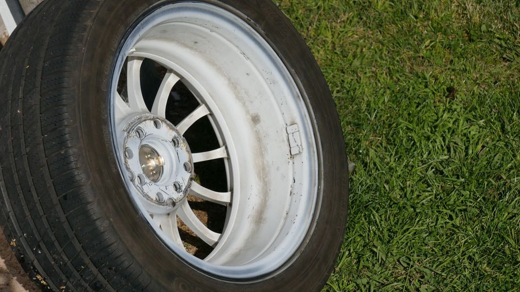

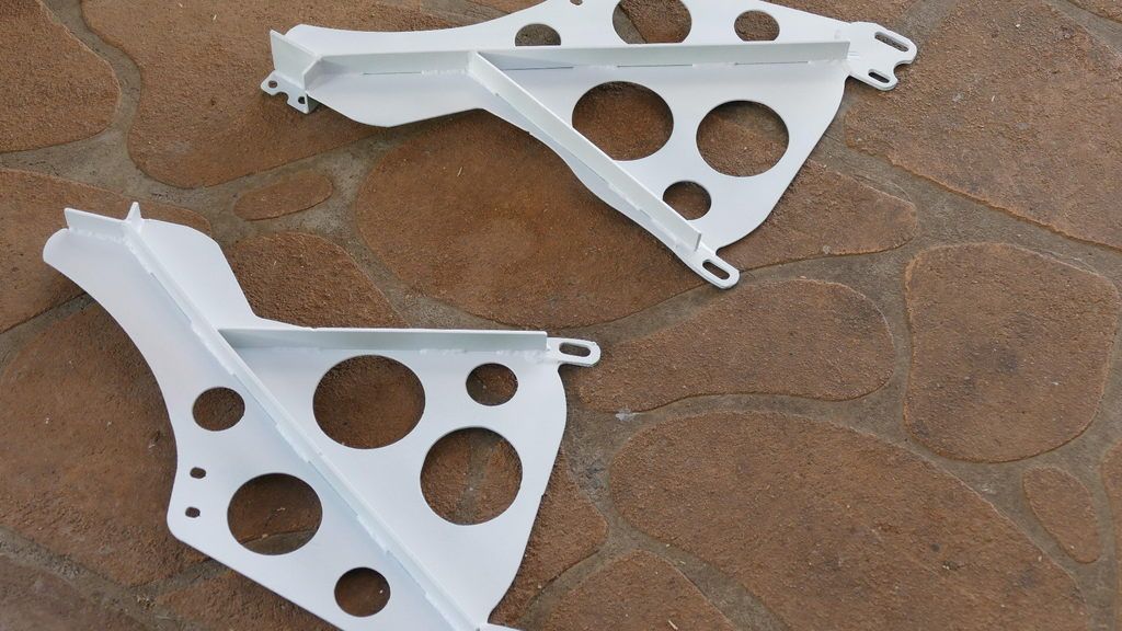

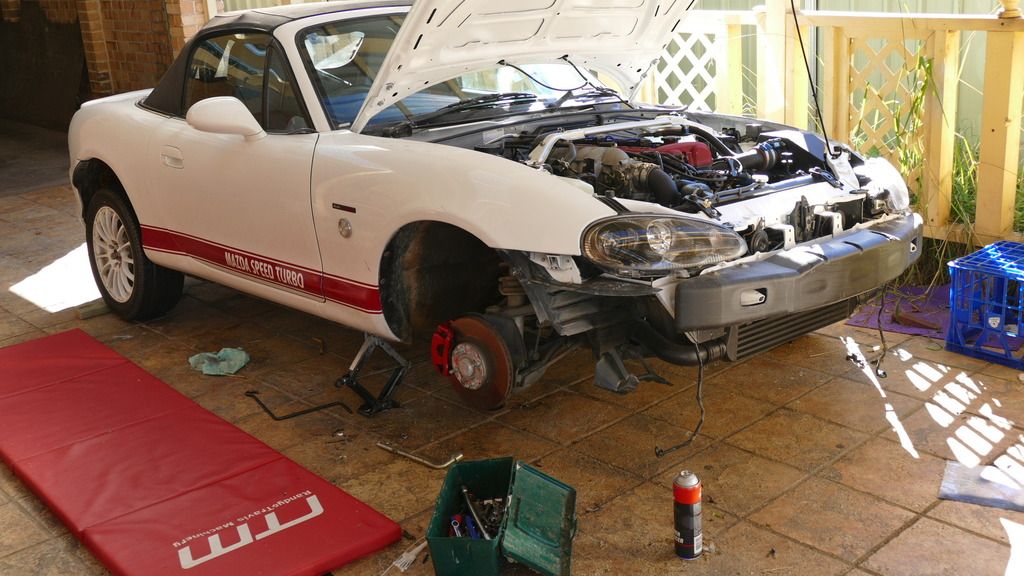

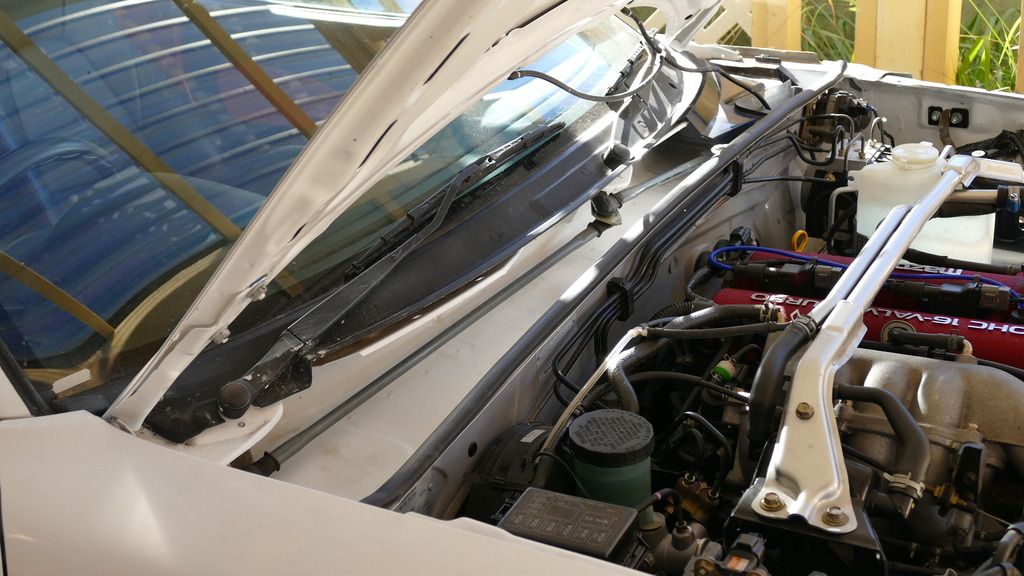

I may go that way too. I just plast-dipped these frog arms today
Postby billybunter » Thu May 14, 2015 4:35 pm

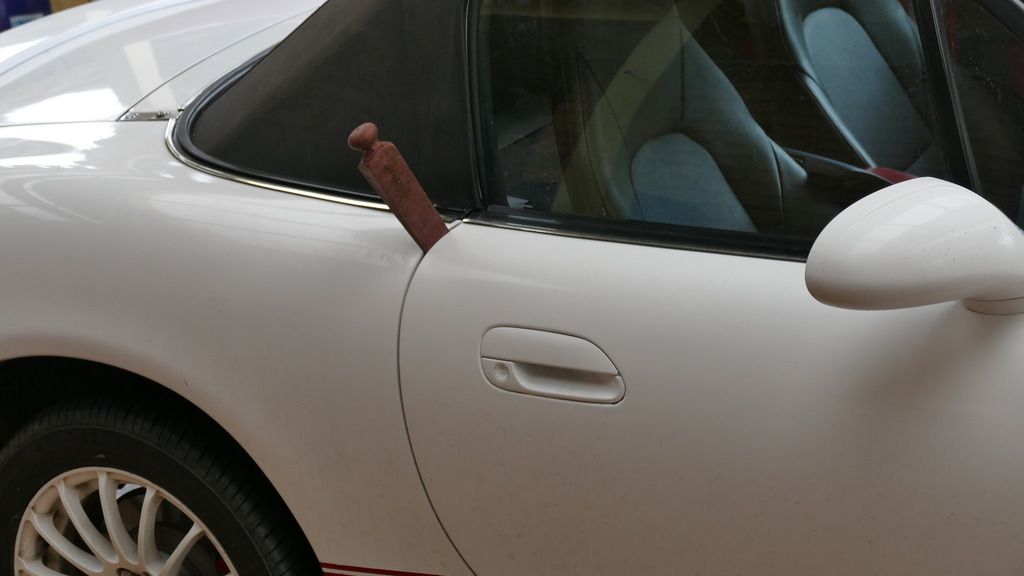

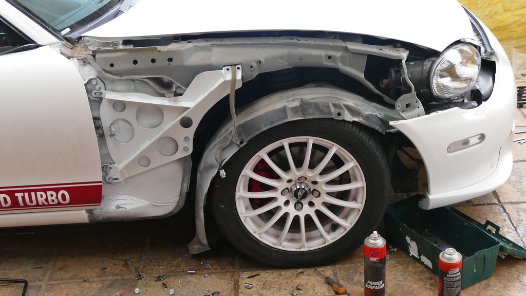

used a door stopper to hold the door in place while I undid the door bolts
and one side almost completed
Postby Lokiel » Thu May 14, 2015 5:58 pm
Glad you painted them white, they would have been extremely noticeable in green against your white car.
Tip: Use your scissor jack to help align the doors correctly and do take the time to do it properly - you'll hate yourself otherwise if they don't shut nicely.
Also, you should use washers on those bolts - get some larger ones from Bunnings because mine weren't wide enough.

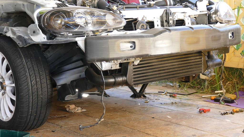

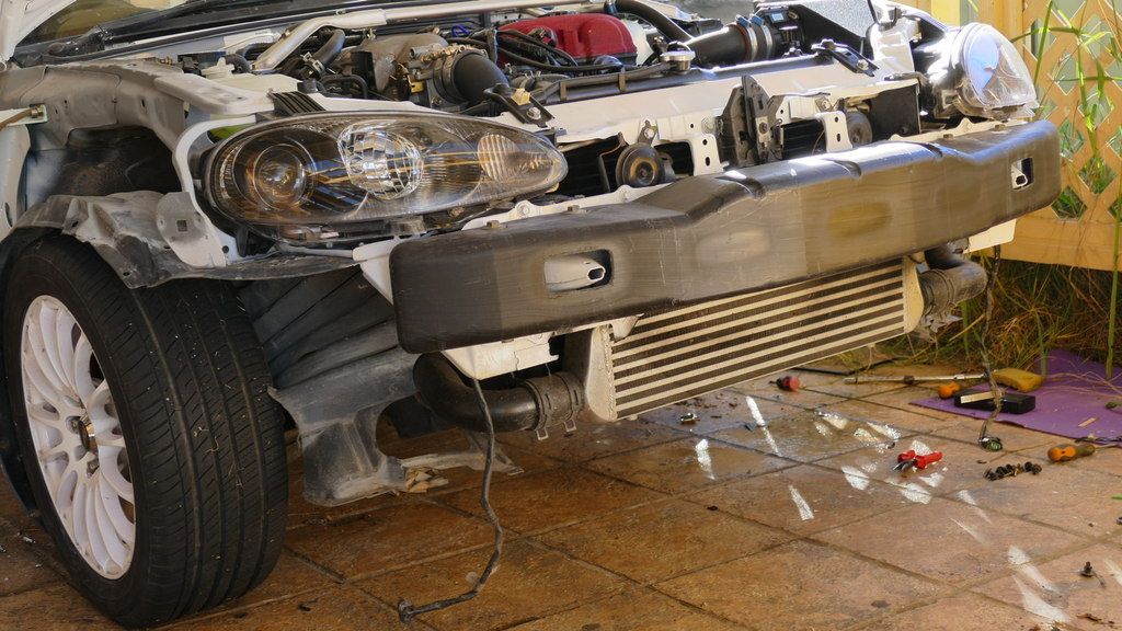

today I hit the intercooler with a bit of stealth paint :lol: just in case I run into the ass of a Porsche on that outback stretch :twisted:

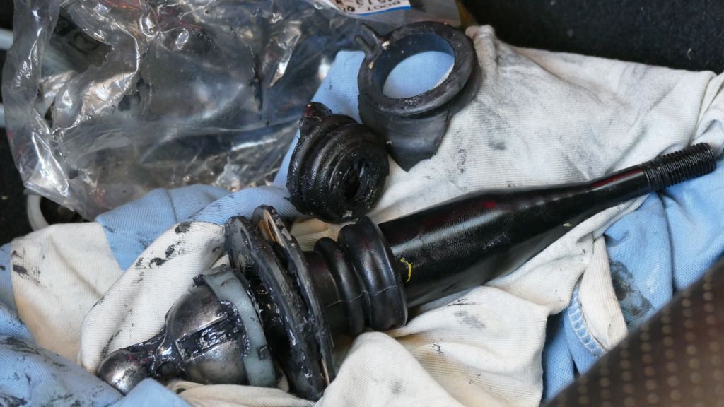

Postby billybunter » Fri May 22, 2015 5:09 pm

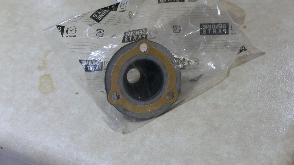

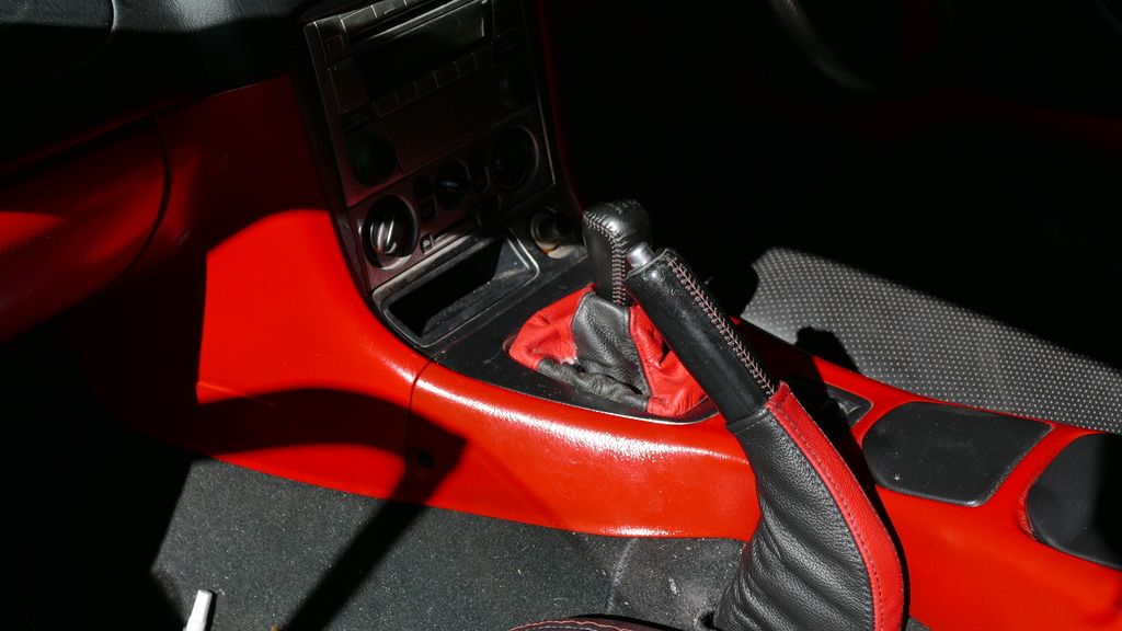

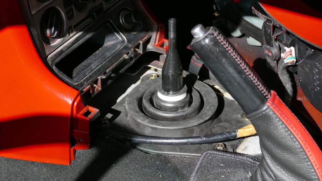

new lower boot shifter seal arrived today

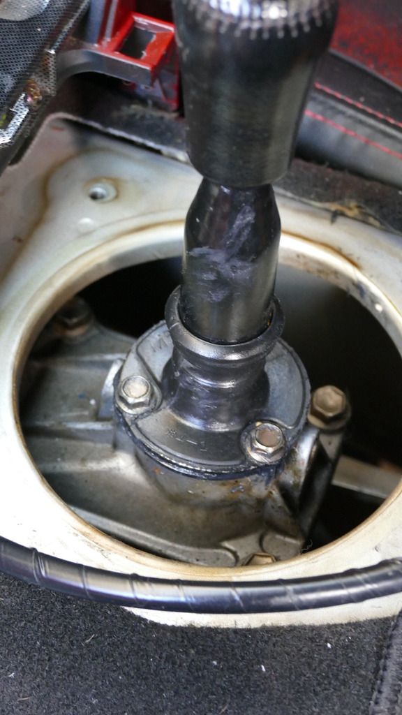

old one was pretty well done!

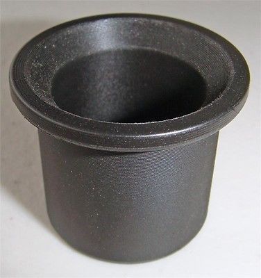

Postby Roadrunner » Fri May 22, 2015 9:38 pm
Is the bushing still in the turret? I noticed it's not on clipped on the end of the stick in the second photo
MeepMeep
Postby billybunter » Sat May 23, 2015 12:48 am
good observation! :wink: I have just replaced it with the delrin shifter tip bushing from miata roadster which so far I am pretty happy with the swap.
Roadrunner
coyotes after you
Posts: 1115
Location: Newcastle
Postby Roadrunner » Sat May 23, 2015 9:18 am
They make a noticeable (in a good way) difference to the shift!
Such a crappy original piece from Mazda. My factory one kept falling off, so put a large washer in the bottom of the turret to hold it in till I upgraded to a short shifter

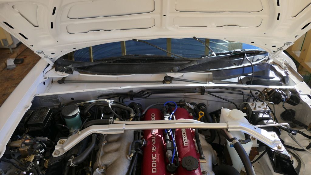

finally after the frog brace install and the door adjustment - one guard back on today

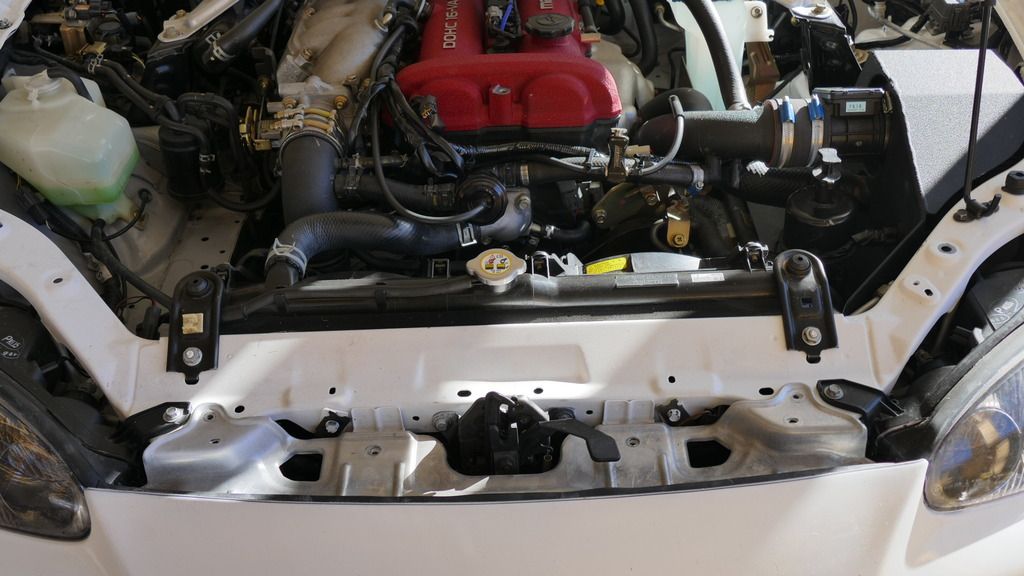

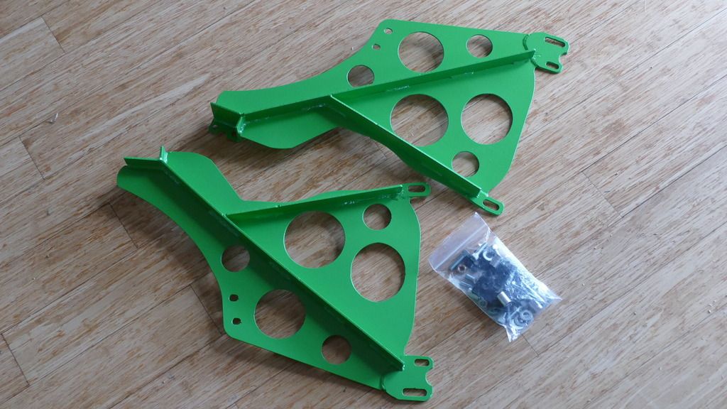

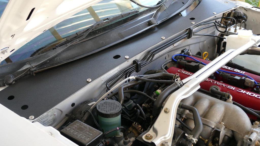

Postby billybunter » Sun May 24, 2015 5:52 pm

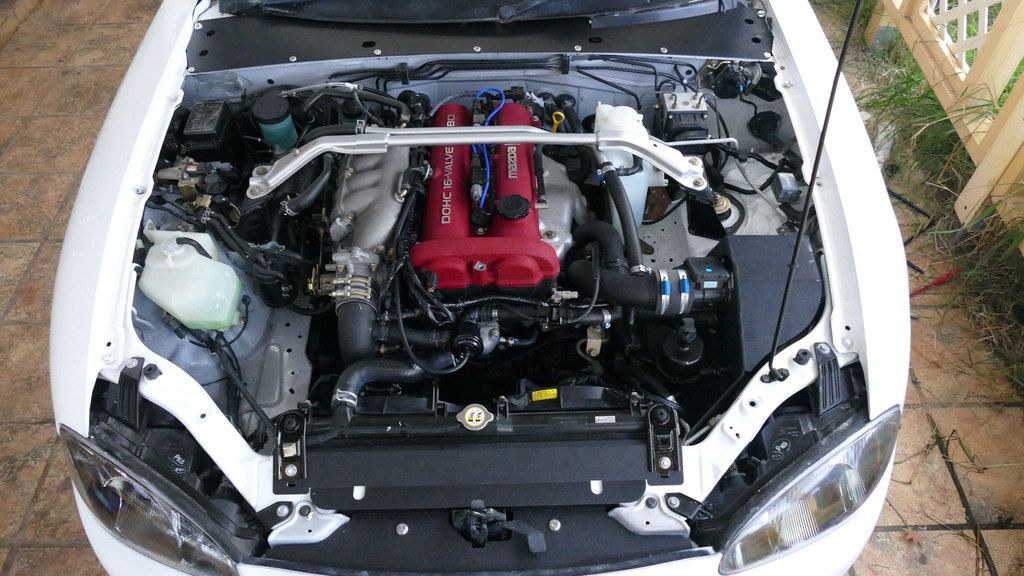

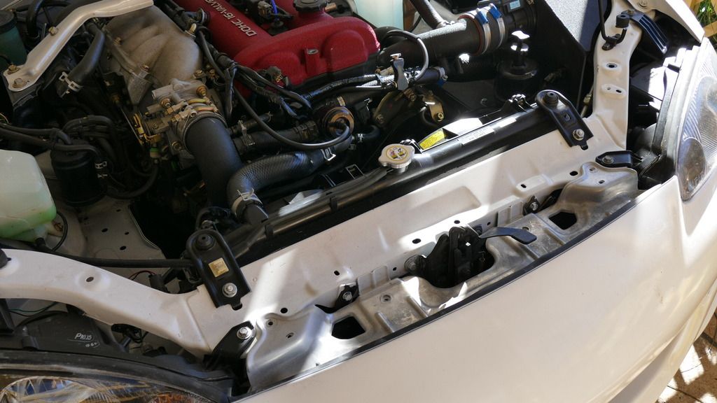

this stuff arrived earlier in the week from garage star in the usa so I thought while I was friggin about with the frog arm install these might as well go on too.
open wiper box locality
following the install

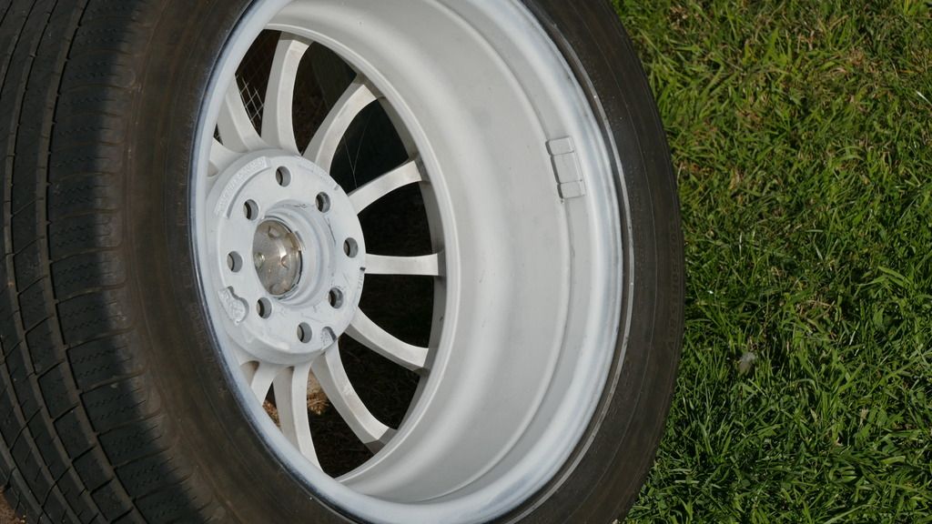

while at the front I decided to redo the inner front rims too.

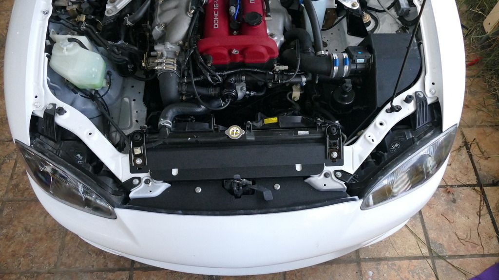

after that the radiator cowling
job completed. not sure if it will help but it looks a lot cleaner

Postby Roadrunner » Sun May 24, 2015 9:58 pm
That engine bay looks far too clean. A drive through the NT should sort that right out :mrgreen:
MeepMeep
Postby billybunter » Sun May 24, 2015 11:34 pm
true! ...what I have plan for it is a pretty long run plus a fair bit of dirt so I guess will either drive it back or scrap it... :lol:
