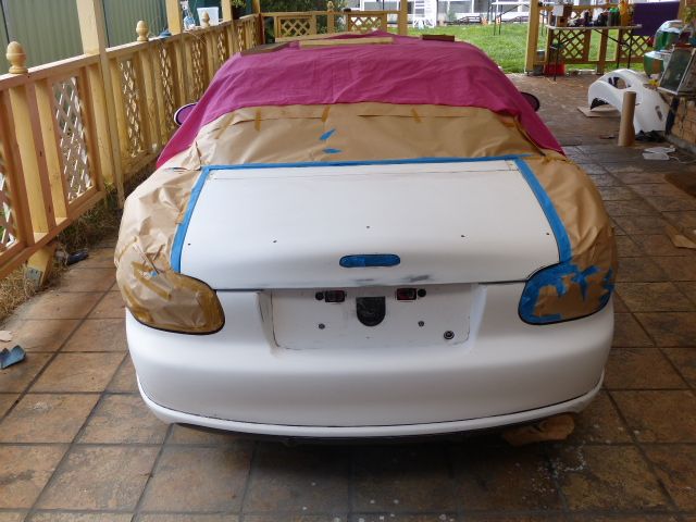

todays run on the car didn't live up to expectations. purchased a sh*t spray gun from supercheap and it had a plastic suction straw. this reacted with the thinners and the suction straw fell into the paint pot and tossed drips all over the boot. nothing i could do but wait it out so i can wet sand it out. try again tomorrow

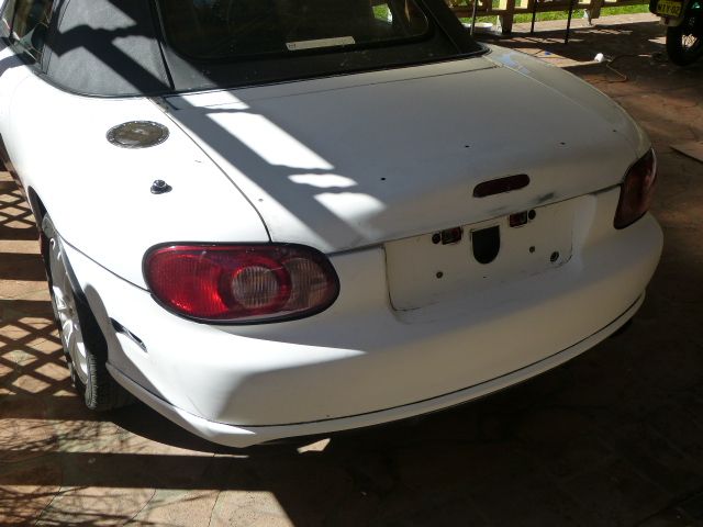

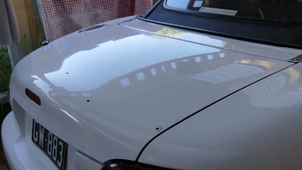

following the re-spray of the front and rear end I applied several coats of clear coat and waited several days prior to the wet/dry sanding.
I start off with 1000 w/d then upped it to 1500 and finally 2000. just quartered the sheets and used the sponge block plus the bit of warm water and a little detergent.
surface nicely blocked out now and ready to be cut polished

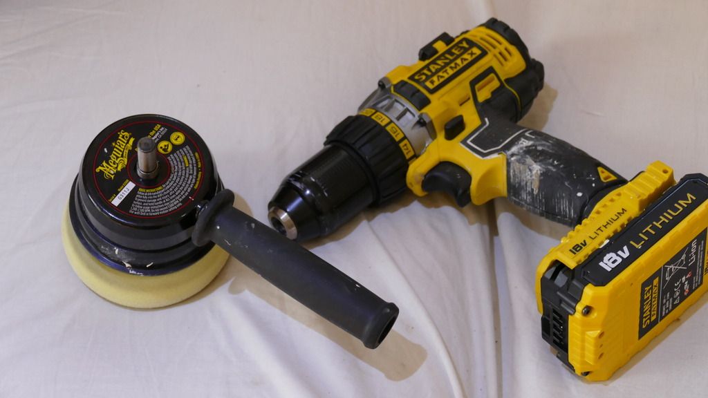

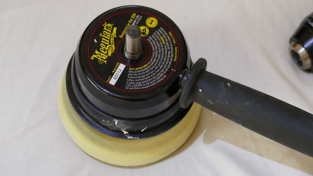

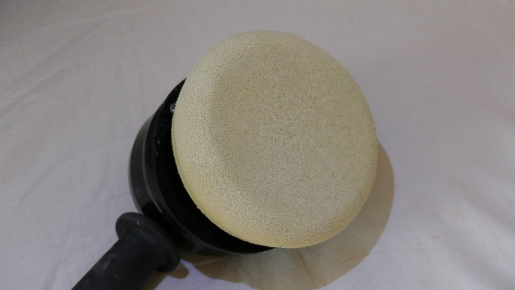

due to many years ago cutting fire wood the shoulders are now shot so I was looking for some easier method than a hand cut/polish. I stumbled across this meguires da 9duel action) polisher and decided I might give it a go.
it attaches to your power drill. the instructions recommend a 240v power drill but my cordless handled it fine
this standley fatmax drill had enough power to handle the job. I applied the cutting compound to the pad and ran it on speed one and after a while upped it to speed two. kept it moving all the time and let the polisher do the work with very little pressure on the handle itself
better look at the foam application pad

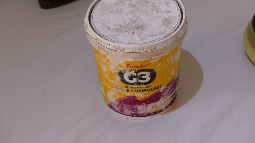

this is a very good fine grade cutting compound, cost a bit to buy but does a very good job....or it has for me

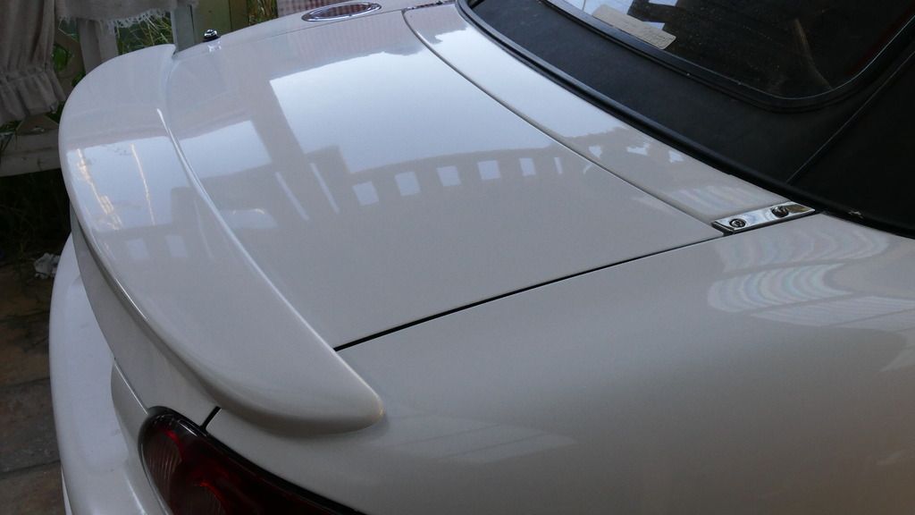

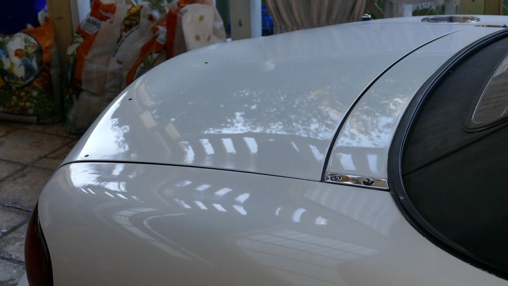

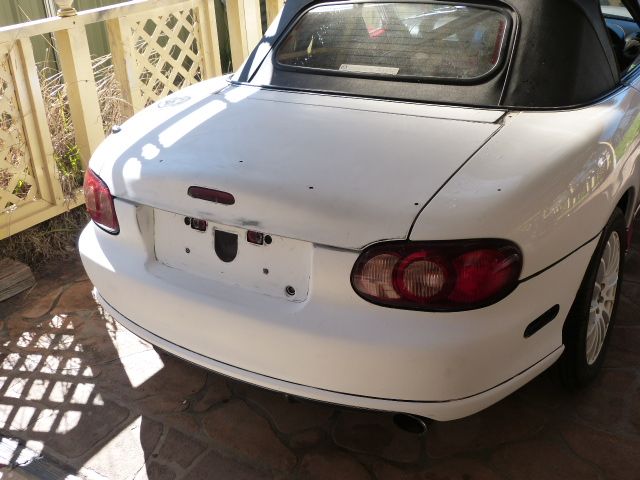

looking over the rear boot to the far side of the car you can see where I cut the clear coat down with 2000 grit wet/dry by the dull appearance. I've always liked the Norton paper. its as good today as it was 25 years ago. no much like that today.
in the foreground you can see where I ran the da polisher and remember this is a cutting compound I have not polished so it gives you some idea it works. well I think so anyway

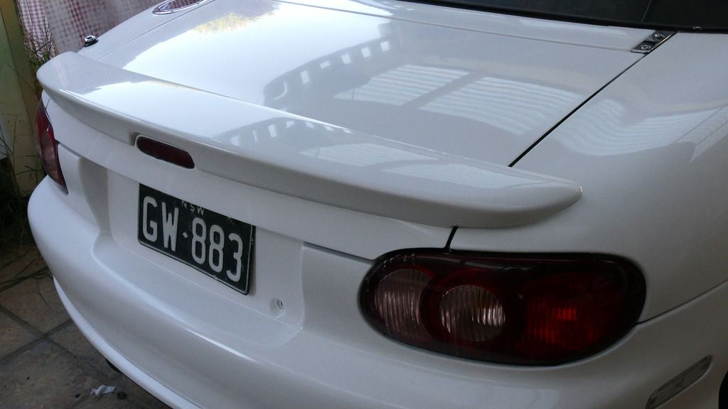

Postby billybunter » Thu Apr 09, 2015 5:14 pm
following the buffing of the tail I then did a quick polish. same place in the shade as we all know we don't polish in the sunlight. well the end results came out alright so I'd be happy to say if anyone was thinking of buying one of these polishers to polish or do a bit of buffing on their car I think the $120 outlay was no a bad price to pay for it.

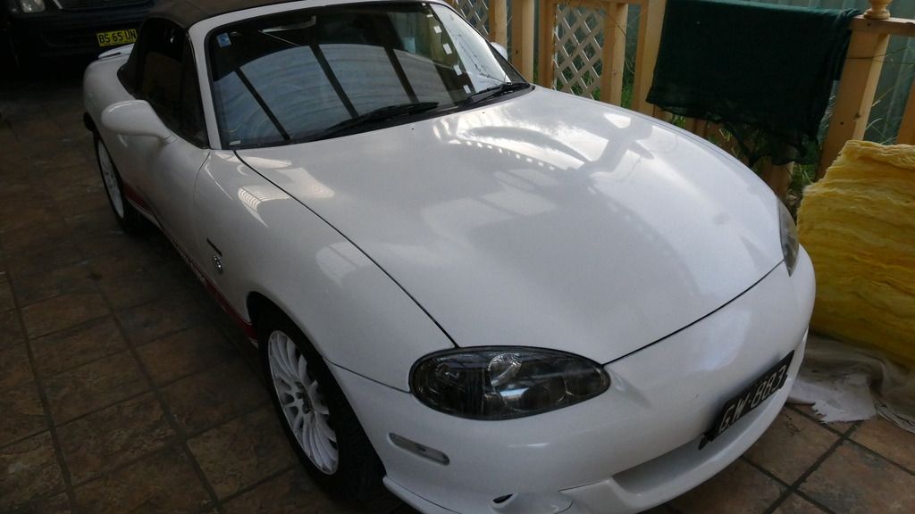

Postby billybunter » Thu Apr 09, 2015 5:50 pm
Postby billybunter » Fri Apr 10, 2015 6:31 pm

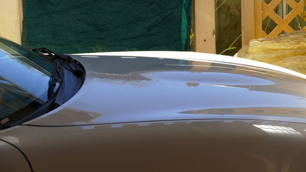

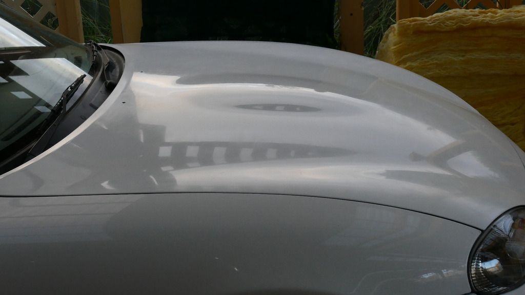

bonnet sprayed and clear coated then rubbed down first with 1000 grit wet/drit follow by 1500 and finally ending in 2000 grit
following same procedure as the boot lid
still have front and rear bars to go. not too sure if its really worth the trouble. I plan to take this car for a run to the open speed section of the n.t. in early july and that's around a 9,000kl trip. I'd say a good possibility of stone chips and I will most likely be painting it all over again.
anyway I will see what pans out. I still have the doors to do.
