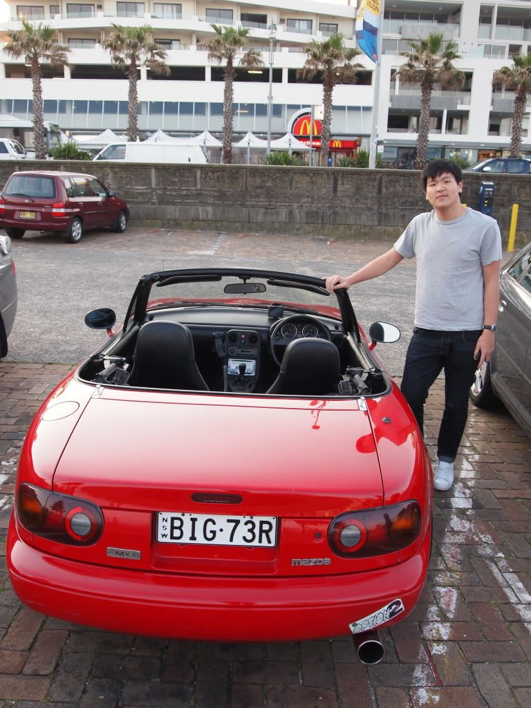

Cruising with my sister (visiting from Indonesia) from my place to bondi, produce quite interesting photos:

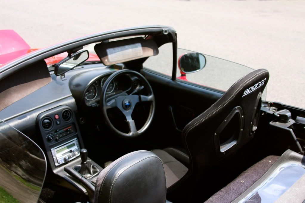

Postby JeremyH » Sun Sep 25, 2011 5:20 pm

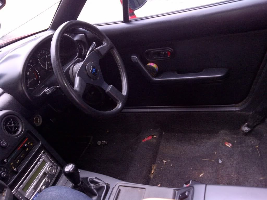

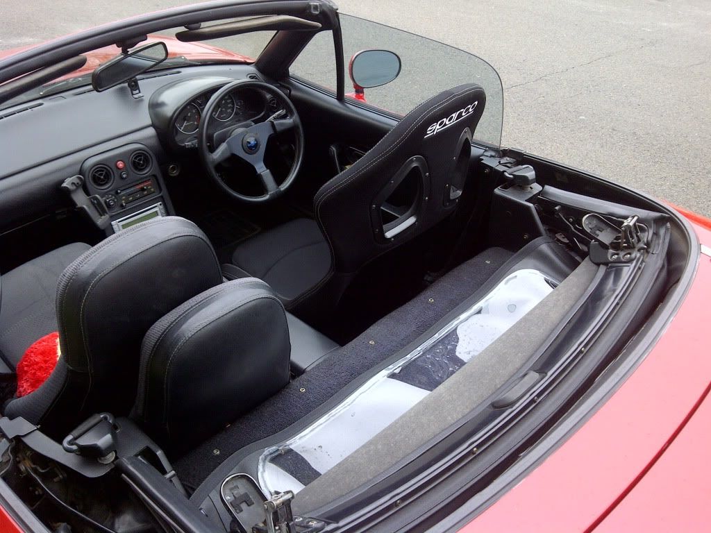

My bro letting me borrow his Sparco seat pulled off from his car. It's a Sparco Chrono i think.
I have tried to pull my stock seat out, but the bolts are stuck and have try to spray WD-40 but still not working,
So i did pay for a mechanic for 50 bucks, which is not bad, to do the Job. I just drill two more holes on my stock rail and that's about it.
If anyone want to know the workshop:
PROWORKS - 553 Bunnerong rd, Matraville
Richard - 0414588221 just tell him from Jeremy.
Nothing special about the workshop; but if anyone need little bits like me, he's fine with the job.

Postby Apu » Sun Sep 25, 2011 5:42 pm
Nice seat! Did it fit right in and can you slid it back and forth without it rubbing on anything?

Postby JeremyH » Sun Sep 25, 2011 8:27 pm
Apu wrote:Nice seat! Did it fit right in and can you slid it back and forth without it rubbing on anything?
Yes, it can move back and forth without rubbing anything :) Good fit

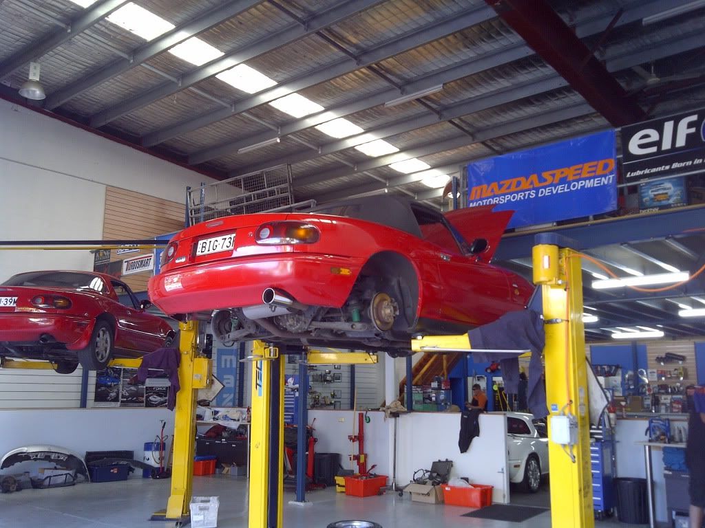

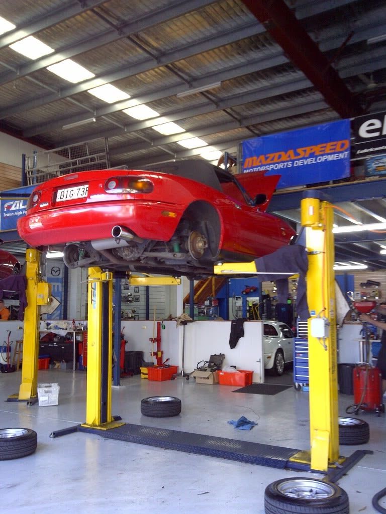

Postby JeremyH » Mon Oct 24, 2011 11:35 pm

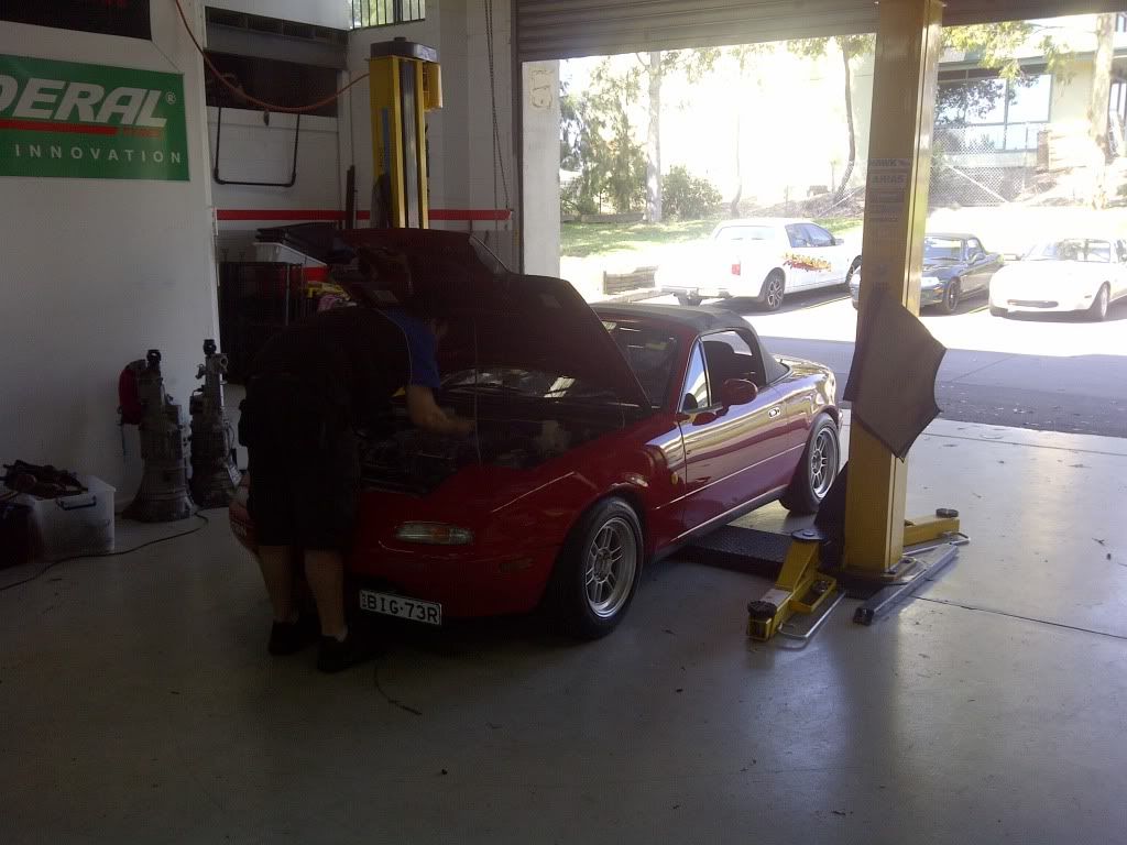

Today, i drove up towards MX5Mania to do service..
They check the engine and found out the engine is still running well..
So i don't need to replace the motor or doing any major service.
Basically, They found out that the main leak of my engine is from the CAS sensor and have the seal replace.
I have bought a PROTORQUE valve cover gasket, but it didn't fit, so it's not installed and mania have no stock of genuine ones.
They set my timing to 14 degrees since i'm running BP Ultimate 98, which i found out makes a lot of difference.
Change the oil and some logbook adjustments, ETC..
I have my window fix, new cables.
They check my drainage holes and they are all blocked haha..
Lots of small things i didn't mention, but it is really worth it..
Going home with a smile, and i can really tell the difference.
It's just feels solid now :) Cheers
