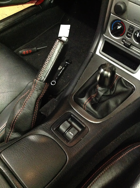

Firstly...ProjectG. Really liking the new boots. They arrived with a few Project G Stickers, a number plate surround, some postcards (featuring slammed MX5's) and a lollie. It was like a little MX5 showbag. The boots were an easy install. Removed the center console and the factory boot. Four screws hold in a little cradle and the boot has several holes which fit over some plastic clips. The Project G boot has the same holes, so it was a direct replacement.
The handbrake boot was a simple matter of removing the plastic factory surround which is held on with just one screw. Then slide the leather boot on. I just pushed the excess into the carpet. There is nothing holding it down but it sits well and looks a lot better than the factory plastics. The red stitching also matches the factory SE stitching very well...you would think it was factory if you didn't know better.

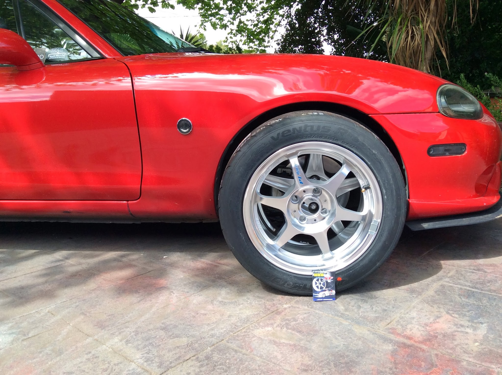

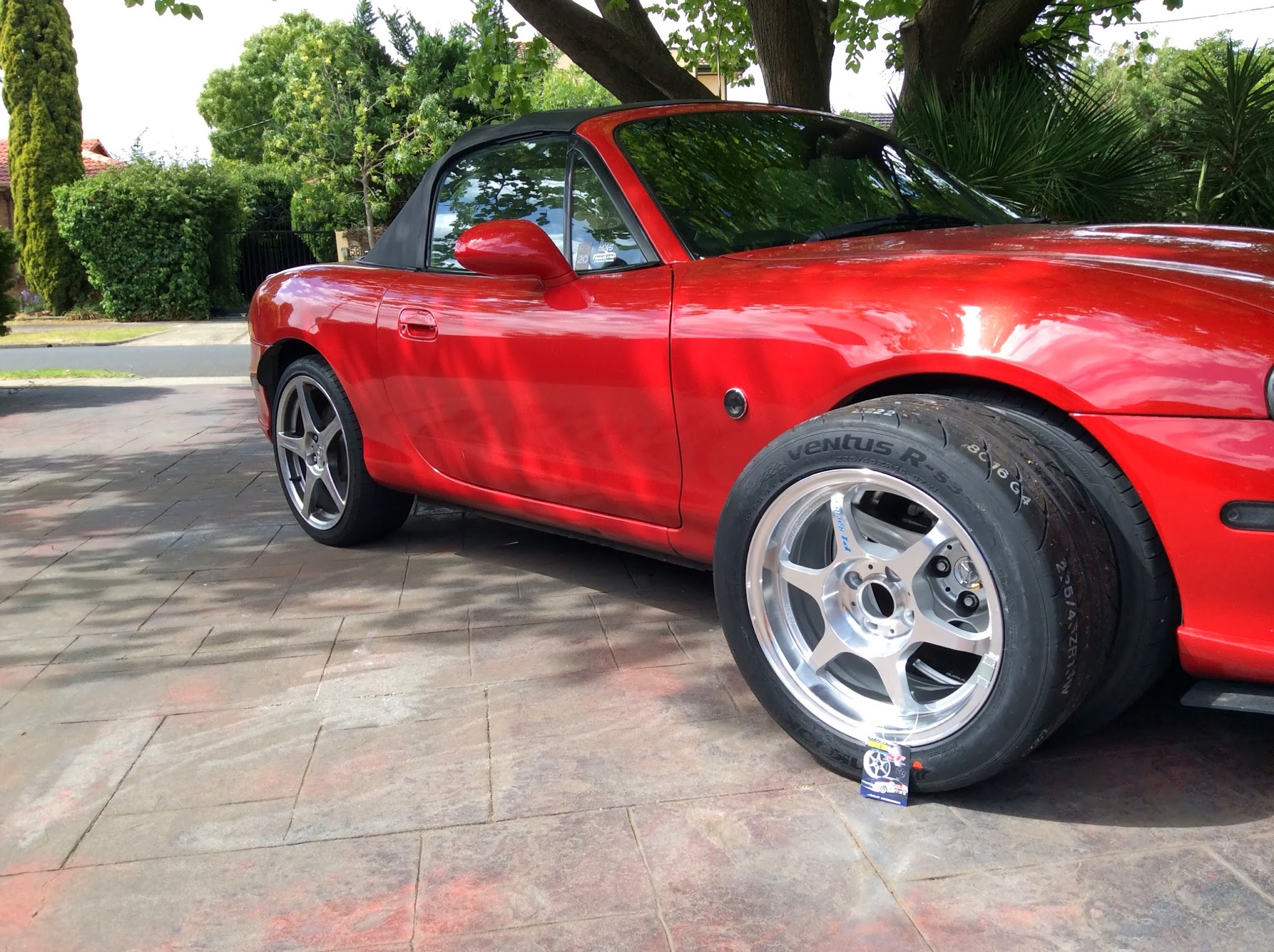

Present arrived today but family holding put until my birthday in a few weeks. For now I just have photos.
Buddy Club P1 SF with Hankook Ventus RS3 225/45/15
