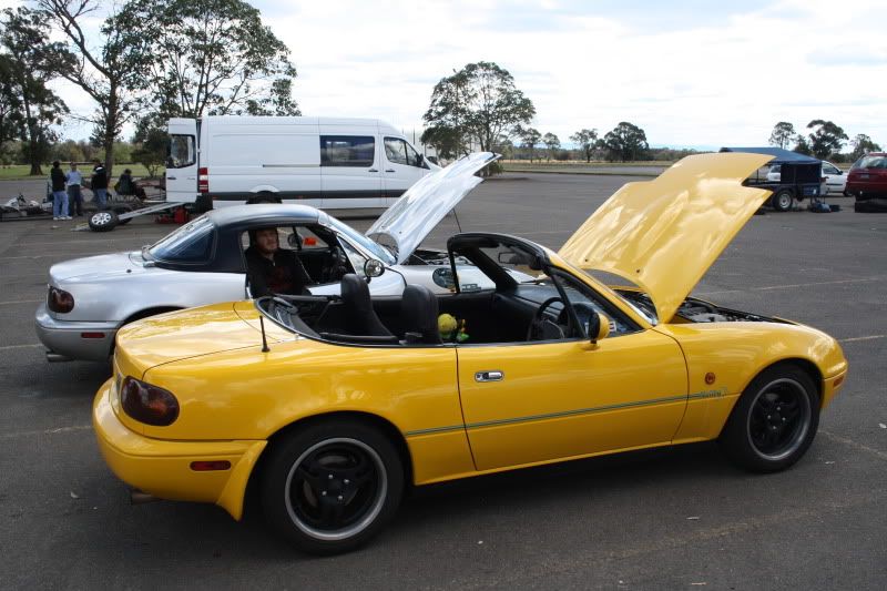

So my brother and i joined up with JSCC, Japanese Sports car club http://jscc.asn.au/index.php.
Decided to enter round 6 of the NSW MOTORKHANA at Nirimba.
Was a great day. Alot more relaxed compared to a track day.
All first gear action but do not make the mistake i made thinking it would be easy :lol:
I think the MX5's surprised a few people though which is always fun.
It is a field dominated by early model Mini's and Golfs.
Found out pretty early that our handbrakes where not upto scratch, so decided to just try and get the best smoothest lines possible all while trying very hard to not forget the patterns through the flags.
My clutch was another thing that really showed it was almost time to retire it!! So that will be changed very soon.
It is a great form of motorsport which teaches car control with very little chance of doing any damage to the car or driver.
I think the only real damage you could do is to hit a flag hard and maybe scratch something.
Another bonus is its $60. With a little wear to the tyres and very little to the brakes.
Besides coming to a stop, you never really touch them.
Some pretty cool cars turn up to these things too.
And there is plenty of time to chat with the owners.
I had a blast, and will be at the next one in october.
Hope to see some other MX5s there!!!
Though i think next time i will tighten the hand brake, grippier tyres up front and some old hard rubber at the back 8)

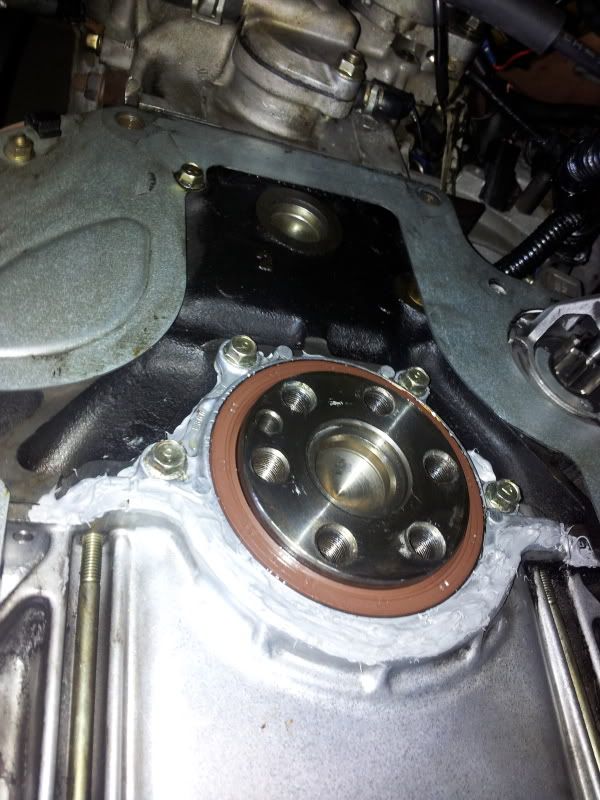

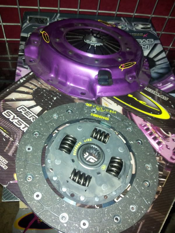

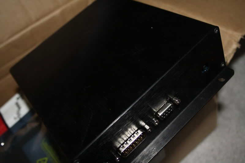

I have just finished a clutch job, with some hassles some might have seen with the rear sump seal.
The last owner/mechanic when they had the rear seal changed used like glue/silicone to hold the rear main in.
So i had to remove the housing and word of advice to anyone listening.
This brings a world of PAIN!! :evil:
To replace the rear half moon, it seems you need to remove the sump as the new rubber seal is too thick.
I reused the old half moon, cleaned the area all up and used Loctite Grey RTV.
I then let it cure for a day or so before installing the rear main seal.
It looks a little messy but seems sealed.
If it does prove to leak then i will just pull the engine, remove the sump, and maybe do a bit of a rebuild on the engine.
Hopefully this will hold though.
Anyways, eventually it seems i have that sorted.
More K's will prove it though.
I used a Xtreme HD kit which oddly came with a LUK friction disc. Last time i used a Xtreme kit it used a Exedy Friction Disc.
I do not know much about LUK discs, i just hope it can hold the extra power it is about to receive.
I replaced the Pilot bearing, Rear main, Front transmission seal and gasket and new rear transmission seal.
While in there i also replaced the rubber water cap at the rear of the engine and the CAS O-ring.
Took a bit of effort to get the gearbox back on but it seemed to slide home quite easily once i had the box up in the air.
Now onto the fun stuff.
Since my last update i have collected quite a corner of the spare room of goodies. :twisted:
This will all be going in shortly.
I finish up at work this week, going away for 2 weeks then unemployed!
Sounds like a bad thing i know, and it may prove to be.
But after 6 years of crazyness it will be nice to do a few things slowly and at a more thoughtful pace.
Though the cash flow may be an issue. haha

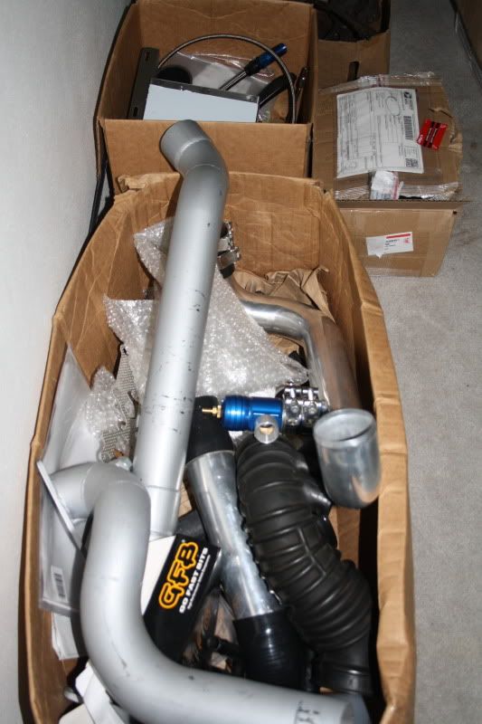

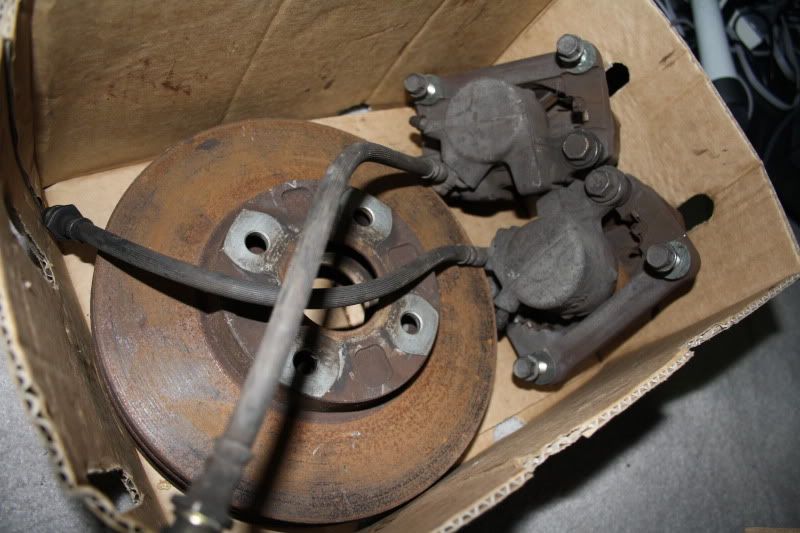

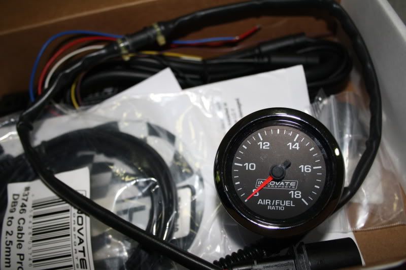

So a brief summary of what i have is-
-Megasquirt (Braineack build, huge THANKS to Caffeine for the soldering fix that Brain missed)
-Innovate LC1 with analogue gauge
-ETD Manifold
-Mitsu (Greddy) TD04 Turbo
-Turbo Tony Downpipe
-Pretty much all stainless lines and fittings
-Stealth BOV
-Stage 8 Locknuts & tabs
-NB8a Front Brakes

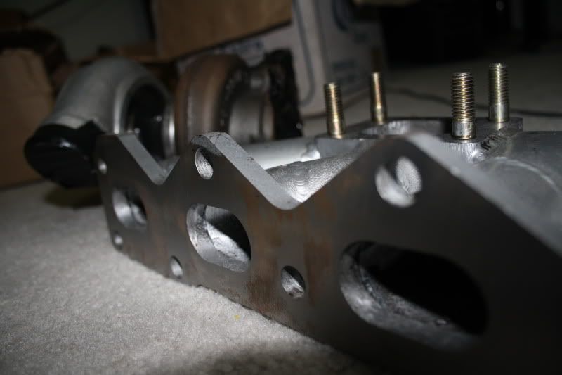

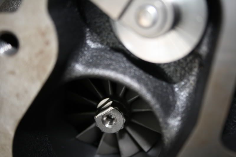

The manifold and turbo have had a few issues.
Upon receiving the kit, i realised the turbo took 8mm Studs, while the manifold was drilled for 10mm.
I have enlarged the turbo holes to take 10mm.
The Manifold also was warped and no surface was properly flat.
After some advice from NitroDann i had the manifold surfaced to be dead straight so hopefully i can get away with no Turbo Gasket.
Still need to sort out an intercooler etc, but the plan is to get the car running on the MS, while still NA, then install the turbo gear.
Should be a fun few months.

Does anyone recommend making relief cuts in the manifold?
Would these be necessary??
I have the manifold machined and am worried if i get relief cuts made, it may screw up the surface?
On the other hand i do not want to crack and break studs etc.
