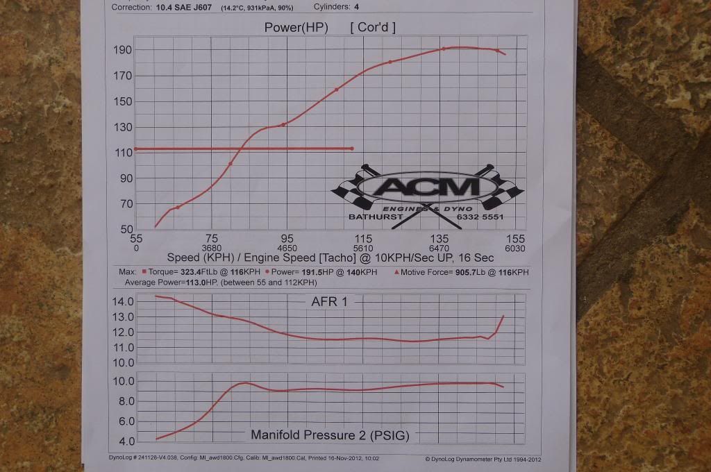

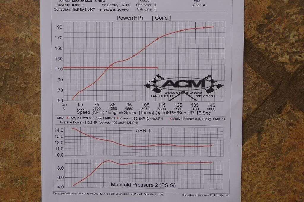

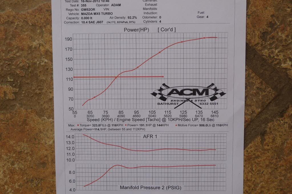

well the upgrade turbo is back in the car. upgrade include a 15t mitsubishi wheel-larger flapper and ported.
i had the car dynoed yesterday. prior to the upgrade - on a previous power run it make 168 rwhp and yesterday with the turbo upgrade 191.5 rwkw
only drama - i now have a bit of turbo flutter or something

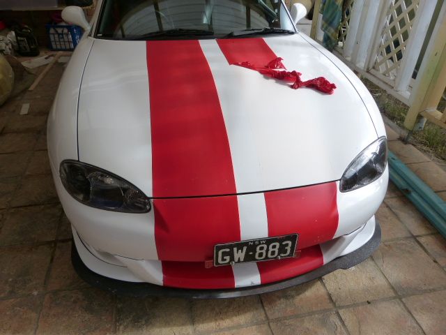

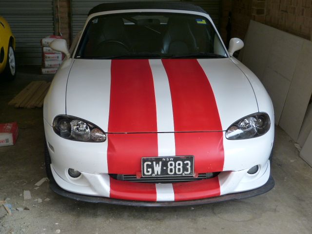

stripes on today in plasti dip.

Dyno sheets show it really wants to be run closer to 12:1 AFR, But it looks fairly smooth and good power figure.

nitrodann
what would you do next in this power chasing saga

Billy, how did you get a nice clean edge on the plastidip? Every time I've used plastidip I get a shitty edge from when I remove the masking tape it pulls at the plastidip an gives a furry edge.
How are you doing it?

Pull the tape off while it's still wet. If the plastidip sets, it sets to the tape and will want to come off with it.

Another 10psi.

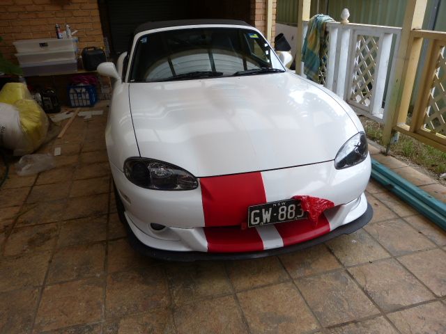

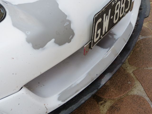

well finally got into photobucket. last time like this
using a heat gun to remove the plasti dip
