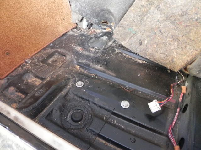

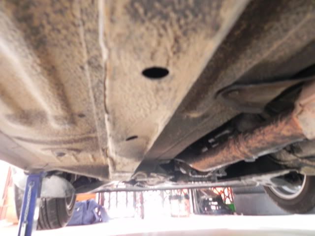

Right, update since I just came inside for lunch. I always knew my chassis rails were bent but damn, never noticed just how much until I tried to put the frame rails on. I took some photos to demonstrate their 'bent-ness' but you really can't see much.
Overall installation seems fairly straight forward but I have got better acquainted with my selection of hammers. Doubt I'll get it finished today as I've got training in about an hour an a half, but I should be most of the way there. Been going since about 1130, so roughly 1.5 hrs so far.

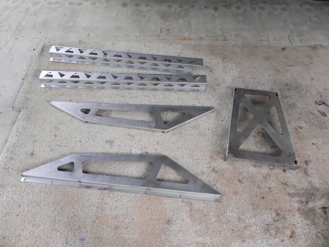

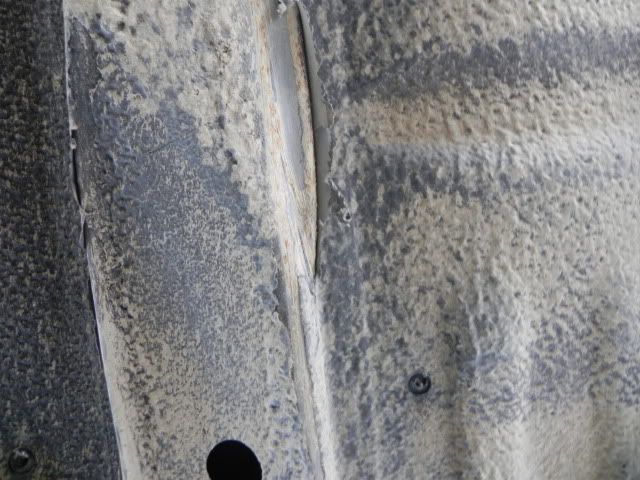

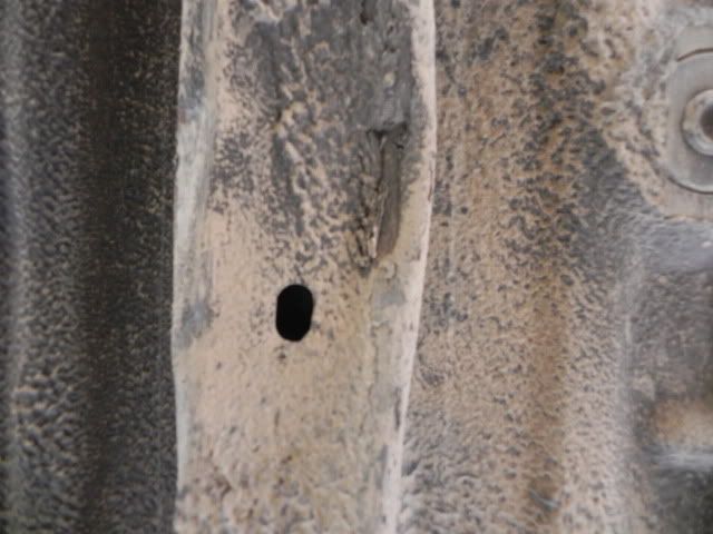

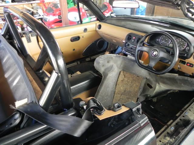

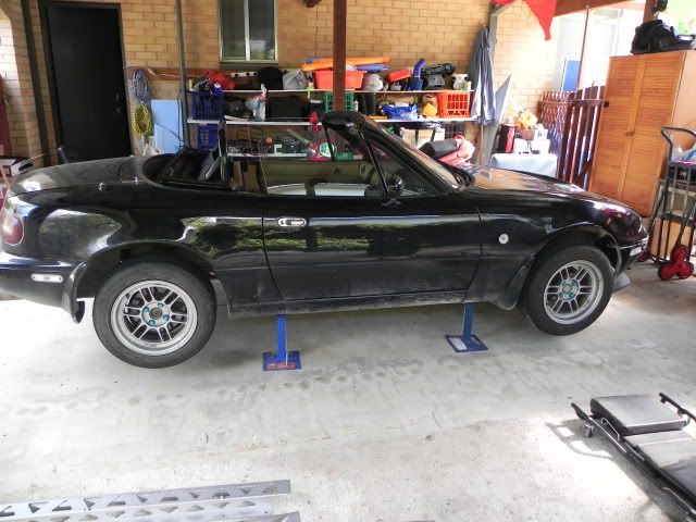

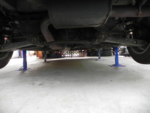

I spent less than three hours today and the frame rails are in. Getting the brace in really doesn't look that hard, just hold it in place, bolt in loosely, adjust and tighten. I however slept in pretty damn well this morning and had training at 3, so couldn't spend a whole day on it.
A good 30-45 minutes of that was me trying to bash my chassis rails back to something like straight so the frame rails would fit, so if yours are in good condition expect to take significantly less time. If you had access to a hoist I'm sure it would be easier, but it honestly wasn't that bad with just the jack stands. Another inch or two of height would have made my life much easier, just so you could get more strength behind the drill. Holding the fuel rails out of the way while you drill isn't particularly fun, probably my least favourite part of the day. Now that I think about it, my favourite part was that you really don't need to remove all that much from the interior. Seats are 4 bolts each, the bottom bolt for the seat belt and four screws each side for the door sill trims and then just pull the carpet back. I was expecting centre consoles and full carpet out, so that was a nice surprise.
Tips!
Don't try to fit the drivers side rail without pulling the fuel rails out of the way. They are there and they're quite important in the grand scheme of things really.
Hammers are your friend.
Pictures from where I'm up to now...
Parts!
Stands!
Bent rails!
What it looks like from the inside!

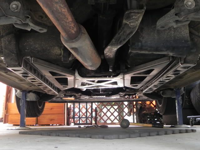

Finished the install today.
Had my house mate help me with the install of the brace. Having another person with me probably would have made the frame rails install a little easier but certainly wasn't necessary; the brace however would have been absolute ass on my own. Trying to hold everything in place and bolt it in at the same time would have been terrible, particularly on the drivers side as the fuel rails most certainly get in the way. Having said all that, it really wasn't that bad. I'm sure a pair of people could punch it out in a day with no troubles.
And now the fun part!
Didn't even finish before I took the car for a drive, put the drivers seat back in and went for a drive. Now I know people have said you could feel the difference just backing out of their drive way, well I could see the difference lowering the car off the jack stands. Initial impressions are pretty well what was expected; the added stiffness is incredibly noticeable through corners with an elevation change and it's far more likely to spin the inside rear wheel. Have a 2 lap hillclimb event this weekend so I'll get my first test in anger on Sunday.

But what you've all been waiting for, more words on the butterfly brace. Basically, it delivers everything it promises. The car feels significantly stiffer in everything it does. It is a different car.
