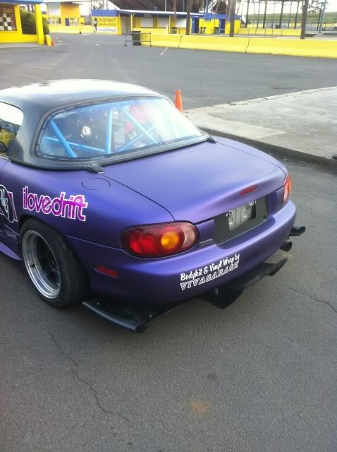

Well i have just had an epic last week. On the lead up to Victoria's biggest drift event my car received a new sponsor in the form of Viva Garage. They are located in morrabin and can supply the front bar and side skirts that i have fitted to my car bellow. 8)
They do vinyl wrapping as well ....which they did to my mx5 aswell ! The color is Matte purple metallic.
Vinyl wrapping your car is a good way to keep the original paint for resale and still be able to have a standout color :)

I had the diffuser on for some pic's.... Viva are going to copy it and supply me with fibre glass copy so i dont smash the original.

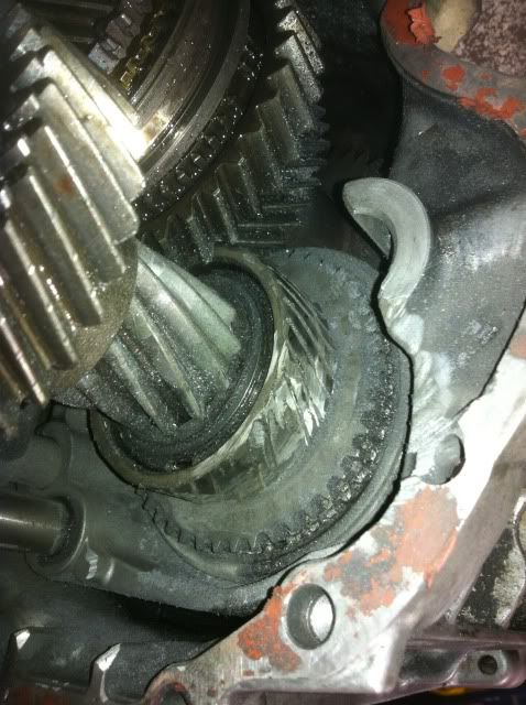

The weekend was a two days of drift, practice on the saturday, and the actual battle comp on the sunday.
I managed to strip 4th gear on one of my scando clutch kick entries :roll:
So i pulled the box out at the track and took it to Rpower motorsport in seaford (sponsor) to help me disassemble it so i could grind th rest of the teeth off the 4th gear cog allowing it to spin free.

Re: Wazman's NB8a
Postby NitroDann » Thu Sep 19, 2013 1:09 am
4th gear... In the dry with good tyres...
Thats a pretty good effort.
How much power do you have?
I havnt really tried gears that high in the dry with less than 300 atw (which is piss easy really).
wazman
Posts: 394
Joined: Sun Feb 15, 2009 11:39 pm
Re: Wazman's NB8a
Postby wazman » Sun Sep 22, 2013 9:12 pm
My car is tuned to run 19 psi boost and it made 223 rwkw at that level of boost. On saturday when i stripped 4th gear i was running 9psi .....so im not sure how much less power that would be.
The higher the cars velocity the closer you are to the tyres sheer point. So its actually easier to slide at higher speeds. I used 5th a couple of times to initiate my "scando" flicks after i had no 4th on sunday.
