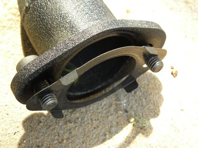

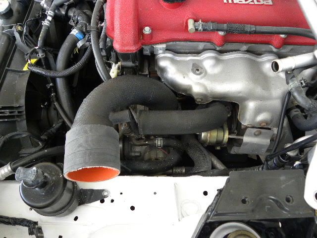

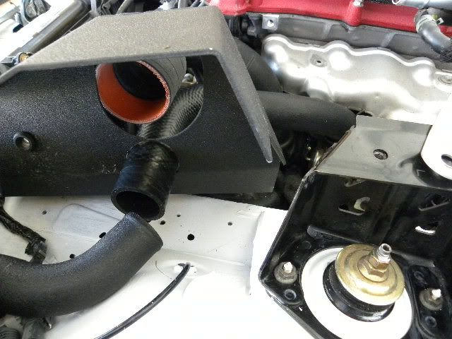

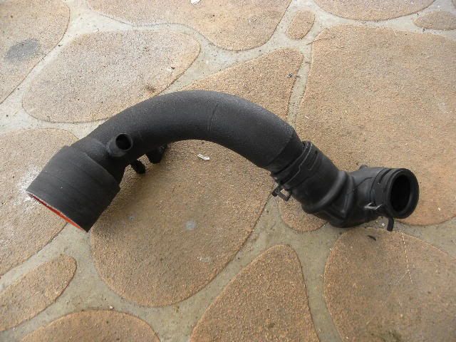

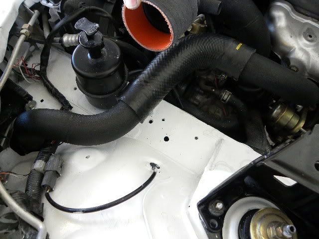

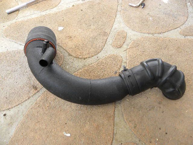

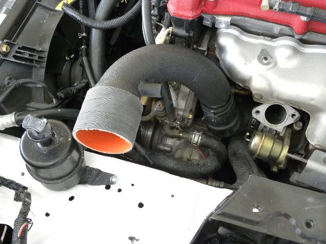

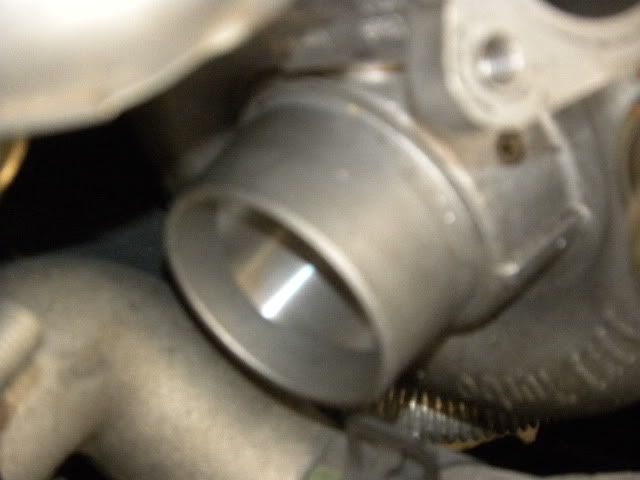

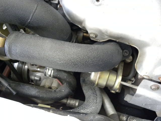

i started from the turbo outlet i then added the following. the original mazda rubber turbo elbow which is then mated to the begi crinkle finish tube.
here it is attached to the turbo outlet with spring clamps. to the right hand side you will see the outlet/inlet to the intercooler....thats next

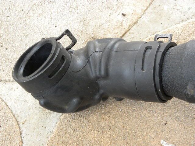

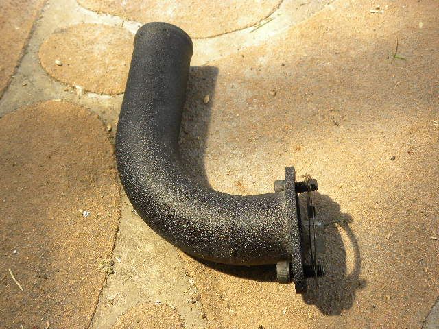

this elow attaches to the outlet
closer look at some type of gasket. be careful not to loose or damage this.

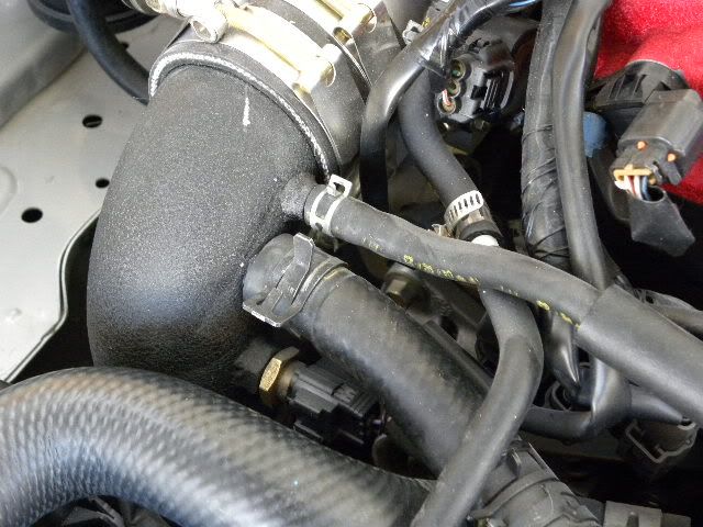

screwed in position via 2 torx screws
better look at what's been done

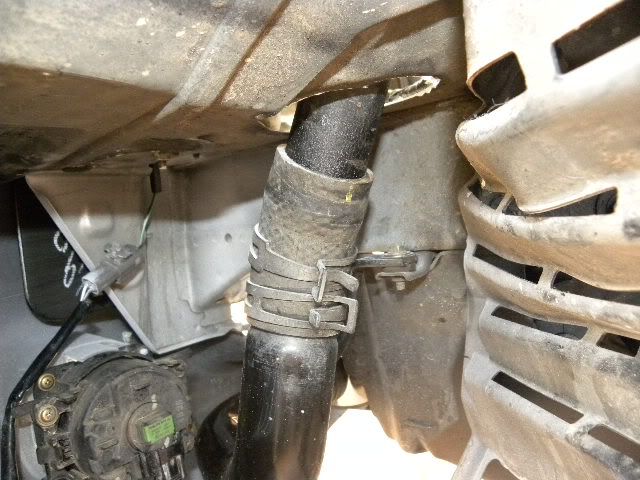

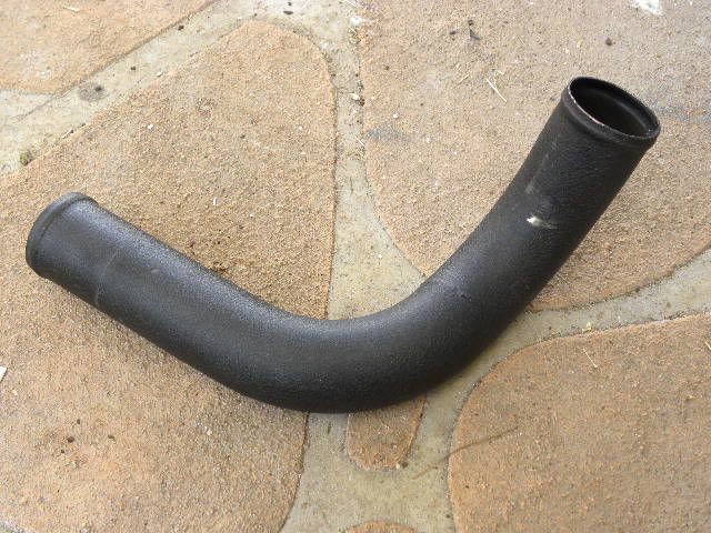

this is the begi steel elbow. it is positioned in the rubber joiner under the wheel well.

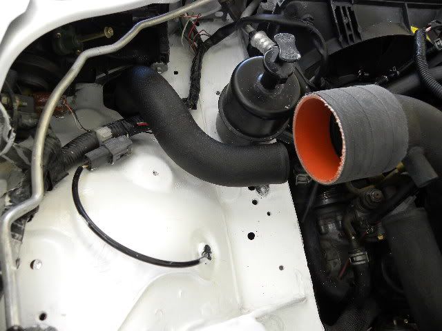

this photo shows it coming out from the wheel well
rubber joiner connecting both parts discribed earlier. this just shows the parth to the intercooler

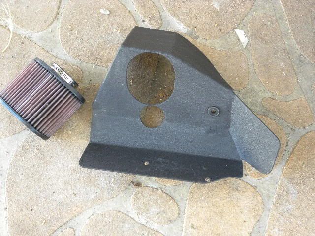

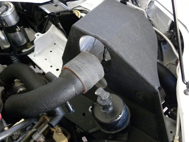

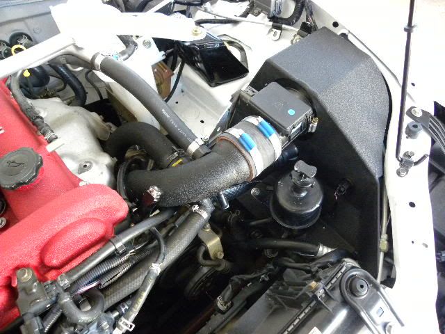

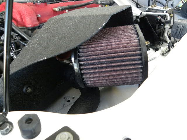

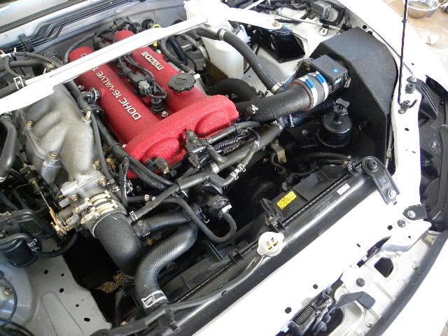

air filter and begi housing
housing partly in position

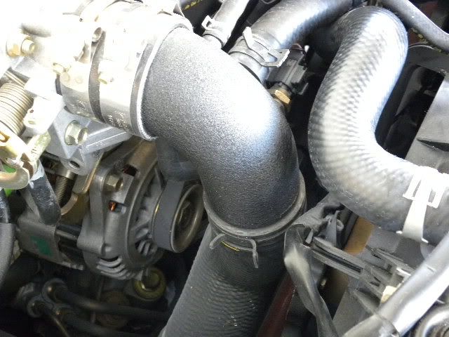

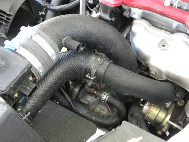

better look at intercooler pipes
sliding the air filter into position

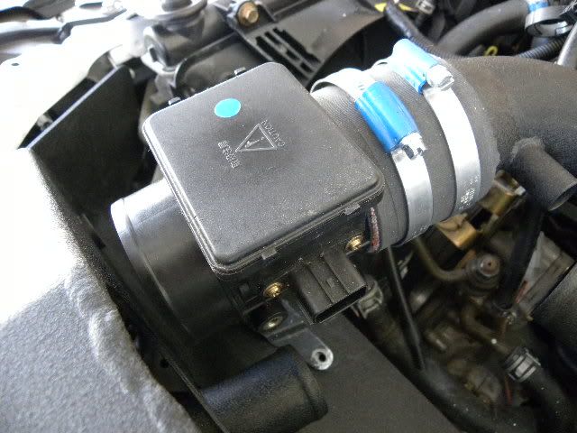

air flow meter attached
intercooler piping push through

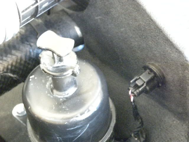

housing lined up to bolt down the power steering system
intercooler pipes clamped

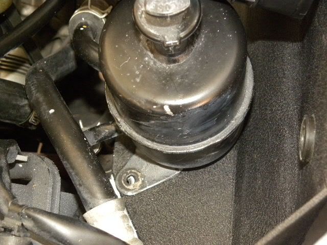

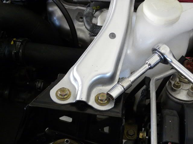

washerr bottle braxket in
washer bottle in
top bar bolted down, 4 screws - 2 per side

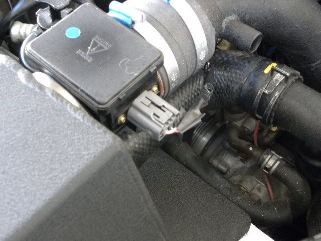

air flow meter connected

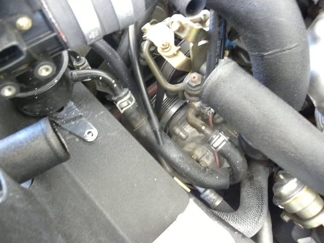

air temp sensor connected

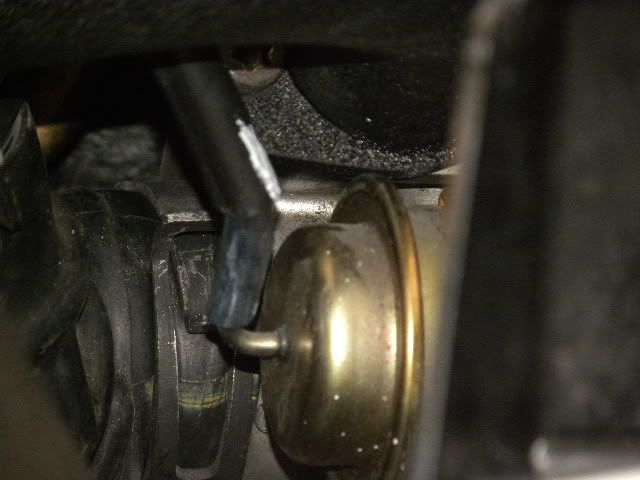

manual boost control connected
begi throttle body inlet. direct hook-up
final results
washer bottle in

okibi
i bought the very first kit to australia. after a few emails and photos to stephanie at begi she thought it would fit fine.
it's a tight fit alright at the front where the air-con pipes are. apart from that everything was fine and the fittings and build quality ..........perfect.
performance wise not as good as the aem. boys in blue wise. i think you'll get past them as a factory fitted item.
mines got a bit dine to it now but with this i think it looks almost standard

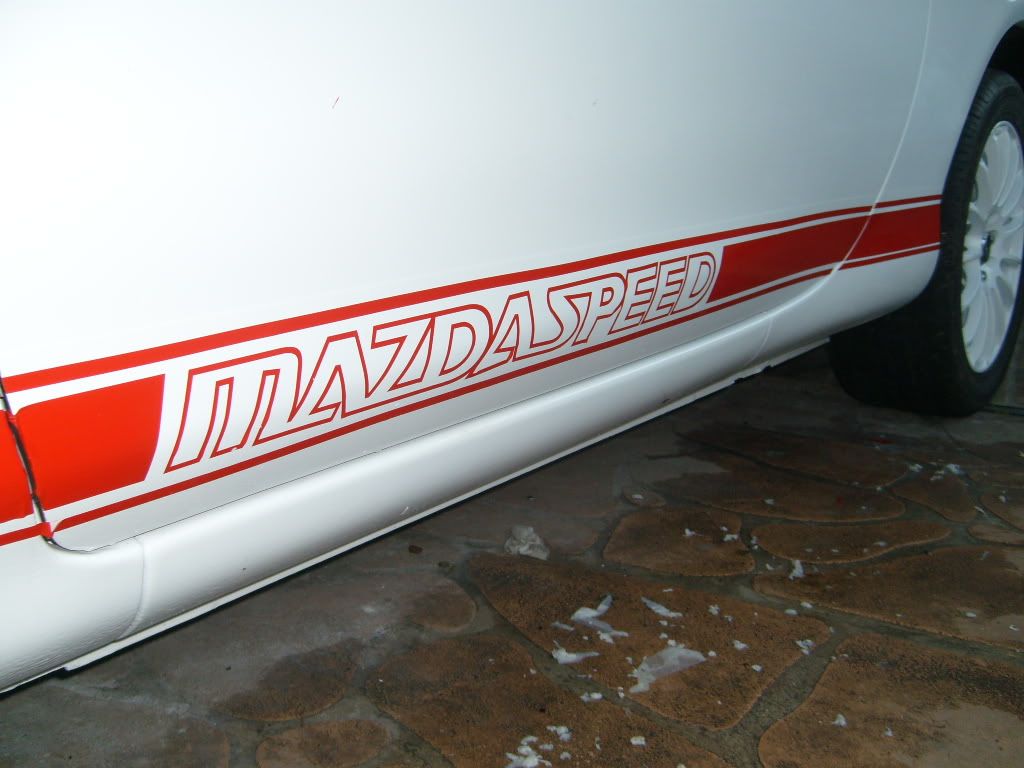

- Posts: 1531
- Location: orange nsw

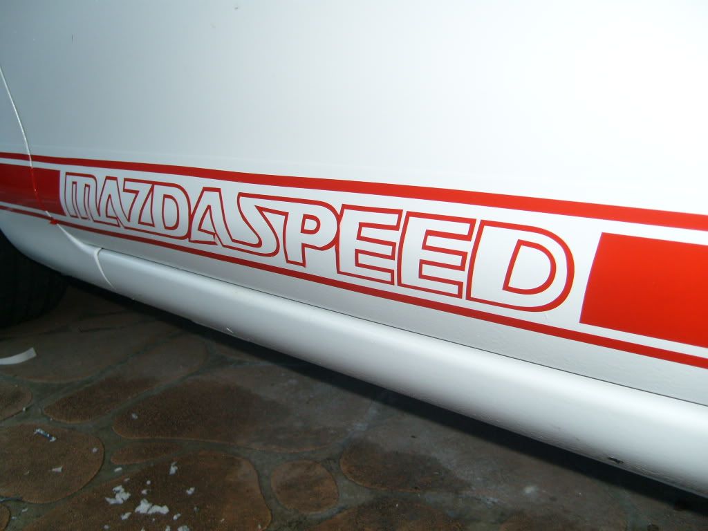

side ones / bought from the usa -special order

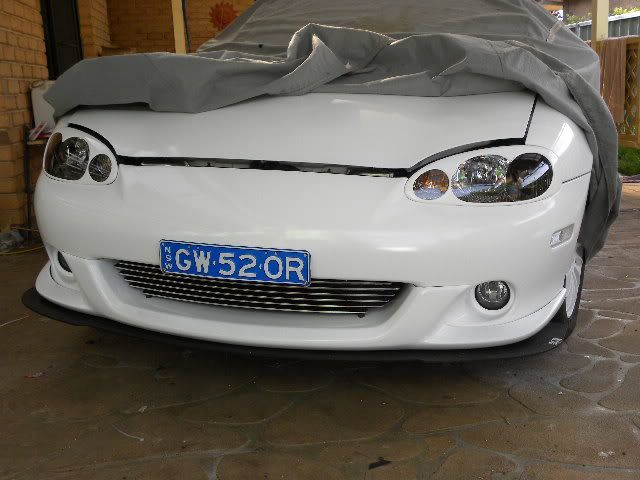

mx5 plus front plate holder arrived today - no more hole screwing

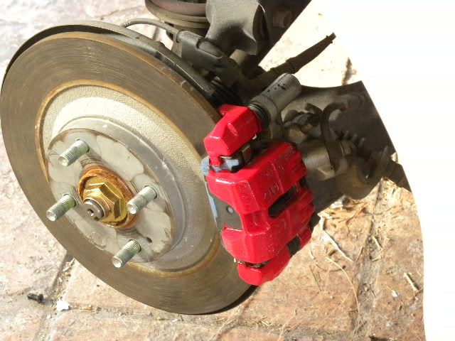

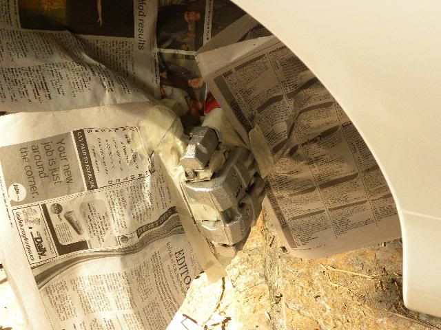

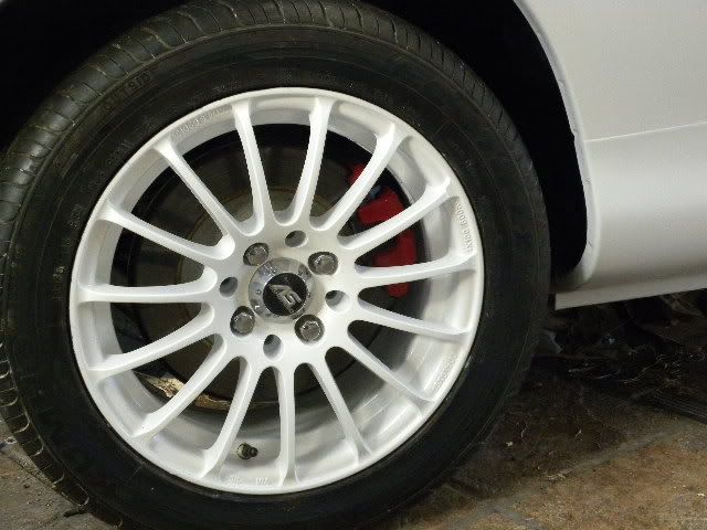

rear dis ready for painting
paint on
completed

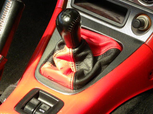

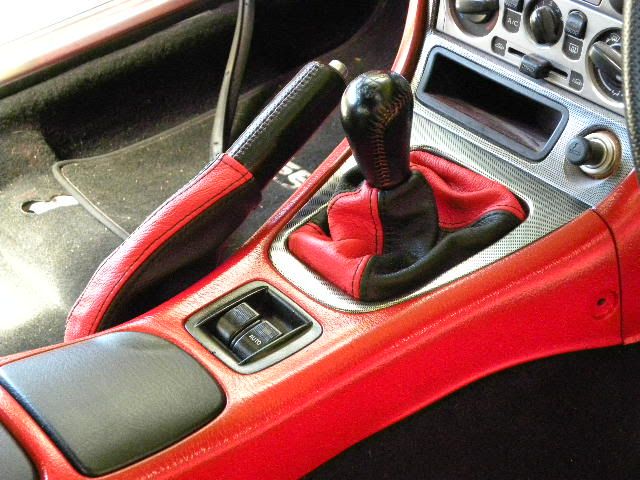

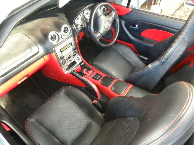

leather hand brake and gearbox boot
console in
seats in
console in
seats in

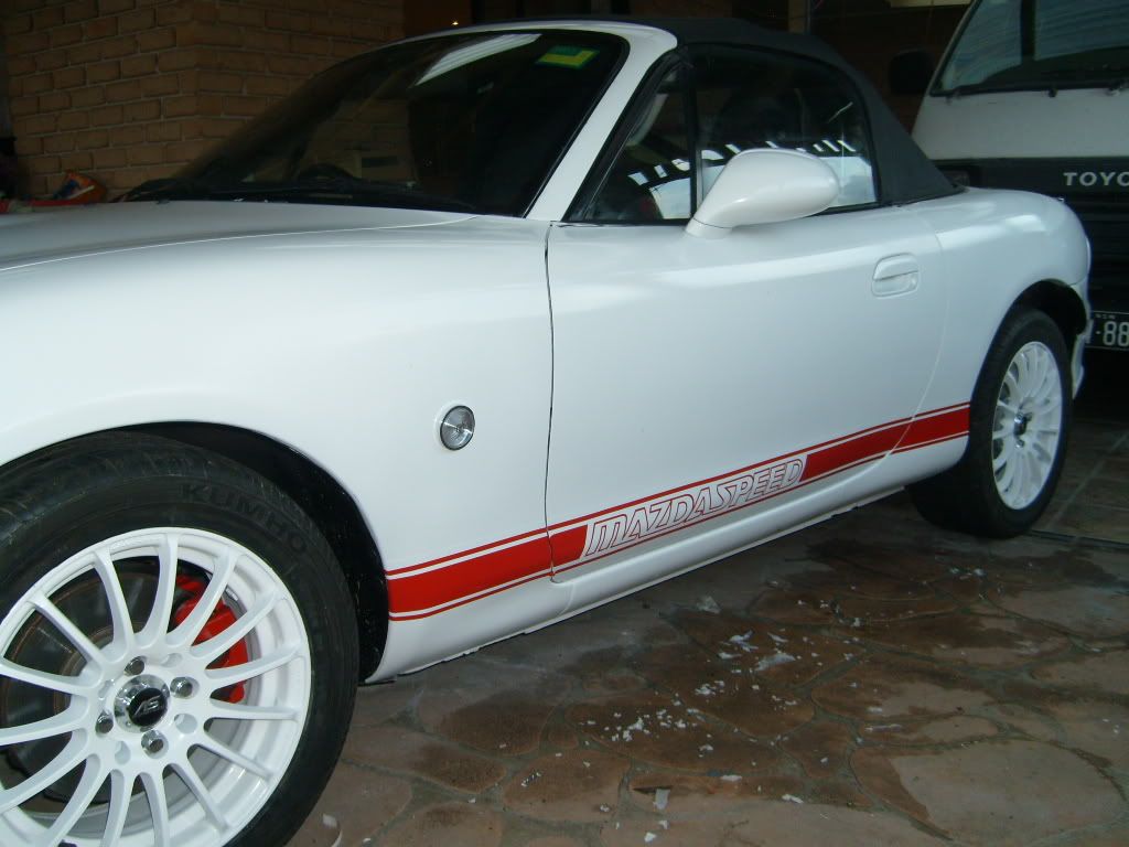

- Posts: 1531
side stripes.........one side on
