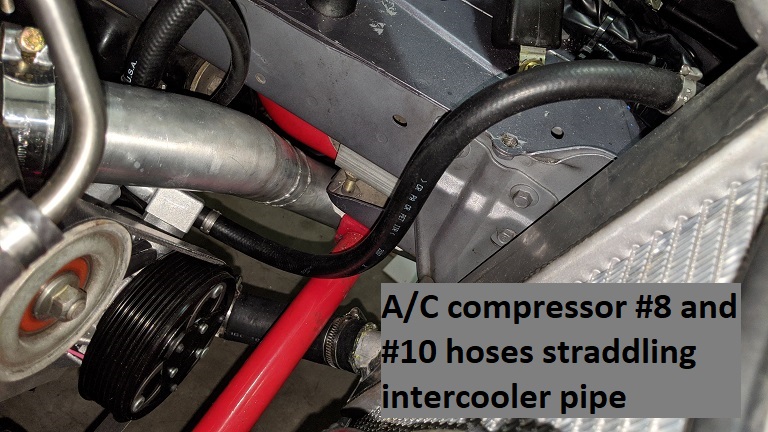

The A/C compressor's #10 suction hose from the evaporator normally routes to the rear firewall by going underneath and up to the rear firewall.
With my new downpipe in the way I needed to up from the compressor instead.
My hotside intercooler pipe gets in the way a bit so the new #10 barb had to exit at 90* and it had to exit to the rear and up because it would be too close to the A/C belt if routed forward.

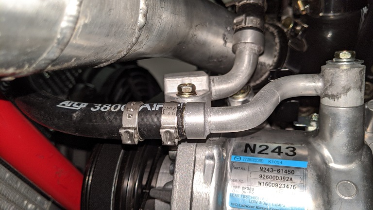

Kooler Car welded their barbs onto the #10 and #8 hardlines I provided and sold me all the matching clamps required for their barbs.
They also added a valve to the #10 hardline in the position I needed. I'd added a SpeedFlow heat sheath because I wouldn't be able to fit it later with the valve in place.
The existing #8 and #10 hoses I'd bought earlier were fine for the new barbs, as was the existing crimping tool I'd bought.
The Kooler Cars barbs differ from most I've seen, they have a bloated section with two recesses either side where the hose clamps crimp into - the owner claims that these are the only ones he's used that don't leak.
A blue plastic locator came with two crimps for every barb. The two crimps fitted into the plastic locator which was then slid over the hose and the barb inserted into the hose as far as the plastic locator would allow. At this point the crimps are located correctly for the barb and can be crimped into place. The plastic locator can be left in place at that point or cut off so I cut them off since they look out of place (the owner tols me that's what he always does too since he thought they looked daggy).
I was really happy with the #8 Discharge hose, a simple S-bend was used and it safely clears the anti-roll bar:
- the #8 hose doesn't flop about at all which surprised me given its length.

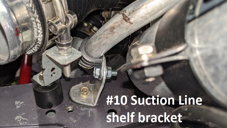

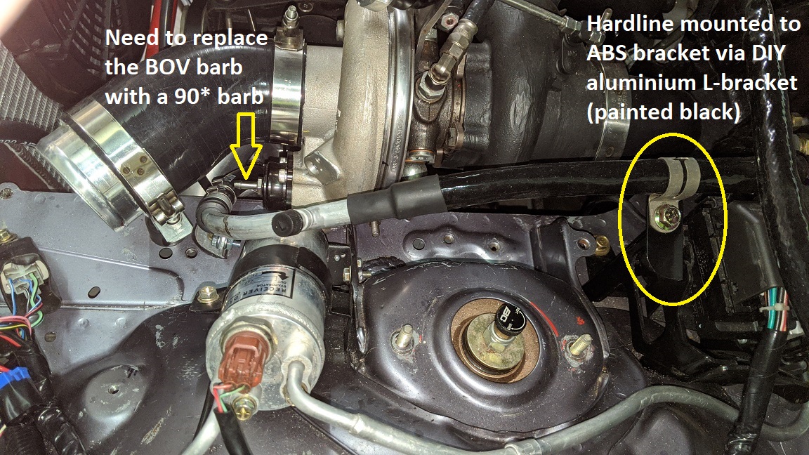

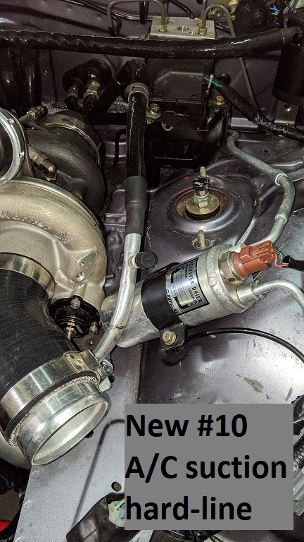

The #10 suction line from the evaporator to the A/C condenser was a bit more of a hassle.
I made 2 brackets for the hardline, one connected to the shelf and one to the ABS bracket to ensure that it wouldn't move.
Getting the shelf bracket's angle correct took several attempts because it "gets quite busy there" (see 2nd and 3rd photos below; the shelf bracket's vertical section angles about 30* towards the passenger side).
The DIY aluminium L-bracket on the ABS bracket stuck out like dogs balls so I reshaped it to look more elegant and painted it black to make it "disappear", which worked really well:
The #10 suction hose is quite short, ~ 200mm, so I really need to drive the car a lot without gassing up the A/C to ensure that it does provide enough flex.
I also need to order a 90* barb for the BOV because it currently exiits straight and is too close to the #10 hose for my liking.
FYI: The #10 hardline is very close to the Receiver/Drier but both are mounted to the chassis (or chassis brackets) so they won't move enough to make contact.

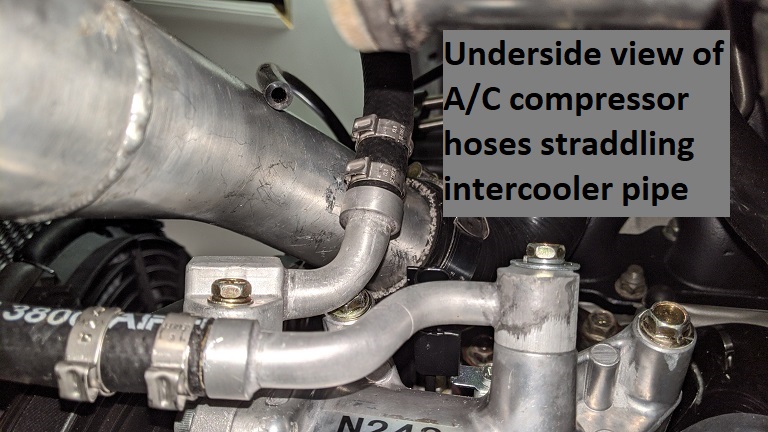

Underside view of A/C compressor barbs:

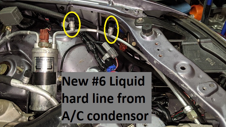

The new #6 liquid hard line from the condensor to the receiver/drier looks a bit better than my Frankenstein version :P
A few days after I dropped it off I thought that the valve may actually be too hard to access since it sat under the fender shelf and could actually be mounted outside my cold air box where it had plenty of access. I gave them a call and they told me it had already been made and they could simply add another barb one where I needed it to save me $$$ so I agreed (see circled barbs below; right one was the original barb):

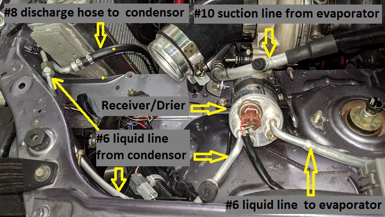

Here's a nice summary shot of all the A/C lines (A/C flow is anti-clockwise):

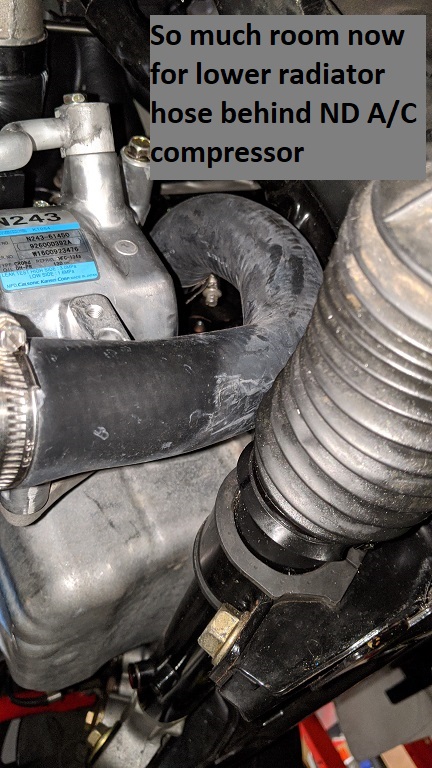

Every time I'm under the car these days I'm amazed at how simple the lower radiator hose routing is now and how much room is available (more so with the smaller ND compressor).
The reason for the OEM convoluted lower hose routing is that on LHD cars, the steering shaft is in the way so the hose needs to be routed around it - they SHOULD have had a separate RHD solution for the lower radiator hose:
I can probably shorten the hose a bit to provide even more clearance from the steering rack.

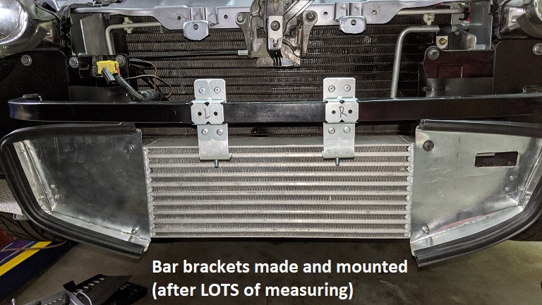

Postby Lokiel » Sun May 24, 2020 10:20 pm

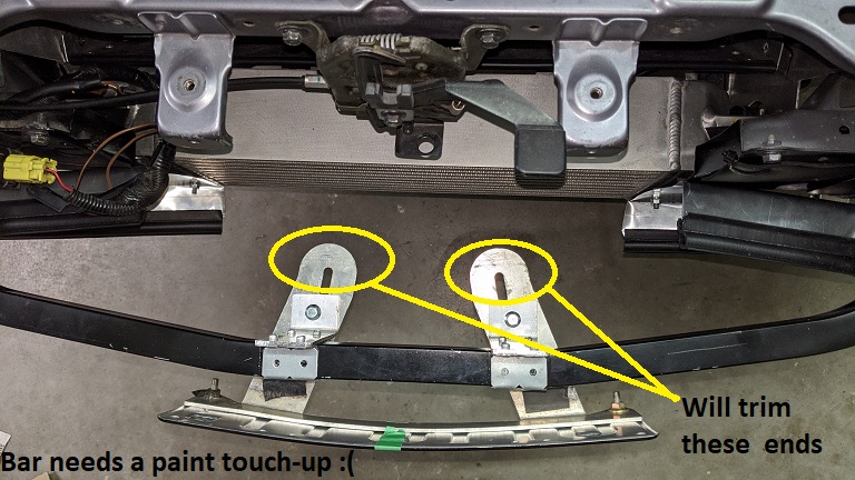

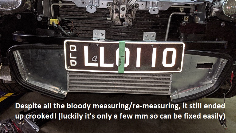

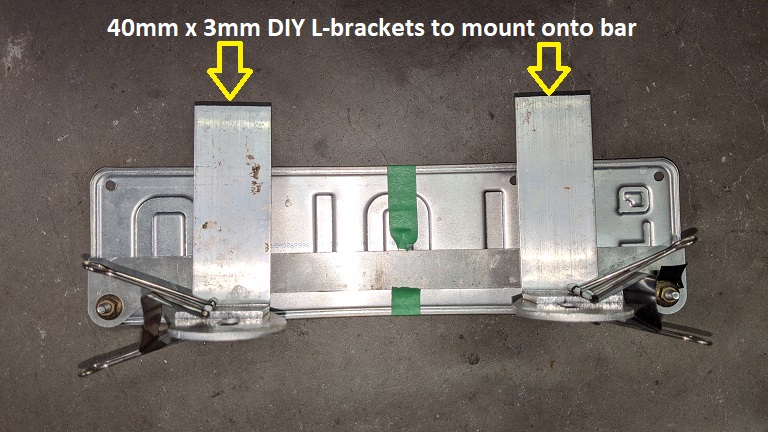

I really hate side-mounted number plates, to me they make the car look crooked so the only place to mount a centred number plate was to the new bar.
I didn't want to drill holes through the OEM bumper and noted that the rear of the new bar cleared the mounted OEM bumper so I could mount my existing aftermarket MX5-Plus number plate mount there somehow.

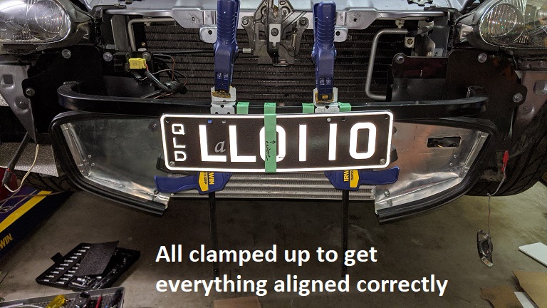

The green tape on the number plate was used as a reference point, the right edge (when viewed from the front) being the centre of the plate.
I made a couple of 40mm x 3mm aluminium L-brackets to mount to the existing number plate bracket and a couple of double-width galvanised brackets to wrap around the bar and mount the L-brackets to:
I wrapped the bar with a couple of layers of black tape where the galvanised brackets attach to to give them some grip on the bar. With the aluminium rear brackets pop-riveted to them, they don't move/slide at all.
I spent a LOT of time measuring everything up, installing/removing the front bumper multiple times, only to find that it's slightly crooked. Luckily it's only by a few mm so can be easily fixed (hopefully just by bending the original bracket a bit):
I'm currently giving the bar a couple of resprays (painting the front of the galvanised brackets in the process) and will trim off the un-needed end sections of the original bracket.

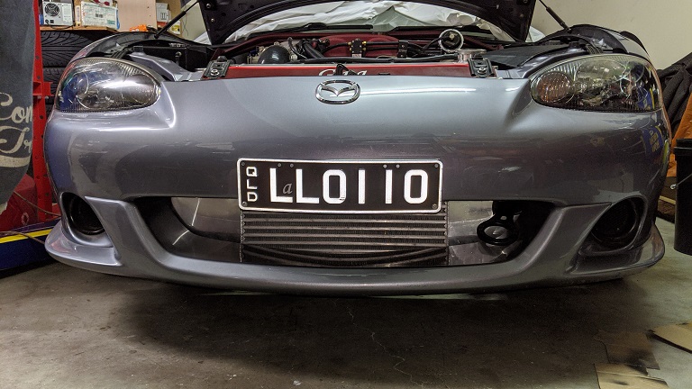

Postby Lokiel » Thu Jun 04, 2020 11:14 pm

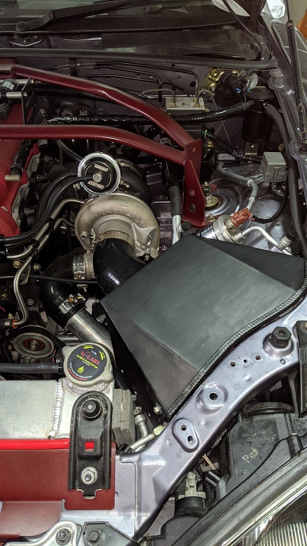

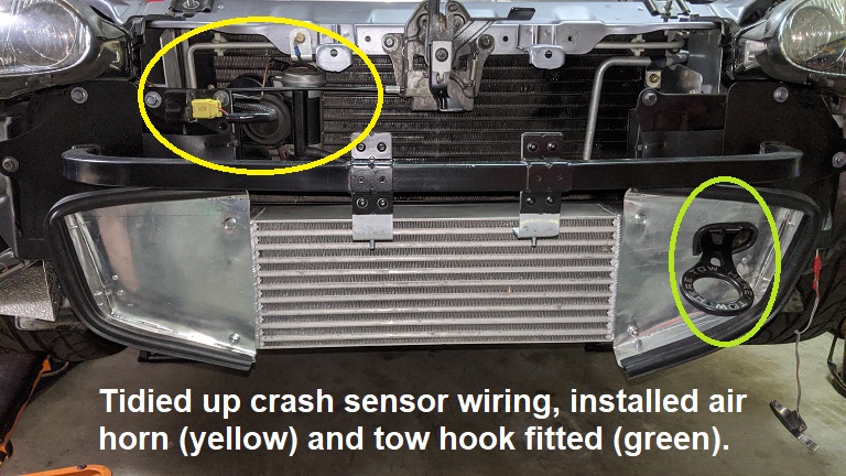

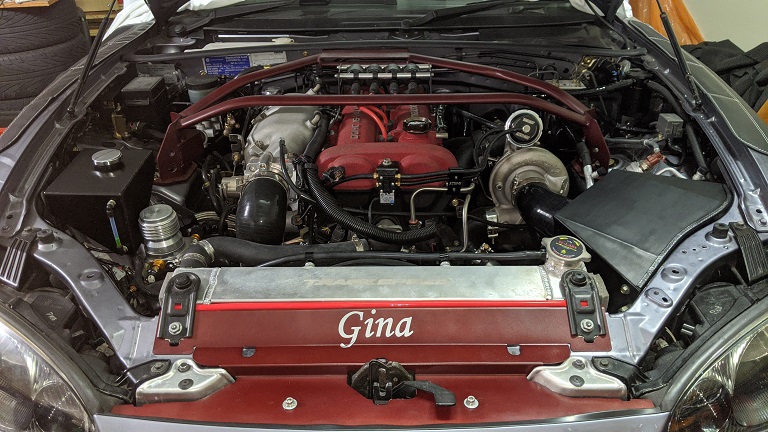

Tidied up the front crash sensor wiring, installed the air horn, tow hook, bumper and number plate:
... looks legit!
I stuffed a half-length Clarke Rubber foam roll under the intercooler to prevent any air escaping under it - not sure how long it'll last but it's cheap and I still have the other half to replace it when needed.
The enclosed cavity above and behind the intercooler is huge (you can stick your arm through the gap above the intercooler) so there'll be plenty of fresh air forced through the A/C condenser and radiator now.

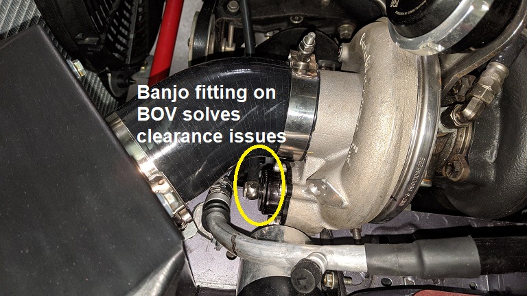

My TurboSmart BOV was using the straight barb and the hose was too close to the new A/C hose for my liking:
The TurboSmart BOV comes with 2 barbs, a straight one and a banjo fitting but I couldn't find the banjo fitting anywhere so ordered a couple of M10 90* 6mm swivel barbs from eBay (I ordered 2 since S&H was more expensive than the cost of a single barb and it's always nice to have a spare).
Unfortunately for me, the swivel barbs use a M10x1 thread but the TurboSmart BOV needs a M10x1.25 thread - I'd just assumed that it needed an M10x1 thread :(
Needless to say I was p****d off and went on a search and destroy mission for the damned TurboSmart banjo fitting.
Eventually I found it (in a small plastic zip-lock bag with the original crappy EFR6258 BOV) and installed it:
- much more clearance now and the hose was shortened too (always a good thing).
I installed the front strut brace to ensure that the #10 A/C hard line was OK (and try and figure out the shape for a heat shield):
It's good to see the engine bay all back together again:
- now I need to stop "dicking about" and tune/drive it!

Postby ManiacLachy » Fri Jun 05, 2020 9:41 am
Looking good! The work you put into that engine bay really shows.
To me the silver block off plates around the intercooler really draw the eye and look obvious. Maybe less noticeable when viewed from a normal standing height though. But maybe painting them black would "disappear" them?
Does the wastegate canister sit taller than the strut bar? It's hard to tell from the photos, but if not that might indicate there'll be no clearance issues with the GV hood.
Postby Lokiel » Fri Jun 05, 2020 3:38 pm
I laid a pine plank over the wastegate can and rested in on both fenders and it sits under it by about 2mm.
The top of the can is about 5mm below the top of the front strut brace.
I'm actually running out of space in the garage to make swapping hoods feasible :(
I'm not a fan of painting aluminium since it gets ratty very quickly - wrapping them in black vinyl is a good option though (with a flux-capacitor sticker on each side maybe?)

Postby ManiacLachy » Fri Jun 05, 2020 4:13 pm
Sounds like the can will just scrape under. Let's hope your engine mounts are tight enough to prevent the engine movement from pushing the can higher.
Give me a shout, I'll come and help you with the hood swap if you need extra hands. You might need to put Gina nose out into the driveway for extra maneuvering room.
Vinyl wrap would be a good idea for the blocking plates. You could even do it body colour then! Easy to remove if it doesn't look right. They're probably too big to anodize?

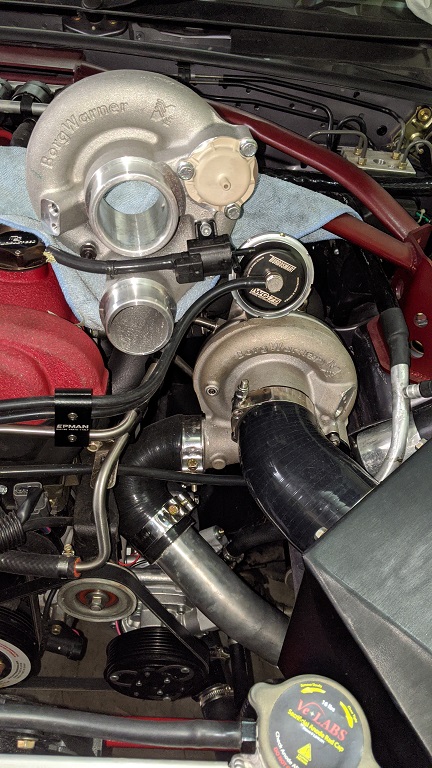

If you did this again, would you consider the 90 degree compressor cover/housing? I will have a lot less stuff to navigate around with my pipework, with no AC to consider.
Postby Lokiel » Fri Jun 05, 2020 7:14 pm
Like this?
I bought the 90* compressor cover a while ago to see if it would help but didn't use it because, at the time I still had the NB A/C compressor fitted and I think that the OEM #8 hose to the front of the car was in the way and I wanted to keep it to save costs.
Thanks for bringing this up because I can now see with the new ND compressor's barb fittings and hose routes that I CAN use the 90* compressor cover (I probably could have used it with the NB compressor too if I got the #8 hose barb modified).
The BOV will sit above the A/C receiver/drier cannister instead of below it, as it does now.
I should be able to shorten the intercooler downpipe and connect it via a 90* coupler to eliminate that horrible 135* coupler.
You can see in the photo that the interior casting of the compressor outlet barb is SHITE (is not this bad on my current housing).
It's smooth inside the snail and intake barb but not the outlet barb so I'll have to do some filing/polishing before installing it.
Would it allow the P/S to be retained?
Don't know! (leaning towards a "maybe")
The 90* outlet is definitely the way to go if you want to route the coldside intercooler plumbing underneath WITH A/C.
WITHOUT A/C, you should just be able to orient the outlet straight down (less bends are better for flow).

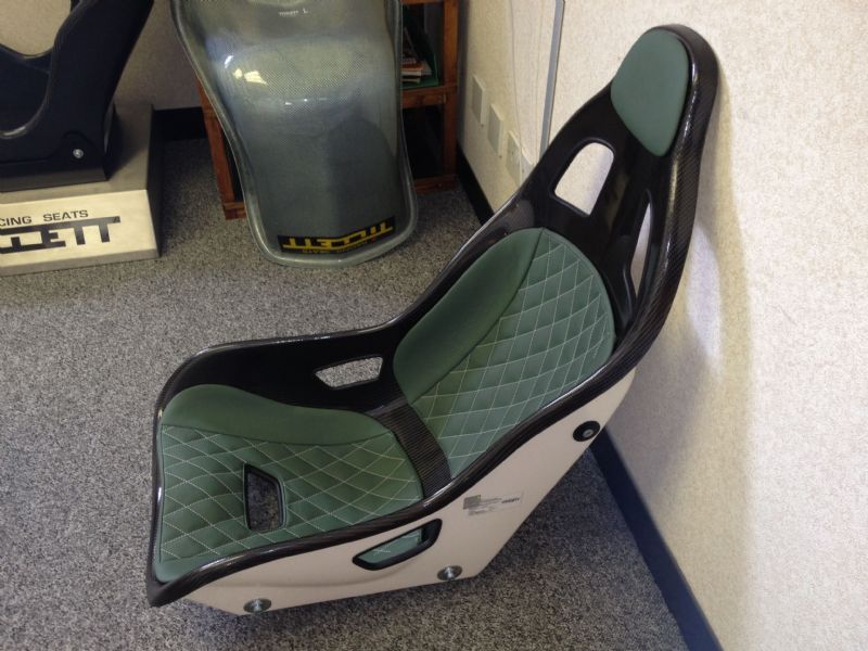

Lotus owners tend to upgrade to Tillett seats because they have better thigh support so that's what I figured I needed but the Tillett B5 was probably going to be too small.

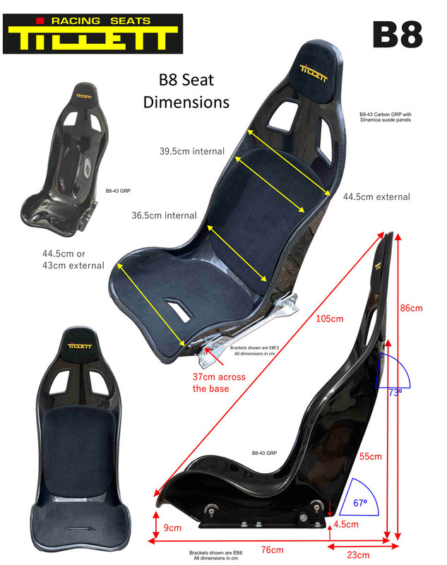

Tillett recently released the B8 seat which they describe as an XL version of the B5 seat.
I looked at the specs and figured that I would fit into these seats and took a risk by ordering two of them from Demon Tweeks in the UK to save on S&H (I hate the look of mis-matched seats).

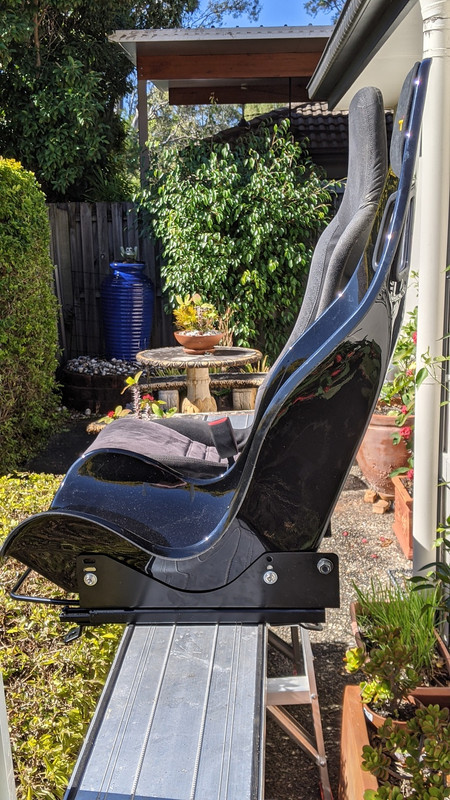

I'd previously bought Mazda NA/NB Bride Lowmax seat mounts from Nengun Performance in Japan because, based on what I'd read on the forums, they accomodate just about any side-mounted seat and they're specific to the car so the seats are guaranteed to be angled correctly.
The Bride Lowmax mount has a slider and the side brackets that bolt to it provide 3x front and 3x mount points to angle the seat.
The side mounts also have a mount point for the OEM seatbelt.
Tillett's site doesn't give any advice on brackets for an MX5 so I wasn't going to risk paying for any that may not work and they're bloody expensive.
Getting a mod-plate for these seats+brackets should be trivial.

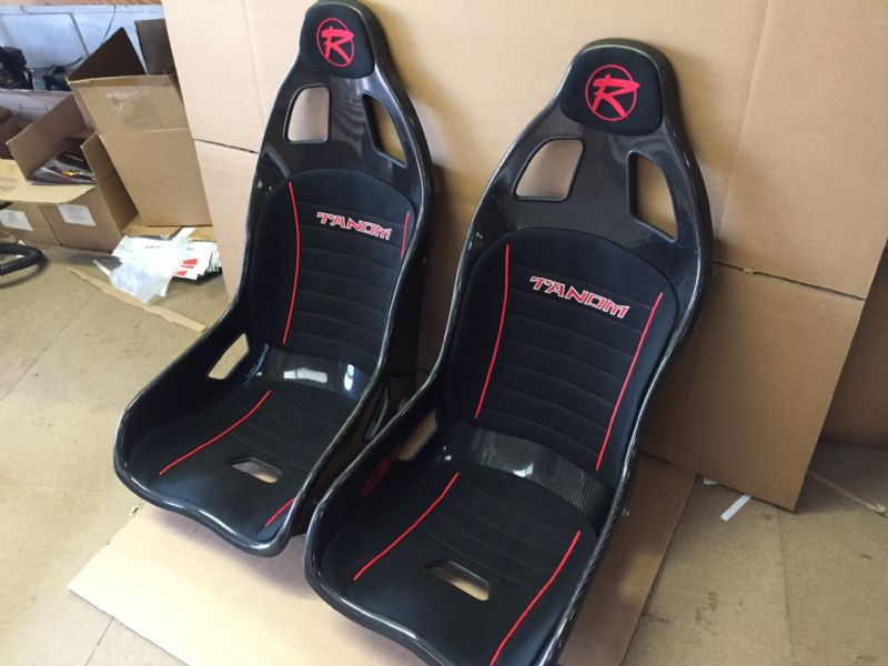

I don't like the look of carbon fibre so I ordered the slightly cheaper FRP seats which have a slick black finish.

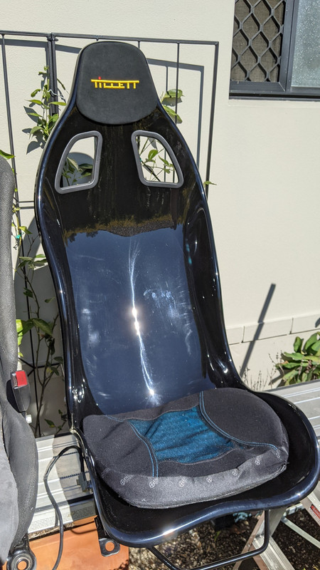

The seats come with a thin headpad embroided with the Tillett logo.
You can also purchase a seat and backpad (see bottom left of picture above) but for ~A$300 per set I figured I can something made locally for that price.
The seats themselves are very comfortable but even Tillet recommend some padding for DD.

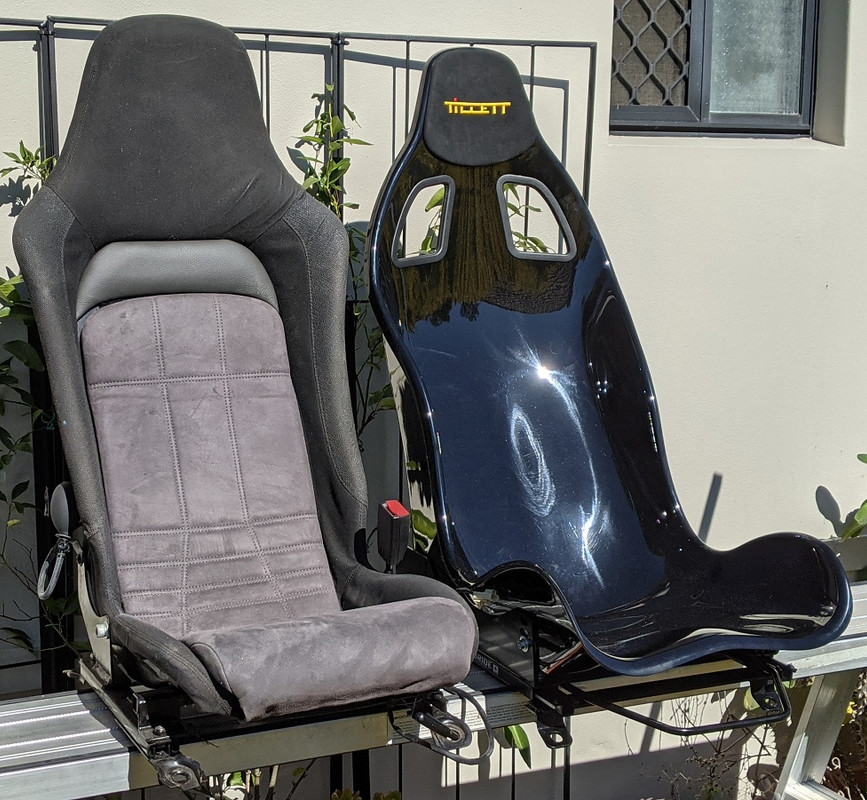

Comparison vs Lotus seats:

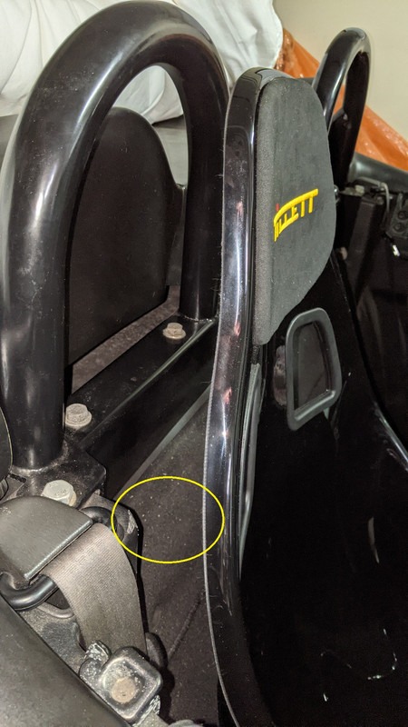

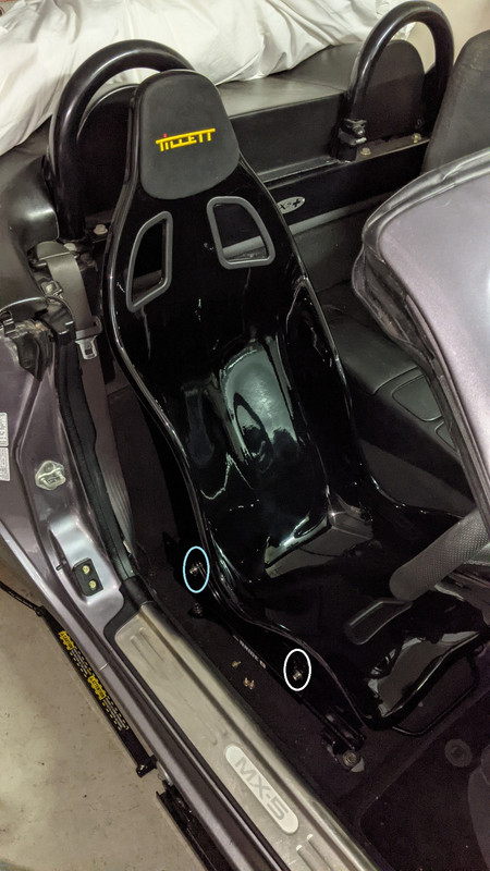

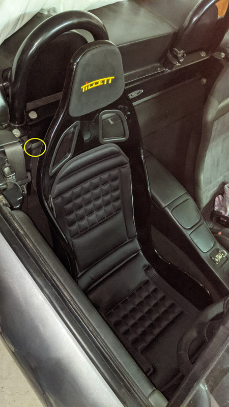

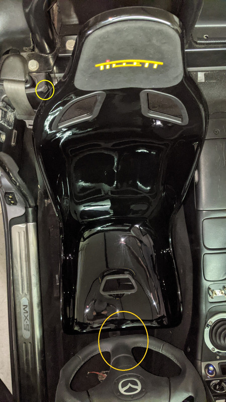

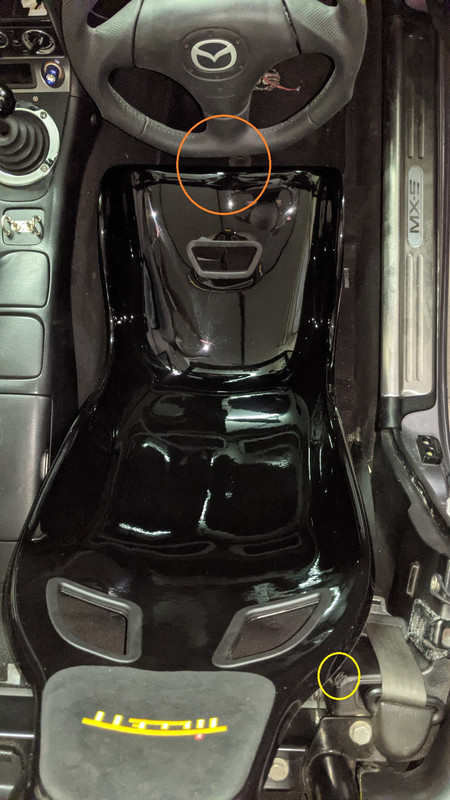

Mounted photos (using the middle of 3x rear side mounts and lowest of the 3x front mounnts - originally used lowest on front and rear but that reclined me too much).
The yellow circles in the photos below show how close the seat gets to the seatbelt mount rail (mine is worn from previos seats).
At its furthest-rear position, the seat sits ~ 10mm in front of it.
The orange circle shows that the seat is centred on the steering wheel (which wasn't quite straight when I took the photos).Image
There's quite a lot of space on the right of the seat and the left side does not touch the transmission tunnel anywhere, even the fromt has ~10mm of clearance.
The OEM seatbelt mounts to the Bride Lowmax side-mount.
There's plenty of thigh support and they hold you well so they'll make a decent track seat but being deep with high thigh support makes getting in and out of them harder so just as well it's NOT a DD!

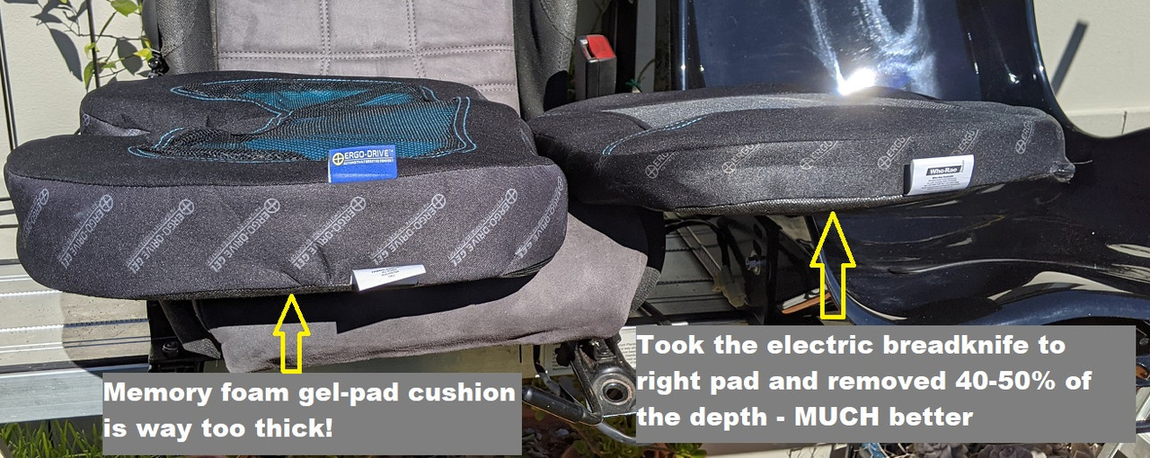

During the week I bought a couple of gel+memory foam seat cushions, lumbar support and a couple of seat pads from Autobarn.
The memory foam lumbar support was too thick.
The gel+memory foam seat cushions were too thick so I cut one down to ~50% depth with an electric bread knife and it's MUCH better, I could drive long distances with this comfortably.
Tillet is correct in stating that you don't need much padding to make these seats more comfortable for DD.
The best one was the one I originally thought wasn't deep enough. It was too wide so I cut the edges off and it's quite comfortable:
I plan to get some custom+local padding, preferably similar to the following but in titanium grey of course with possibly a "Gina" custom emroided headrest:
