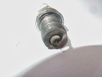

Coming home last night the car was acting strange, not much acceleration and backfiring however after about 10 mins all was good. Stopped for a coffee and the car again had not much acceleration and backfiring however drive was less than 10 mins home.
Pulled the spark plugs out
CYL 1
CYL 2 (not removed due to brace)
CYL 3
CYL 4
Pulling out the COPs and this happened (coolant)
And this (plug black and fouled)
Looks like coolant is in cyl 4 and when the engine gets hot enough it stops effecting the engine. No obvious coolant use and the oil looks fine.

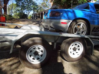

Loading the car on a trailer without power is a fun job
Lucky my other half likes turning a winch by hand ....
In case people have not seen this type of trailer, it is a tilt trailer with the ramps stored underneath.
Once the trailer starts to tilt back down the car will just roll forward. I used a wheel chock to may sure it did not roll back too far. I also had a block of wood (in the photo) to use as it was being winched on in case it tilted too early. The trailer is heavy but it is solid and tows very well. If I add the 2nd trailer brake and a breakaway the trailer will gross out at 3,000 kg.

Not good news. Do you know why the plugs have fouled so early? Coolant in the cylinders doesnt sound good hopefully no damage has been done. Bit strange.

That is a great trailer setup, how much would yours weigh with no car? I know how much fun it is trying to load a car (even a tractor) onto a trailer with no power haha atleast I was steering when loading mine on lol. Did you have the winch then?
speed freak wrote:Did you have the winch then?
Yes there is one now, and would you care to guess the reason why I put one on there

speed freak wrote:Not good news. Do you know why the plugs have fouled so early? Coolant in the cylinders doesnt sound good hopefully no damage has been done. Bit strange.
I'll know tomorrow as I will be dropping it off at Plus tomorrow. It has only been in the last few days and it has hardly been dríven (MX5 Plus to the Exhibition, then home).

GOOD NEWS! The coolant coloured water was trapped inside the coil plug when the engine bay was detailed. The engine would heat the water up and because it had nowhere to go when it cooled it would condense again.
Lesson is detail the engine bay yourself next time. So it looks like I'll be at lakeside and time attack round 1. Lakeside is going to be a test day and get the tyre pressures sorted out for time attack session. However plan is to do a run close to the pit wall to let the sound of the ITB's at 8,000 rpm be heard.

Any time I wash the engine bay I will pull out the plug leads and blast any water out with a air hose.

Do you know why the water was coolant coloured??? It had to come from somewhere.

MattR I assume that it was the coloured of the stuff used by the person who detailed the engine bay. The water on the plug would have been caused by me pulling the plug out. Jason gave it a good going over and is confident that was the cause. The no 4 plug is fouled as it has been there (along with the other 3) since tuning so it is not indicative. New plugs have been installed.
