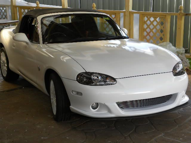

Postby billybunter » Thu Oct 20, 2011 6:15 pm

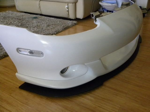

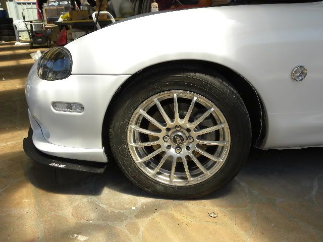

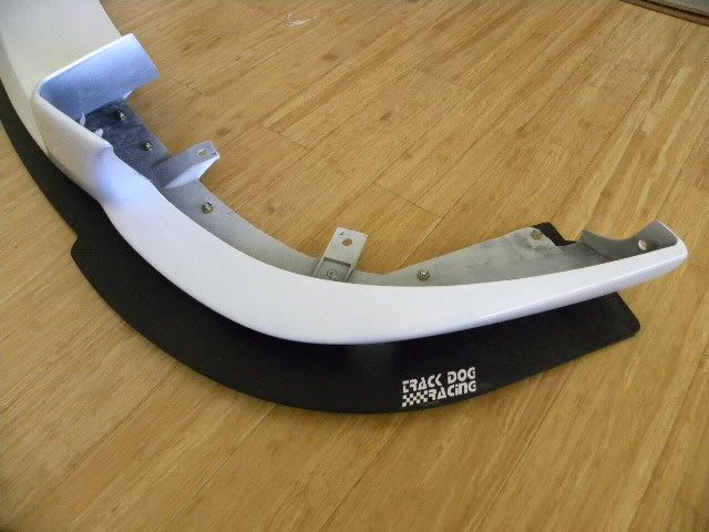

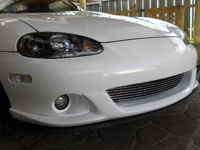

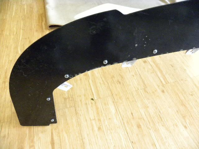

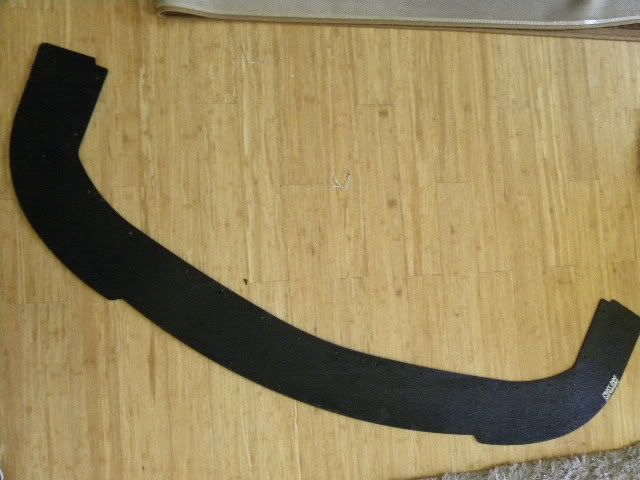

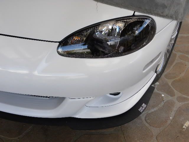

track dog splitter
held om by 15 screws
attached to bottom of front bar

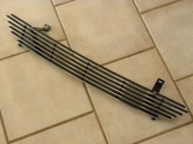

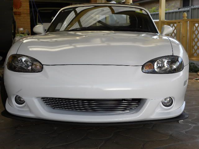

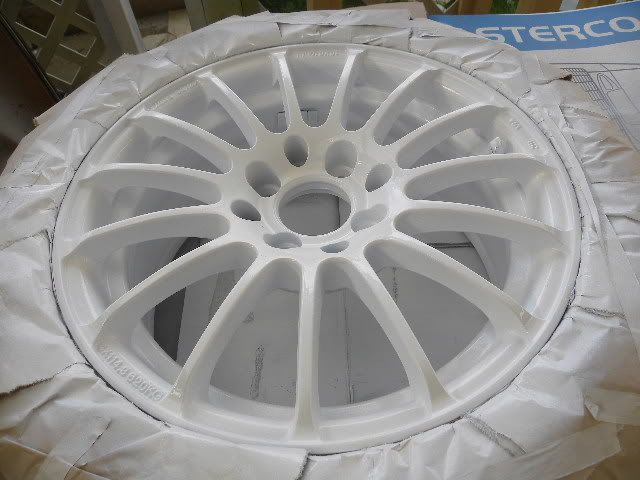

billet grille
wheel masked-cleaned and primed
top and clear coated

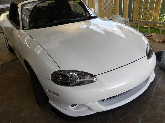

front bar on
photo of the billet grille
side shot with the white wheels :D
initial D

Postby initial D » Thu Oct 20, 2011 6:21 pm
jizzed everywhere on my keyboard
taminga16
Posts: 3634
Location: Central Victoria
Postby taminga16 » Thu Oct 20, 2011 6:57 pm
Looks the goods BB, thanks for taking us all on the trip.
P.S. At the risk of sounding like an A******E is the grille a bit limp to the left? Kick me now. :)
Postby billybunter » Thu Oct 20, 2011 7:03 pm
taminga16
you were right -the grille was off alignment. a quick tune and it's now back on track :beer:

Postby Bizi » Thu Oct 20, 2011 7:15 pm
Looking like it's white on twack, BB.
The headlights/grille make for a different look to other NB8Bs.
What's the story with the headlights? Is it a CF-style paint job in the headlights?
Postby billybunter » Thu Oct 20, 2011 7:20 pm
no - there the original se's headlights - this is standard with the turbo model

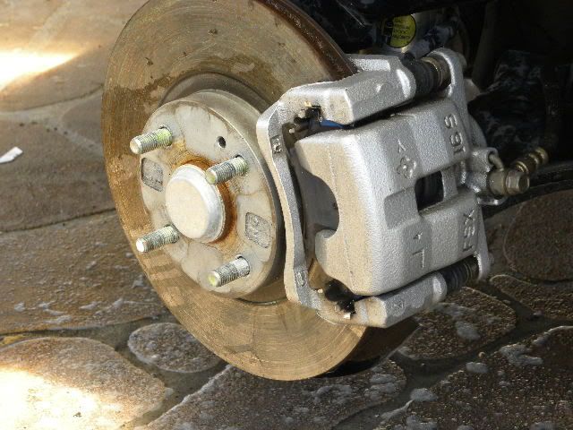

todays work area - front left corner

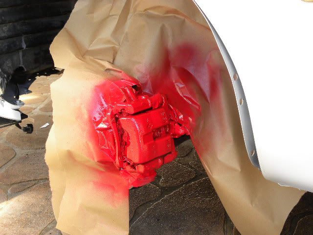

all disc calipers require a tidy up. left front first.
can of 3m caliper paint. clean whole area with grease/wax remover then mask up
then apply 3 to 5 coats

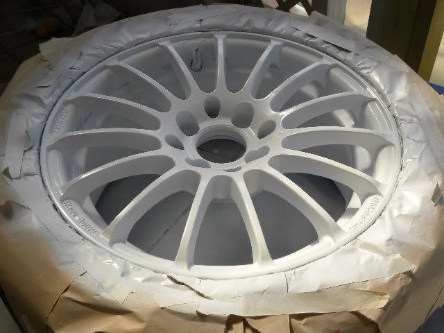

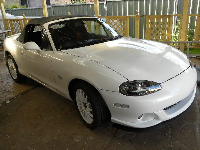

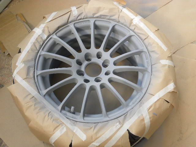

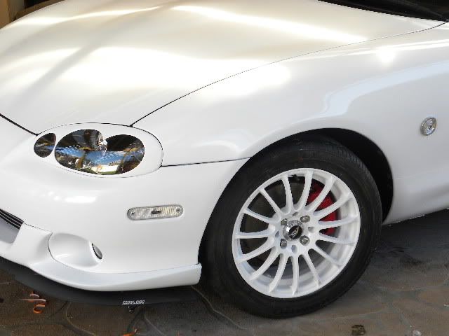

multi-spoke wheel re-painted. first off thorough wipe over with grease/wax remover. .......and i do mean thorough if you want the paint to stay on. followed on a hit with 320 wet dry sandpaper - then clean the whole area again and mask off. prime the surface/both sides. allow a couple of hours to dry then apply top and clear coats
allow a couple of hours to dry and its back on the car
side view

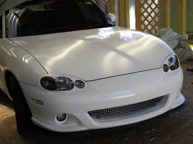

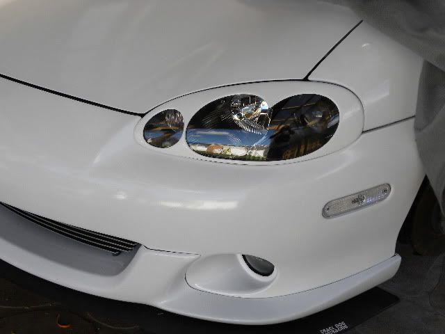

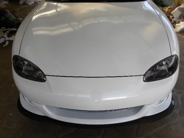

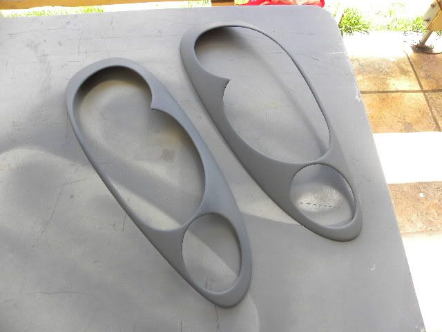

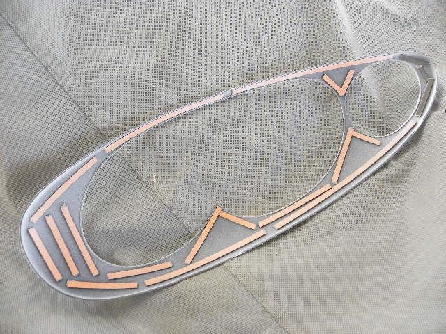

headlight covers.
rub the surface with 320 wet/dry paper. wipe with grease/wax remover then apply the plastic primer
give it an hour to dry then apply top coats
couple of hours later ready to fit to the car. note all the double sided tape contact point. not much room for error here.
on the car
Postby Lokiel » Fri Oct 21, 2011 5:19 pm
Did you try those headlight covers in black? IMHO, there's too much white and I'd prefer to get rid of the altogether - just my $0.02 worth and food for thought.

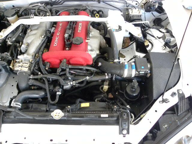

a few months ago i bought the very first begi cai. i've had it on the car a couple of times. the aem shown performs much better but looks cheap.
the begi is definately a factory look type system and more expensive to buy. remember i have nothing against the aem - as i have both systems and neither are for sale.
reason for the swap. rego due shortly and the aem won't pass this guy. i'll see what happens with this factory look-alike and see how it goes on the day.
if not it's back to the standard system for me.

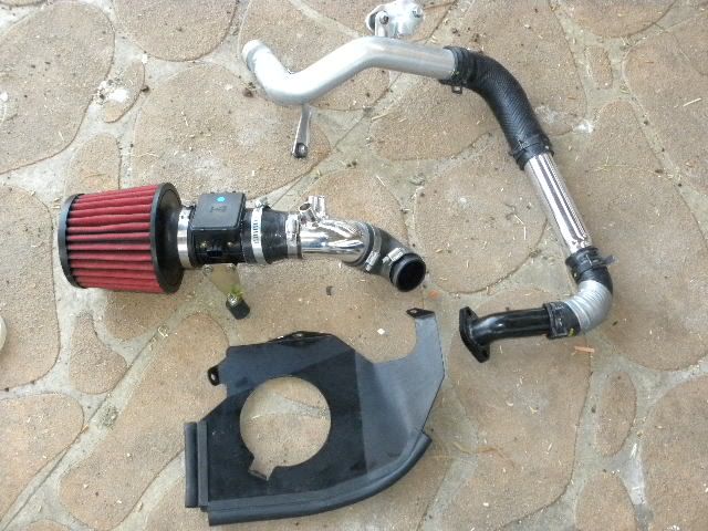

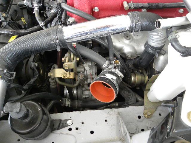

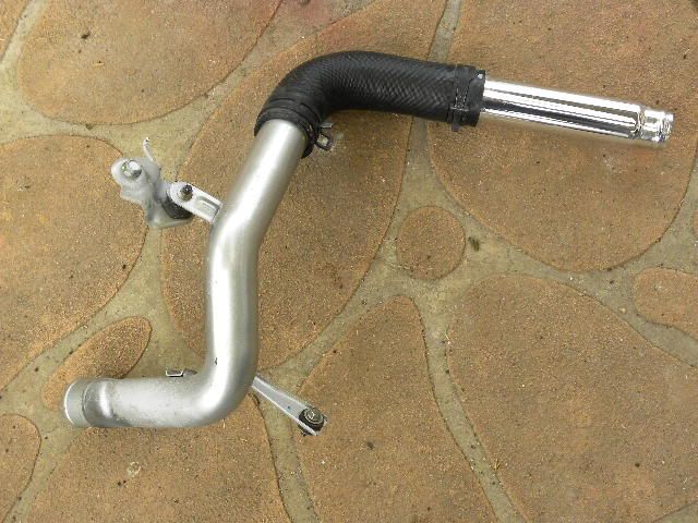

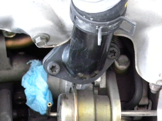

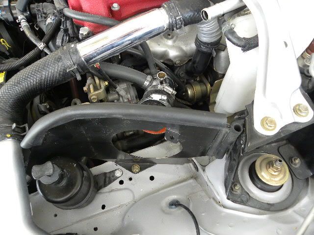

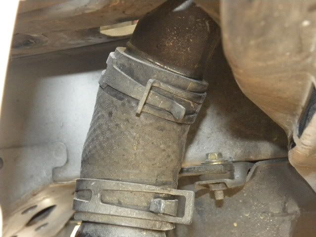

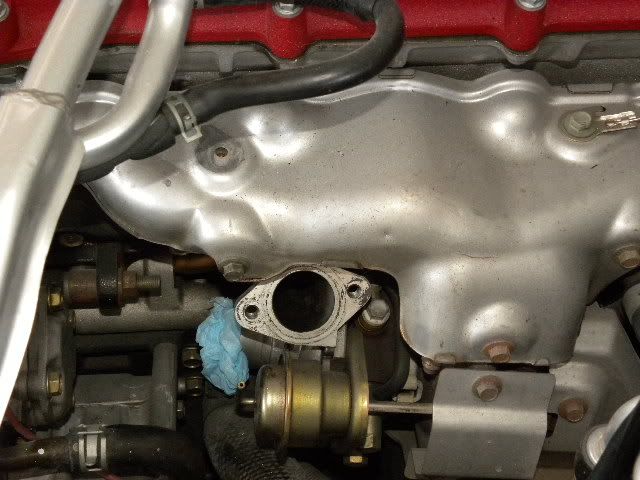

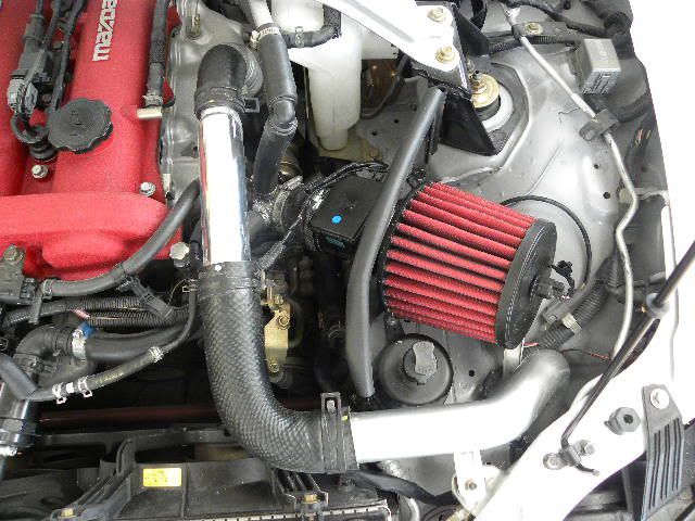

the pulldown
part 1,
the aem set-up

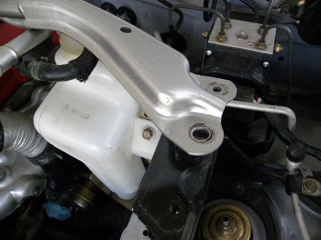

airfilter off then remove the steel guard
like so
undo these bolts -2 per side

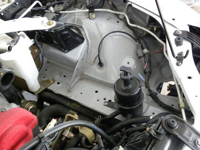

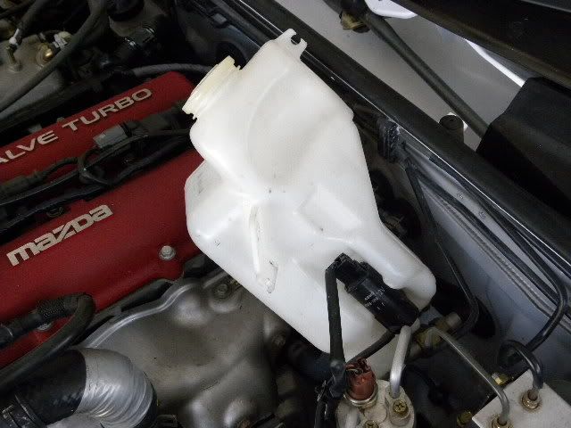

remove the water bottle
should be down to this

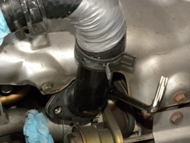

remove all tubes and loosen the clamp which attaches to the turbo housing and then pull the lot out
like so
this pipes next

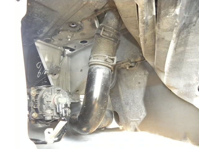

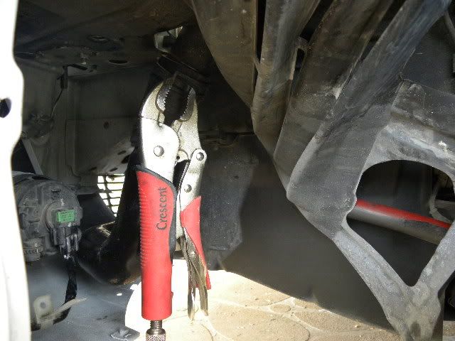

once you un-clamp the top section of pipes remove the left hand wheel from the car. remove the plastic liner and this is what your after
closer look -top clamp only
multi grips work best, clamp on and from the top -give it a good pull :lol:
once out you have this
last part of the job. torx screwdriver required her
photo of the lot
time taken ..........3 days :o about 40 minutes
