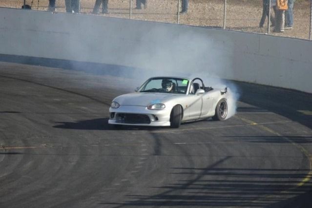

I have had a couple of spins due to running out of lock.
Modified front knuckles has changed the sport of drifting.
Where a lesser driver would usually spin out they can simply wind on more lock and fix the mistakes after the apex of the corner what their lack of skill and technique caused before the apex.
To be competitive in drift battles you need to show very aggressive angle pre corner.
Problem-
Due to the double wishbone suspension on the mx5 the inside edge of my 15x8 0- offset front wheels fouls on the lower control arms.
Solution-
Use a narrower wheel with a lower offset. Move the inner edge of the wheel out ! Requires new wheels
I bought a pair of second hand Work Equip 03
The size is 14x7.5 offset is -19mm
These give me 13 mm more clearance on the inside edge.
Problem-
Solution-
