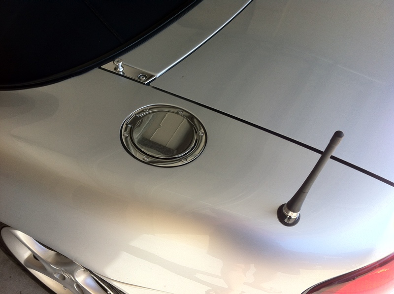

Postby tescoking » Fri Nov 01, 2013 6:22 pm
Waiting for two weeks, finally the chrome fuel door is here :P

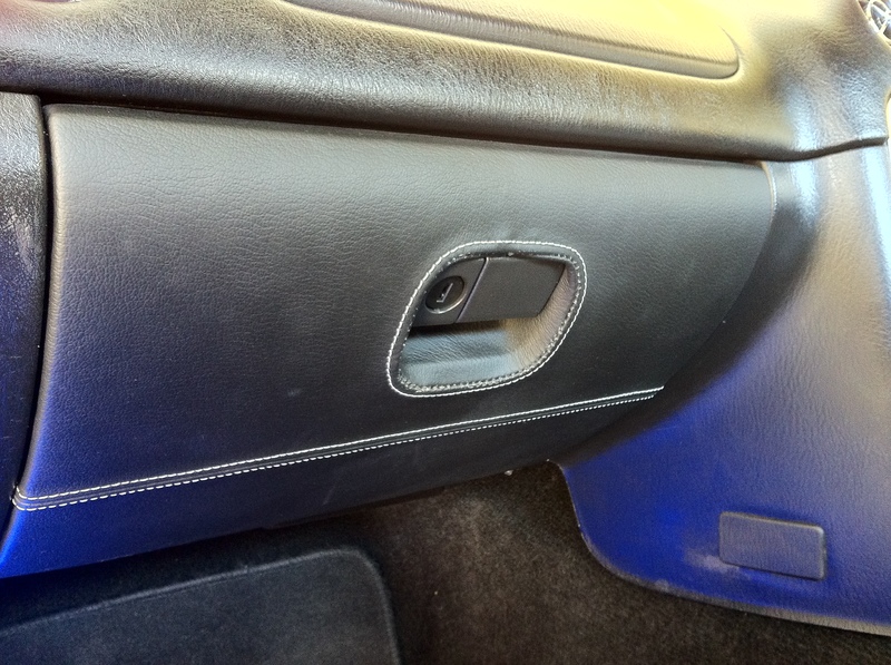

Postby tescoking » Fri Nov 01, 2013 6:35 pm
My custom leather seats and glove box :)
I am pretty sure I am the first one and could be the only one having this design on my car in Perth maybe even Australia, because the leather seats design was approved by me with the trimmer and the "MX-5" silver logo was found by me on internet and I asked the trimmer to stitich it on the seats. There are also a NA with this design (different seats with different style) and this logo after me, but it was made with different colour. Hopefully I would meet the owner someday.

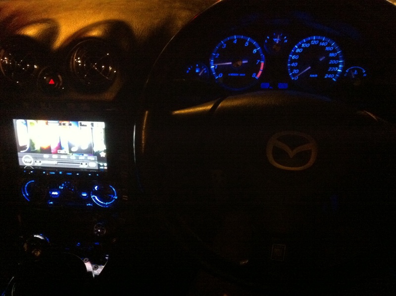

Postby tescoking » Sat Nov 02, 2013 12:25 am
Thanks guy, here is more picture of my interior lighting.
Lets say good bye to all the OEM red bulbs and boring speakers grill ^^

Postby AntHarmer » Fri Nov 08, 2013 3:55 pm
How did you change the colour of your HVAC bulbs? Was it a big job?

Postby tescoking » Fri Nov 08, 2013 4:15 pm
fastfreddygassit wrote:Outstanding! :NETPOINTZ:
The blue light theme actually looks really good on your car.
And your interior....wow, just wow! The retrim looks fantastic!
The seats, the glovebox and the centre console look so good.
Are you going to retrim the interment binnacle?
Great work :mrgreen:
I guess I will, but still thinking what kind of material should I use, because of the leather will dry and crack under the sun. So maybe not going to use leather.
My 5
tescoking
Posts: 824
Location: Perth, WA
Re: Tesco's NB8B
Postby tescoking » Fri Nov 08, 2013 4:27 pm
AntHarmer wrote:How did you change the colour of your HVAC bulbs? Was it a big job?
Not a really big job, but I spent a couple days on how to remove the face of the HVAC due to there are no info about it.
First you will need to go I.L. sport and purchase the gauge, which is the black background with white picture with the icons on it. You will have to buy them from Germany, if you don't change those gauge, the light is not going to change even you put another colour.
Second, when you got your gauge, then you can use a small flat driver (wrap something on it to block the point) otherwise it will scratch the plastic. Then start from the top which is between the head unit and the HVAC. Place the flat driver in and move all the way around the frame, you will need to use a bit of strength but be be careful. Once you open a gap and you will see there are some small little hooks, adjust the frame and it will pops out. But be careful that when you pull out the frame, there are switch that connect the A/C, don't pull too hard, otherwise it will disconnect and fall inside, by then you will need to remove lots of things to bring it back.
Third, get some T5 LED on ebay and place them in. and put back everything.
I know my English is not so good, so if you don't understand I can send you some pictures or video for demonstration.

Postby AntHarmer » Fri Nov 08, 2013 5:51 pm
Understand perfectly. Your English is good. Thanks for that, will attempt this once IL Mototsports gets the blue coloured faces back in stock
