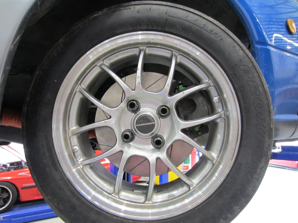

Butterfly brace installed, pads/rotors changed, brake ducts insatlled, thermostat installed, radiator fan switch/plug replaced, passenger side harness bolts installed, drivers side crotch harness bolts installed and the soft top removed. All that was recoverable from the soft top was the frame as the soft top itself was falling apart. Work done as per normal by MX5 Plus.

Front disc/pad (ducting in the background), not posting a photo of the rear because they look the same.

Well another donation made for the following:
*Changed front and rear rotors and front brake pads. Fit trackspeed engineering brake ducts while apart. Could not finish install of duct pipe as more fabrication required. Made template and will manufacture for next visit.
