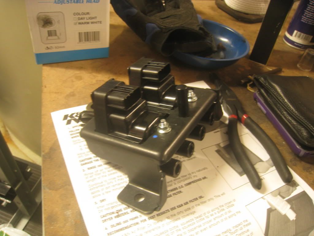

First the coil packs were changed.
The difference in response and power was there, so all things moving in the right direction.
Old
New
But.... the misfire was still there but less so.

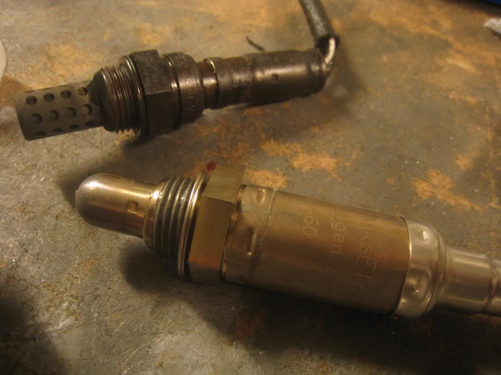

So onto replacing the O2 sensor.
Old in the background vs. new.
Bit more of an improvement.

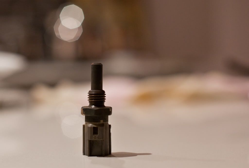

After moving back to Sydney the misfire was there intermittently, then almost everyday at low throttle and rpm. At full throttle the issue wasn't there and short of changing the TPS and AFM (quite expensive pieces) there wasn't much else to replace.
After searching on miata.net and hearing of similar issues with many other cars, the coolant temperature sensor at the back of the head (under the coilpacks) could be a culprit.
I rang around and found the part and decided to change it over since it wasn't too expensive.
Changing it over is almost a repeat of replacing the coilpacks since you need to take them out to access the sensor. There isn't much room back there since Mazda thoughtfully decided to put all of these bits at the back of the head very close to the firewall.
After many hours of work by my friends and many months of wondering what this issue was, replacing the sensor didn't take long at all. Even I managed to do it.

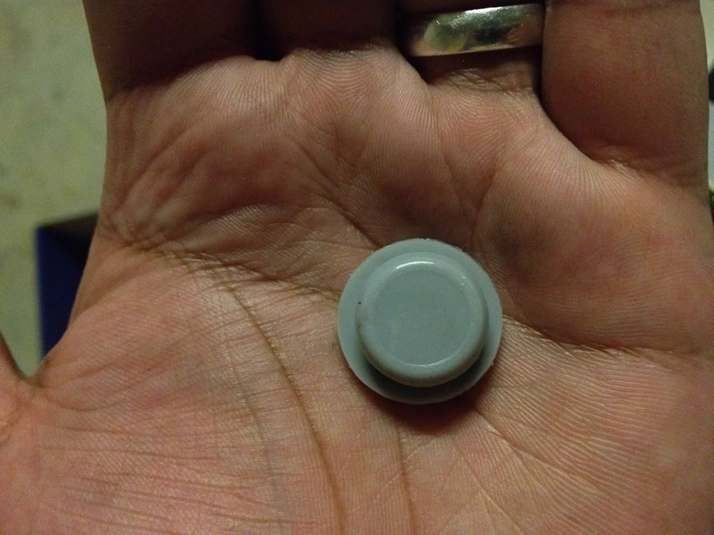

Here's the old sensor, it has a 12mm bolt size FYI and is located on the housing at the back of the head below the coil pack next to the cam angle sensor.
Important to note: This is an ECU coolant temperature sensor, also located on the same housing but on the exhaust side of the car is a temp SENDER for the temp gauge on the dash which points horizontally out from the side of the head. You don't need to change this unless your temp gauge is dead.

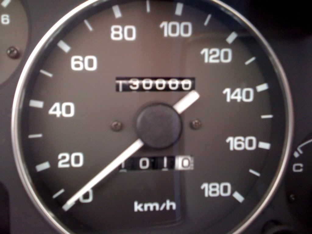

So the misfire of about 6months worth of annoyance is now officially fixed!!
And after a test drive, Betty and I are bonded once again. I have gone from having this niggling feeling at the back of my mind every time I drive her to really loving driving her all over again.
Fittingly we hit this milestone on the way home from fixing the long running issue.

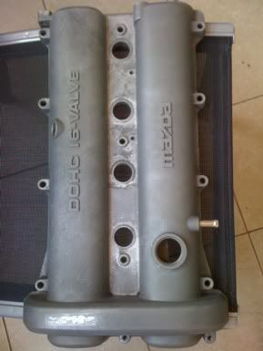

Took the valve cover off, pretty easy to do. Then into the dishwasher!
Painting it and putting it all back together (while trying to save the valve cover gasket that was replaced recently) without hassles was the next challenge.
Valve cover was then cleaned with wax & grease remover.
Despite looking 100x nicer than last night's grungy condition, she won't be winning any beauty contests right now. Still looking a little tired.
Now she's ready for paint!

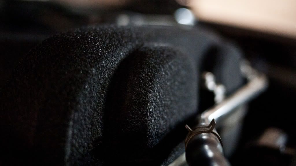

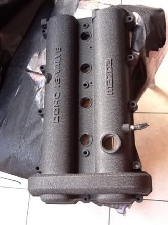

I decided on black wrinkle finish paint as it suits the style I am going for with the car. The black finish is also the same was what was used on the very limited production M2 1028 roadsters.
You have to be very careful especially with the thickness of the paint to avoid drips.
It transforms in front of your eyes from a smooth finish to an odd wrinkly finish and as time progresses you get the desired affect. I used a hair dryer on the heat setting to speed up the drying and to make the wrinkle finish tighter. Plenty of fumes, so trying their oven method did not sound like a good idea.
Here's a crappy shot of it, the finish gets tighter as time progresses.

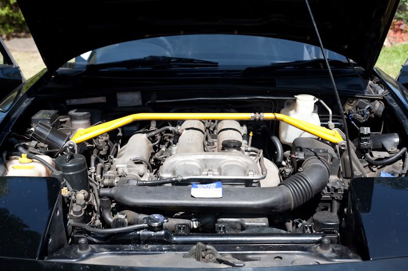

Now to clean the engine bay and give the paint some TLC.
Taz_
Posts: 58
Joined: Sun Jul 19, 2009 7:31 am
Re: Taz's JDM NA8 S-Special: I don't need no steenkin hire c
Postby Taz_ » Sat Dec 31, 2011 9:19 pm

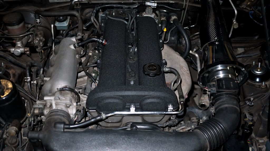

Before:
After:
Shaved/polished lettering to come...
Also note the cold air intake fitted. Added a noticeable increase in power and torque, plus the sound is rather tasty.
Need to get proper photos.

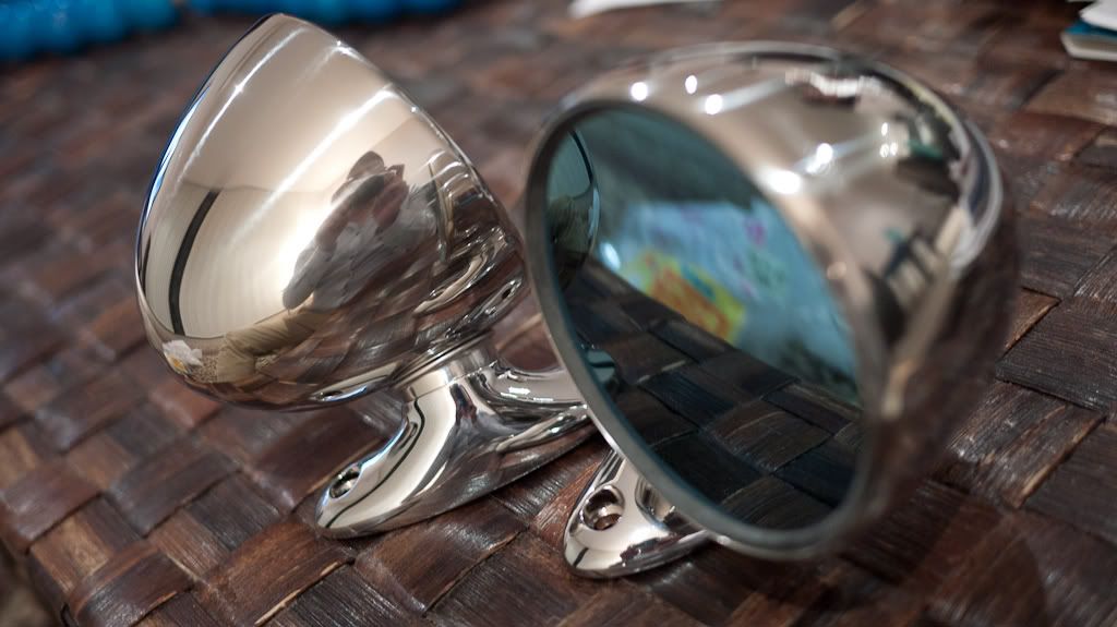

Nice and shiny!

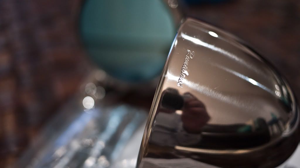

These mirrors made by Runabout Japan are replica's of the very limited production M2 1001 & 1002 Roadsters sold in Japan. These are the later model versions with blue tinted glass in the mirrors. Plug and play, stainless steel and amazing quality.

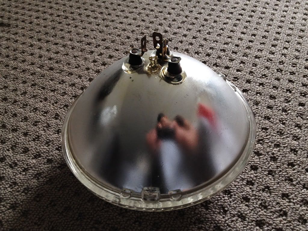

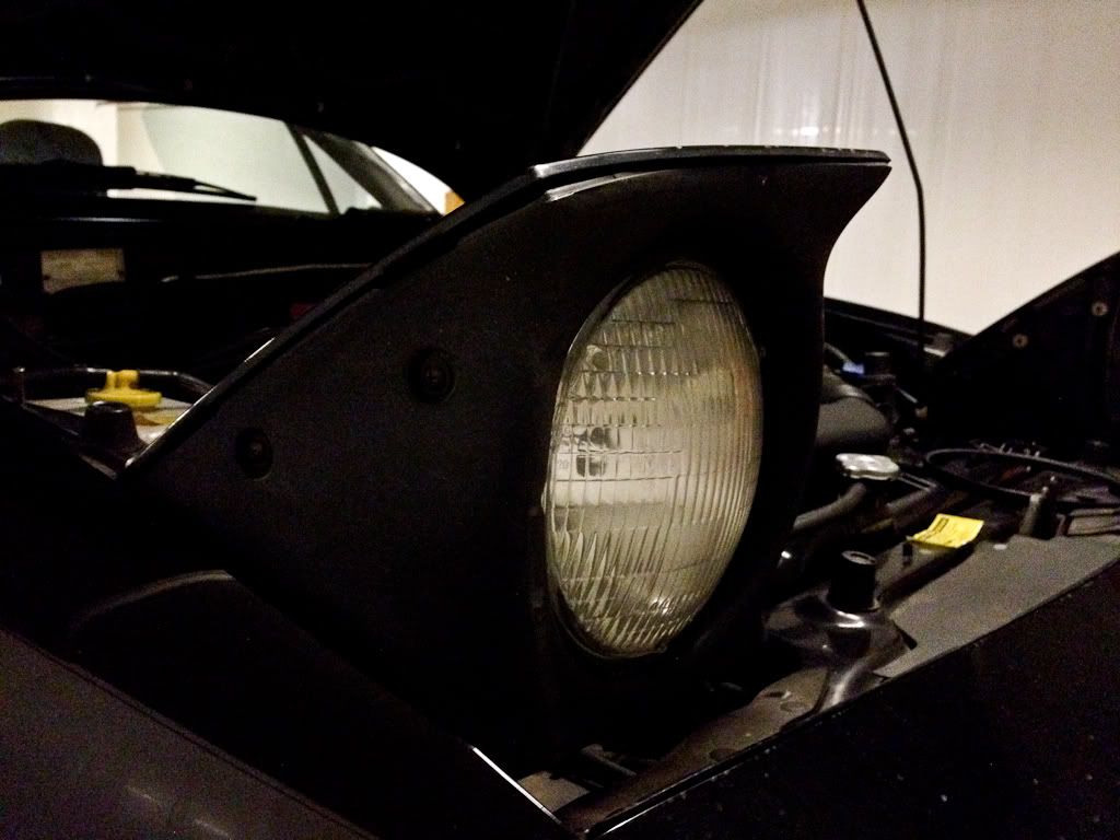

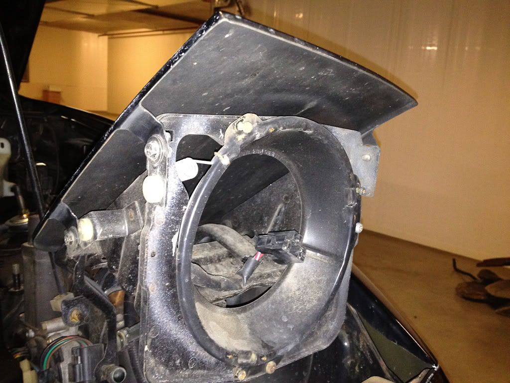

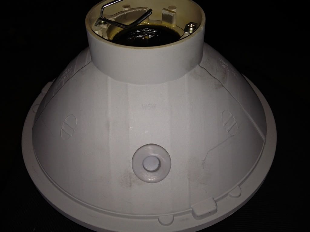

Ironically after passing a legit pink slip, I noticed Betty's passenger side headlight was not working on low beam but was fine on high beam. Rather than being a mysterious issue it was simply the bulb needing replacement.

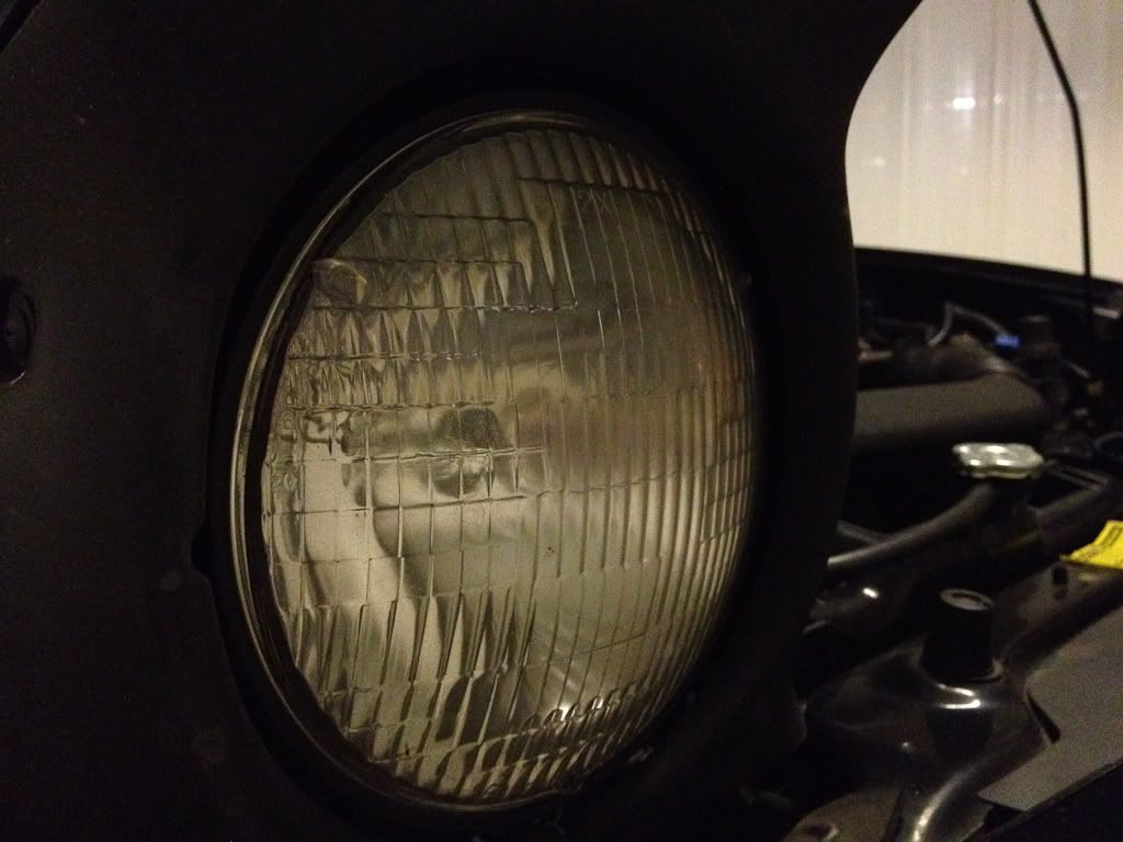

On import models including JDM and USDM cars they use sealed beams unlike the Australian delivered models. I found this out after doing some research and opening her up.
We start here, with a standard original sealed beam unit.
Next we remove the two screws on either side holding on this plastic shroud
Pull off the shroud, loosen the three screws on the retaining ring (not remove, and avoid the longer screws which are for headlight aim), rotate to remove and the headlight unit comes out along with the retaining ring. You then pull off the wiring plug from the rear of the headlight leaving you with this
No H4 replaceable bulb here, sealed up.

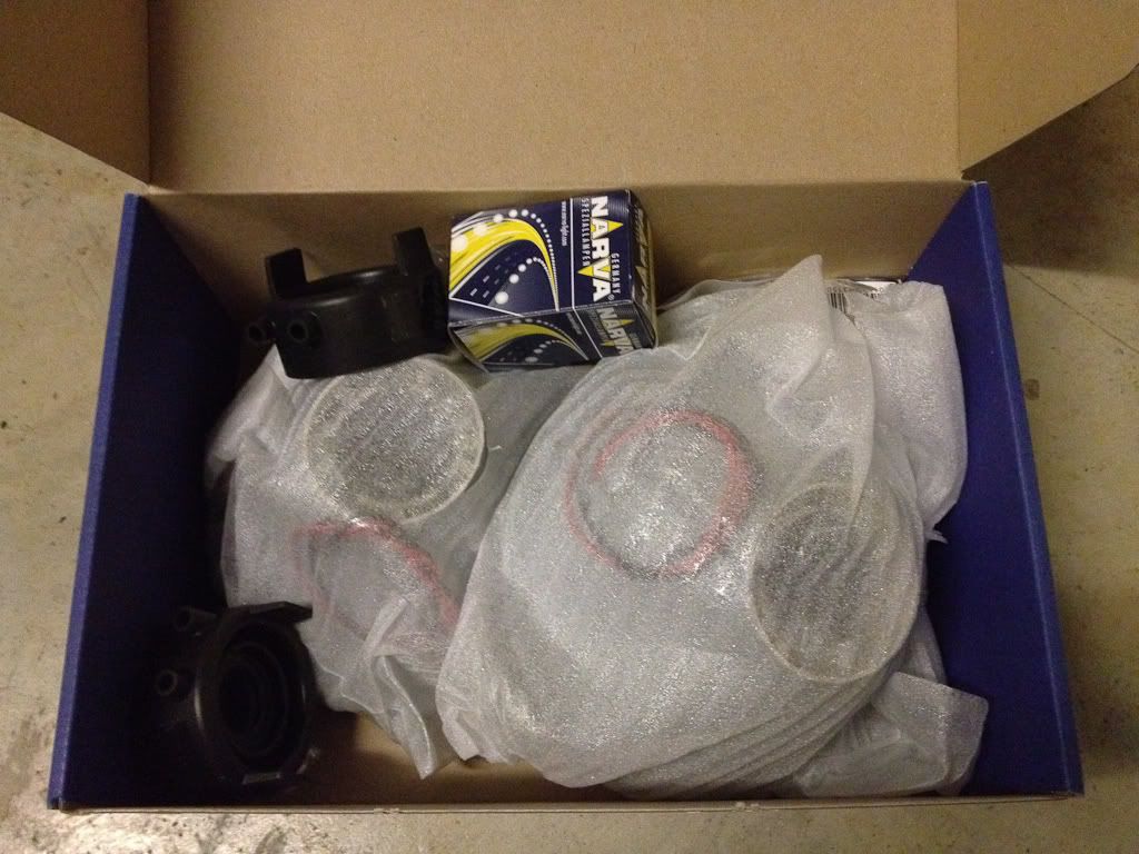

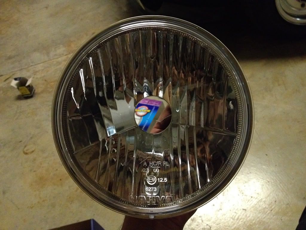

Rather than sourcing some new sealed beams, I opted for these NARVA H4 conversion units as I wanted to increase the lighting capacity from a dimly lit candle to something much more modern. After asking around on here and doing some research the NARVA units were sourced from the local auto parts shop after ringing around a few places.
They are E code units, which means they are to European standards, they also comply to ADR's.
Compliments of the Germans
Everything you need is here.

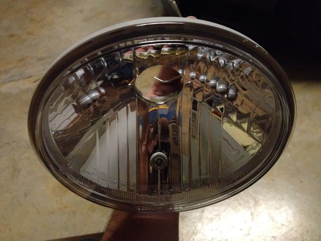

The kit comes with a pair of 'free form' headlight units - This is a more modern 'crystal' style unit, polycarbonate and with a much better beam pattern and cut off than traditional headlight designs like these.

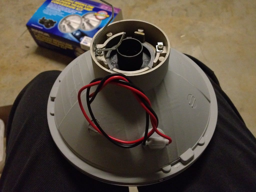

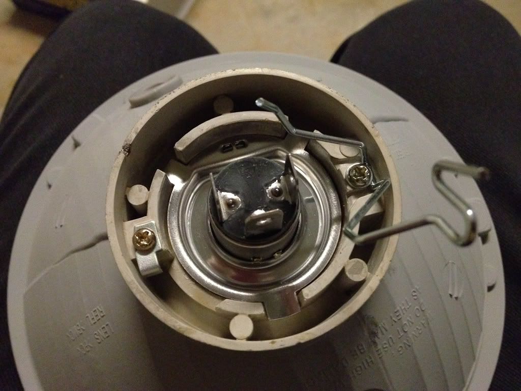

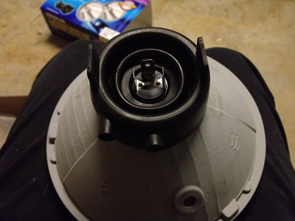

Also included are H4 bulbs, rubber boots for the rear of the bulbs to seal the connector from dirt and water, parking light fittings (there is provision for these inside these lights themselves) and parking lights.
Here is the rear of the new unit, as you can see there is a metal latch for the new H4 bulbs and the wiring is for the park lights (this is optional to use given these alights are used in a number of applications)
Here is the front
You can see the park light I fitted below to show what it would look like
Instead we fit this little plug since the parking lights are in the bumper on the Roadster.

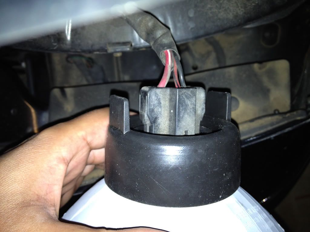

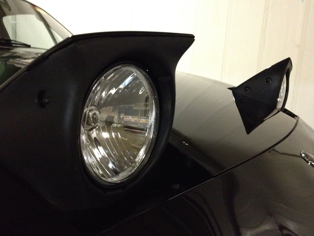

We then insert the bulbs into the rear of the housing by opening the metal clip, pretty straightforward
Fit the rubber boots
Plug it in

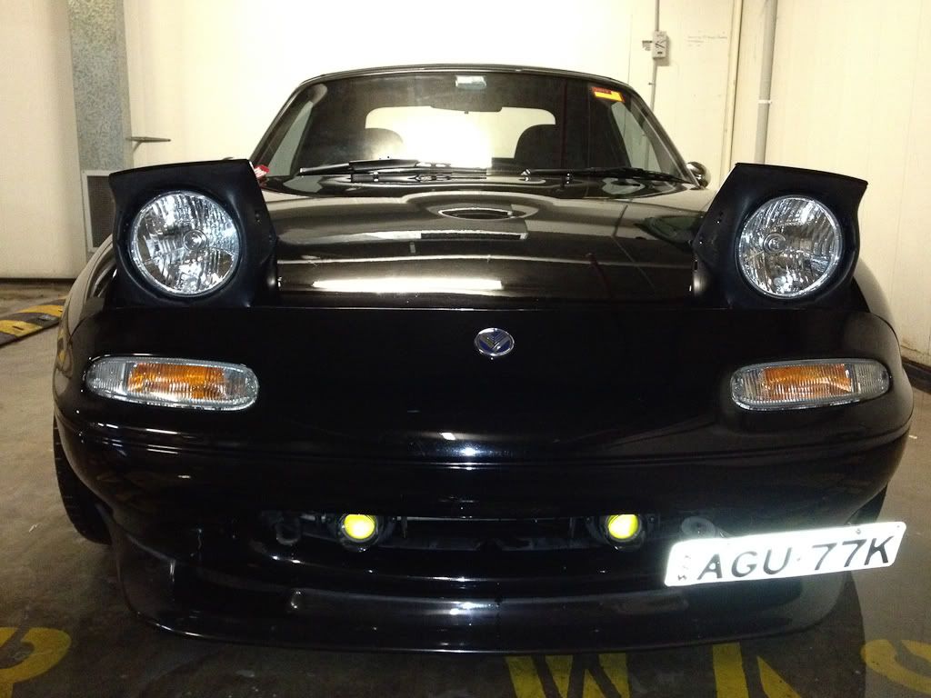

Refit the headlight onto the car - they only fit one way as per the plug on the back.

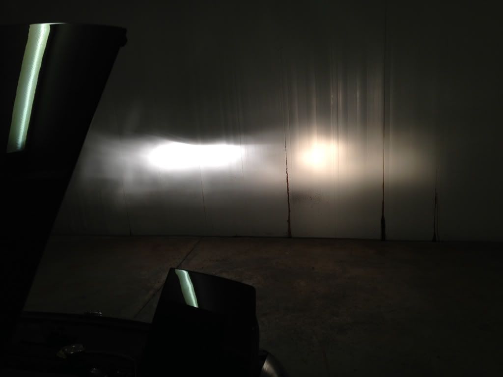

Let there be light!
New light on the left, much brighter, whiter light, wider beam pattern and a proper cut off like a modern car. The right is the measly dimly lit candle power headlight we had before. In real life the difference is more obvious and the clarity and cut off of the new light is more noticeable.
Job done
