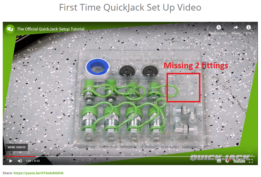

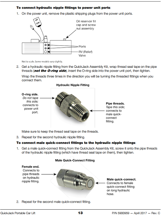

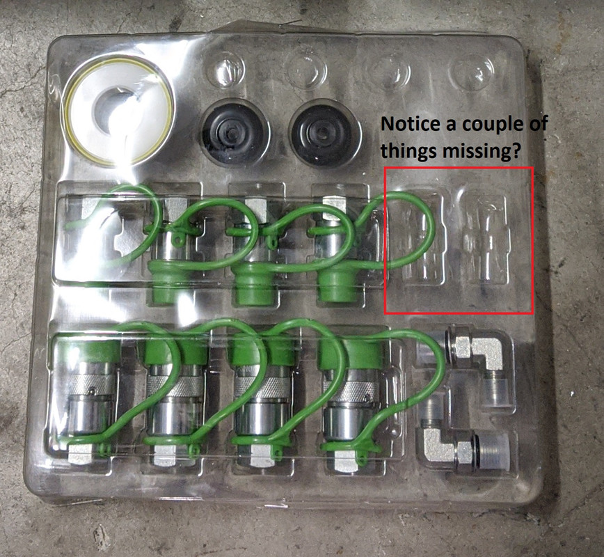

I didn't have the 2x straight hydraulic nipple fittings shown in Step 2!
I'd taken a photo of the fittings pack before I started and had actually noticed the 2x missing pieces, which I assume were those in Step 2.
The manual showed a slightly different fittings kit, which I assume was for the larger QuickJACK models since it included a few extra pieces AND the 2x straight hydraulic nipple fittings from Step 2 of the assembly instructions (see left side, middle fittings).
I'd watched the QuickJACK installation video several times, https://www.quickjack.com/setup-video/, and had never noticed that they were missing these 2x fittings too:

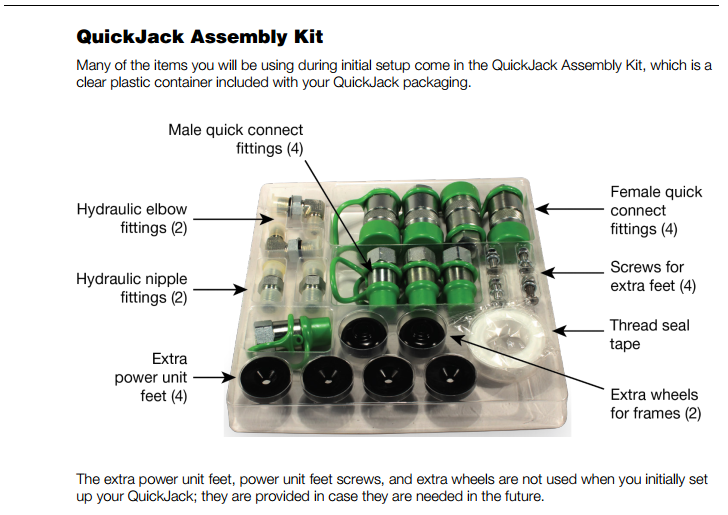

There's another subtle difference too - my fittings kit has 4x male quick-connect fittings that are EXACTLY the same (like the ones in the kit in photo # 3), whereas the kit in the video shows 2 different types, one set of 2 has a threaded end with an O-ring (these screw into the power unit) and the other set of 2 are like the 4 that I have.
I either need the 2x missing straight hydraulic fittings OR 2x male quick-connect fittings with threaded ends and O-rings (preferably the latter since there's one less point of failure per fitting) :(
My local SuperCheap and AutoBarn didn't have any hydraulic fittings so I'll try and sort something out with the QuickJACK supplier this week.

Perhaps there is something we are all mssing (perhaps the instructions aren't quite right)? i guess the supplier will give an easy answer.
