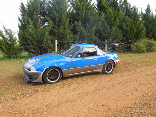

Well turned 50 today so decided to do an early morning road trip (some people may understand why the stops were done in certain places) .
Left Upper Commera around 0545
Image Image Image
Coffee stop at Coomera
Between Mt Tambourine and Beaudesert
Roadvale
Image Image
Between Roadvale and Kalbar (stopped because the splitter bottomed out)
Kalbar Lutheran Church
Image Image
Cunningham's Gap
Image Image
Mutdapilly (friends Appaloosa horse stud)
Then a boring drive back to Upper Commera via Logan Motorway/M1.
All up 300 km and my other half officially hates it! The plus for the drive is the wind/engine noise in the cab made conversation (complaints about my driving) difficult. Passenger not impressed that I was practicing left foot braking going down the other side of Mt Tambourine. However, the use of ear plugs would make the drive more enjoyable and considering that stops were made along the way, 300 km is about the limit without hearing protection. Maybe a set of earmuffs that plug into the intercom maybe the go, however it may look a little silly.
