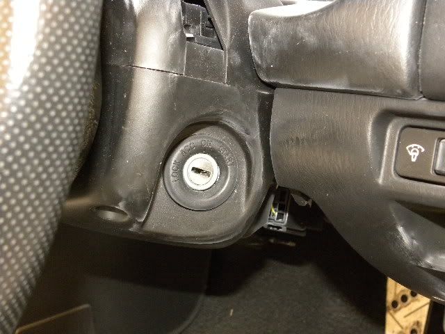

take out your ignition key

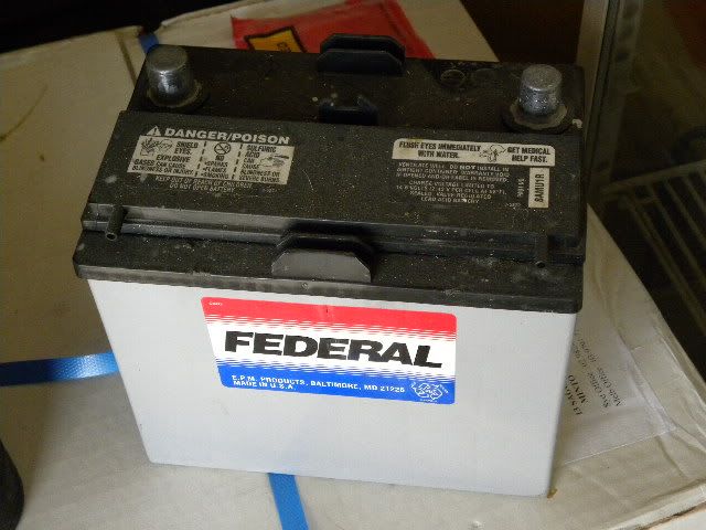

dis-connect your battery. remember.mines out anyway. all you have to do is disconnect one terminal

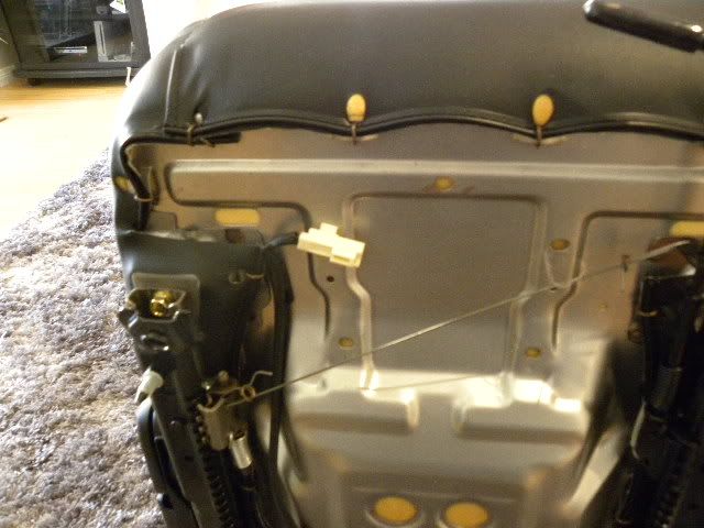

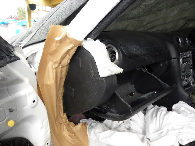

remove the front bucket seats. 8 bolts. quick and easy. now before you remove the drivers side seat - from underneath unclip the drivers side airbag switch.
PAY ATTENTION!!! see this switch under the seat if you fail to plug it back in and turn on the ignition - air bag sel for you and a trip to the dealer.
THAT IS REASON WHY YOU DISCONNECTED THE BATTERY. for starters you will mostly likely forget about it- jump in the car and turn on the ignition. .........nothing.
straight away you will remember what i said - did i re-connect the airbag switch and if so then on to the battery.

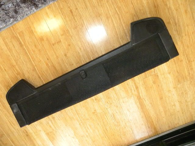

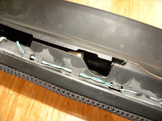

next up - remove the windblocker - 2screws either side
once thats done don't remove it briskly - right in the centre are the wires for the speakers. unplug these.

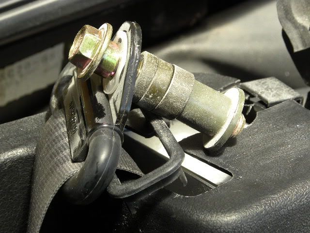

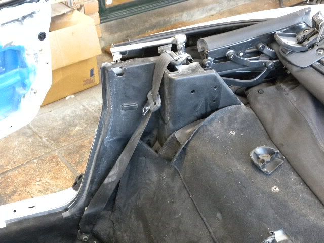

prise up the cap and remove both seat belt bolts

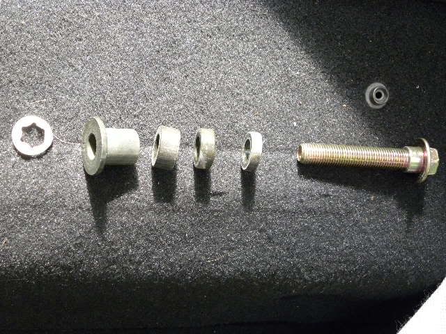

if you happen to drop them - here is the correct location of the parts
remove both the side panel

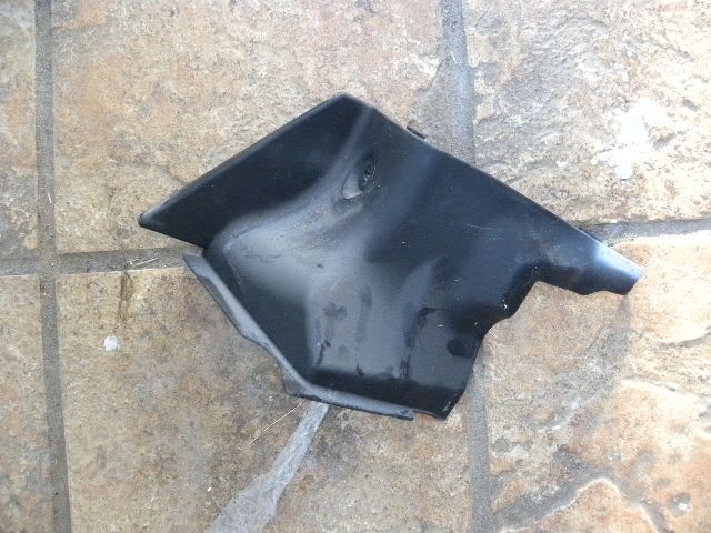

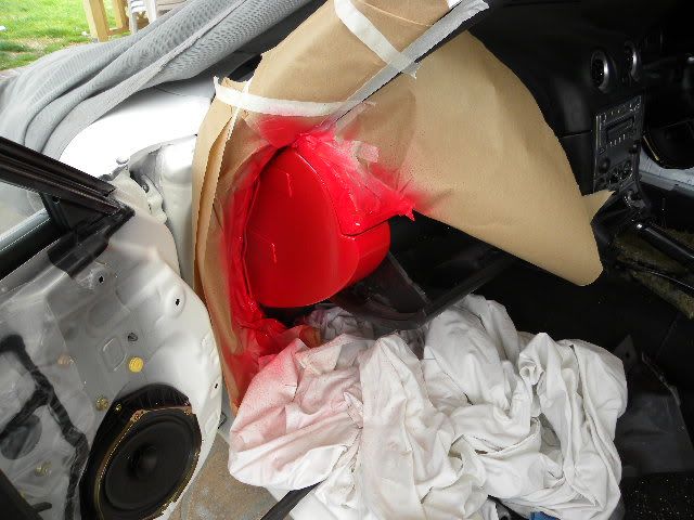

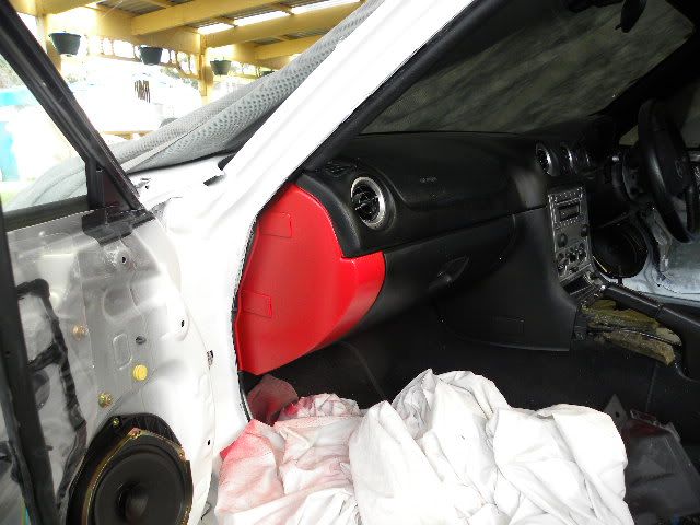

remember i removed this cover to paint - yours stays
on the opposite side of this plastic panel there's another. remove this one only. one each side

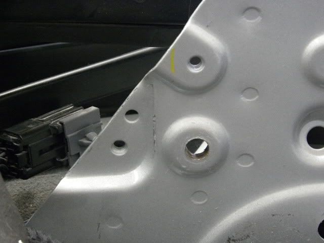

the passenger side has a connector for your heated rear window - so be vareful with the removal

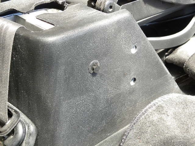

now it's out with the drill and a 10mm bit. my car has both plastic panels removed to show how easy the site is for the drill bit. you will be drilling out the bottom one ( both sides)
[IMG]http://i907.photobucket.com/albums/ac278/wildbill2010/DSCN1804-1.jpg[/IM
once completed - should look like this

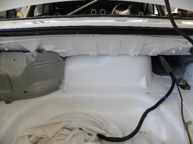

now go to the boot
remove the full rear part of the boot liner - plus the fuel filler cover plate. you need access to this area to tighten the roll basr bolts

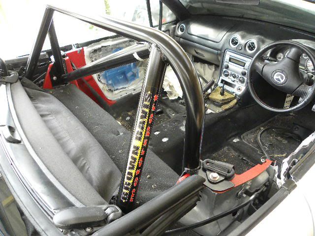

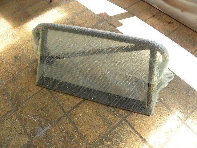

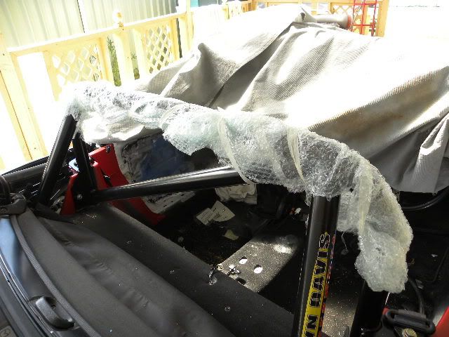

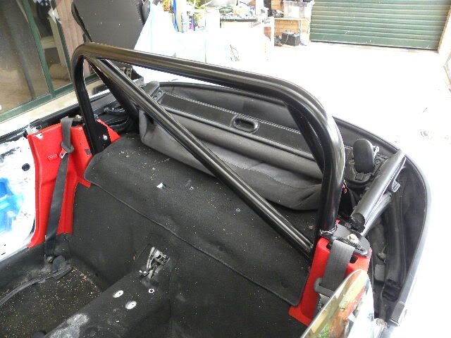

now with the help from a friend carefully place the roll bar in it's bolt down location between the tops of the seat belt mounts. i wrapped the top of the b/d bar in bubble wrap to avoid scratching the surface
wither do this with the roof up and place in position. or down and slide in position.
line up your anchor points side and top.

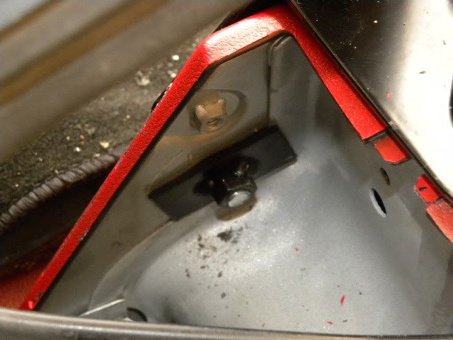

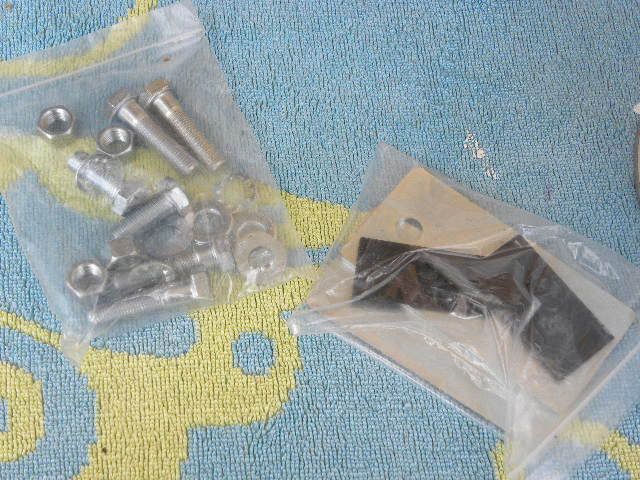

anchor point fitting kit. the 4 large bolts and steel plates attach to the section where you are about to drill the holes. the other two with captive nuts are side anchor bolts - see photo

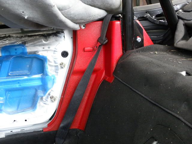

bolt down loosely either side of the seat belt mounting points. place the bolt throught the seat belt mounting hole and slide the other parts in - from below
once this task is over bolt down both sides of the seat belt towers. now to the sides bolt from the inside and go through and held by the captiver nut - see above.

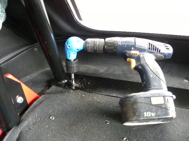

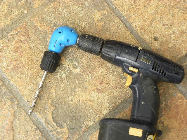

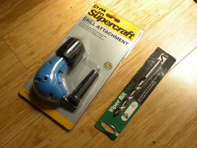

to drill the back section - the roof must be up. because of the angles there's no room for a normal drill and bit. i had no choice but to buy a 90 degree adaptor plus a new bit $42
here is how it looks inside the cabin. not much room and i strongly advise a brand new 10mm bit or it's gonna be hard work for you
closer view of the 90 degree adaptor
hole through the floor -rear section. one down and 3 to go

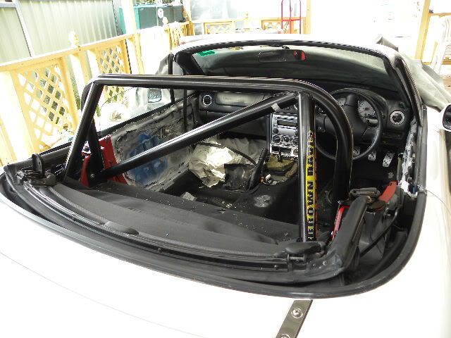

once you drill through the floor its just a matter of inserting the 4 bolts from inside the cabin and with your helper in the boot area - place the metal plates and bolt them down.
fix up your trim and its over. job done.

Goddamit! 90deg adaptor! How stupid is that! I've got one and forgot all about it when I installed my BD twin hoop bar...I did it on my own and man it was a B!ITCH!
...I undid the back of the soft top :oops:
Postby billybunter » Thu Oct 13, 2011 9:08 pm
thought about that - but was a bit worried about damaging the plastic trim. anyway it's over and out of the way and back on with the build:D

just a heads up
that plug under the drivers seat is just for the seatbelt warning light
i disconnected mine ages ago, was sick of it beeping at me everytime i started the car
Postby billybunter » Thu Oct 13, 2011 11:41 pm
in that case -my mistake. i remember once removing a plug under the drivers seat on a bmw z3 i had and it was an airbag plug
that produced a cel and a trip to the dealer. :frown:

Pretty sure the side airbags in the seats did not arrive until the NC. Only the two frontal airbags in the NB. But that's still a good warning about what happens if you unplug an airbag.
de Bounce
Posts: 1091
Joined: Thu Feb 12, 2009 5:19 pm
Location: Northern Burbs - Melbourne
Postby de Bounce » Fri Oct 14, 2011 12:05 pm
I disconnected the plug under my seat (2001 NB8B) as the red light distracted me when I wear a harness.
From my research the Supplementary Restraint System (air bags) deploy both bags when the vehicle is subjected to the appropriate impact regardless if the drivers seat belt is used or not.
Could be wrong :?: and don't intend to deliberately hit anything to find out.
