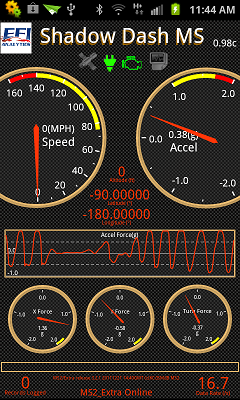

Bluetooth x Megasquirt - http://omgpham.com/bluetooth-x-megasquirt
This is something I've been wanting to do for a long time, implementing Bluetooth connectivity for my Megasquirt ECU.
No more cables for tuning and data logging, I can even use my Android smartphone/tablet for data logging and digital gauge/dashes. The Android App is called Shadow Dash MS, free of charge from the EFI Analytics.
http://tunerstudio.com/index.php/shadowdashmsmenu
You can buy off the self devices that are plug and play, around $50-$100, but I've decided to take the DIY route which cost me $12!
These can be found on eBay for about $12-$14 shipped to Australia.
There is a bit of work to do like adjust settings as well as some soldering.

- gslender
- Posts: 2330
- Joined: Sat Feb 19, 2011 10:49 pm
- Location: Brisbane, QLD
Re: mrpham's summer build
...or just buy this for $60 plus shipping and its done - already configured and it just works (and the developer who built the apps gets a little $$ for his troubles)
http://www.tunerstudio.com/index.php/cablesandbluetooth
