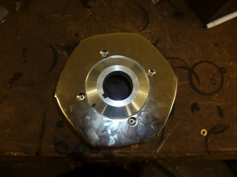

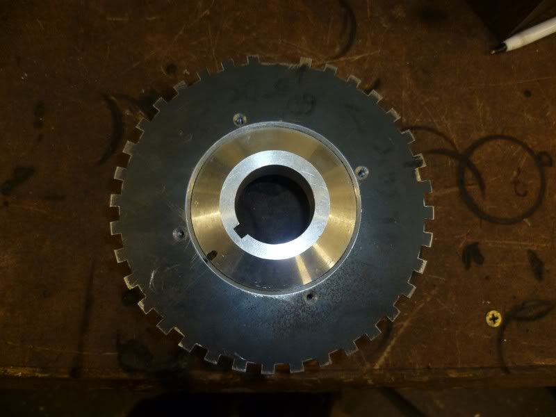

Today I made YET ANOTHER 36-1 wheel, this one for the new pulley. I never want to have to make another again in my life, they take forever!
6 tooth wheel which came with the pulley
New 36-1 wheel

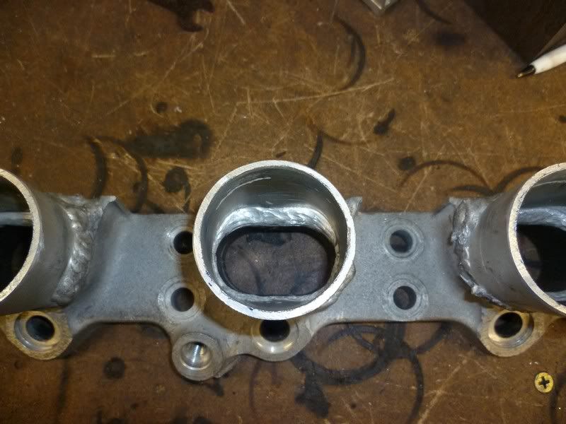

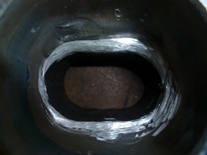

I also took some pics of the lower intake manifold which I ported out a bit. It's not perfect but the dremel takes ages to remove material.

The main reason I'm going to a 36-1 wheel is that I've eliminated the cam sensor (due to fitment issues), so the ECU can't tell when top dead centre is with just the standard 6 tooth wheel. It gets this info from when the missing tooth comes around. Also having 36 teeth rather than 6 gives a higher resolution signal for more accurate ignition and injector timing. I don't need a cam sensor because I'm using wasted spark and semi-sequential injection.

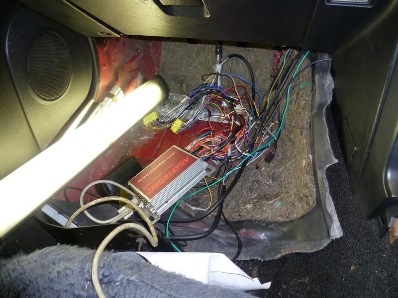

I got the ECU all connected
It wouldn't boot up properly, then I realised one of the grounds wasn't connected. After I fixed that I installed the latest firmware and did a few checks. The injector test worked fine but I could only get coil 1 and coil 2 to fire, coil 3 appeared dead. I figured it was unlikely the brand new OEM coil was defective so I checked all the wiring and isolated the problem as the ignitor that I made. The 3rd BIP-373 coil driver wasn't working, I probably overheated it when I first soldered it. Luckily I had a spare and once that was installed everything worked properly.

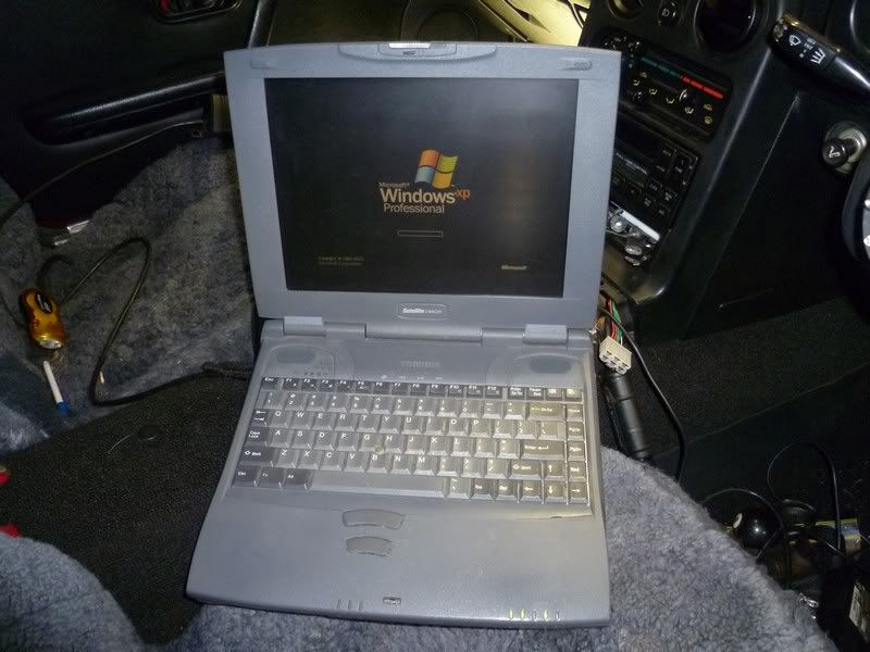

Here's the ancient Toshiba laptop which I installed XP on and the WARI tuning software. It has a serial port which works but the screen only goes to 800x600 so quite a bit of the tuning ap isn't visible.

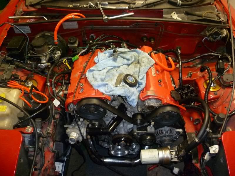

Here's a shot of the engine bay.
All that's left to do before I can start it is to put on the intake manifold, add oil to the engine and gearbox, torque up the front crank pulley and plug in a few wires.

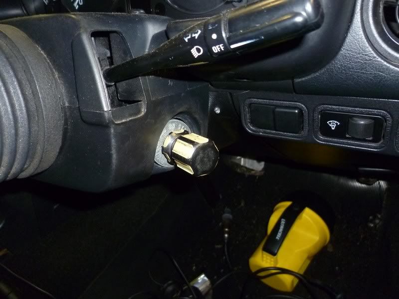

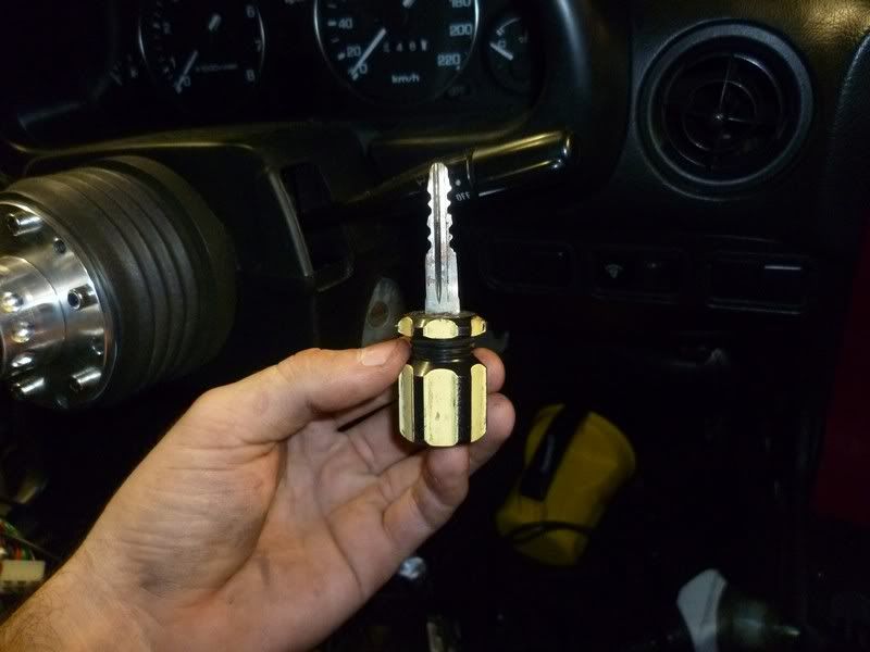

I also made a screwdriver key
Well, what else do you do with a broken screwdriver?

Good luck mate, I have been following this build with interest since you started, very good work!
With regards to the screwdriver key, there might be a small business opportunity in that for you, it looks quite cool! lol

LOL at the key! It will get a ton of laughs.

I've always wondered if people get an interesting reaction from the cops at an RBT with a screwdriver key.

I really like the key! Best part of the build so far! haha

Hehe thanks guys, I love how the key turned out.

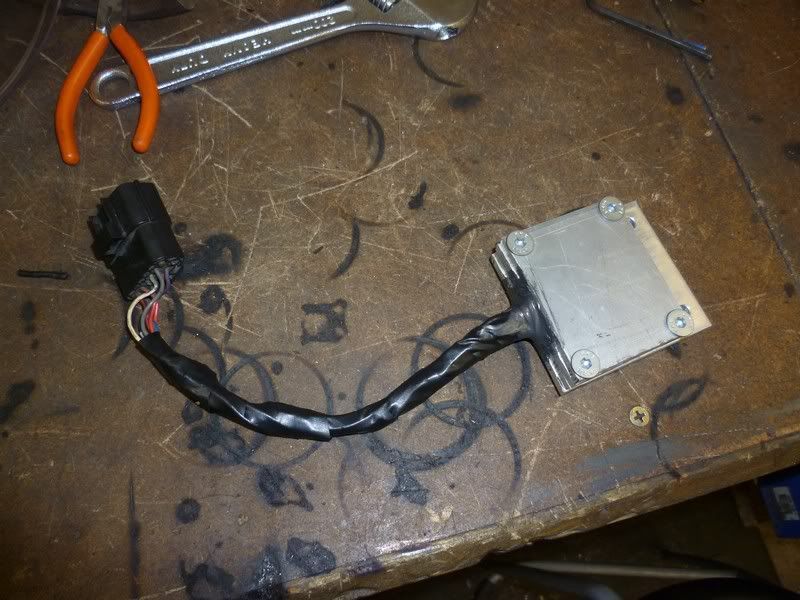

Basically I've somehow fried either the coil, all the BIP-373 chips in the ignitor or the ECU's ignition circuit. I think it's unlikely to be the coil because the BIP's would have been destroyed long before that happened, and the ECU functions perfectly apart from not generating a spark so I think it's unlikely to be that.
So, somehow I've destroyed the ignitor chips (unless someone knows another reason why isn't working) and I can't start it until I get some more

OK, so a massive update! I found out the ignitors weren't working because I had bent the pins a bit too much and a couple had come loose from the chip
. Rather than ordering some more from the US and waiting until they arrived I found out that heaps of Mitsubishi's including Magnas use a Bosch BIM-034 single channel dumb ignitor. One trip to pick and payless and I had 3 of them.
Once I wired them up I had some weird issues (spark causing ECU to reset and fuel pump to prime and all sort of weirdness) but that turned out to be because I had only one spark plug plugged into the wasted spark coil for testing. Once I put two spark plugs in it worked perfectly... AND THEN IT STARTED!!!!!!!!!
