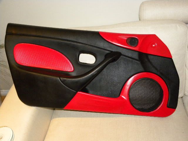

here's the first completed doot card

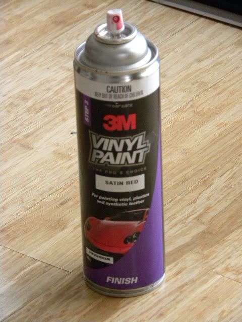

the paint - 3M vinyl

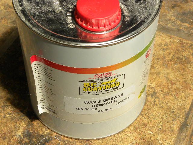

grease/wax remover 4 litres ( its cheaper in the long run)
2000 watt oiled filled heater or any other heater
scaper/sandpaper and mashing tape.
i would have preferred to use vht vinyl dye as i have read good reviews but none was available locally in RED so i chose 3M vinyl from supercheap. no reports on this so time will tell if it's anygood. price about $17
i gave all areas of the work job a good hard scrub with grease/wax remover. if possibly buy a 4 litre tin. it's a bit over $20 and a lot cheaper in the long run than a spray can of the stuff. you can then use it time and time again

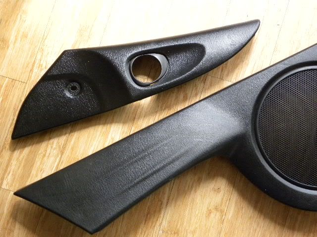

top area of door trim before/after the wax and grease remover. note after photo-the trim has lost its armorall gloss
give all areas to be painted a thorough scrub. even after that you may still find problems with hard to get grease areas which will show up later on in the job.

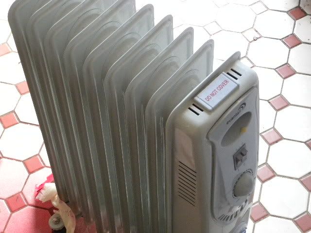

alternately do what i did. into the laundry or any other small area and hook up a 2000watt panel heater.
takes about half hour to warm up and your in business and ready to go

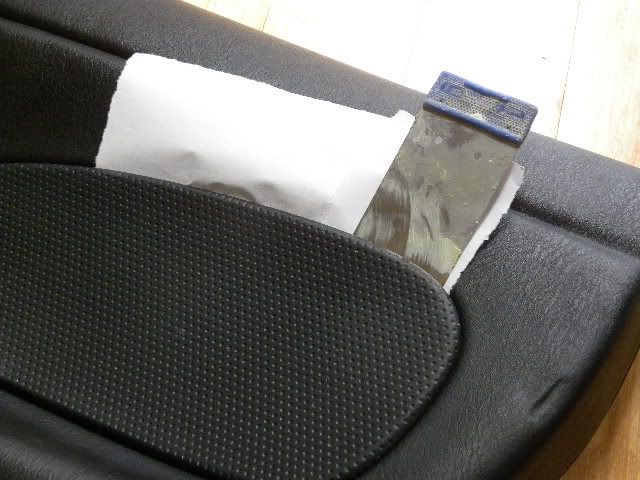

while you area is heating up you can get on with the masking

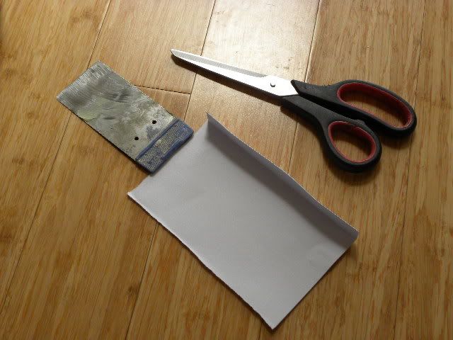

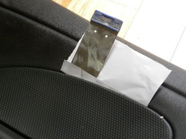

to make this easier use something like this
get some A4's cut to quarters then fold the bottom egde up 10mm. slide in your applicator then slip it in behind the door card and follow on around the door trim

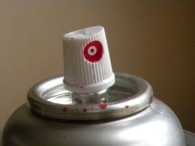

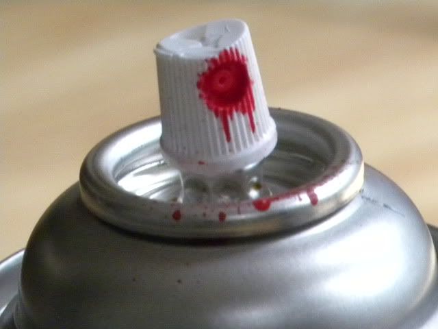

now before you go to coat 2 allow 10 to 15 minutes and clean the spray nozzle. why? it will probably save you an unexpected burst of paint on you work . so keep it CLEAN!

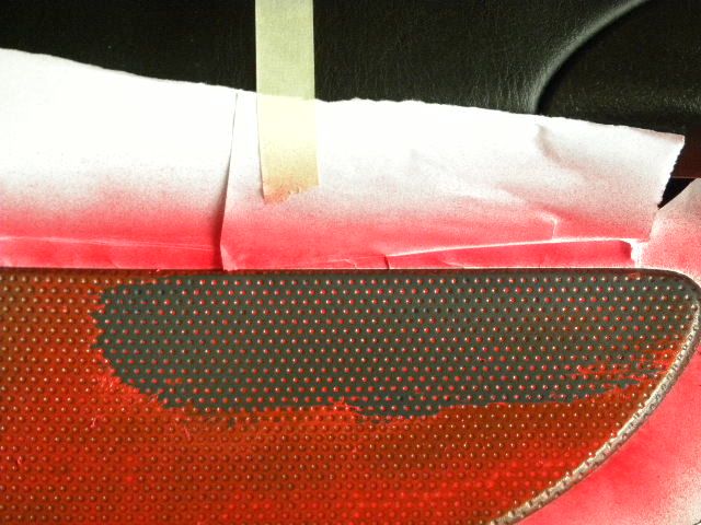

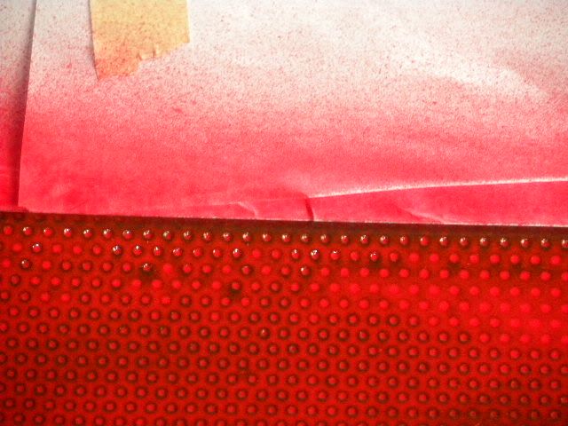

during the painting of the door card - up came a grease mark. there were 4 dots in all over two sections
only thing was to do was to totally rub out the areas with the grease/wax remover
don't worry it's no big deal. clean the area up but make sure you don't leave any rough areas. if you have a couple of the rough areas give them a light rub with 600 wet/dry paper - again LIGHT! to smooth 'em out
now give go back to step one and give it a light spray. don't spray the total area - just the re-work.

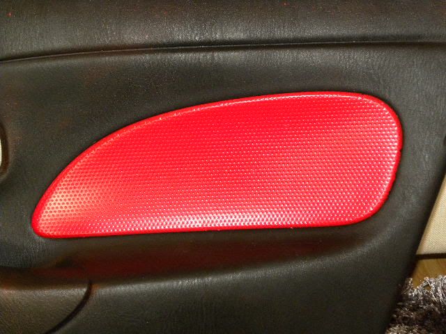

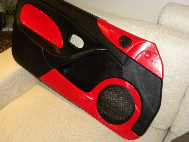

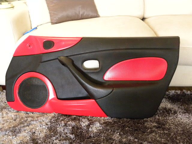

here's a completed work photo of the mess taken about 2 hours later. looks good and everything is fine
about 3 hours later the panel is completed with about 5 or 6 light coats of the vinyl paint. say 15 to 30 minutes flash times between the coats.

now would i use the 3m vinyl again - not if i could get the vht vinyl dye. i wasn't really happy with the spray can nozzle. at times it shot jets of vinyl paint
i recall using other spray cans say 20 cm from the work area -but 45 cm was :roll: and at times spray control was non existant.
on the other hand i might have had a crappy spray nozzle. one quick point to end. always pre fire the spray can nozzle elsewhere and not on the job. after a break it's usually the first burst that produces a paint splatter or excessive paint and a run.

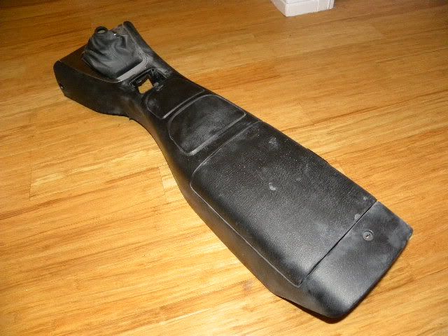

back again - same place with newspaper on the floor. :wink: now working on the spraying of the centre console
Postby billybunter » Tue Oct 11, 2011 4:36 pm
today's project - centre console
