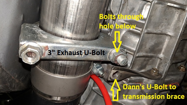

KevGoat wrote:BEGi don't supply a bracket with their downpipe and just say to remove the original, nothing about replacing it. Opinions appeared mixed on Miata.net whether it's necessary. I preferred erring on the safe side and made my own. I didn't receive any bracket with Dann's exhaust when I fitted that a few months ago and I haven't fitted one yet, but had intended to make a new one to suit.
Maybe the bracket was added by MX5 Plus when they re-built the engine - will try and take photos of it tonight because it was quite effective and may be what you're looking for KevGoat.
Essentially it's a piece of galvanised steel, about 100mm long and 20-30mm wide in a shallow spiral (for strength?) that attaches to one side of the U-shaped exhaust clamp and the other to a bolt on the gearbox - strong and very solid which is why I'd like to mimic it..

Postby NitroDann » Mon Nov 26, 2018 11:09 am
If I didnt send you one Kev it was a mistake.
We always do this and Lokiels bracket is from me also, (as is that heat sleeve).
Let me know if you want me to post it to you.

Postby Lokiel » Mon Nov 26, 2018 9:19 pm
Photo of Dann's downpipe bracket and 3" exhaust U-bolt as promised:
- that slight twist to what was originally a flat piece of metal is simple and very effective since it makes it very strong
- I'm going to make a temporary one out of aluminium initially because when the exhaust is made it will likely need to be modified again.

Lokiel wrote:Photo of Dann's downpipe bracket and 3" exhaust U-bolt as promised
Photo makes it easier to know how and where it fits. Took Dann up on his after he posted above and glad I did now, it looks pretty substantial. Can't believe I forgot all about it after fitting the exhaust!

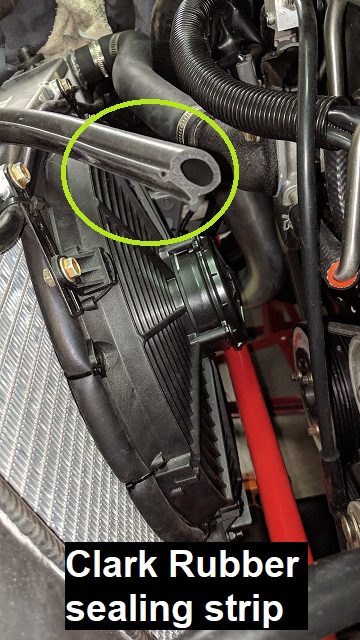

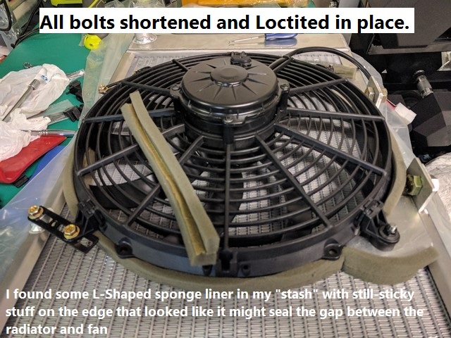

I did take the time to install the rubber seal for the fan I bought from Clark Rubber a few weeks ago - the existing foam I used didn't seem robust enough:
The round part is on the outside of the fan and it's held in place with zip-ties - the rubber should last several years vs months for the foam.

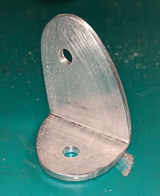

To "more-securely" mount the filter pod, tonight I made a small 3mm aluminium bracket that screws into the hose clamp's bolt and sits on a rubber stopper that mounts through an OEM M6 threaded hole:
- it'll be hidden within a new Cold AIr Box eventually so I don't intend to "pretty it up" any further.

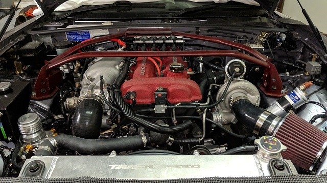

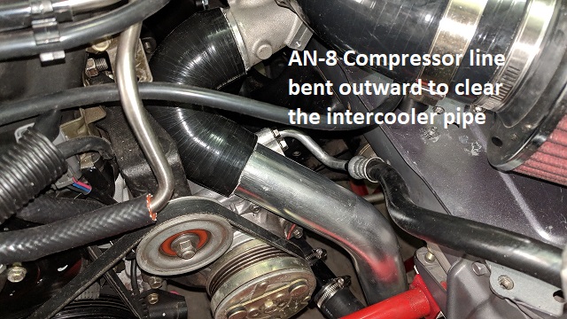

Looking at the A/C compressor's AN-8 hard line section, I figured I may be able to bend it enough by hand to clear the intercooler's hotside plumbing:
- yep, cleared it nicely, that's one less A/C line I need to worry about re-making.

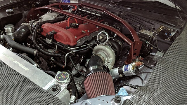

I was also worried that my Carbing 3-point brace may not fit with the EFR6258 and wastegate cannister in place so did a quick test-fit:
- luckily it does!
This will be left off for the exhaust installation since it makes it easier for them to access the downpipe's V-band clamp.

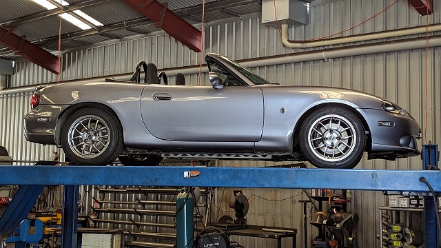

Car delivered to Newman Ave garage in Woolloongabba.
We pushed it onto the hoist, raised it and I ran through what I wanted:
The guy didn't seem fussed at all, even when I mentioned that the hotdog may no longer fit - Dann's downpipe is shorter than the TSE one so there's less room under there now.
Hopefully I can start re-tuning this weekend and actually drive the car again!
