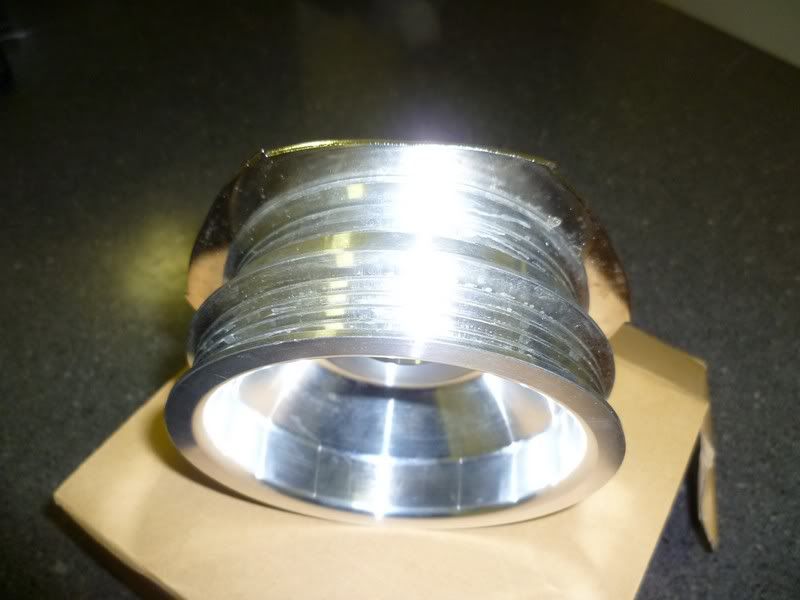

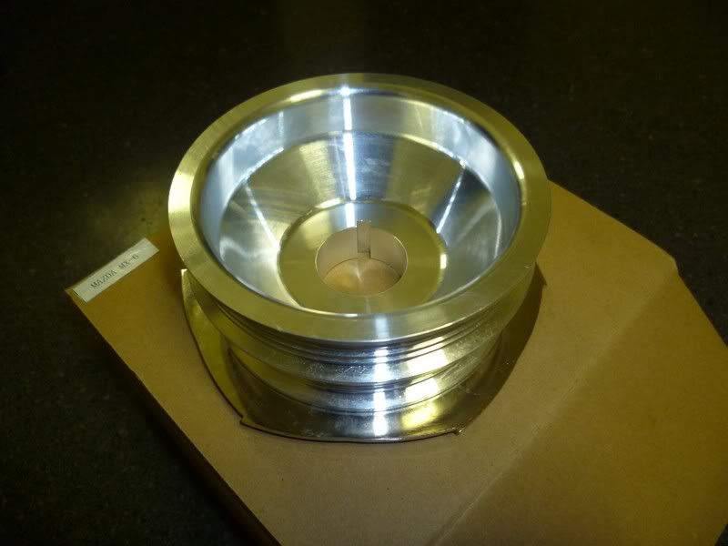

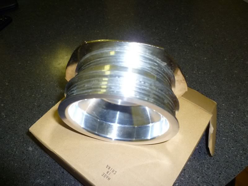

FINALLY the pulley arrived today! It looks pretty good, though the bolts holding the timing plate already have their heads mostly stripped out. That should make removal fun :)
Not bad for $35 (+ $42 shipping)
