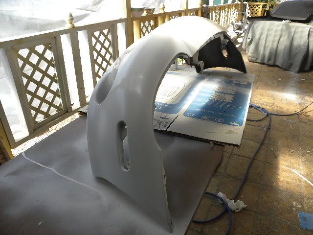

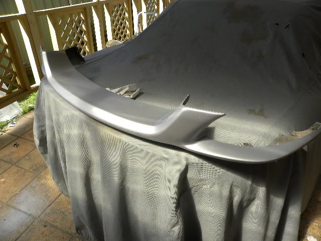

Postby billybunter » Tue Oct 04, 2011 6:02 pm

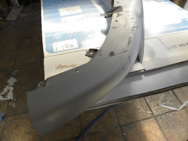

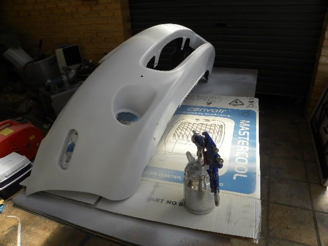

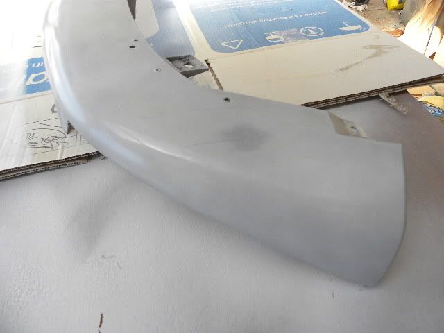

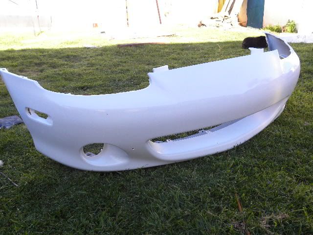

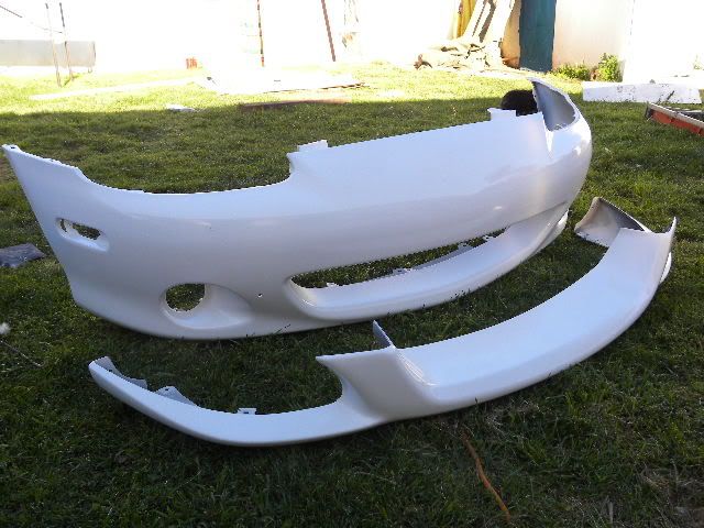

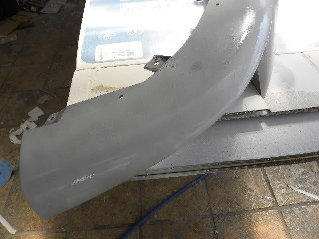

front bar coated in plastic primer
bottom part of front bar
under side of bar plastic filled and sanded
first of 3 top coats
top coat on

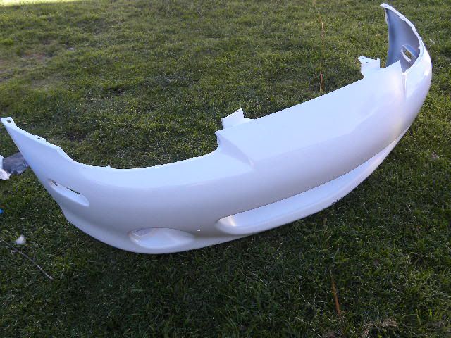

top and clear coated
job done
Postby billybunter » Tue Oct 04, 2011 6:07 pm
just thought i'd mention. just in case you think that there might be a paint run in the centre of the bar from left to right...........definately no run just high reflection from the clear coat :D

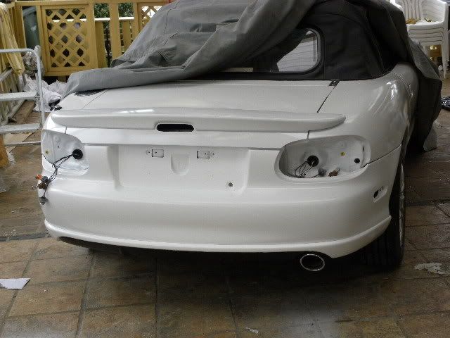

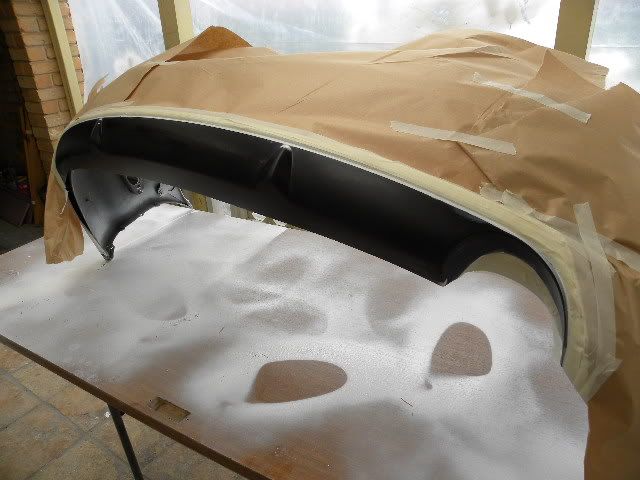

Postby billybunter » Wed Oct 05, 2011 6:17 pm

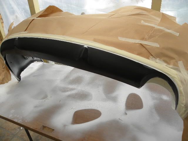

rear bar lower section sprayed in plastic primer then top coated in matt black
rear bar on car
Postby billybunter » Wed Oct 05, 2011 6:18 pm

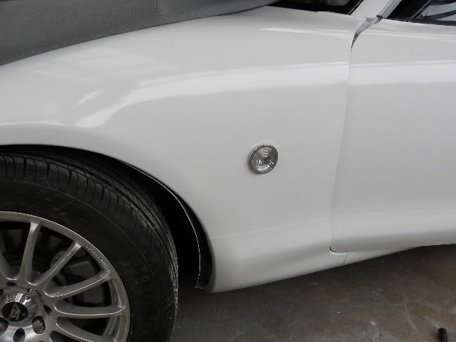

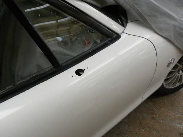

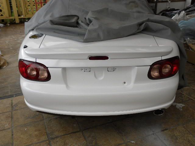

Postby billybunter » Thu Oct 06, 2011 5:38 pm

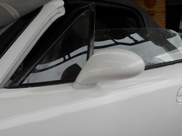

door hardware on
mirrors next
clear repeaters

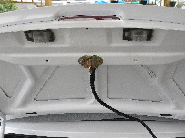

boot area

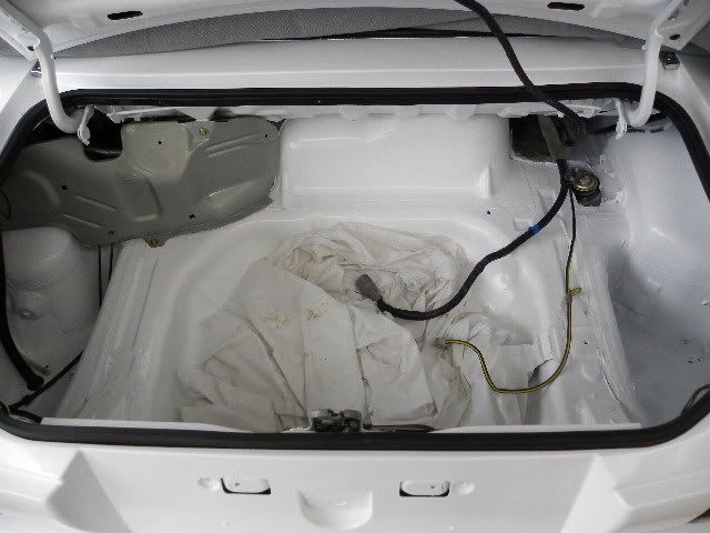

rear bar - tail light - 3rd brake light and clear reflectors

Postby ak_perth » Thu Oct 06, 2011 6:44 pm
Wow, i love the clear repeaters. They always look brilliant on a white car

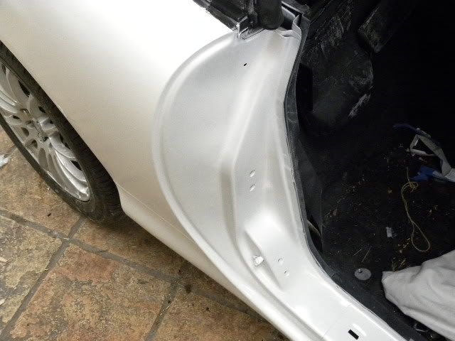

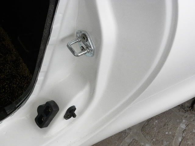

will carry on .........with the tease. wait till we get to the interior. had this door jam rubber the wrong way in, just change it over. old photo here showing wrong direction

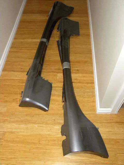

now it's onto the side skirts

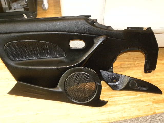

Postby billybunter » Sun Oct 09, 2011 5:17 pm

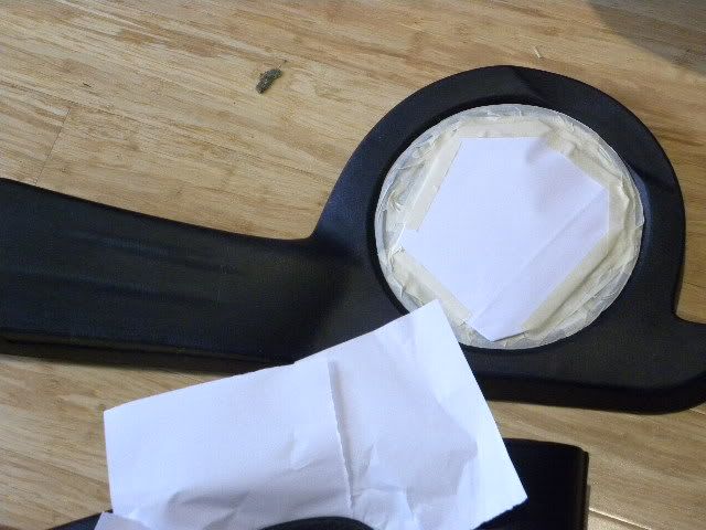

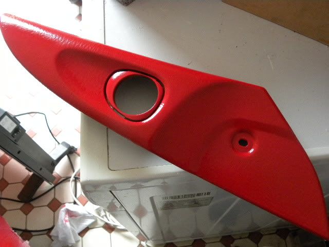

decided to do the door sills at a later date. now into changing the colour of the door cards to jazz up the interior. hopefully should look smart with the white exterior.

Postby davidau » Sun Oct 09, 2011 6:06 pm
Red to go fast? :mrgreen: The progress is good.
What type of paint do you use for door card?

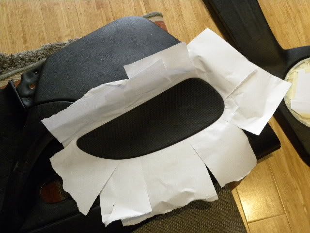

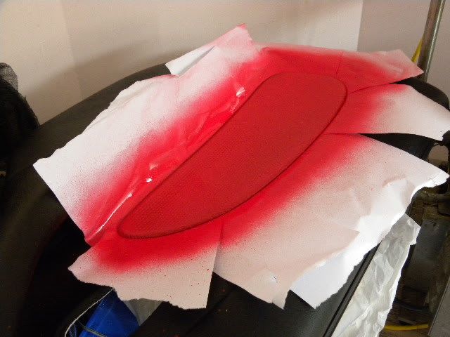

Postby billybunter » Sun Oct 09, 2011 6:19 pm
3m vinyl paint - you can get it at supercheap and goes straight on. should be a good product being 3M. one thing you must do is prepare the surface well with grease/wax remover.
i cleaned the panel parts several times. literally laid it on. when on to the painting still got grease bubbles on a couple of parts. best thing to do is out with the g/w remover again and wipe over the contaminated area. after that just blend the red paint into the black.
allowed 10 to 20 minutes per coat. three coats in all.
don't slap it on thick or this stuff will run easily.
Guran
Posts: 3754
Vehicle: ND - 1.5
Location: Albion Park NSW
Postby Guran » Sun Oct 09, 2011 6:28 pm
How good is that cleaner at removing Armorall and similar silicone-based vinyl treatments? I've been told they can be virtually impossible to get off, and cause delamination of overpaint. Probably more of an issue for exterior panels. Hope you don't have that problem.
